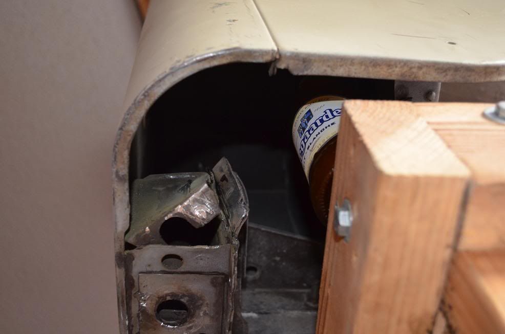

Worked on the broke off tub mount. Snapped what was left of the bolt off, nothing I tried, PB blaster, heat or tap out would get it out. I ended up breaking spot welds and taking it out, tomorrow I'll try and drill it out and re-tap or weld a nut to the top of the plate, then re weld the tub plates.

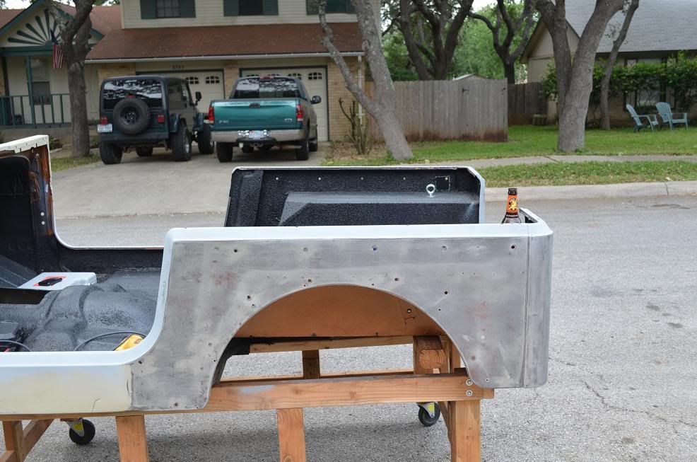

I decided to use POR-15 under the armor for rust prevention, this with the inside of the side armor coated in POR-15 should to the trick. I tried to mount my rear tube flares, but they did not come close to mounting properly, so their gone, I was not a fan of them anyway...
I decided to sell them and pick up some TJ rear factory flares, I had some beat up ones and after a mock up, they looked pretty nice
I'll re-mount the armor before paint with seam sealer at the edges, then have them painted with the body color.
Got the armor test fitted, they were a pain in the as* to mount..
Armor off, sides to bare metal
Sides and inside of rock sliders covered in POR-15

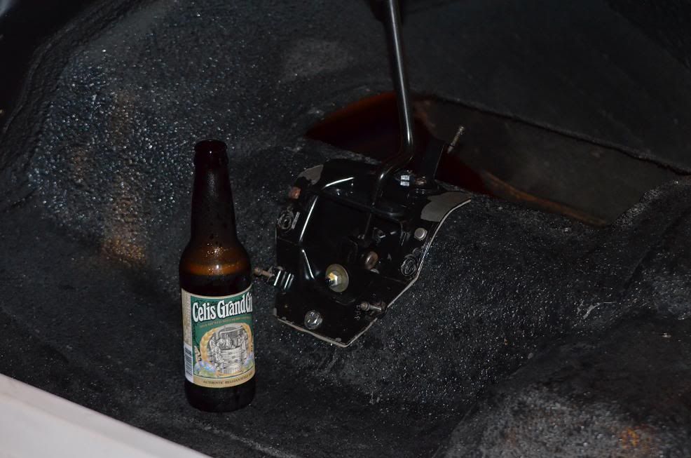

Seems like I did this already once... got the transfer case shifter remounted on the new tub.
From what Iv'e seen, I'm not a big fan of this herculiner stuff, can it be painted over? or is there a way to clean it up?
