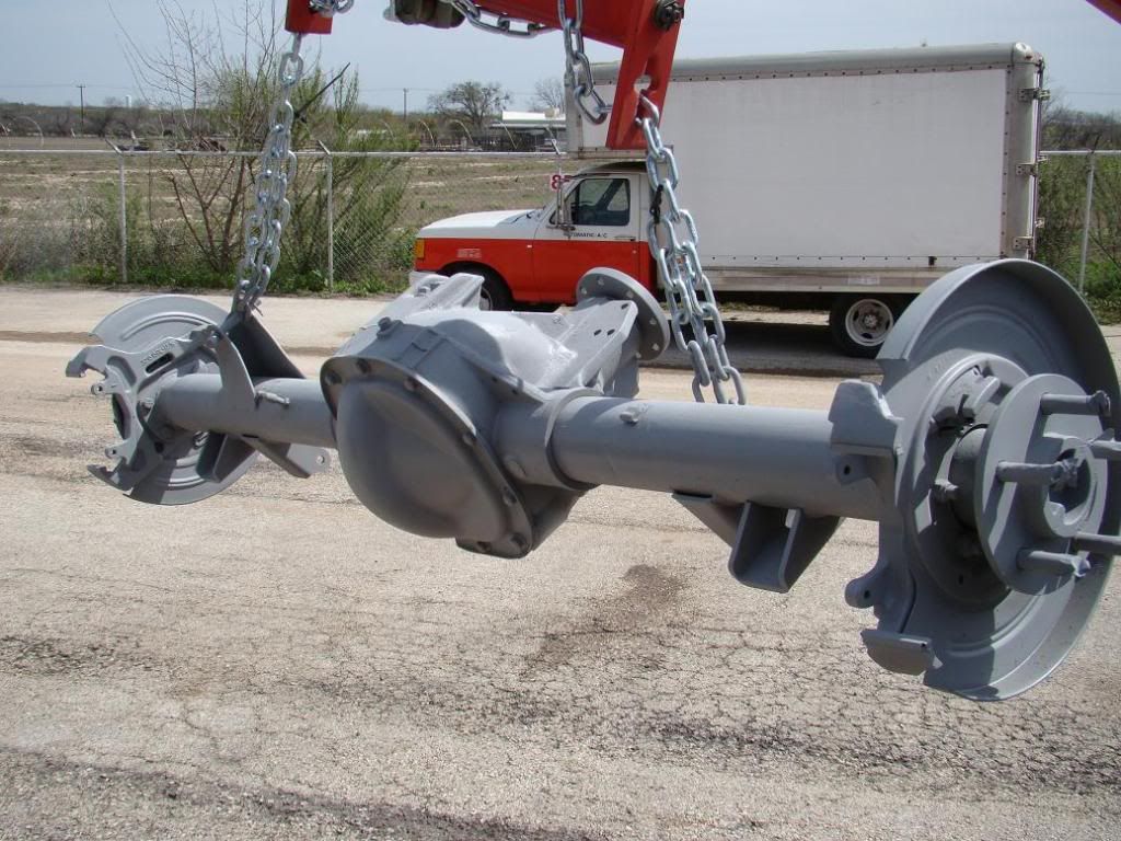

Life finally stepped aside and allowed me to get something done on the Jeep. The ford 8.8 finally got back from the shop. I was able to drain the fluid, sandblast and prime it this morning.
Iím off all this week so I should make some progress; my goal is to finish the chassis by the end of the week.

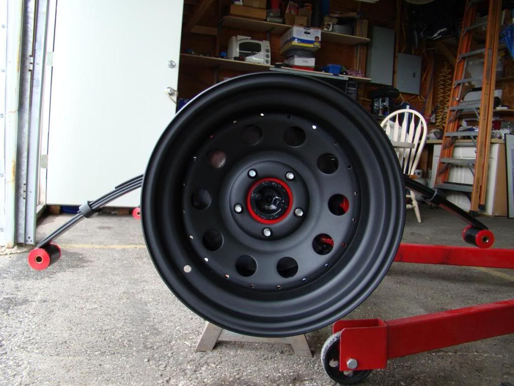

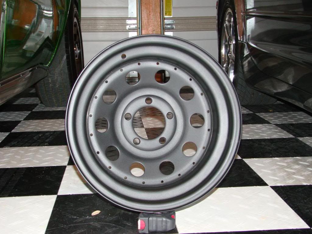

Got the ford 8.8 top coated with satin black today, pictures tomorrow....I played around with my powder coating system on one of the original rims, I think my oven is not heating up enough. The rim is darker than the picture but came out a dark grayish black and has a rough texture like the coat didnít melt enough. Even thou it didnít come out satin black, I love the lookÖ.hope it sticks... I'll post another picture in the sun when I get a chance.

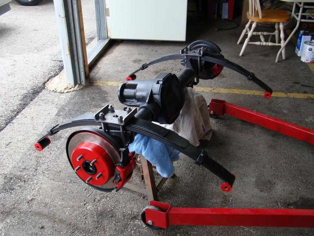

I had the spring and shock mounts welded on. I will eventually go with lockers, just moving dollars to get it going. Found out today the decent tires that came with it are 14 years old... so new tires are on order.
The rim is black, not grayish...I'm just color blind
The powder coated rim in better light..
Got the brakes and springs on the 8.8
A rolling chassis is close at hand

Are you planning on putting a clear coat on the wheels or leaving them as is?

I didn't know you could ? I just read you have to apply ther clear while the rim is still warm, could it still be done?
I think my bigger concern is what the second rim will look like, I belive the oven is on its last leg, I left the rim in for almost 2 hours and have not looked at it yet...

I am no powder coat expert by any means. The wheels i have are black, with a clearcoat over them and they have held up really well for the last year. I would look into it, it will sure make them last longer and be really easy to clean.
