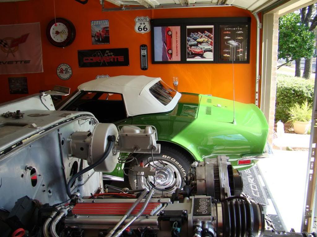

Also, get me a picture of the C3 vette hiding under the cover across the street... looks like a 73 to 75 model...
Glad to see you have a running engine. I am very jealous now and have much work to do to catch up. My PCM is indeed different because it is older model, I bought a 93 LT1. Probably should have held out for the newer one, ie 95-96, but this one came with a video of it running in the car before I bought it. Sounded sweet!
You have a keen eye; oldman Joe has a 70's vette under the tarp and I have not been able to catch him on the bi-weekly engine run to get a photo for you but will keep trying. It is a very cool car!

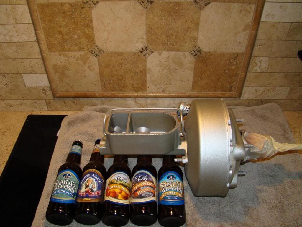

Got the brake booster in and brakes bleed today..

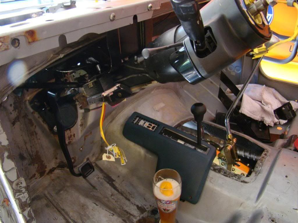

After a nice 3 day weekend and a trip to Austin to watch my Horns open up the season, gotta a little work done.....No beer til the last picture, don't want my neighbors giving my address to AA...

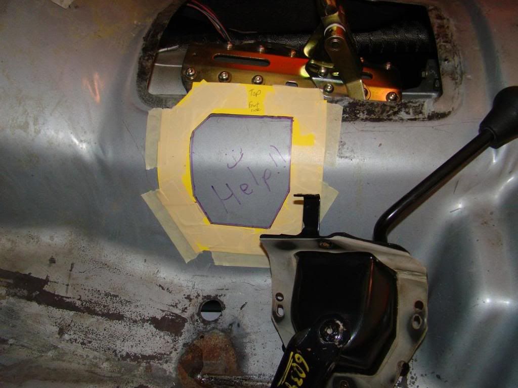

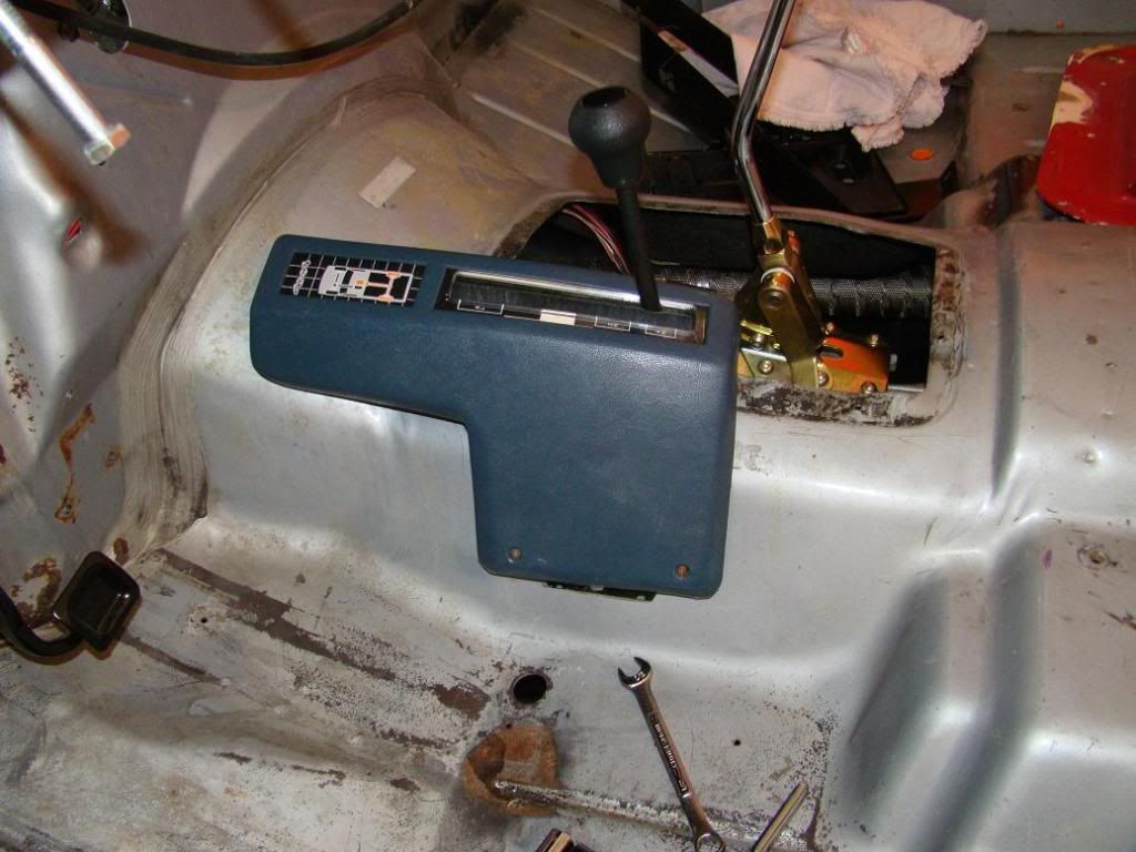

Started mounting my stock chevy TC shifter in, made a template from the backside of the shifter..
Cut out..
Mounted...
Not sure yet If I'm going to use this trim.
Finished the steering column mount, JB'ed a couple of steel plates under the column and filled the top sides flush. Since the Jeep column was flush with the top of the column, and the vette column was flush at the middle, I made a couple of spacers out of Delron.
Column mounted..
