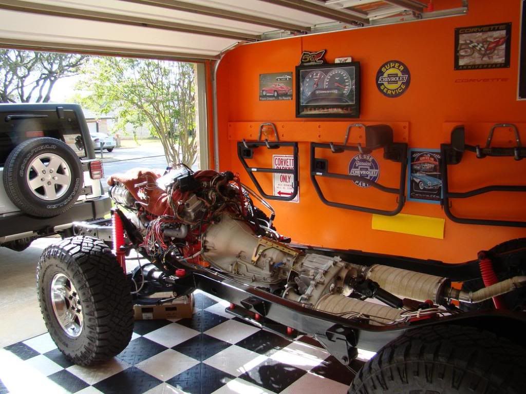

Ran my fuel pump wiring in the frame, seemed a logical choice. I reconnected all my dash wiring & steering column on my fancy "work bench" and spliced in the fuel power and gauge wires. Not sure yet the fuel gauge works, but note the gas can on the front drivers side tire, it had fuel in it after 5 seconds of cranking
I plan the to get the "corveep" ( what my baby girl named it) running as it sits.

I liked the orange paint in the garage. I was curious if I could get away with that being an OU employee. Then I noticed your 'Hook em' tag and realized the orange was more than a trendy shop color.
Oh well. It looks good anyway.

The color is actually between Chevy orange and Burnt orange, but as a OU employee, I would choose a different shade, for career longevity..
Hook-um!! ( sorry, had to)
