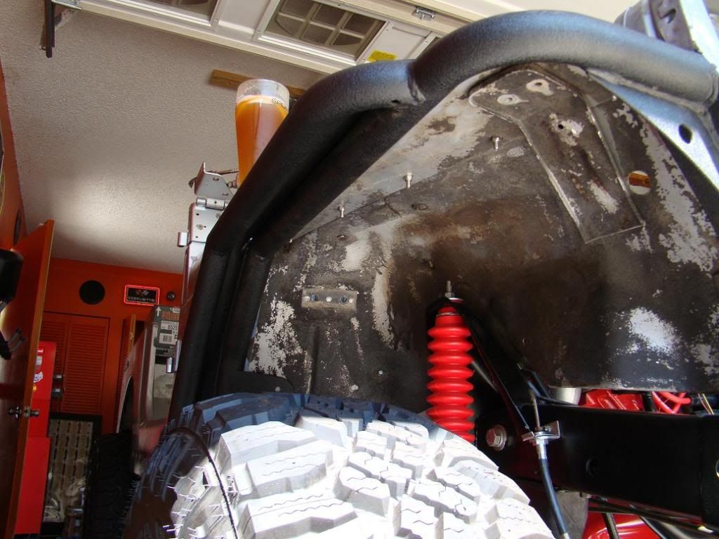

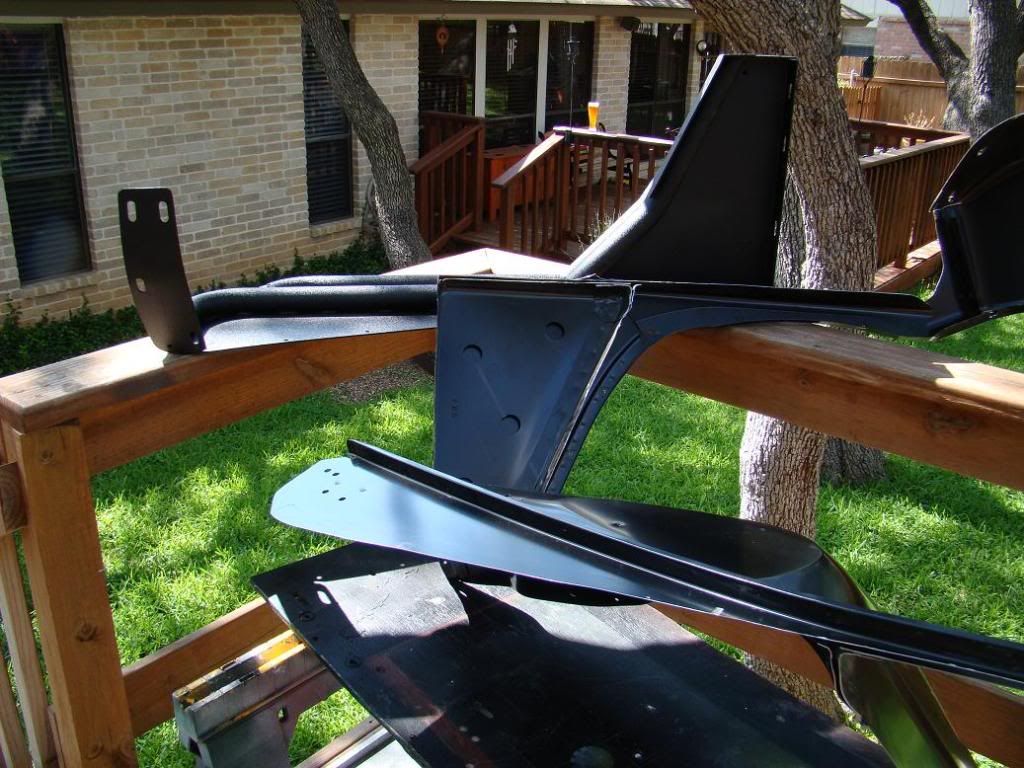

I needed to get the inner fender wells on the tube fenders, to give me somewhere to mock up and mount stuff like the PCM and engine fuse block.
Here is the passenger side, I'll disassemble tomorrow, strip and prime it. Note the scuff marks on top and in front of the fender, thats how it was shipped...
Felt strange cutting a new fender up... I'll finish this one tomorrow as well.

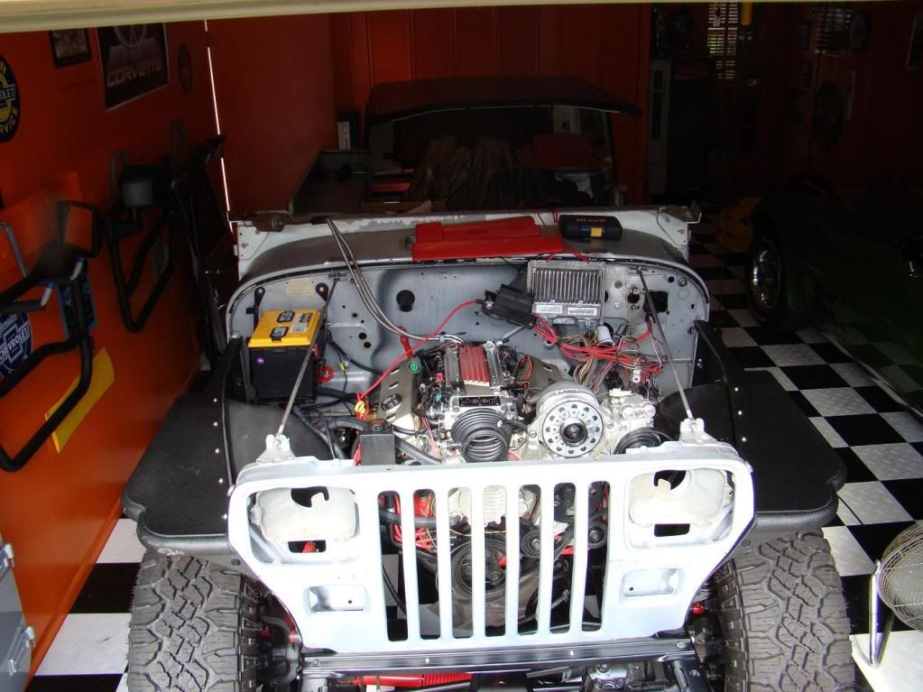

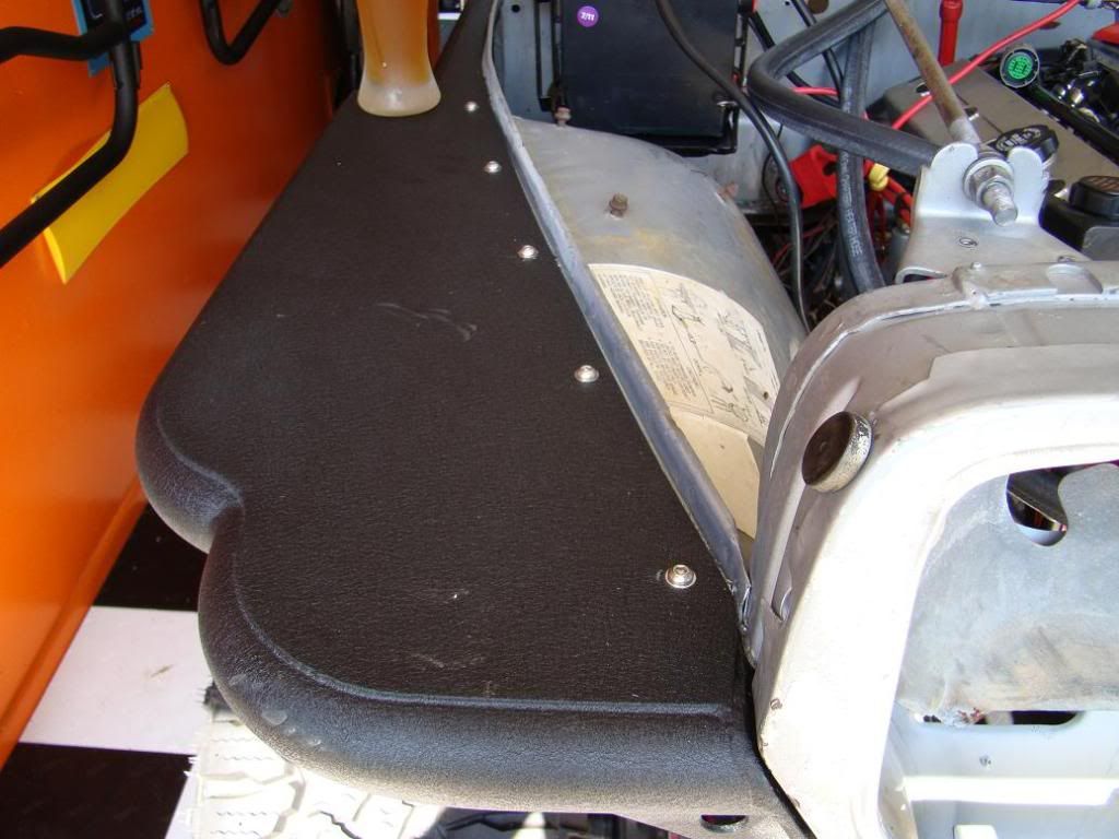

Spent the day removing the undercoating on the passenger side fender well...what a pain in the rear end..
Both fender wells mounted, note the dent on the passenger side fender....dropped it on my backyard side walk, nose first from 5 feet up....
Not sure I have enough room for the stuff I need to mount on the fender wells...
The beer is in the pic, who can find it??

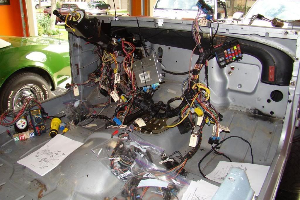

I spent the day identifying and labeling the dash harness, even though most won't get used....it's good to know what you have. I found 3 connectors on the passenger side that penetrated the firewall on the vette. You can see them on the right side of pic, I just connected them over the tub for now.
I discovered the dash harness is from a 6-speed vette, not an auto, that's going to leave me a little extra wiring to do.
Progress is being had, but I'm gonna have to post when my 6 yr old baby girl's not around, she insists on reviewing the posts...as evident below.....
