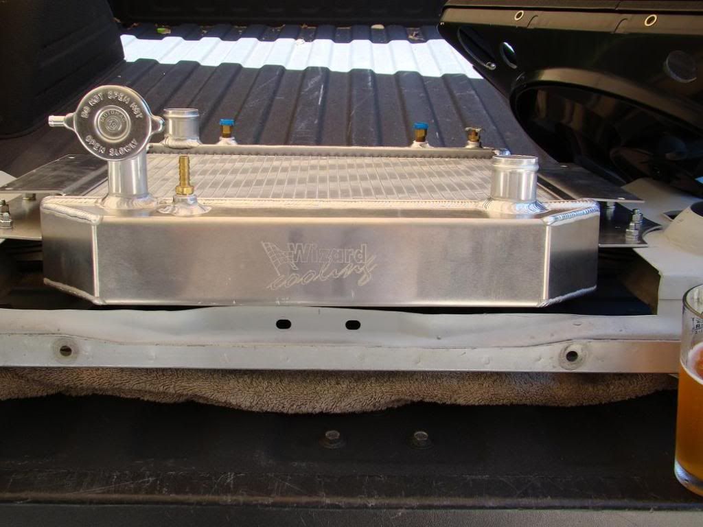

Finally, my drought in building this Jeep is over, unlike the current drought in South Texas... I took the entire week off to get something done.

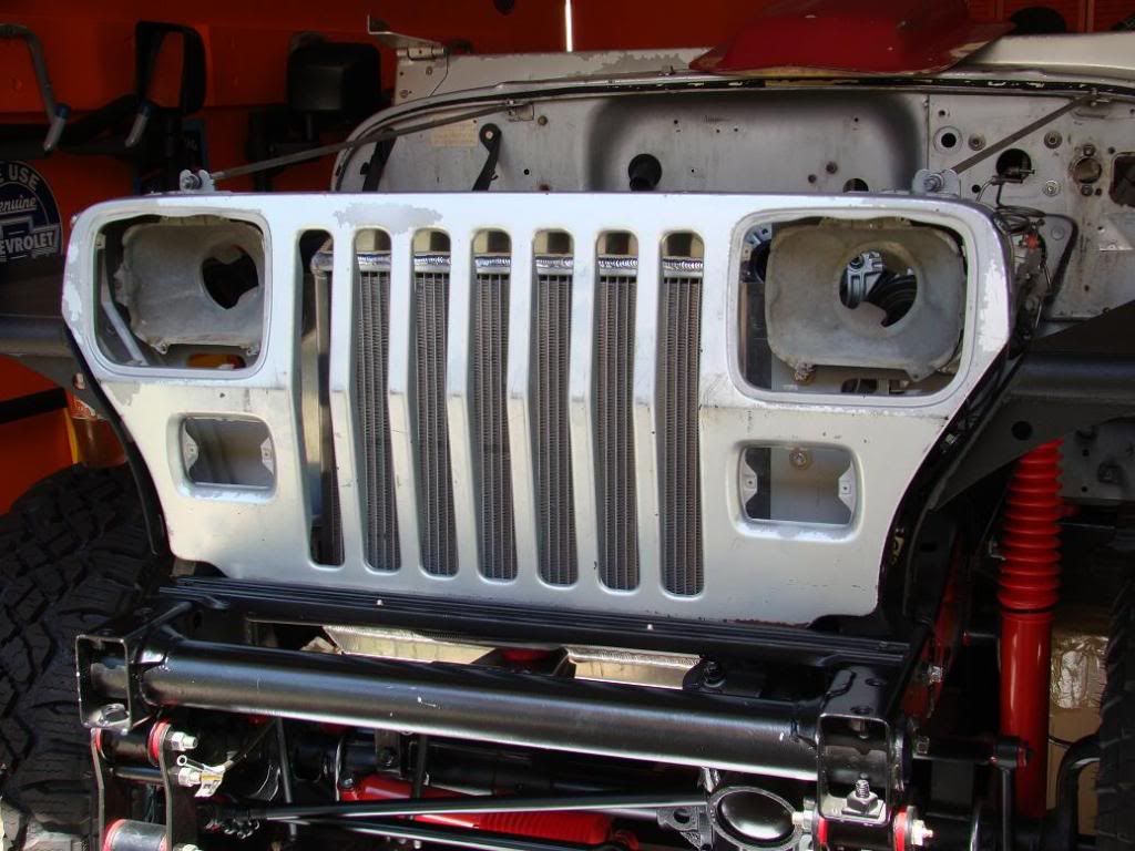

Got the tabs welded on the grill completed.
After I cut the mounts in on the new radiator..

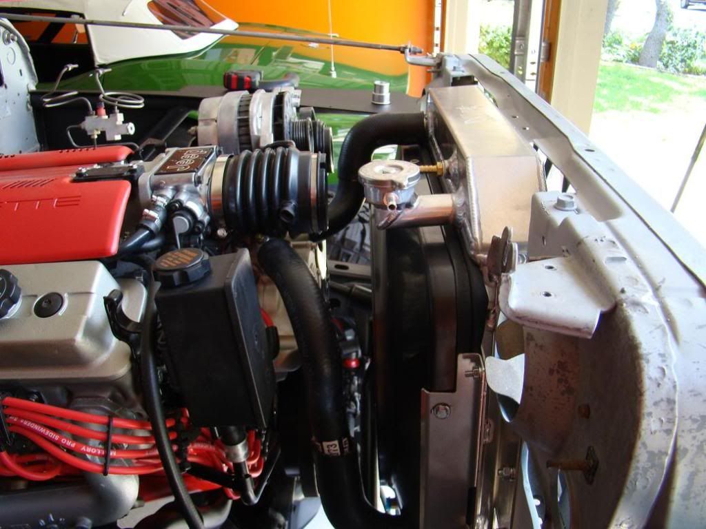

With the fan mounted. This fan fit the old radiator, I don't think I would find one anyway so I cut holes into the fan shroud to accommodate the lower radiator connections.
Front view..
Almost 4" of clearance !! , tomorrow I'll try and finish the hoses and tranny cooling connections.

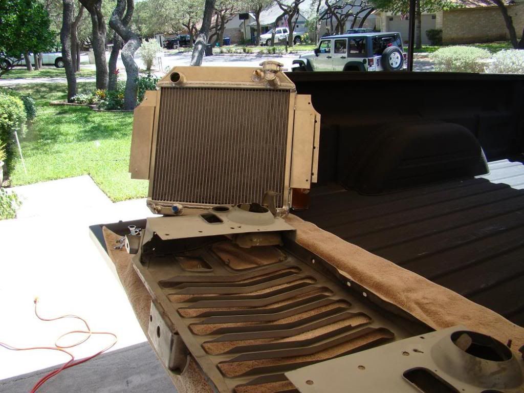

Picture is poor, but got the radiator hoses fabbed from 4 different hoses. I need to still get the splicers.
After setting the grill back on last night, I realized the fan shroud was hitting the steering box, with my lack of patience, I trimmed it off. I also extended the tranny lines out from behind the shroud. All I have left are a few minor details, and the cooling system is done.

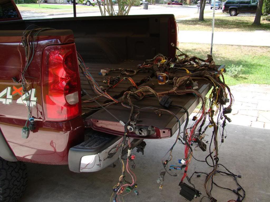

Spent the second half of the day stripping and cleaning off two harnesses, figured now that the major dirt and coverings are off, I can finish cleaning them inside the house where it's not 100 degrees.... It did inspire dinner thou... Spaghetti it is !!

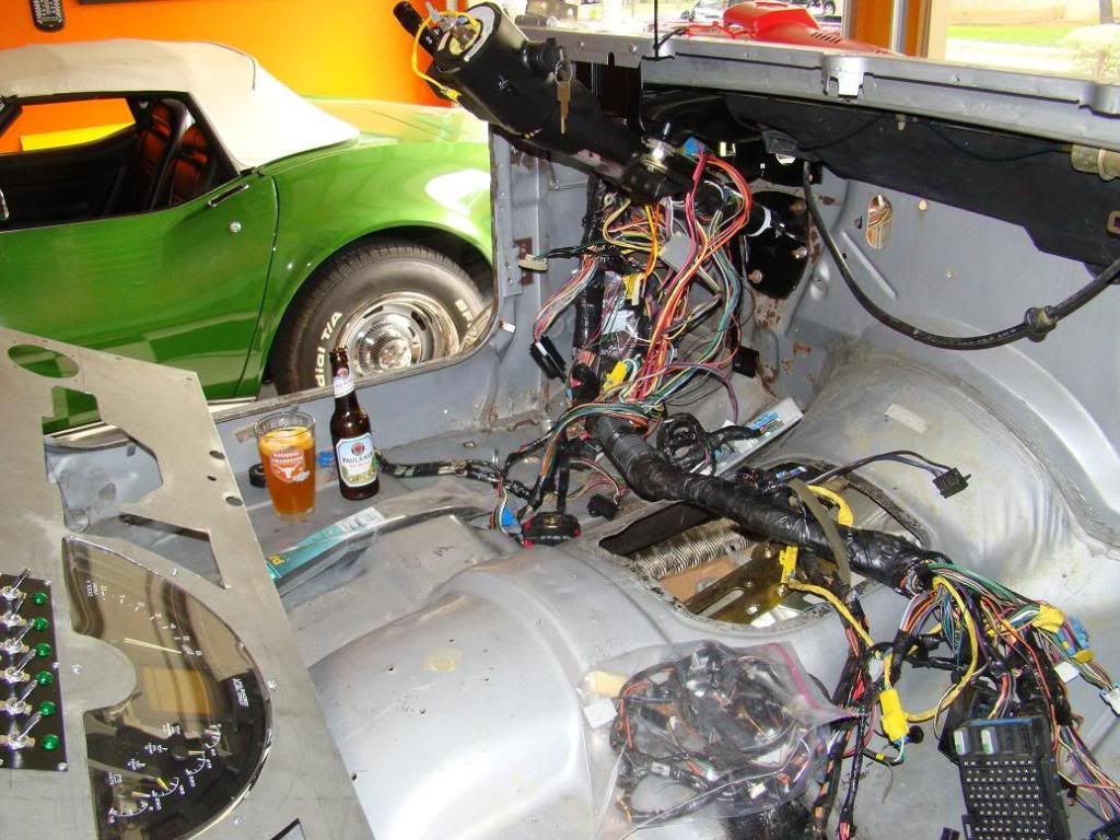

Another poor picture, but I got the engine harness temped in today, had to "restore" the oil temp. sensor with some epoxy, and I temporarily hung the computer off the firewall. My goal is to get the engine to turn over, if I can do that, getting it to run will be easy...
Rick
