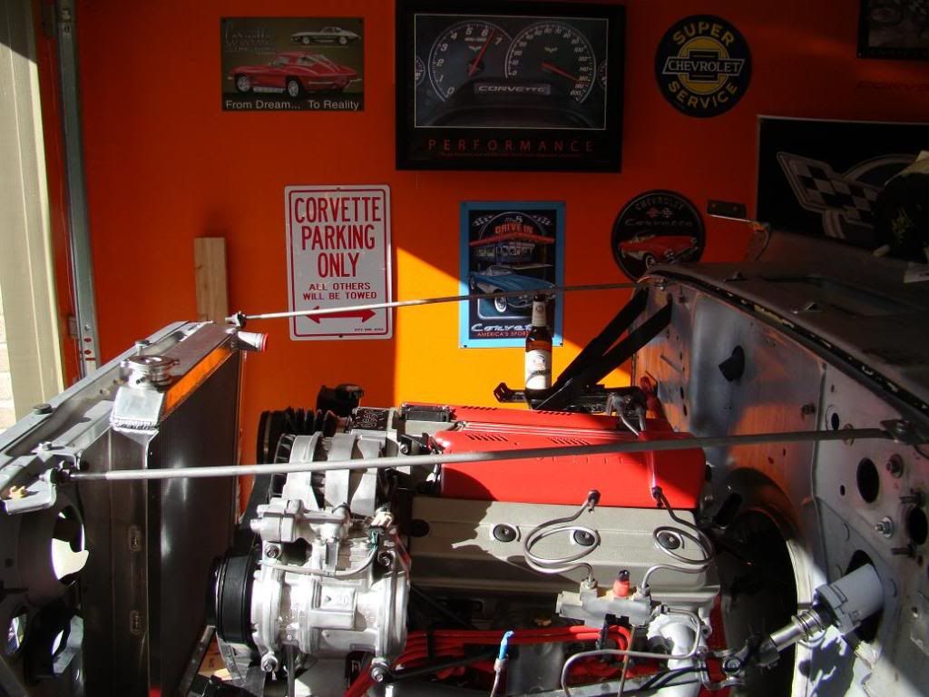

Got the radiator cap installed today, man that was a bi*ch, had to hold it with my right hand, keeping it perfectly level, then give 3/4 turn twist, but it fit like a glove.....
Cut the old dash plate up, added luann plywood for the start of my mockup dash...the 96' vette cluster sure takes up alot of space...
Here's the cap install
And the mock plate..

I see no beer in this one. . . Are you slacking on us, or am I really just missing it?
I have to say, that LT1 looks MUCH better in your Jeep than my LT1 does in my '93 Firebird. . . Yours looks new, mine looks like it's coming up on 175k miles. . .
I've been thinking of swapping a SBC of some sort into my YJ when the 4 banger dies, that's probably the route I'll go, that way I can have the best of both worlds. . . A capable 4x4 rig that will go anywhere, but can also get out of it's own way on the street. I'd probably see better gas mileage numbers out of a V8 than the I4 anyway. . . lol
I don't remember, and don't really want to go searching around for it, but what transmission do you have behind that LT1? 700R4/4L60E? Also, it looks like you are running an LT1 F-Body or Corvette steering column, are you also running a stock LT1 PCM, or did you choose to go with a standalone fuel/spark management computer? I have a TON of questions, but don't want to ask too many until I get a chance to read all the way through your thread.

It's a 4l60e, stock 96' vette column and PCM & BCM
Erdinger Hefe in the lower middle of the gauge cluster..

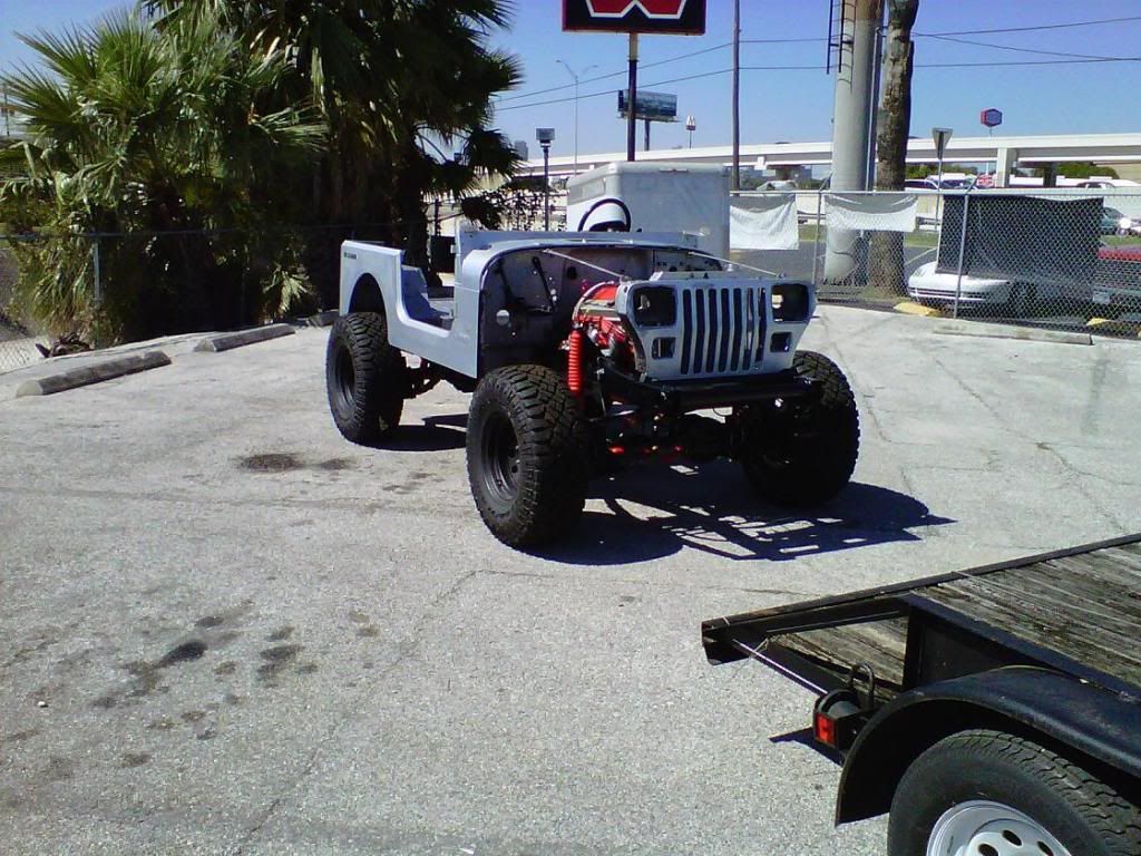

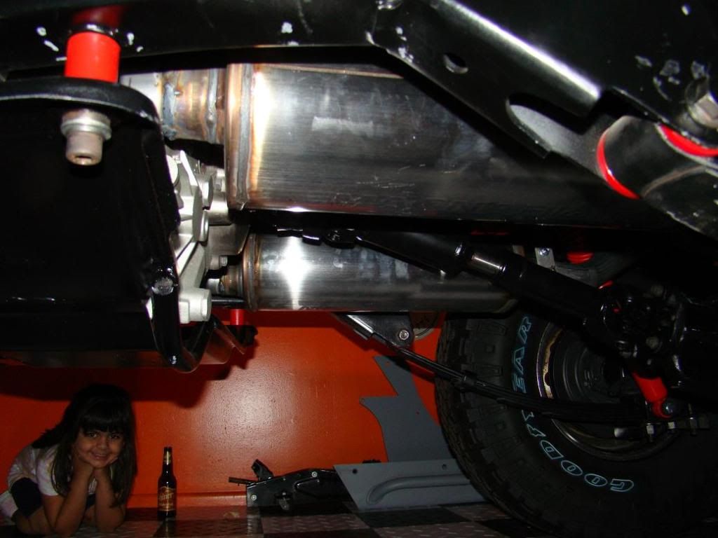

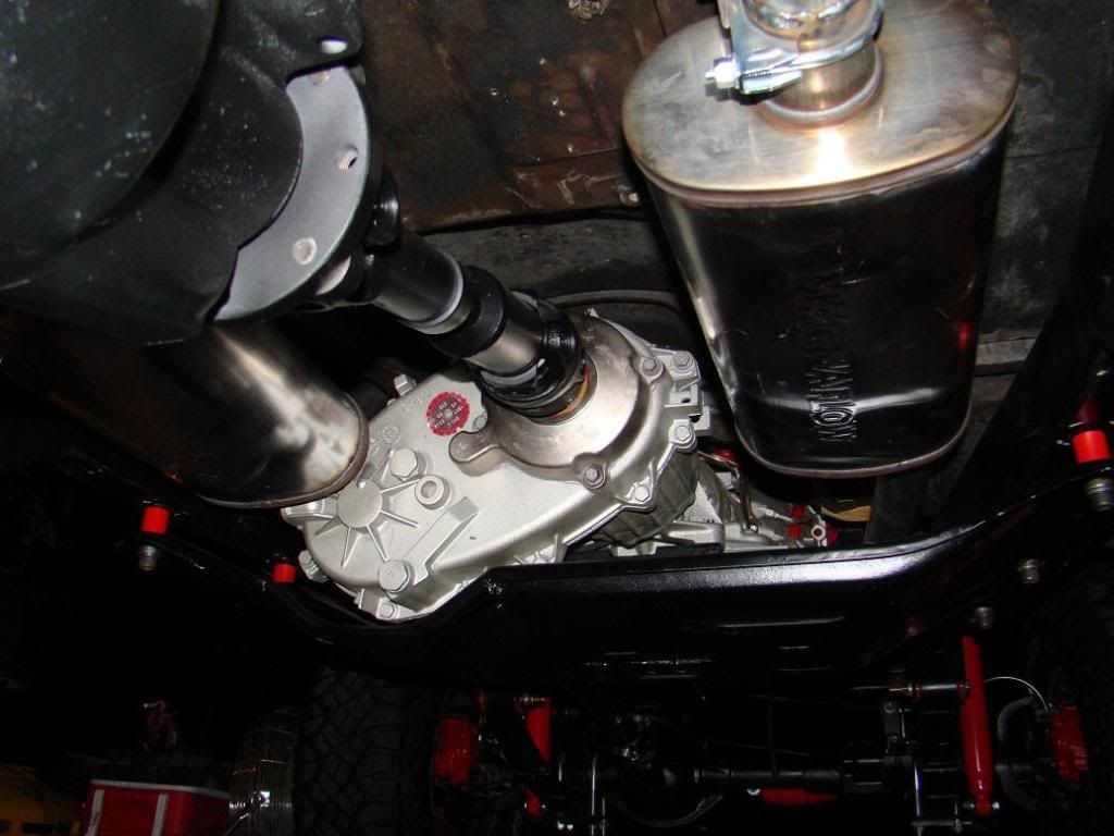

Got it back from the exhaust shop, they did an excellent job, better than expected, tail pipes run 3 inches back from end, everthing tucked up neat, nothing bolted to the body. Fair price as well.
If you are near San Antonio, Planet Pickup is the place to go IMO!!!!!
