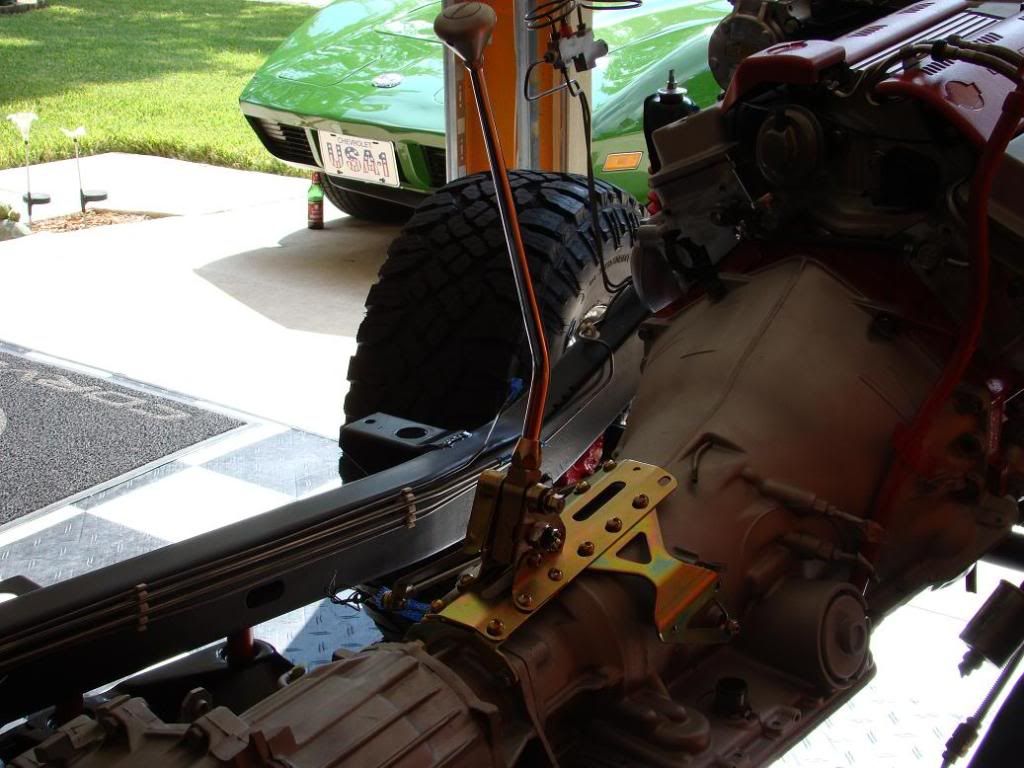

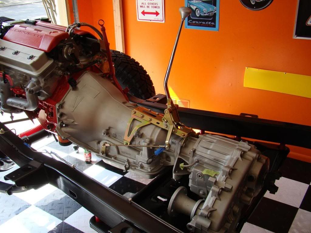

I need to make a linkage for the transfer case, I was thinking of using 2 Heim joint ends with a rod between, what kind of offset does everyone think is could push?
Looks like I'm about an inch and a half different on a 10" rod.
i did mine using the same shifter with the np241, it lined up straight on, the issue im having is if you notice the rubber bushing inside the bracket that will keep the shift lever in 4L and 4H, all the way forward and all the way backwards... when your in 2H or neutral it will very easily shift between the two, what i did was used a rod with a washer and on the other side of the bracket a washer and cotter pin. the problem with this is it doesnt like to stay in 2H, with enough driving and vibration will go right into neutral... i believe to correct this problem im going to need to find away to incorporate the little green grommet that was originally used in the shifter linkage, i think thats what keeps that it in what gear you shift it into. or make some sort of detent to keep it from moving between the two
I remeasured and it looks like a 1/2" offset, 1 think i'm good as far as that goes...there is a 98' chevy down the street, I'll try and crawl under this weekend to look at. maybe bring a wrench lol !!
No, wouldn't help anyway, the T-case shifter I mounted is not the same distance away.... I order a couple of heim joints and I'll just cut a threaded rod to length.
