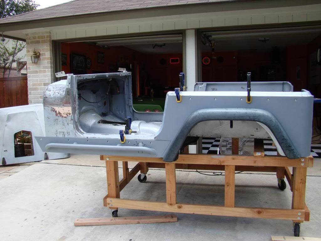

Messed with the tub a little, seeing how the armor will fit with the TJ flare. Also stripped a little of the paint off my "worried side" A little more bondo than I hoped for... Not sure yet what scheme or color to go with.. Not even sure what flares to go with.. I like the Metalclock stuff, but for the price, I might get my buddy to fab....
Rick

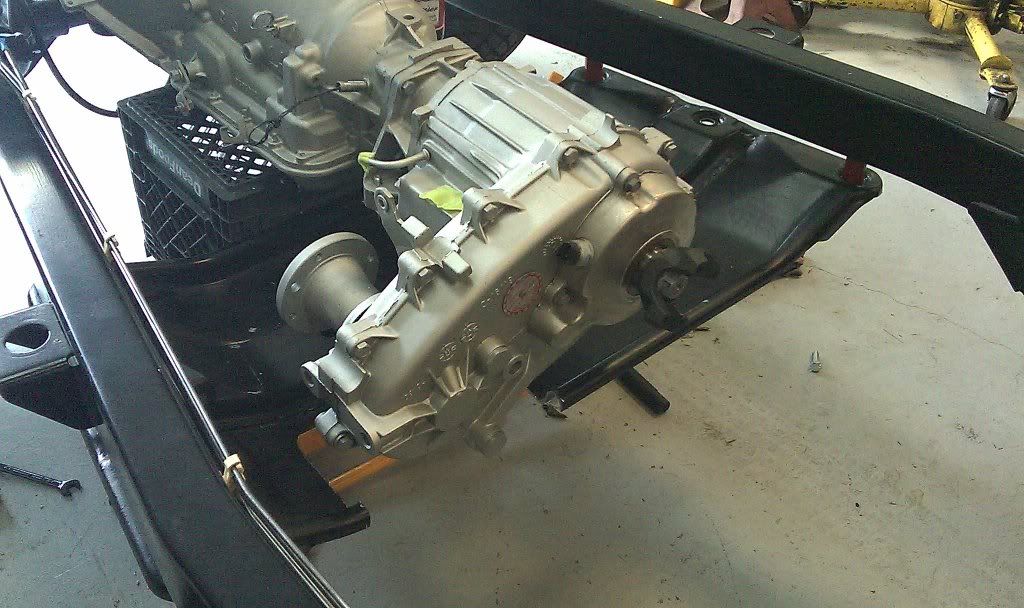

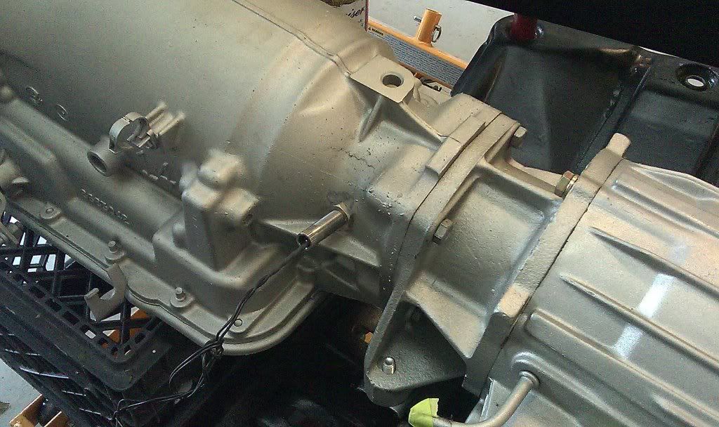

VSS installed.......
I'm cutting the skidplate, engine angle will be at 5%, Going to fab a skidplate over the cut out portion under the transfer case.
Rick

Dang, is that thing sitting really low or what??
The T-case is actually about 1/2 above the pan, but was hitting the back lip of the skid plate. I'll box the hole in about 2 inches below the pan.
Rick

Yeah, I saw where you said that - but I was mentally comparing it to my swap where we only had to cut the back lip off and none of the plate itself...
What motor mounts did you go with? I'm sure its in the thread, but this way I don't have to go back and search. Just wondering if the motor itself sits lower than mine did. Because I was a little leary of how close the balancer sat in relation to the front pumpkin. Then there's the exhaust too. It's close up there.
You can't tell from this pic, but it's close.

I went with the advanced adapter cradle. It might sit an inch higher than I liked, but the overall drive train length kinda dictated it. It looks like on on your skid plate, it's cut in the middle front, you must be running a different t-case as my was hitting the driver side rear.
Overall, I think this will work for clearance and drive-ability due to drive-shaft angle, with the the 4" lift. I also added back the 1 1/2 skid plate drop.
