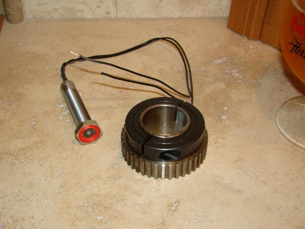

Got the VSS in today from Novak, waiting on them to send the instructions, don't want to drill a hole in the tranny not knowing what the hell i'm doing..
Might get to install it over the weekend, scheduled some vacation next week hopfully to get some work done on the build.

Got the instructions from Novak, taking it to a buddy to install, not comfortable drilling a hole in the tranny myself.

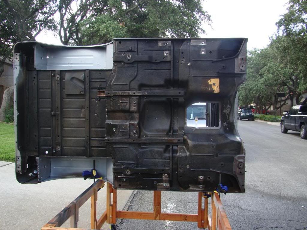

Restored the rear wiring harness and power washed the underside of the tub.

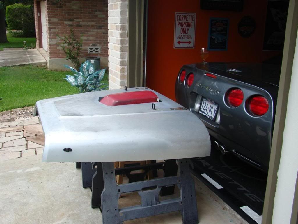

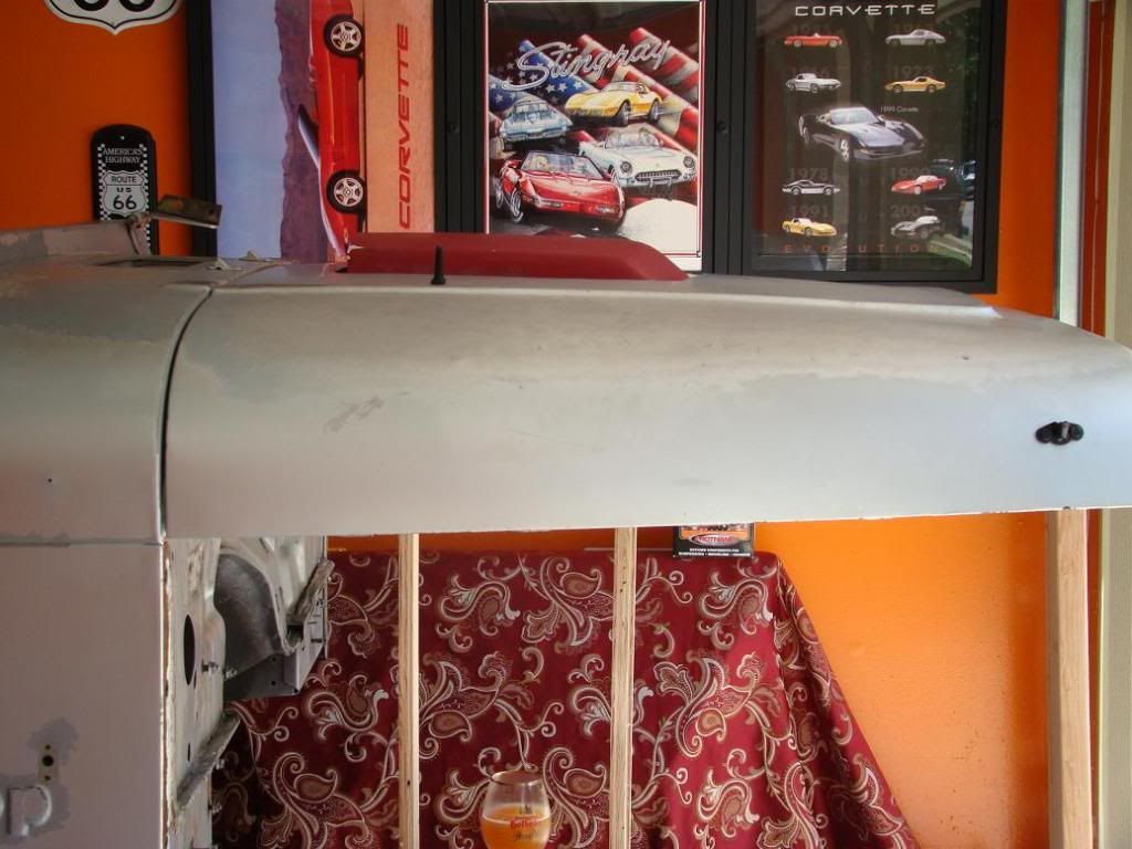

Nobody get excited, this is just a test hood.............
I can set the depth or rise anyway I like, It would be a functional shaker
Rick

I doubt your Jeep needs anything more to make it stand out, but I can dig the scoop as long as it is providing some function. Helping the engine breathe and cooling underhood temps are good things. Now move that thing away from the vette before you scratch it!

The rolling frame is over at a buddy’s shop getting the tranny mount fabricated and the rear axle angled up, still can’t weld… He is also installing the speed sensor, don’t have the balls to drill a hole in the tranny myself, I would rather pay than play on this one ……

I'm late to this build, I'm getting ready to por 15 my frame and was wondering when you prepped your frame after sandblasting did you marine clean, rinse with water, metal ready rinse with water, dry then spray or brush on por 15? I'm just nervous about putting water on a bare metal frame. Your frame looks great that's why I'm asking you. Also what primer and topcoat did you use?
winning is offline
post #225 of 1295 Old 08-04-2010, 06:07 PM Thread Starter
mavrick331
1987 YJ Wrangler
Location: San Antonio
Posts: 591
I prepped with metal ready then rinsed with water, since I had sand blasted 100% to bare metal, I got sand in the frame. I blew most out with air before metal ready, but the metal ready left a film I didn't like. So I rinsed for 30 minutes with water and wiped dry. It did leave a light surface rust, but don't worry, It's actually better for the Por-15 to adhere to. You can see the rust on the bare frame below.
I brushed it on and it left ZERO brush marks, it fills nicely...After a light sanding I primed 3 coats with a 2 part epoxy primer from Sherwin Williams automotive outlet, don't remember the make. After another light sanding I top coated with Eastwood's extreme chassis black, 2 coats. I think I could hang the frame at the coast for a dozen years before it rusts...
