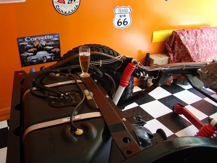

Originally Posted by shoreline View Post
Heh Rick - what fuel tank did you use?
It's a stocker from and 89 4 banger, with the baffle in it.

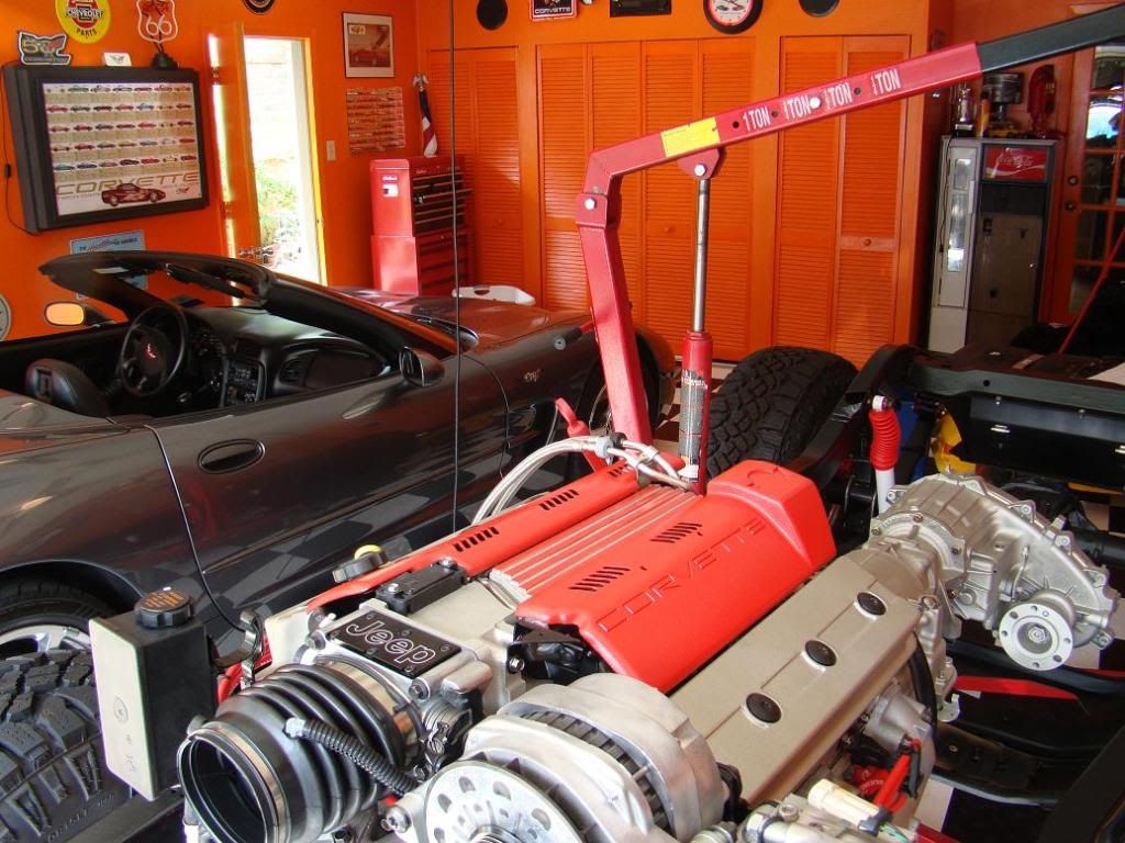

A liitle more engine detail
Ok, JEEPSTERJCS, this is where I need your help. A buddy came by and asked, how are going to steer it........ Looks like I might have any issue with the steering shaft, without the tub on I don't know. Did you have an issue with this?? You can see the steering box, not much room for the shaft?
Rick

post #185 of 1295 Old 07-03-2010, 07:32 PM
ajs96
Location: Texas Hill Country
Posts: 84
Rick
Look at this video link, there doesn't look like there is any clearance issues at all on this one
YouTube - LT1 V8 JEEP WRANGLER (YJ) CORVETTE ENGINE

Thanks....98% of the work was done elsewhere thou. Good news on the steering, looking at another early YJ, I have about 1/2 clearance.....beeter than zero.
Rick

If you do have clearance issues, you can run the brackets and accessories from a Camaro/TransAm as they are on the pass side. It would be to bad as you have done so much to make those look better than new!

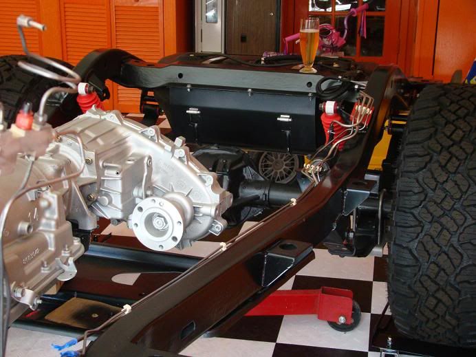

Got a liittle more done, fuel systems and some of the brake lines....

What about moving the angle of the engine/trans and trans case down towards the back more to help with the angle to the rear axle. Naturally this means moving things as needed but since you dont have a mechanical fan it shouldnt be as much an issue to do this. Sorry just thinking out loud.
