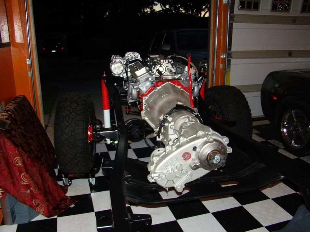

Happy Fathers day to all!!!
Got the transfer case mounted and the rest of the emissions...

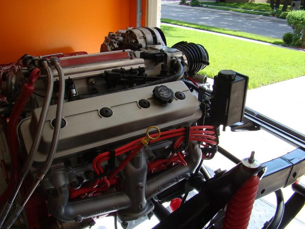

Does it matter where I place the fuel filter, near the engine like the vette, or at the stock Jeep location?
Thanks,
Rick
Plug wires on..
More plumbing...

I had mine on the inside driver's front fender.
Hi Rick, Just saw your answer above about your flooring. Thanks for the info. I put down a white epoxy and with all the heavy work and welding going on it is scratching/chunking up pretty fast. Oh well.
I put the filter up where I could work on it, it would stay cleaner and not get snagged by bush that I always seem to drive through. Also, I only used metal to barbed to rubber injection hose and double clamps so I could routinely check the condition of the connections more easily with it up under the hood.
