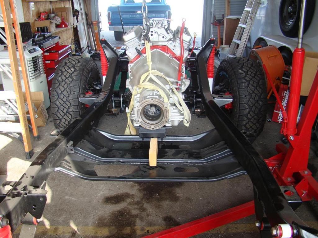

I recently found an 87' YJ sitting behind a storage facility in fairly decent condition, has hardtop and doors and half steel doors, no soft top or engine. I tracked down the owner and convinced him to sell it for $1000.
I plan to make a daily driver out of it, but I'm going to start from the frame up, from there I’m still up in the air....back with a 4.0 inline 6, or small V8. Would a small V8 be practicable for an everyday driver? I don't plan on heavy offroading, mild at best (getting too old).

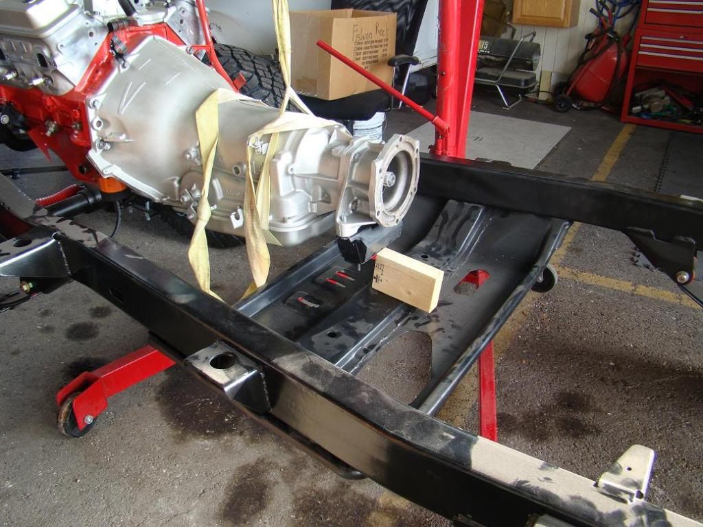

Would you consider changing mounts at this point to gain some room up front?
As an LT1 swapper (in my S10) I screwed up by putting mine too far forward and really struggled for years with fitting fans up there and still trying to run an A/C condenser. Like you said, there's plenty of room to move back, so why not do it?
Once you cut your driveshafts it's too late to go back (for free, that is) and then you gotta think about exhaust too. So get it in the "best" position considering ALL options (clearance on both sides, back AND front). I would say even if that means getting different mounts!!
***EDIT***I just looked back to see that you have your driveshafts cut already...so...SORRY for the bad luck!! LOL
Correct........ driveshafts are mounted, and exhaust will be done by the morning. I had a few comments of "why did you use the cradle, you get better placement using weld on mounts?" Should have listened...running a rear distributor, this mount would be perfect. Live and learn :brickwall
I still have other fan options, and still might be able to make the Mark8 fan work..........
