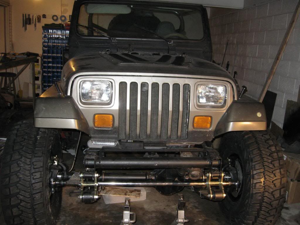

AHHH. The long awaited stance:
In between my build my roommate decided e wanted to do his ball Joints. This is how it looks when you don't really have all of the tools necessary to get the job done. Needless to say we got them out but had to run to autozone to get the balljoint tool to get the new ones in.
Time to get the front diff sealed up ad fluid all round. That would be my Yukon ZIP AIR locker. The things pretty sweet.
Now is about the time that **** really starts to hit the fan. The end is in sight. I'm waiting on a few parts to finish her up. What I'm trying to say is my pictures and documentation are getting more and more lax. And I failed to take any pictures in the building of this:
BUT it was pretty simple. All it is is an X across the roll bar. You can use you imagination on how it was made.
After a few months. (was only supposed to be a few weeks)
Got the jeep running so what else to do than flex it OUT!!

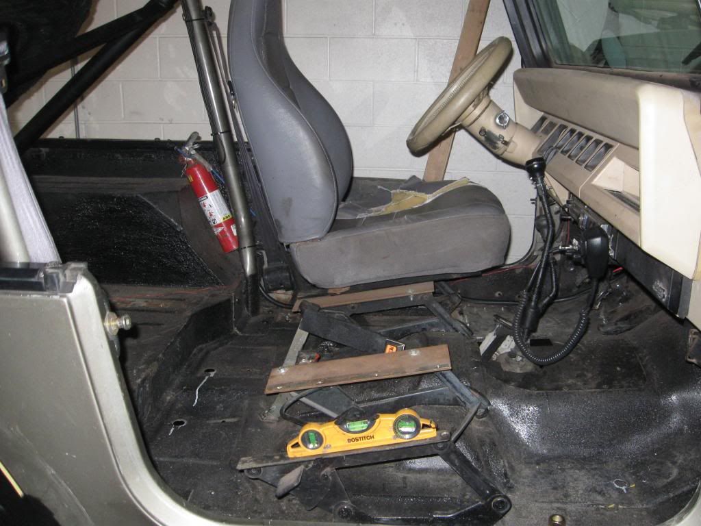

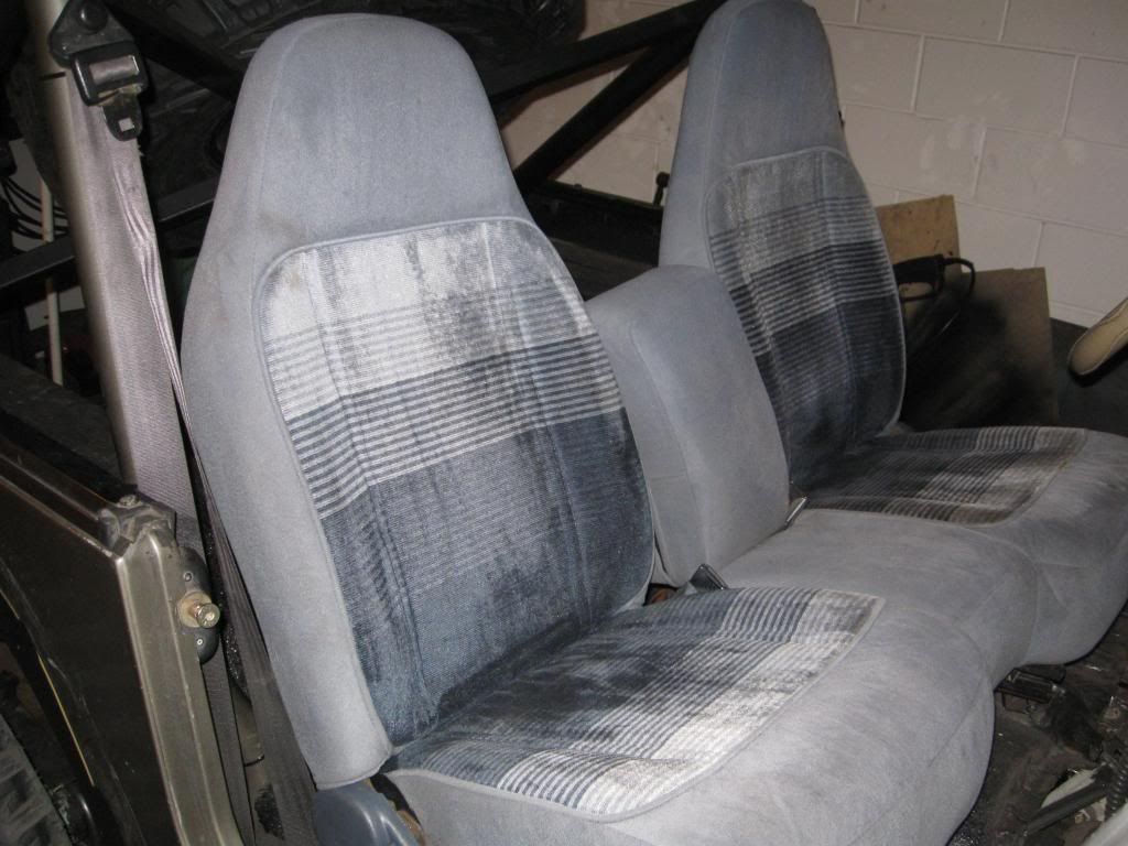

Now that the YJ is moving under it's own power I can focus on the more cosmetic items on the list. I have always wanted bucket seats in my jeep. Don't know why. So I snatched myself a pair of 60/40 seats out of a 96 ranger. They looked pretty good until we got the pressure washer out to clean them. Turns out they were pretty dirty.
AGAIN not much in the way of documentation for installing the ranger seats so this will have to do.
The seats were said to bolt in to the existing YJ mounts. BUT they didn't. Well the could have but my head would have been over the windshield. What I ended up doing was built some little platforms out of square tubing. then was going to set the seats on there. Only problem was the platforms I built were still too tall. (word of wisdom here thoroughly test fit all parts before welding them onto your jeep) So I had to cut the platform out and make a shorter one. All in all it worked out pretty well. Took me a day to do but couldn't be happier.
