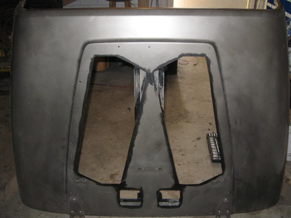

Time to gt that 9" prepped. I got a little a head of myself here. I primed the axle before I welded the perches to it. No big deal just have to grind some primer when its time to add the perches.
I just couldn't help myself. It looked so goo sitting on the workbench I just needed to add some primer. I also kind of screwed myself. When I put the permatex on the third member I just put the regular non hardening gasket goop rather than the ultra black which is supposed to be the Bees Knees. So I pulled it back apart and replaced the goop with some ultra black. Probably didn't have to but if I got it all together and it leaked I would have been pissed!

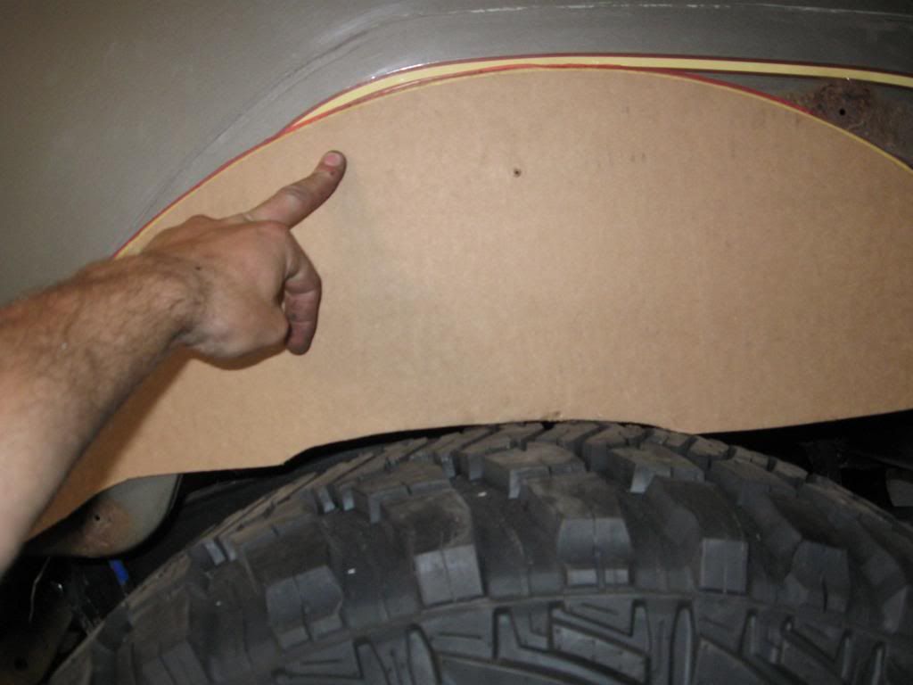

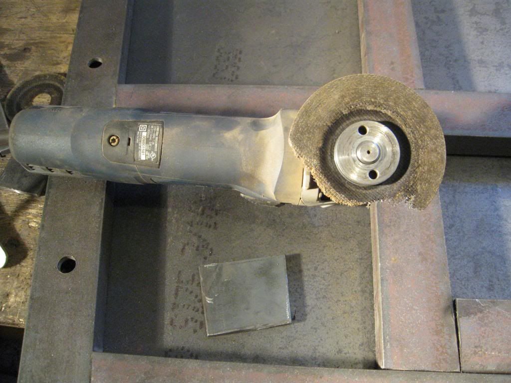

I used a dremmel, a cutoff wheel and a flap disk to make the holes. The flap disc works great to smooth out the edges. An actual LED taillight shot is yet to come.

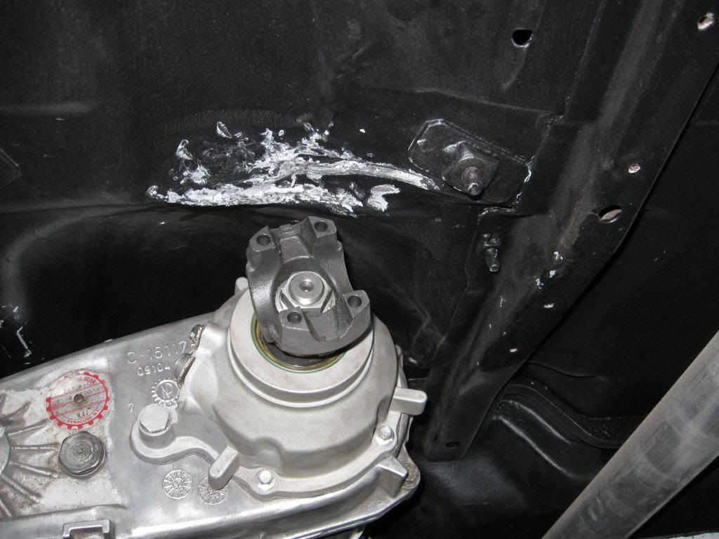

Time to start in on the tcase SYE.
The JB SYE output shaft (left) and the OEM one.
Got it all buttoned back up. Look at how shiny it is.
The SYE kit took me two nights after work to complete. About 8 hours. but that includes cleaning the case and getting side tracked. Overall it was not too bad. I did however have to cut my fork rod down a little. (89 tcase)No bigge but I wanted to make sure it was right before I cut it.

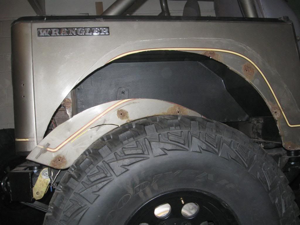

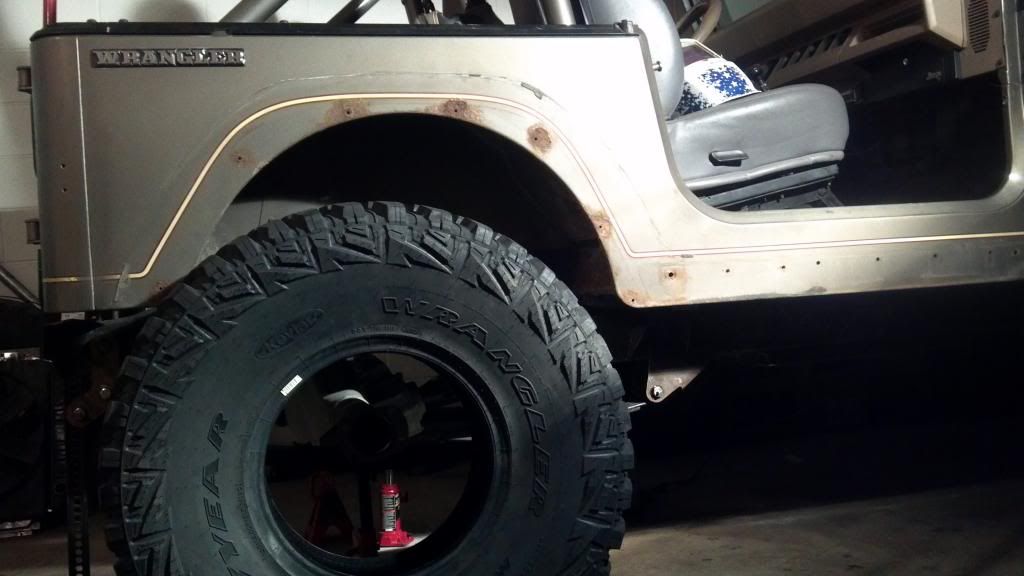

Once that was done it was time to remove the flares.
A little rust. Nothing too concerning. Actually REAL good for a WI vehicle.

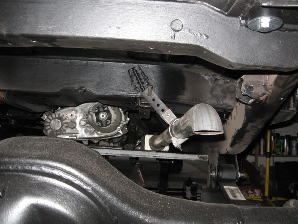

Got my new TJ head pipe.
This will get rid of the stupid under the tranny YJ exhaust piping.

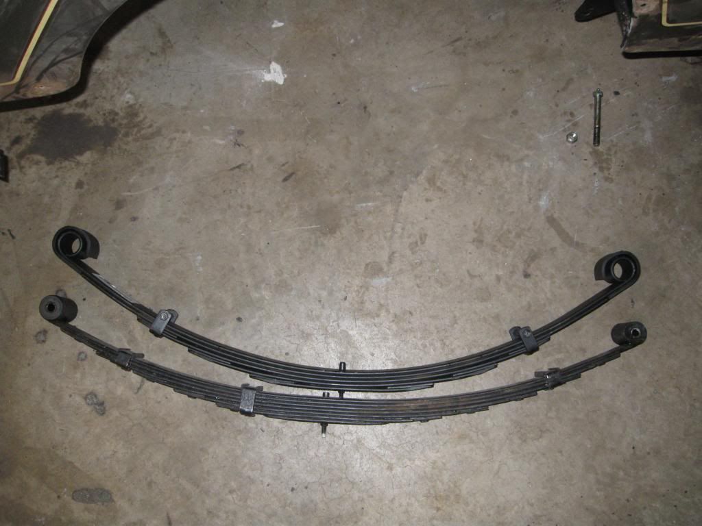

Here is a quick side by side comparison of seemingly 4" lift springs and the Waggy springs.
Just about 2" longer
1.5" lower
And a 2" offset pin. Hence the stretch

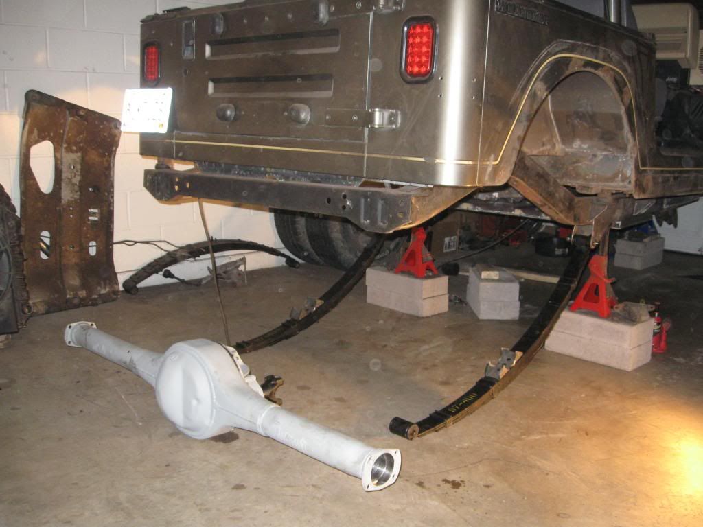

Here it is the first mock up of the Ford 9". I like how it almost glows.
DAMN thats WIDE

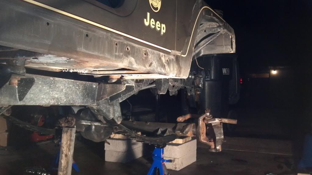

OHH. The dreaded rusted body mount removal procedure. Only had four real bad ones. 4 out of 11 isn't too bad. Right?
Somewhere along this point I realized I wanted to clean the entire underside of the Jeep tub AND frame. Then prime and under body coat the whole thing. Just to fresher er up a bit.
Removed the rusted rotted floor section under the drivers feet.

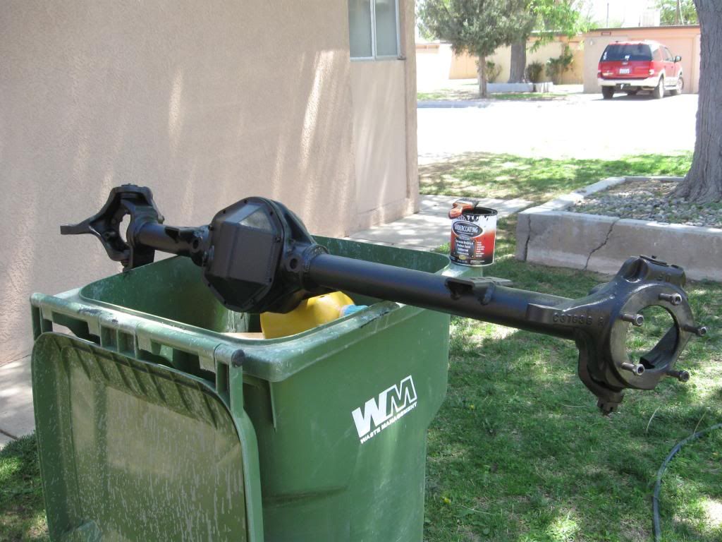

TADA!!!! Everyone meet my new front axle. Its a High Pinion Dada 44 out of a 78 F150.
I really lucked out with this one. Went on craigslist. Found it. The guy was asking $500 for it. Drove there gave him $360 and drove it back.Good buy in my book. And now I can stop worrying about finding my HP D44.
There it is getting cleaned up and taken apart.

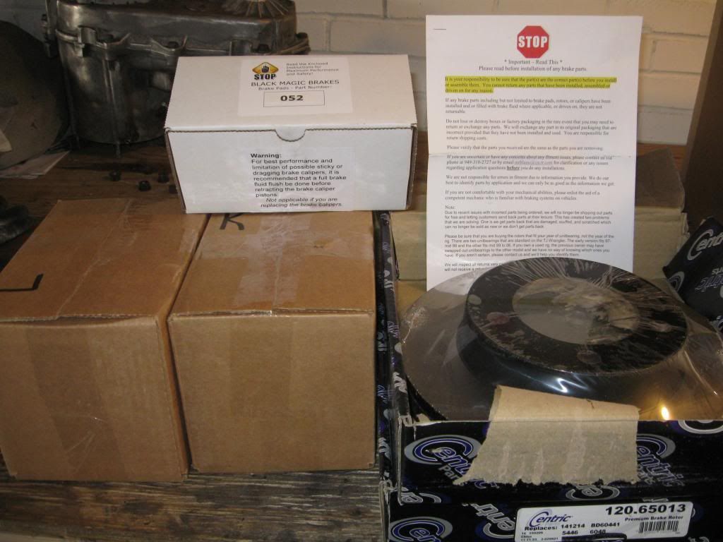

Got my Black Magic brake kit in for the 44
Lets see how these things work

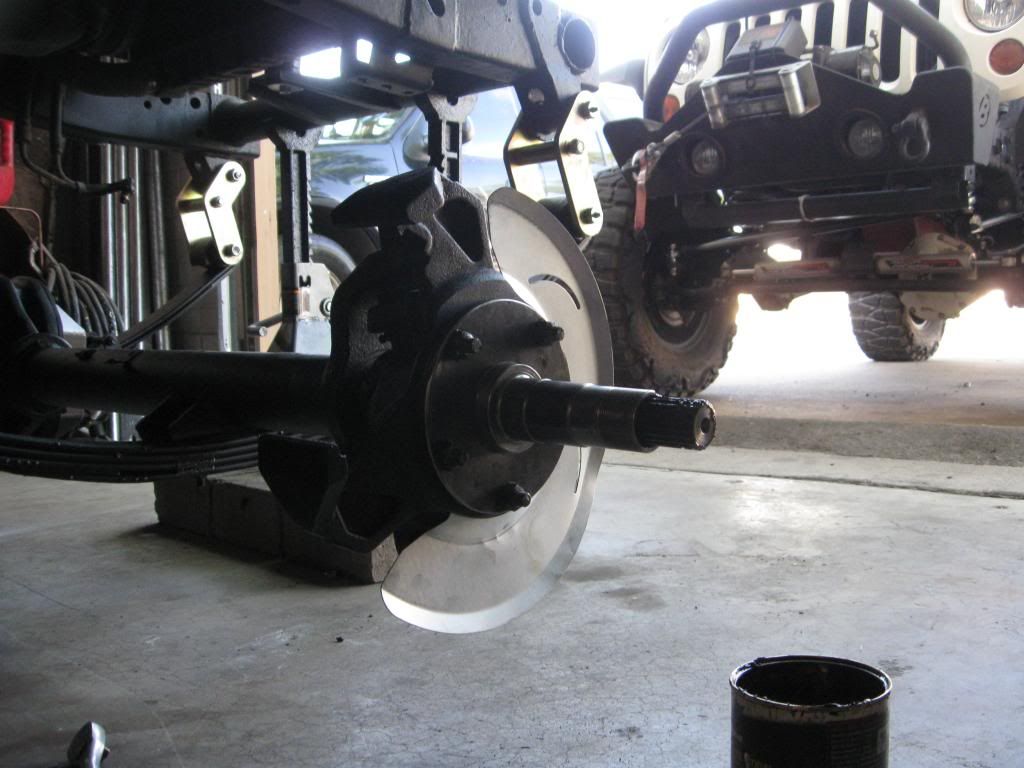

The point of no return....
AKA. HP D44 test fit.

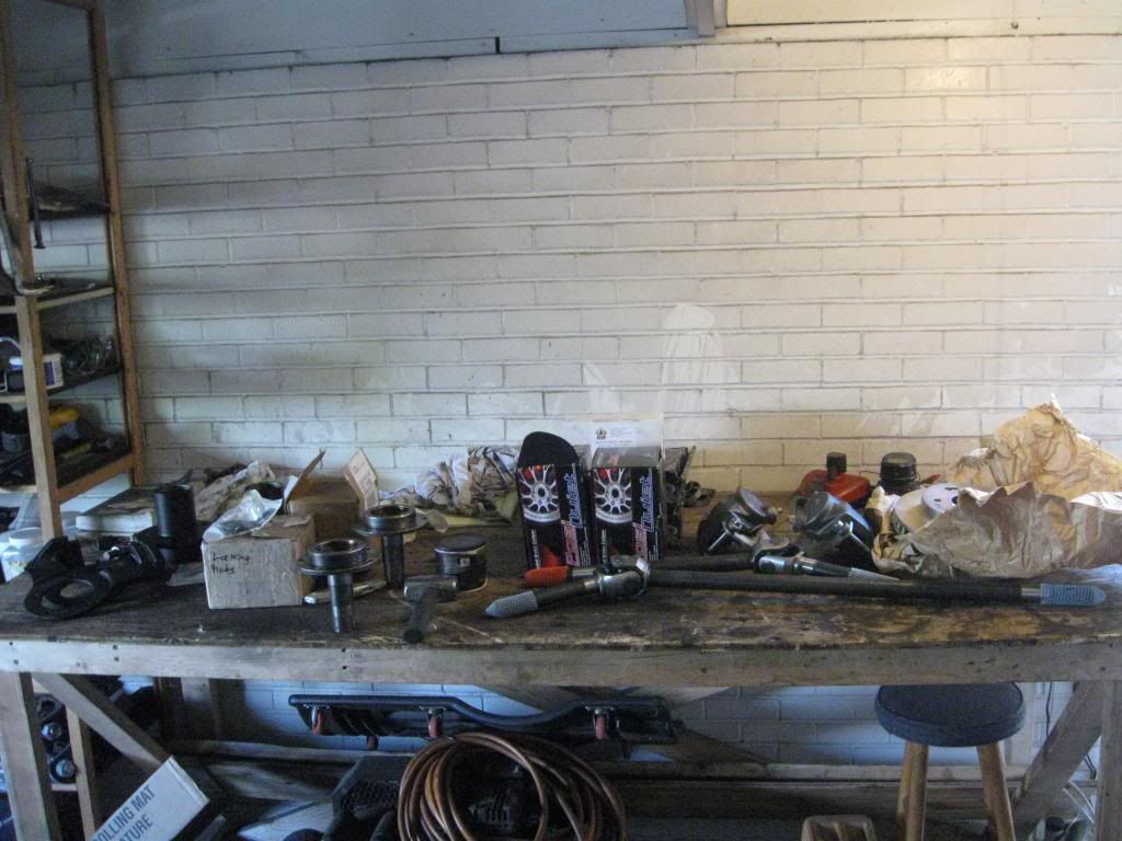

The workspace. It's getting cluttered up.

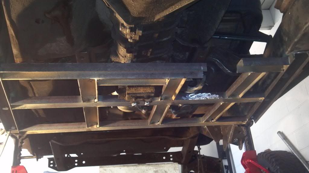

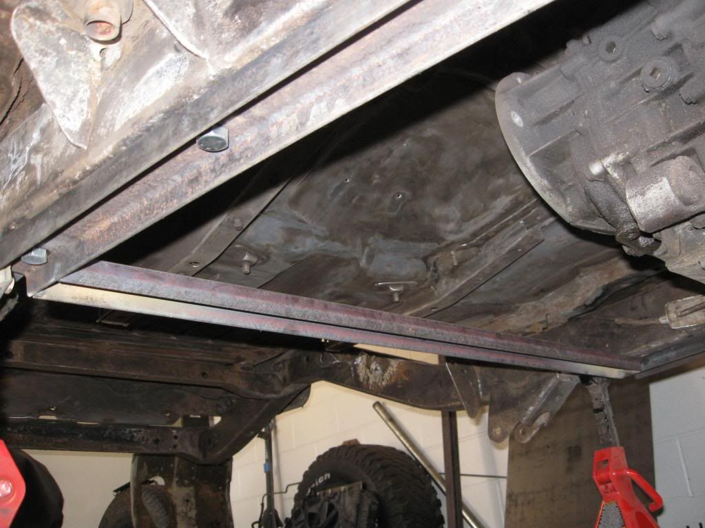

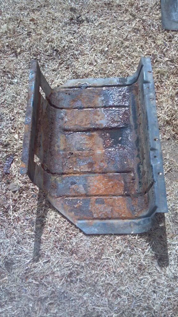

Here's a shot of the old tank skid. It's rusted through in a few places. The original plan was to add some angle iron reinforcement to it. But Its in rough shape. So A Warrior Products tank skid was ordered instead.
Either skid will have to be modified to allow for the stretch.
OH man! Here.s what happens when you are drilling a 1/2" flat belly skid mounting hole with a 18V cordless and the bit catches when you least expect it...
Good thing I was wearing safety glasses

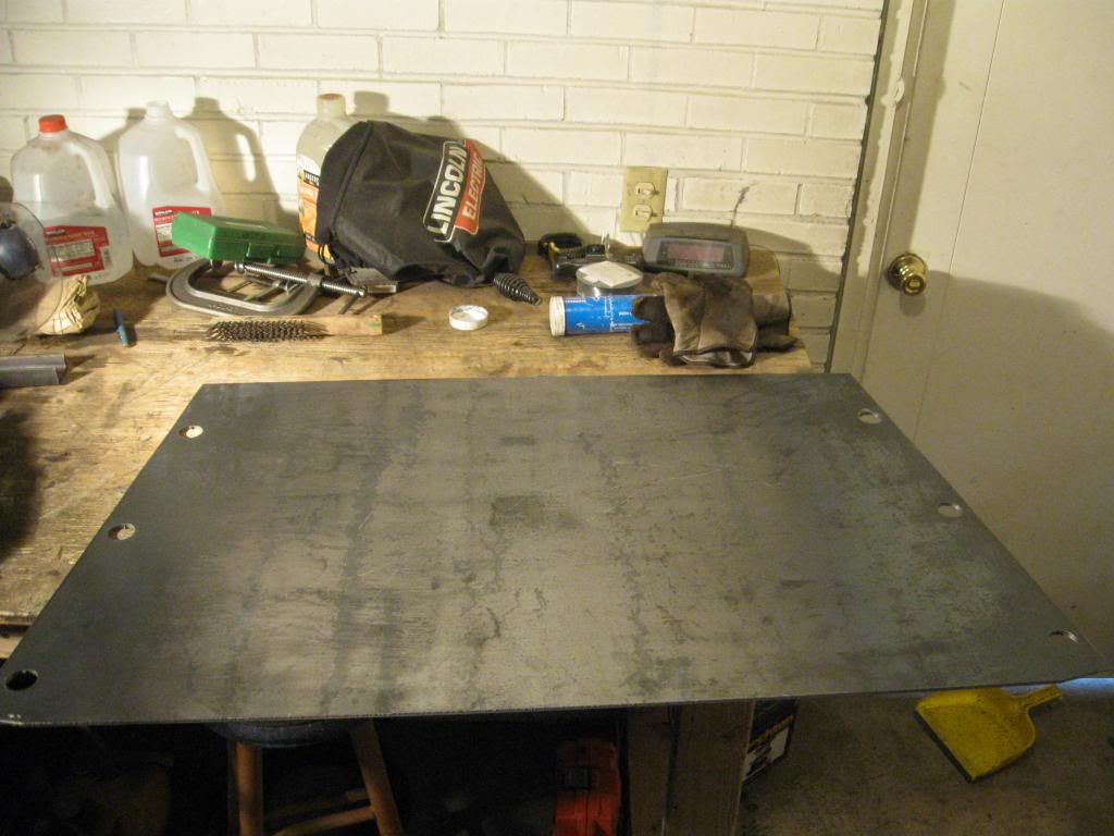

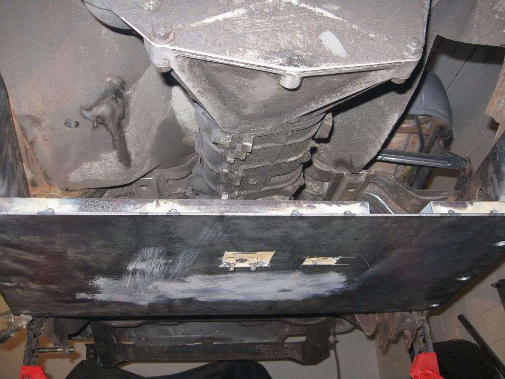

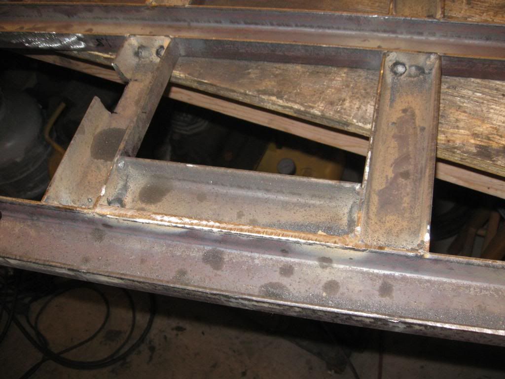

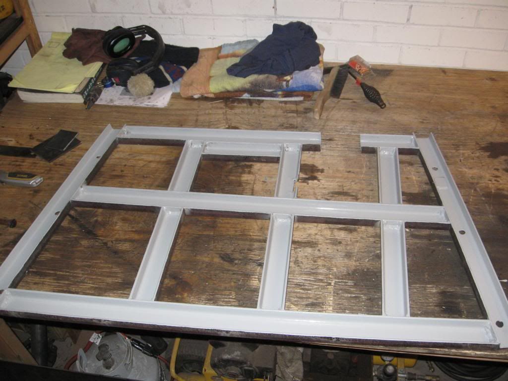

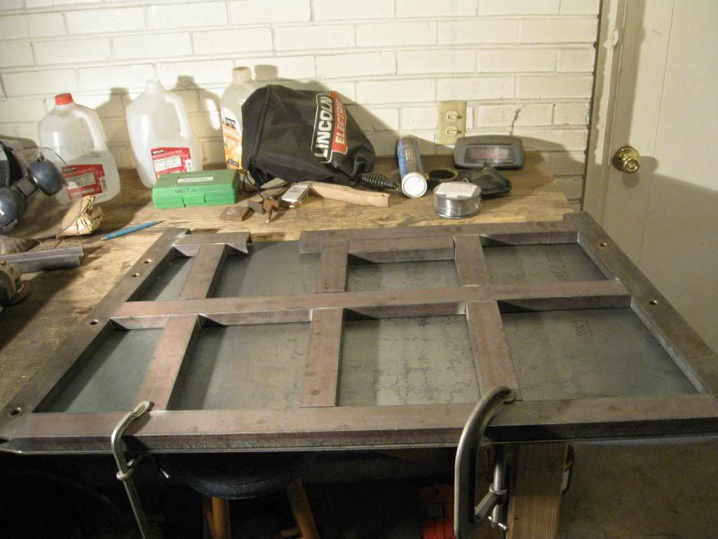

Time to start on the flat belly skid. Measure the mounting holes. Drill them. (in the correct places) and start tacking the frame together.
And pretty soon you have a flat belly skid frame built.
Throw some sheet metal on there. Hold it with a vice grip, and a c clamp or two.
Mark and cut off excess.
Now things start to take shape.
Counter sunk holes to hide the bolt heads.
Keep in mind I am doing all of this with minimal tools. Angle grinder, drill, and borrowed 120V wire welder form work. Ans as to be expected with minimal tools come technical difficulties:
Add a little beef.
Prime the inside of the channel:
Get the tranny mounting holes cut in it.
Tack on the mounting plates.
Then wait until a friend who knows how to weld can finish it up with some good beads.
All in all the flat skid plate was pretty easy. Pretty straight forward. And should do the trick. And this thing is heavy duty. Should hold up to a lot. Better it weights 86 pounds.

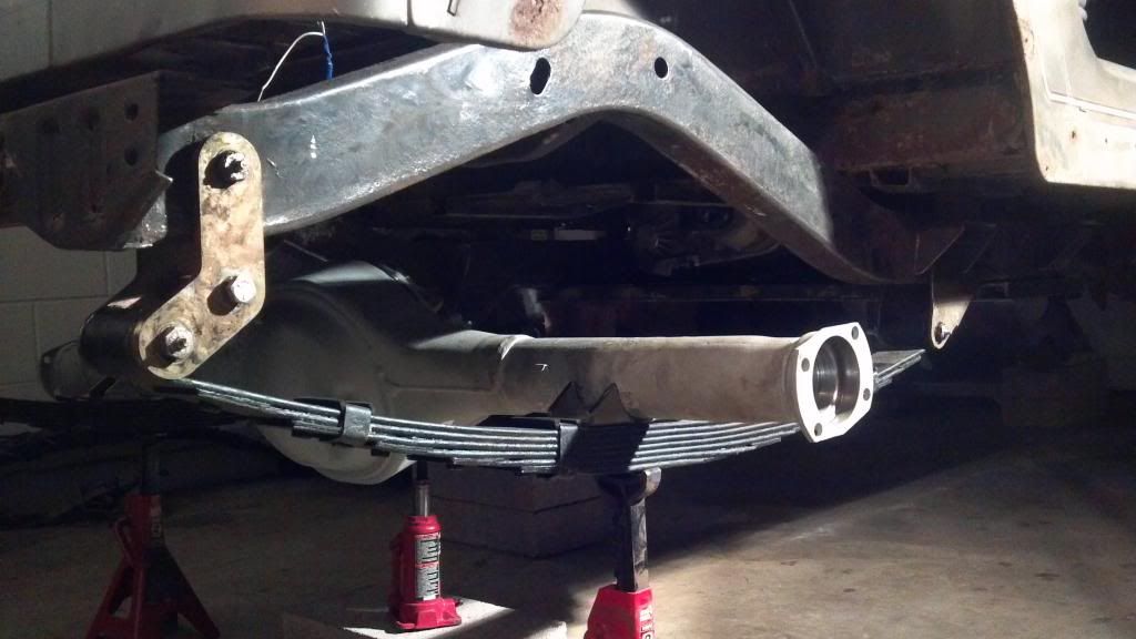

Getting the 9" under to take a look at how she looks with it under there.

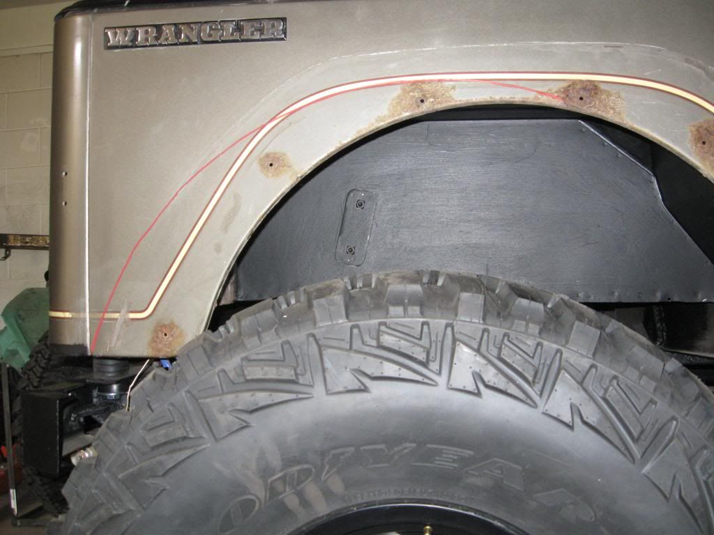

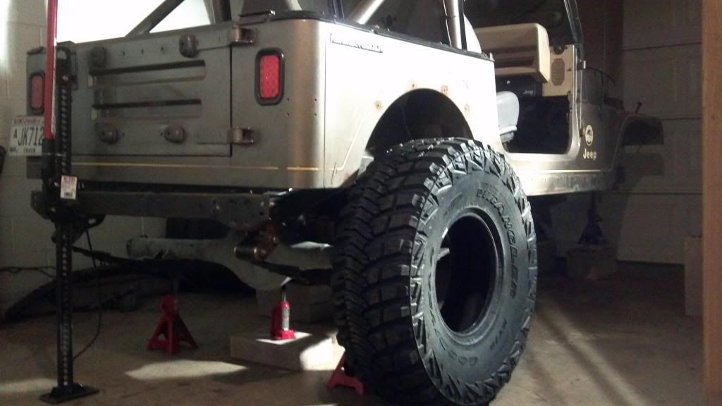

Mocking up the tires to get a feel for how ittl look.
Looks like I'll have to cut some...

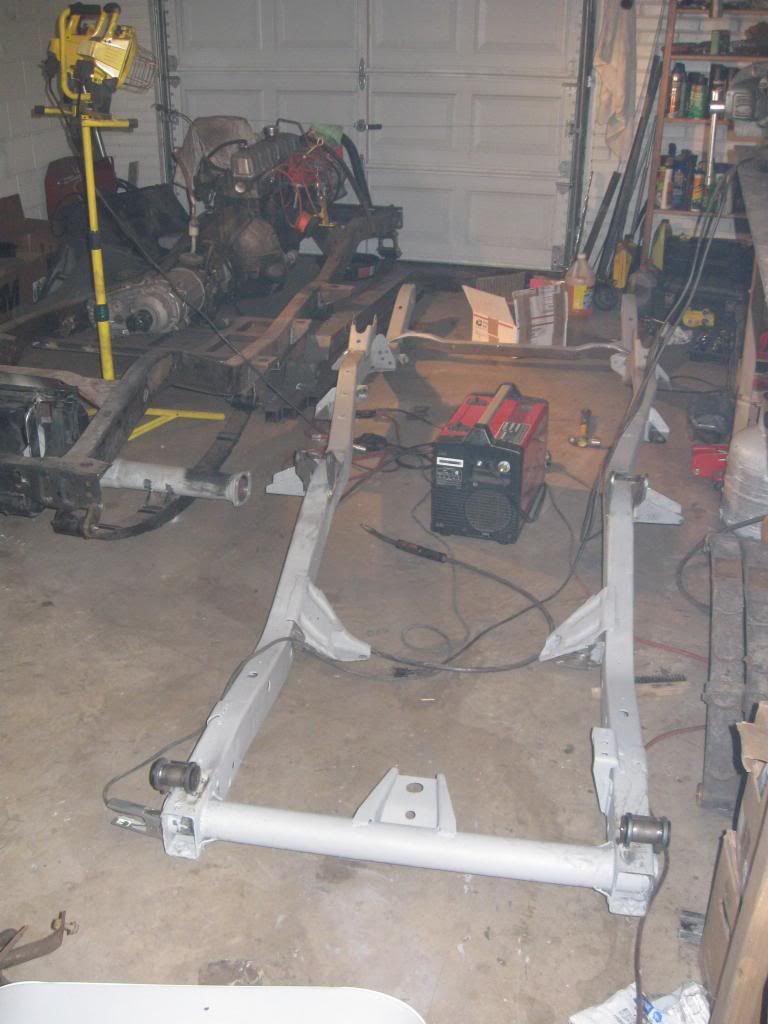

After a bit of mid build debating I decided to go the extra mile and make it an official frame off resto/build.
Was able to find a rust free NM frame locally for $250. STEAL!!!
The Neighbors love me btw.

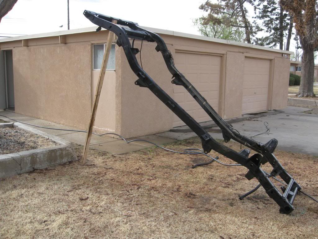

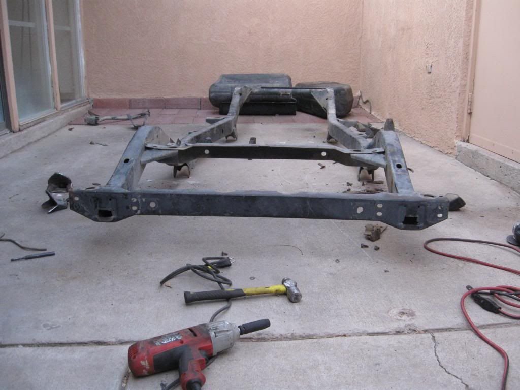

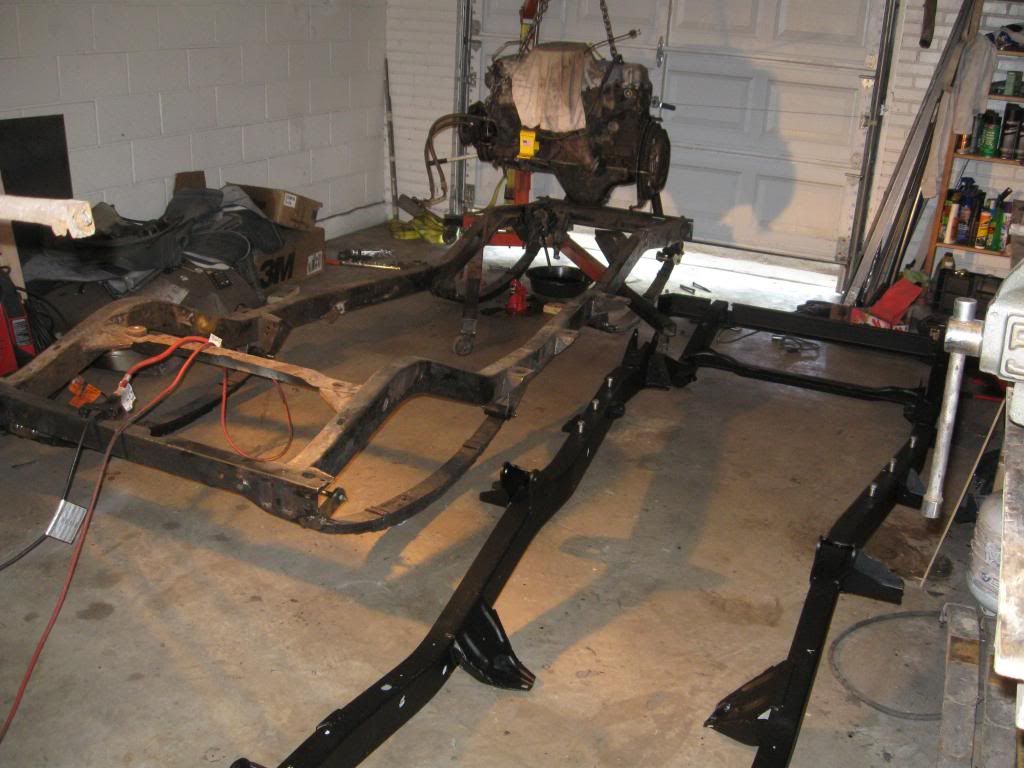

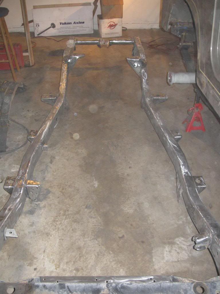

My frame prepping area. Cut off all of the unnecessary brackets. Shock, tracbar, sway bar, and rear cross member. More on the cross member to come.
Still trying to find out how to work this grinder.
My "house of sand is turning into a CASTLE!!!!" ....With a moat.

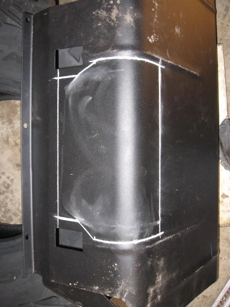

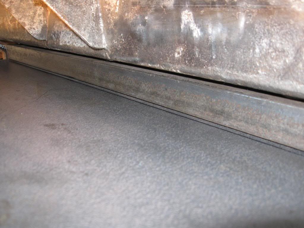

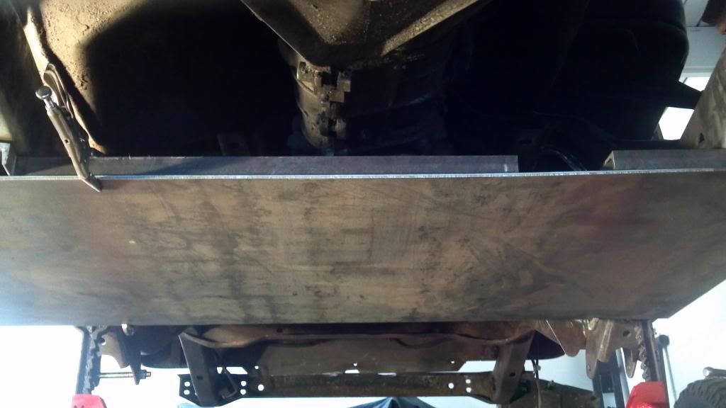

Time to put a dimple in the tank skid to allow my stretch. This one hurt a little. Cutting into a $200 skid stings. I wish my old skid was structurally sound enough to get the job done. Sorry that its rotated 90 degrees.
Walah!! Pretty stout.

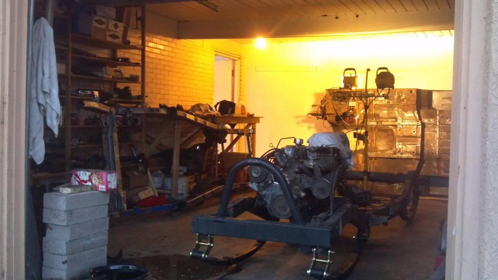

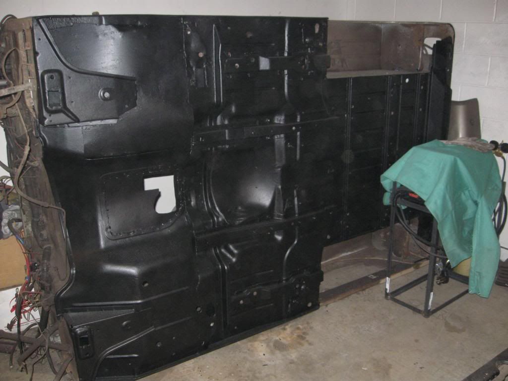

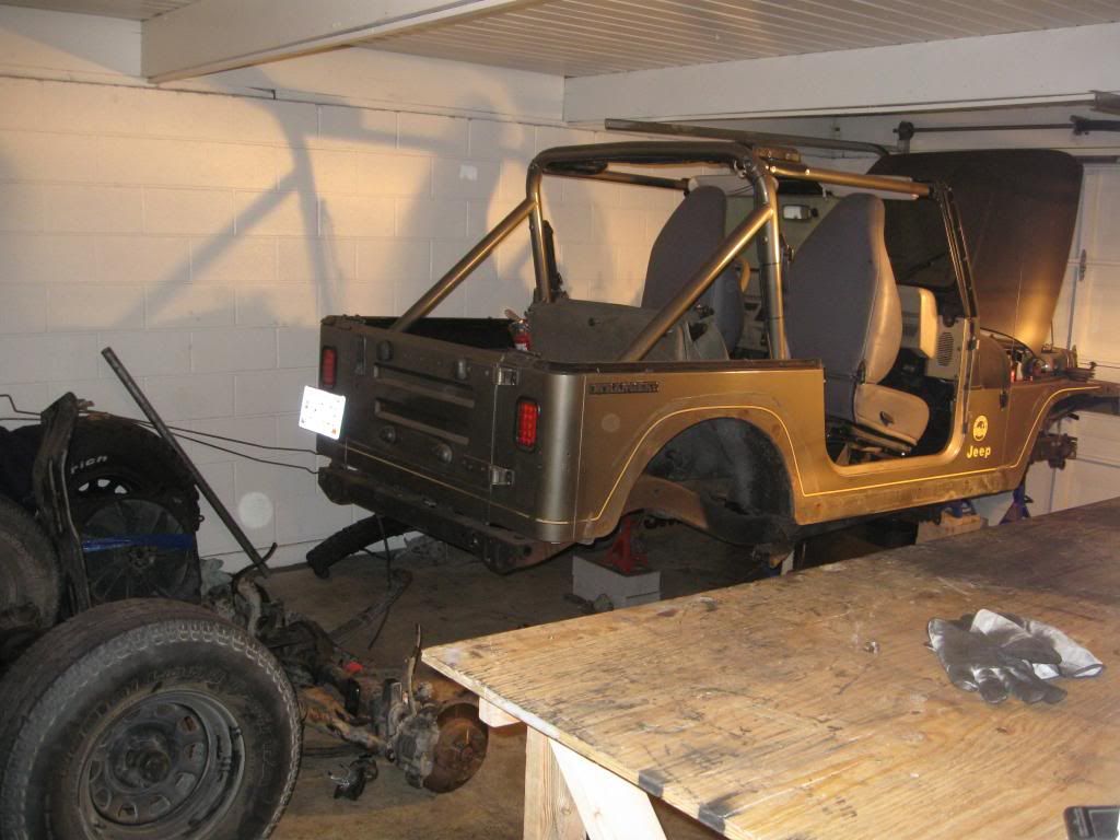

Body is off. Full frame prep underway. Body prep. And I knew I had SOO much more to do. Yet
Here's how the body sat for a few weeks. Got it good and clean underneath tho. The hole in the floor is to get me over 120 HP.
This is what the garage looked like when **** hit the fan.
Wishing I had a 2 car garage.
My new toy.
Moved the spring hangers to give me additional stretch. Turns out that was not the best idea...
I FINALLY got the body ready.
AND the frame. Time for the SWAP!!
Got the body on the frame.
SEVERELY threw my back out in the process. We went with the grab some buddies n grunt the tub onto the frame technique. I had split some gear oil on the floor the day prior. Threw some chemdry onto it and called it good. It was not. When we were shuffling the body over the frame I stepped on it with one foot. Lost my balance almost fell on my *** holding the body. But was able to recover. For the next month I was hobbling around. Oddly enough the only time it felt OK was when I was working on the YJ.

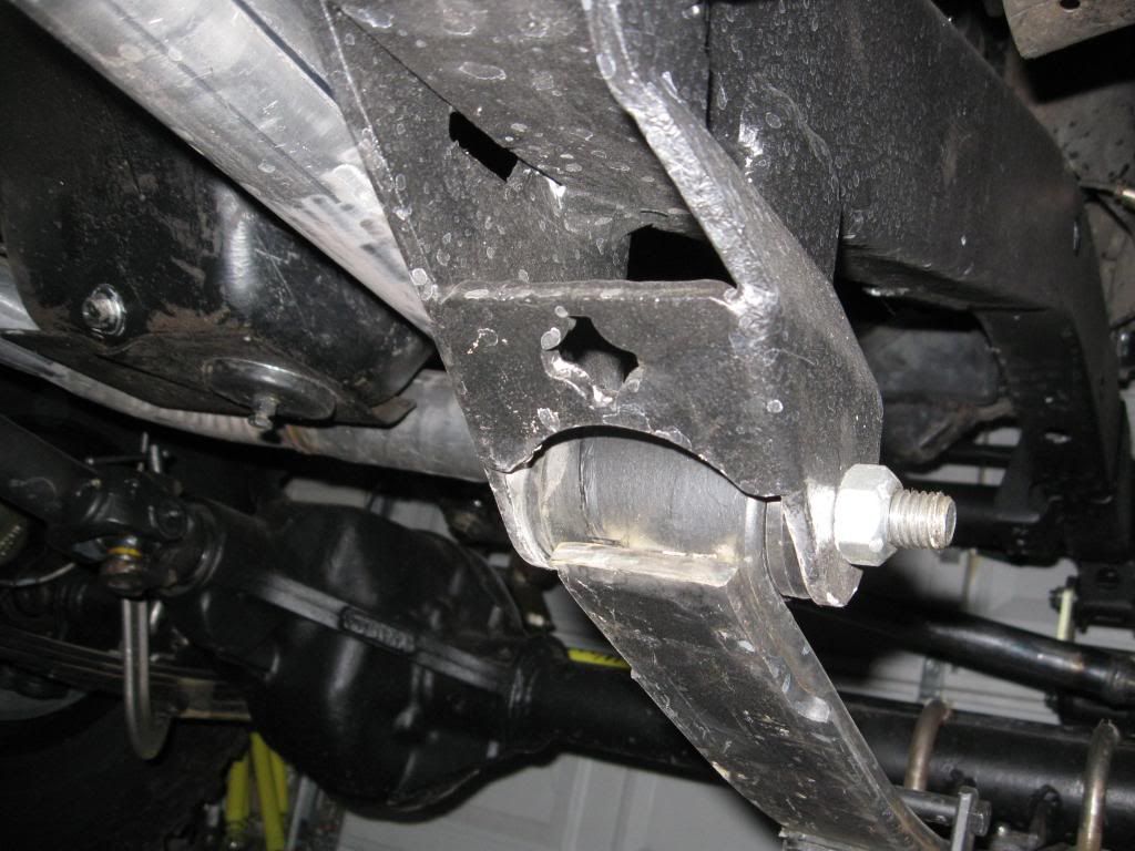

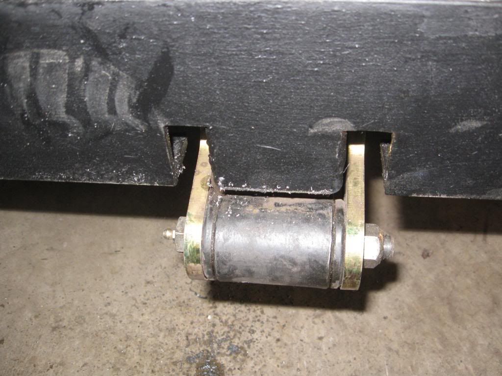

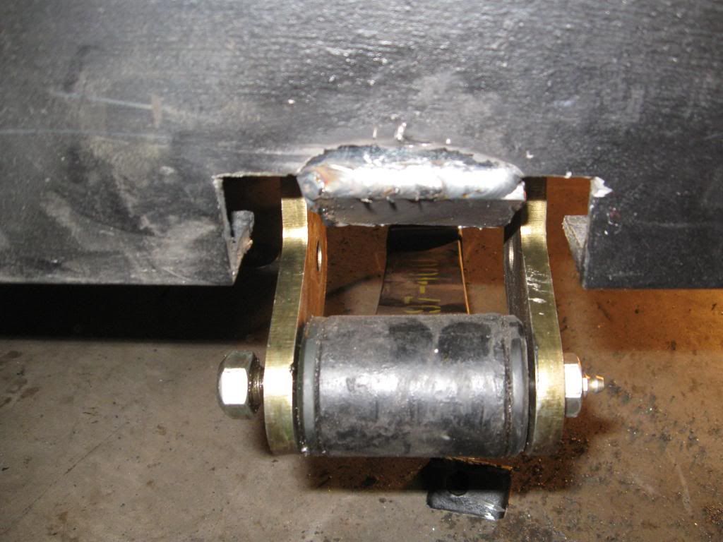

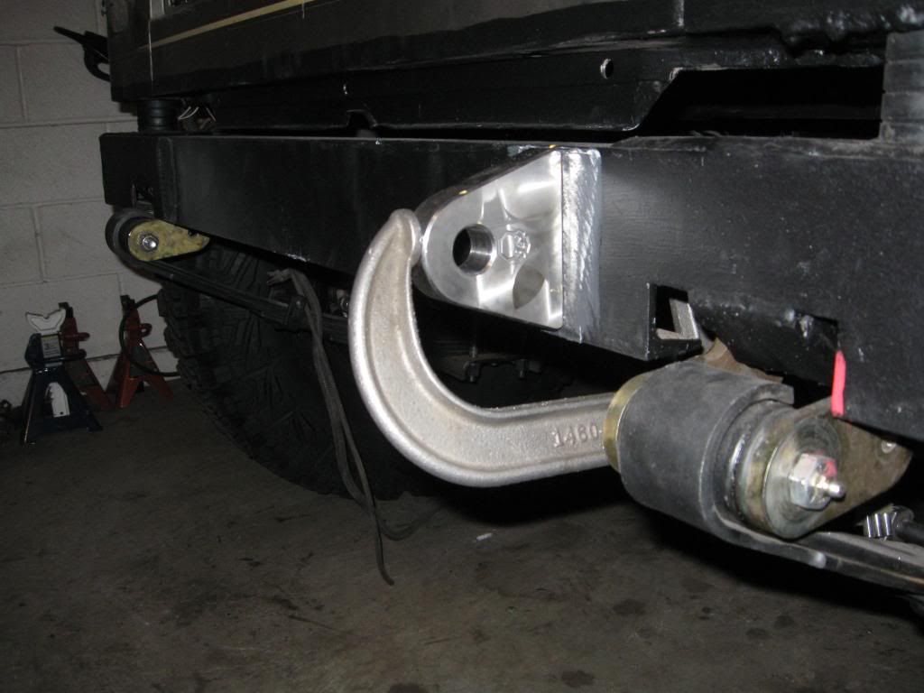

The rear crossmember I fabbed up was designed to allow the rear shackle to move more freely. So I notched it a little to allow that.
BUT the shackle was hitting on the bottom soooo...
Heres a shot of what it looks like when done.

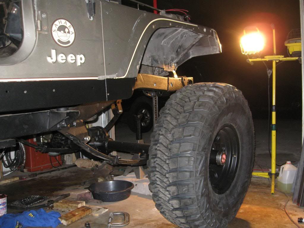

At this point I hit another big turning point. With my waggy springs and the spring hangers moved my shackle angle was too flat. I would only see MAYBE 2" of uptravel. This is why I said earlier I made a mistake moving the spring hangers. (3.5" in the rear and 1.5" up front). I needed a shorter spring. The waggy springs are 2+ inches longer eye to eye and I needed to bring the eyes in to fix that.
So I went with BDS.
3.5" BDS vs the waggy springs. My guess is that the waggy springs would have flexed better. They were noticeably softer than the BDS springs are. But I'll never know. If anyone is looking for a set of waggy springs I know a guy with a set.

So I got me a nice new $500+ pair of BDS springs. Installed them and ran into some problems. The military wrap was interfering with my rear crossmember clearance area. I already had the new plate welded on and was not 100% comfortable cutting more away. SO I opted for plan B.
Now I have enough room.
Ran into the same problem a little farther down the road in the front. (outboarded spring kit)

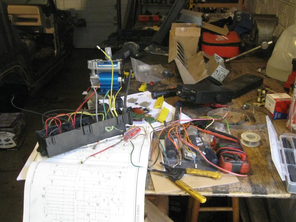

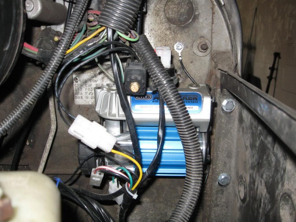

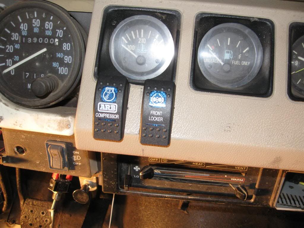

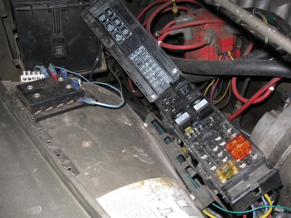

In the process of painting the axles I decided it was time to update my under hood wiring. Mainly my aux relays and suck.

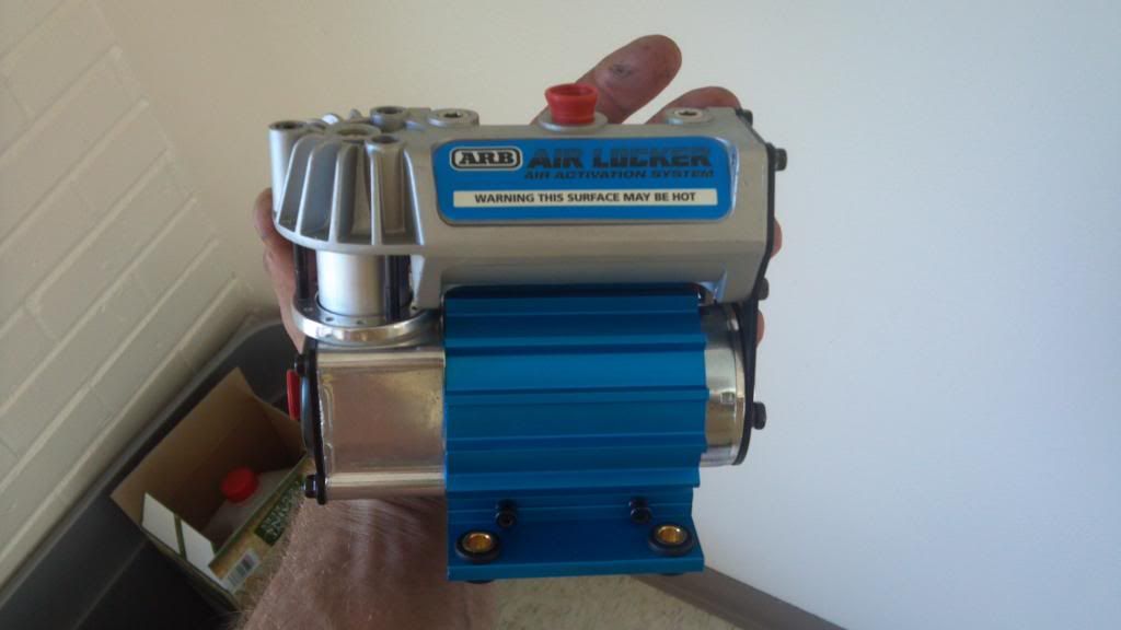

It was also time to install that air locker I've been drooling over for the past couple months.
Got the rear under it.
Won't have to cut as much. But still will have to cut.
Got my exhaust hung
Got my disc brake conversion all set up.
Now that the rear is on I feel as if I have to show a little love for the front.
This is the easy part. The hard part is getting the hub on properly and torquing that damn spindle nut... Multiple times.

Later that night I got my passengers side hub all put together. So I HAD to see what it'd look like with a tire on it. Pretty GOOD!
Next project up. Dring Mounts.
These things a HEAVY DUTY. I hope thew stay on If I ever need to use em.

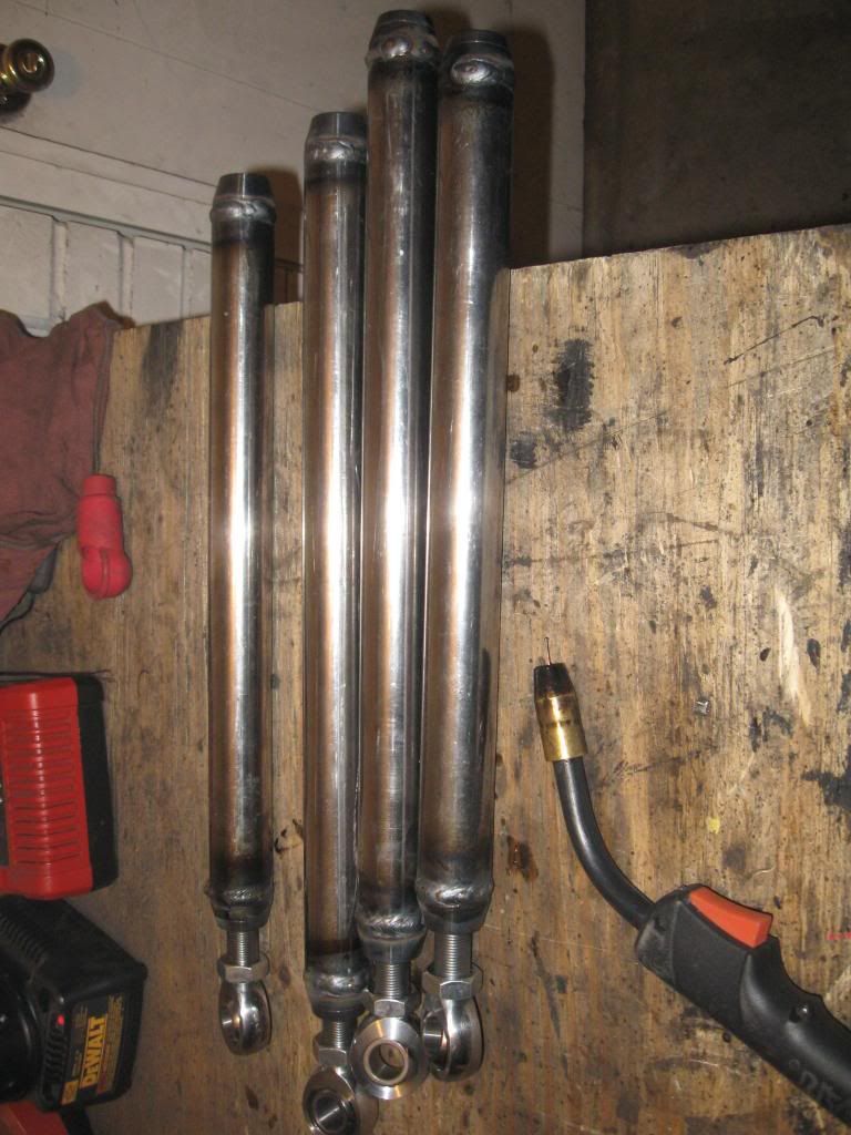

Here's Some control arms we made to stretch his rear a little.
What better time than now to trim that rear fender I've been meaning to get around to.
Look's good.
ZIP!
Before.
The front tires are on at this point and the driveshafts are being installed. Only I ran into a small problem. With the flat skid I ran into some clearance problems with my CV joint. SO BFH time! Again. this time I wail on the thing for quite some time. Now it fits.
Seeing as how I live in New Mexico where it's pretty hot. It was time for a hood vent.
Finished product to come.

Damn you got so much done! You do good work man, It's going to be do bad *** when it done!!!
Few questions. What size tires are those? 35s or 37s?
Now that you moved your spring hangers what's our final wheelbase? It looks like you have 3.5" front stretch and 3.5" rear stretch with waggy fronts and YJ 3.5" BDS rears right? What's the plan for steering? At 3.5" front stretch that might be a little to much for the stock steering box location.
Can't wait to see it done!

35's. I already half wish I had gone 37. But that's unfair seeing as how I haven't even wheeled it yet. Wheel base is right at about 100". It has about 4" in the rear and 2.5-3 up front.
Trying some different things with the steering I will report back when I find a solution. Right now the tire hits the fender up there without the pitman arm hitting the diff. But I will need to test things out a little more. I have a waggy pit man arm for it to combat my loss of turning radius. Also it's flatter so that should help the stretched steering issue out some too. If things don't go as planned the perches allow me to move the axle back 1.5" or 3" to fix it in then end if all else fails.
Yup. 3.5" BDS. PERFECT for 35's IMO.

Well you basically have 37s since the MT/R K run actual size unlike most tires.
One thing, make sure you cut off the little plates on the front outside of the frame in this pic.
They were for shipping when the frames were new and being shipped to the factory. They do nothing for the frame now but hold water and rust. Even on my 100 percent rust free mint CA frame, when I cut those plates off I found a little rust forming...
