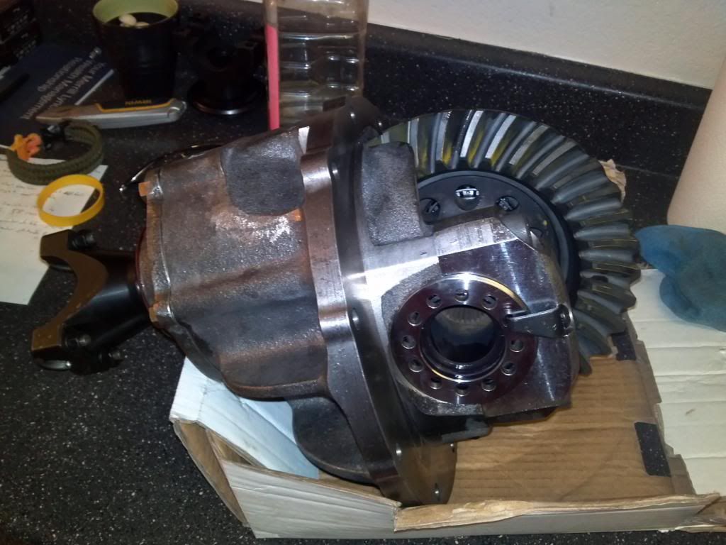

Took a BIG step in the right direction today. Got my 9" third member all set up. Has a Yukon Pro Nodular case and pinion support. Daytona pinion bearings. Yukon 35 spline full spool. Superior ring and pinion. (Although they were actually factory second Yukon ring and pinion gears) That pissed me off a little. I say factory seconds because the ring gear appeared to have been dropped on the ground or banged on something sharp. I ordered them direct from Superior. Which disappointed me a little.
Anyways here are the pics. It's a thing of beauty.

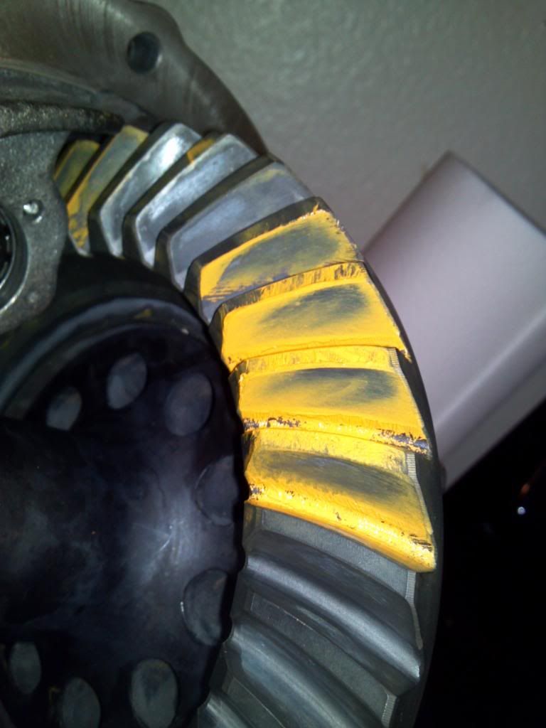

Heres my pattern. It was tricky to set up because the pinion has one or two tight teeth. Which was also a bit of a let down. But this is the best pattern we could have hoped for considering. Its actually not too bad. Backlash was between .008" and .012".
Drive
Coast
