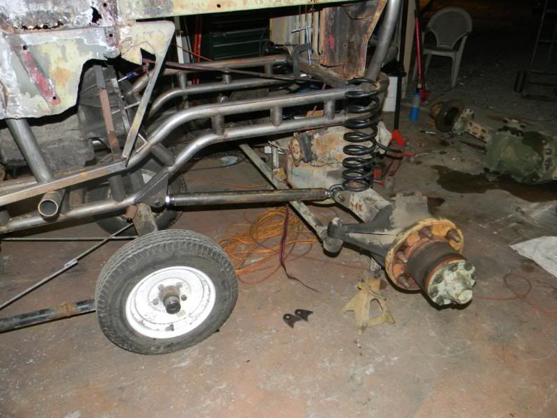

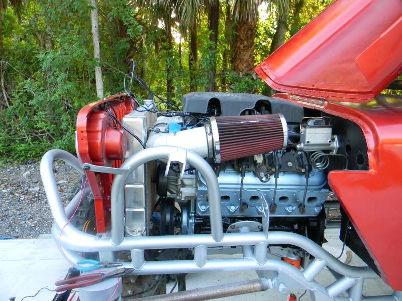

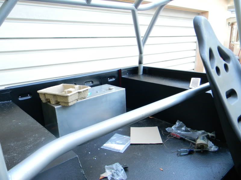

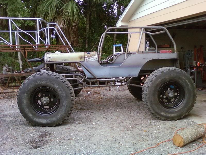

my willys jeep build tube buggy one
things have changes a lot but the finish is near

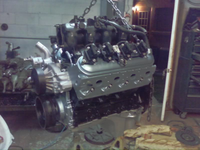

has a ls 5.3 4l60e and a dana 300
about 1000$ more to go
bought this for a title and grill and tailgate

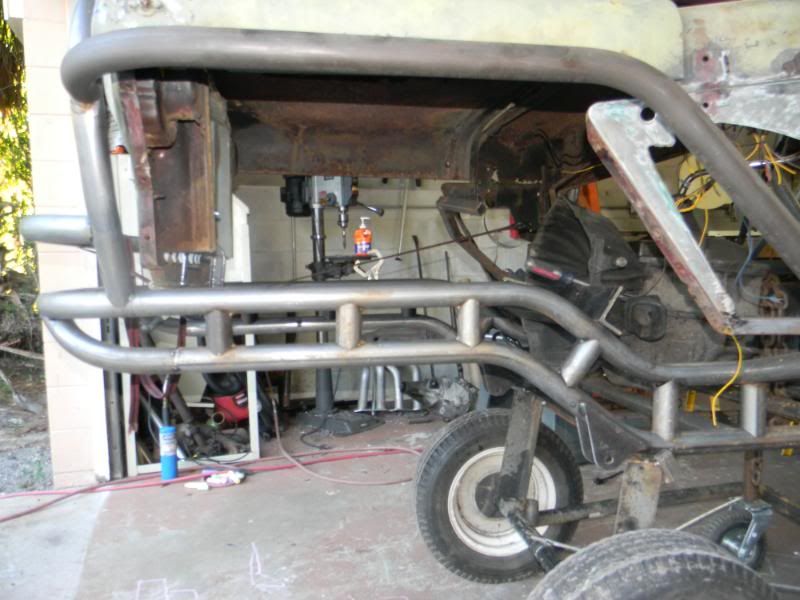

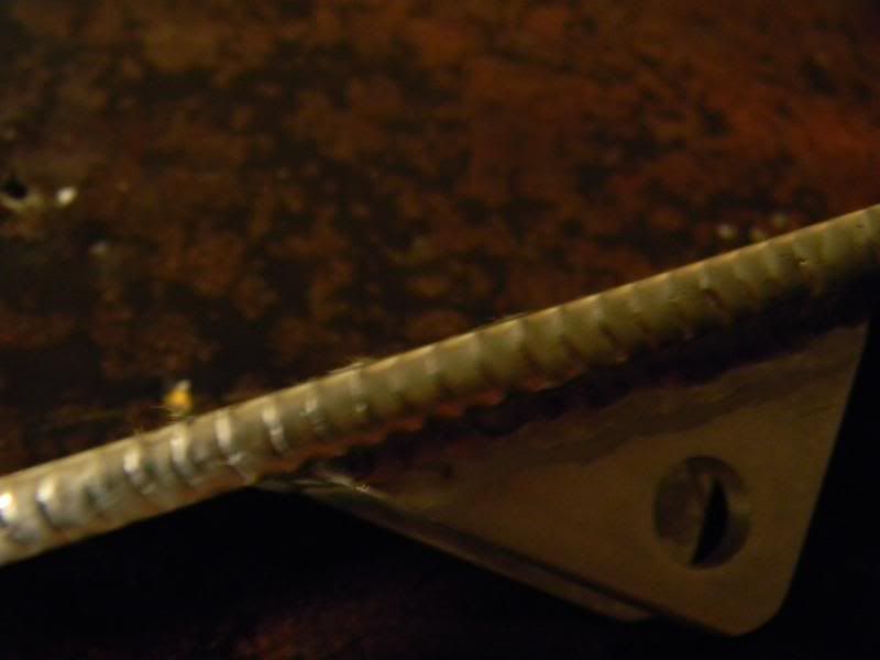

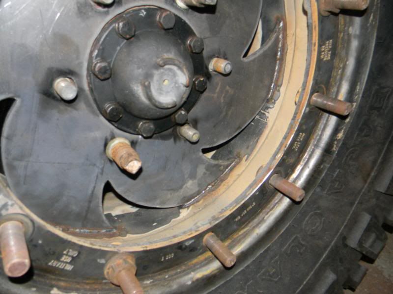

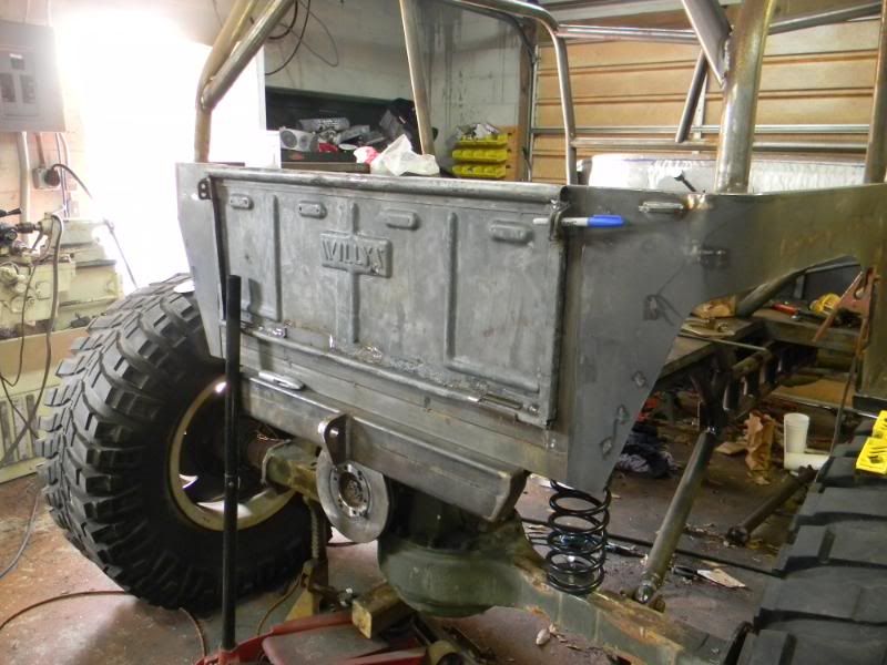

started about 3 months ago on it need to save up some money for lockers and then i can pull the axles apart and paint
need a winch mount
just put in some tail lights

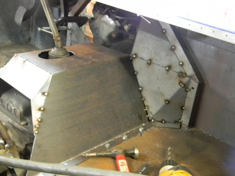

working on tcase adapter to night

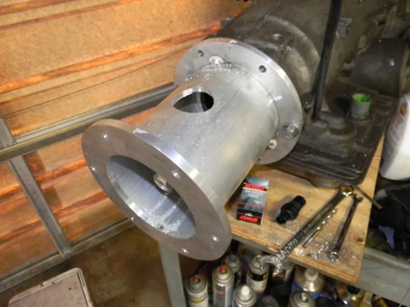

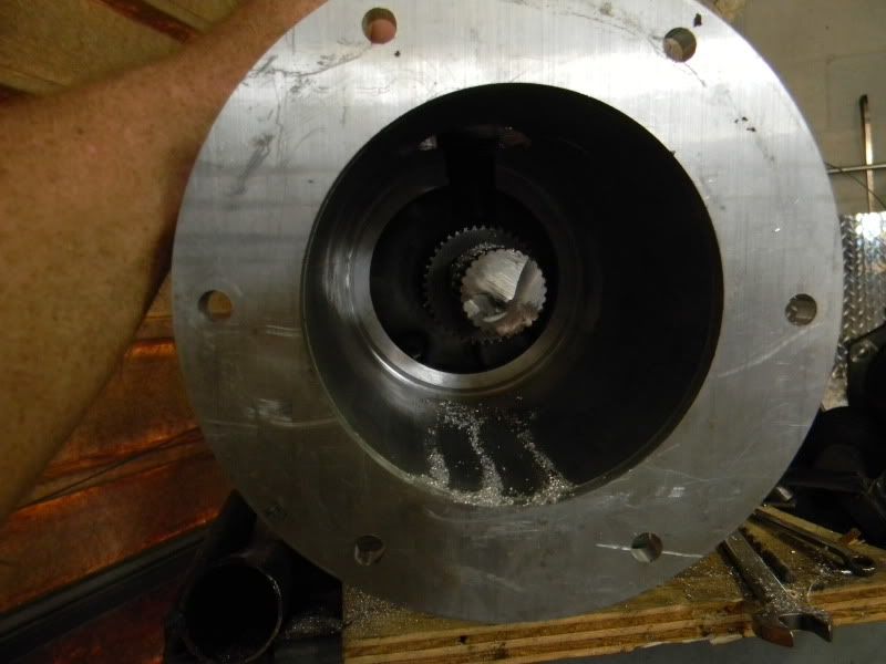

Posts: 37

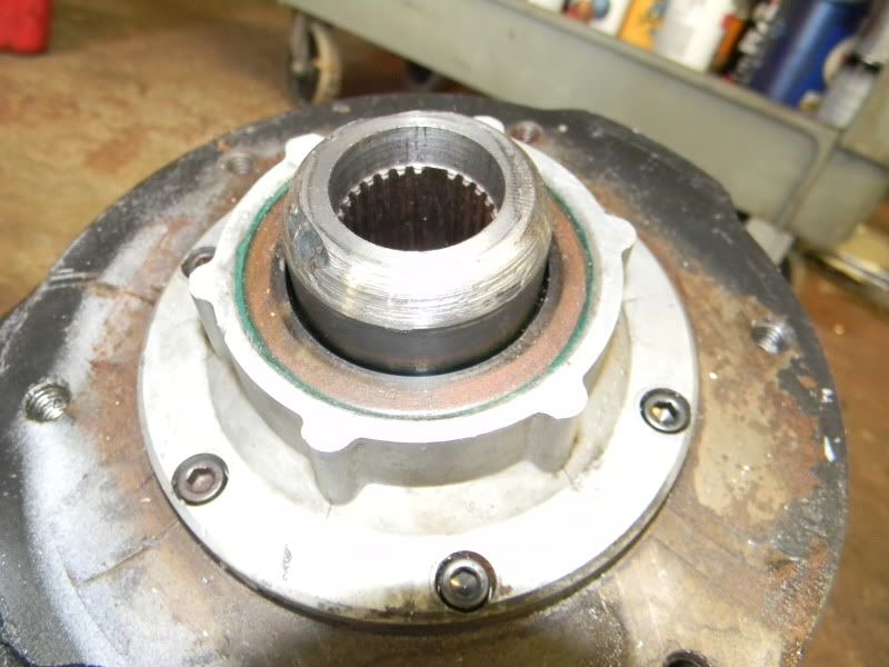

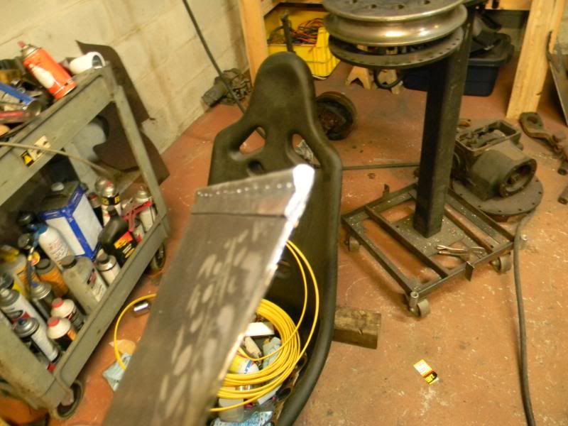

started to build the tcase adapter
cut out the old splines in the input of the case and welded another spline yoke to change spline count.
then cut a few inches off the trans shaft
need to finish the vvs censer

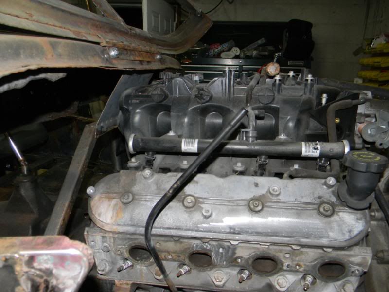

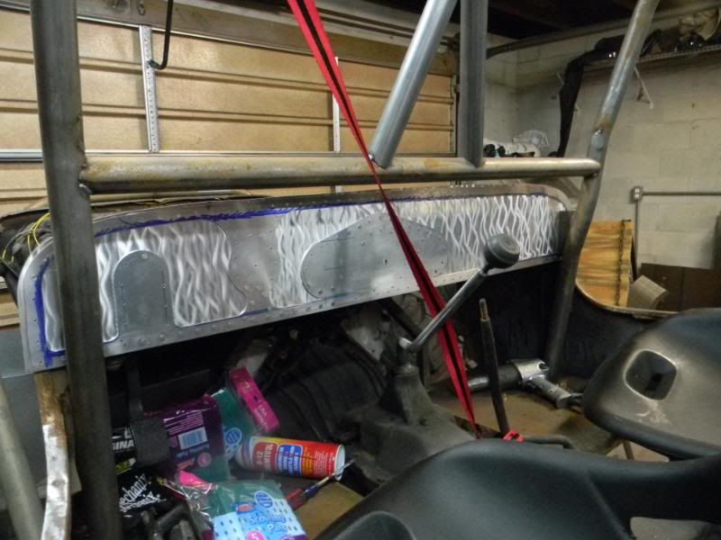

got the stuff to build the steering column to day
need to work on the headers i wish stock manifolds would fit i hate headers

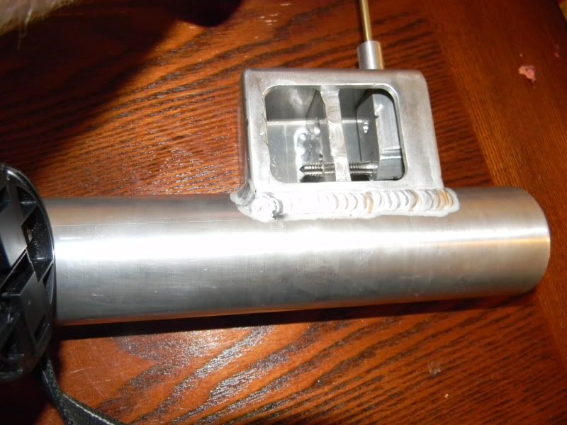

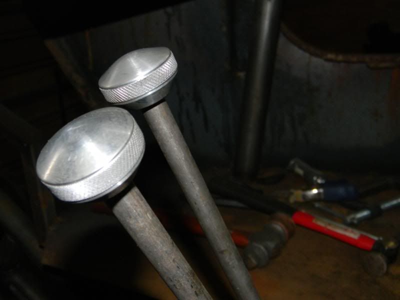

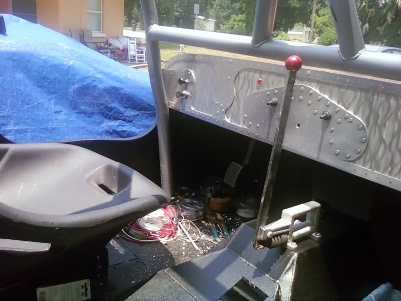

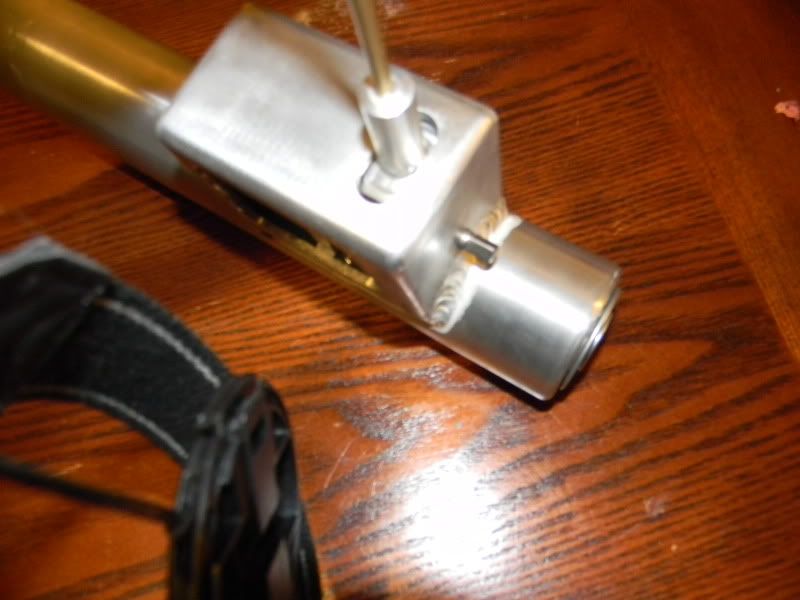

Started the steering column to night and the blinker assembly for the willys
need to get a 3 way switch tommarow for it
and turn a handle at the end and make a block off plate tor the bottom of the switch cover and a mount for the column
