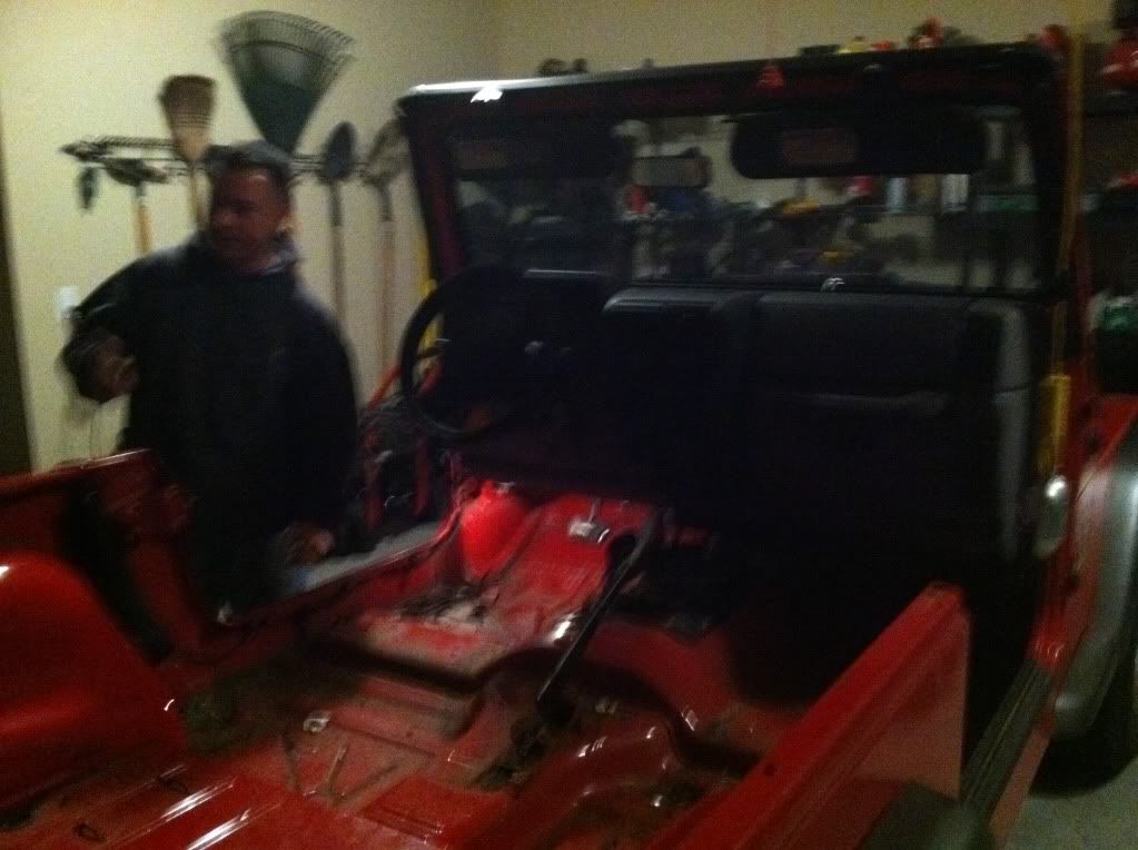

Story: picked it up last fall. Its a 97, 4.0 auto with 149K miles. Purchased for $5000. Pretty much bone stock. The PO said it had been wreck and repaired (salvage title). And as we all know how these things go, theres always more to the story that comes out later. We were told it was hit in the front passenger fender, which had been replaced. Found out later it actually flopped. No biggie.
On the way home.

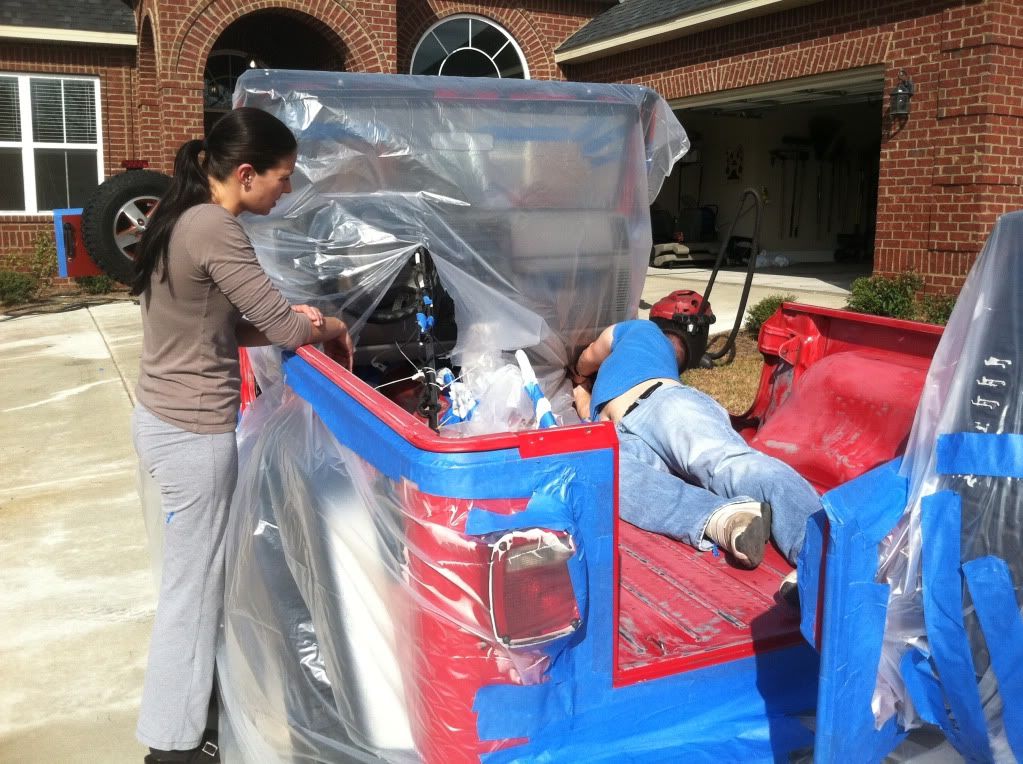

So, we got it home and had to take care of just a few things right off the bat.

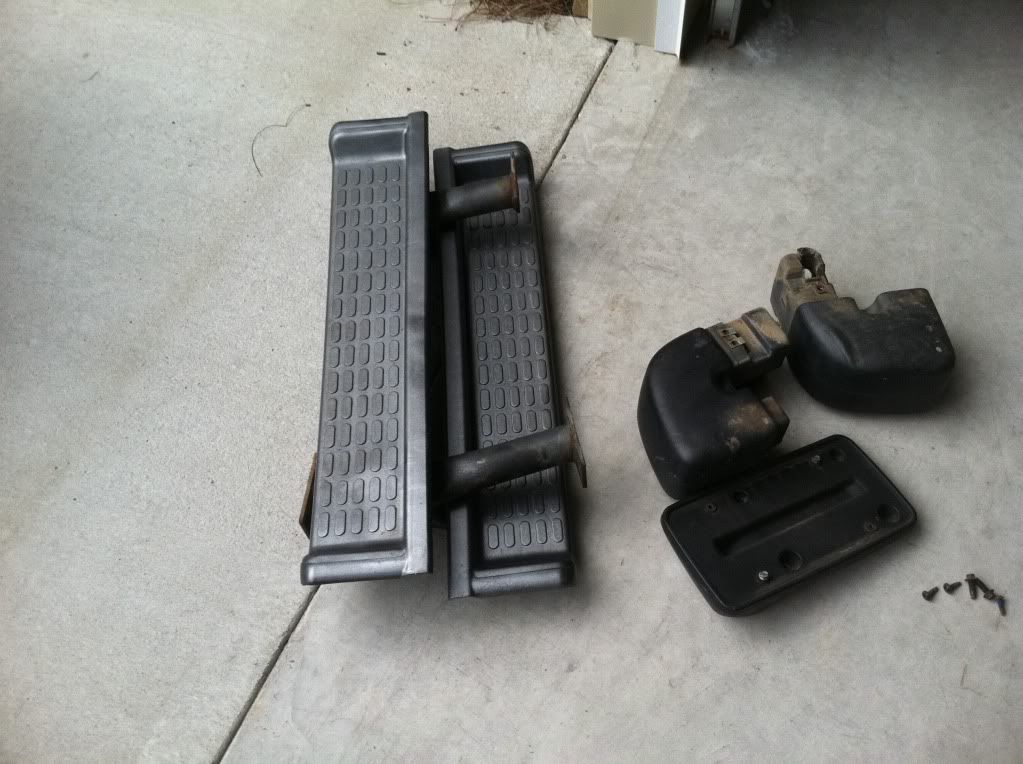

All the stuff we took off.

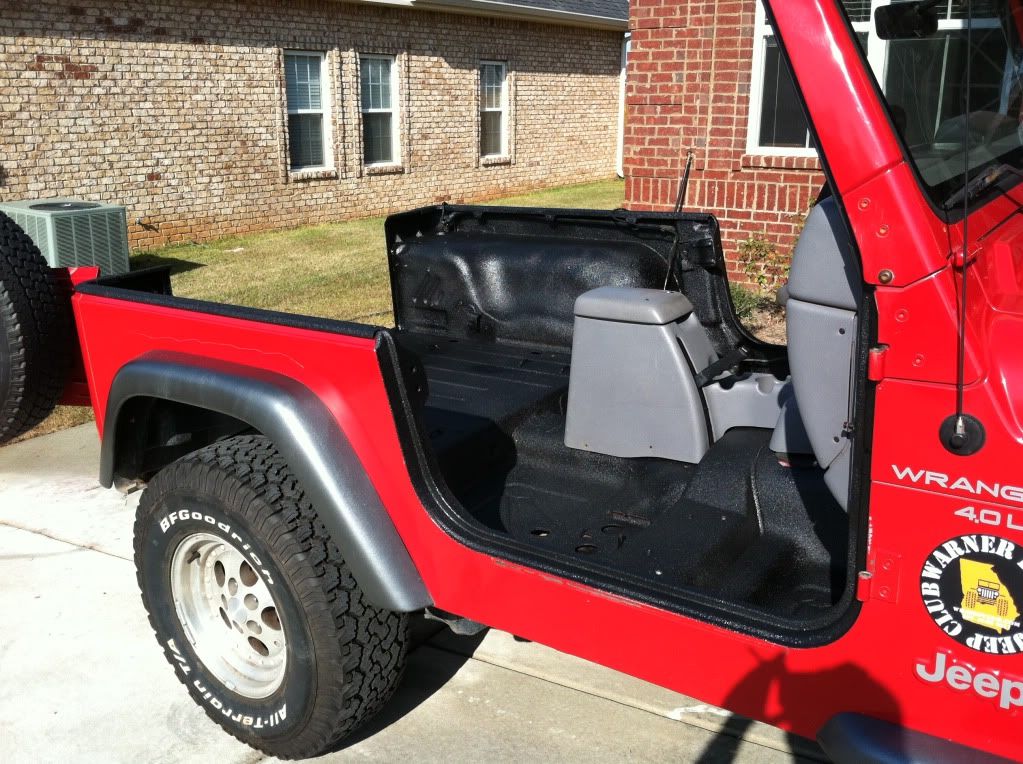

Had to get rid of the ugly yellow sticker

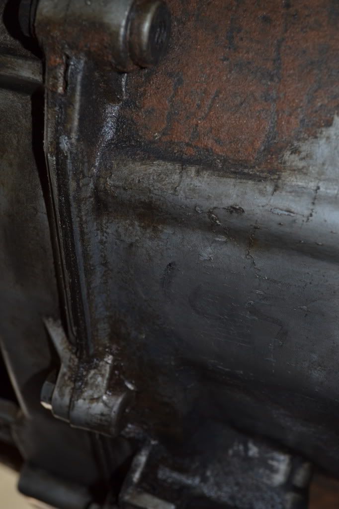

Progress: oil change, replaced thermostat, flushed heater core (MUCH better heat inside now), put fuse back in door defeat, adjusted TCase linkage (4-lo works again)... now still trying to figure out why the vent selection wont go to the front vents. Right now we only have floor and defrost.

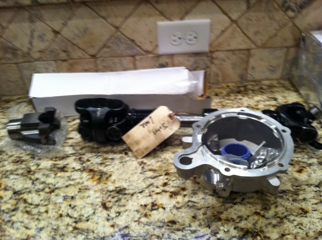

Coming soon to a little red Jeep near you:

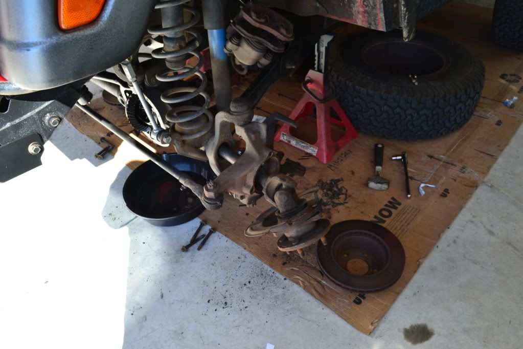

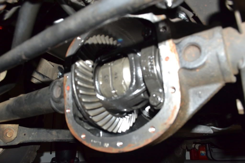

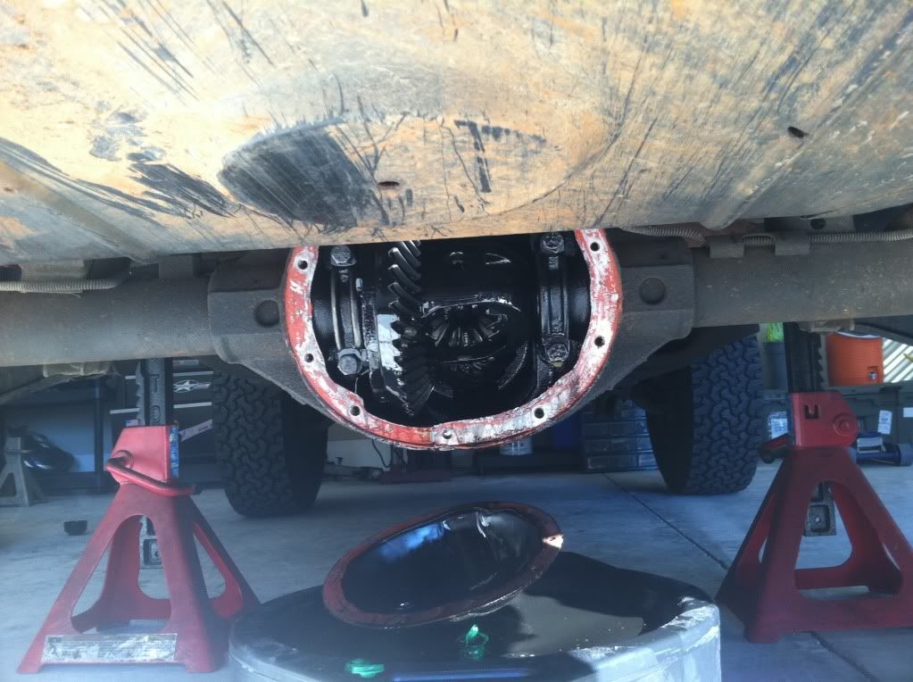

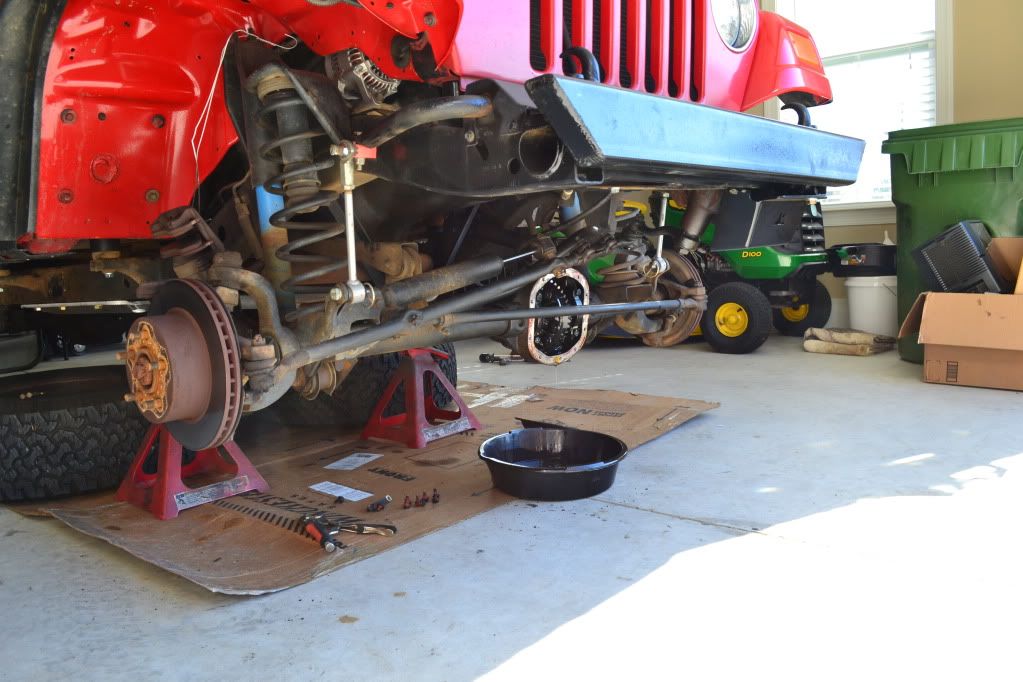

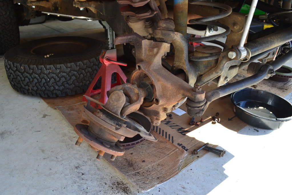

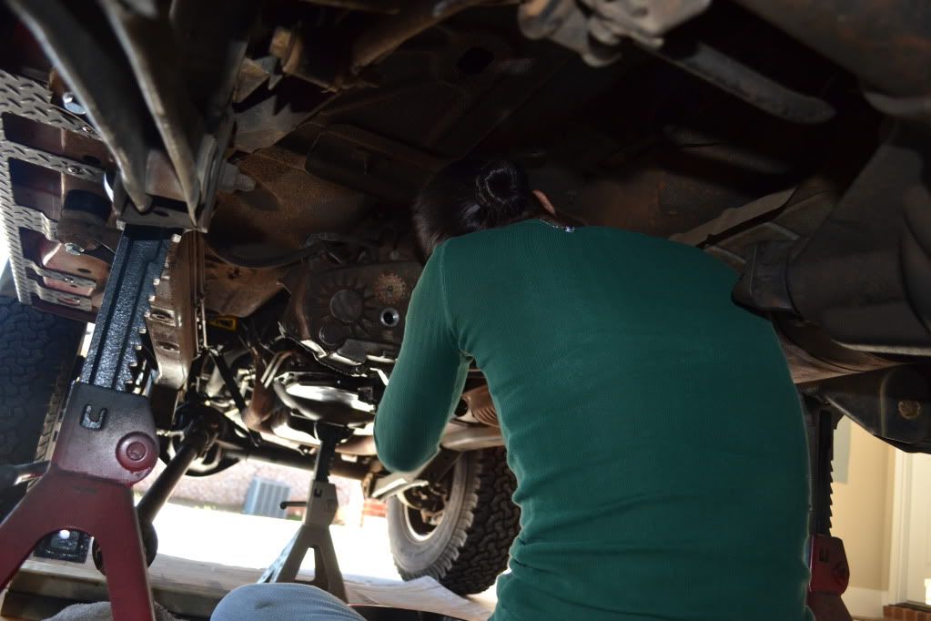

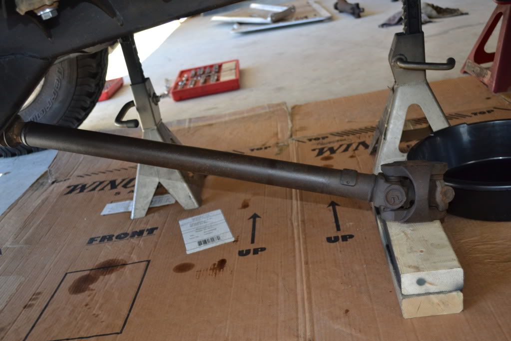

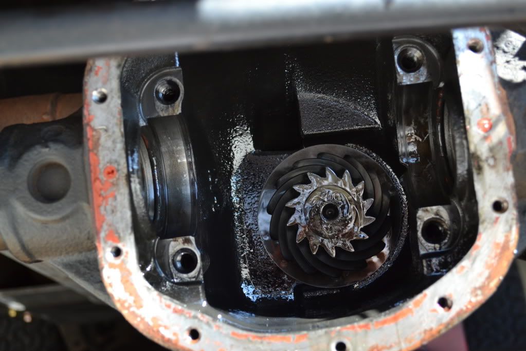

Met up with a friend this morning and picked up a spare axle shaft (and 2 more, :ty. (Turns out the drivers side shaft was bent during the flop) Swapping a shaft on a D35 is a piece of cake:
pull the wheel
pull the drum
open the diff
unscrew the center pin retainer bolt
remove center pin
push shaft in
remove C Clip
pull shaft out
install in opposite order
(Looks like Im pooping :fu
Lessons learned:
When you put the new shaft in and youre turning to line it up, the spider gears (2 little ones?) will go for a walk right out of the carrier. When you find them and put them back, make sure to find the shims they ride on too. Otherwise, its a real PITA to put the shims back in after youve bolted everything back up and re-sealed the diff.... Hey, atleast I didnt fill the diff before I noticed them laying on the oil catch.
Also, its an extremely bad idea to hit the brakes after youve removed the drum. Again: Putting 13 year old drums back together is not fun.
I basically turned a 30 minute job into a 3 hour job. But hey, its all back together and no more bent shaft :clap:

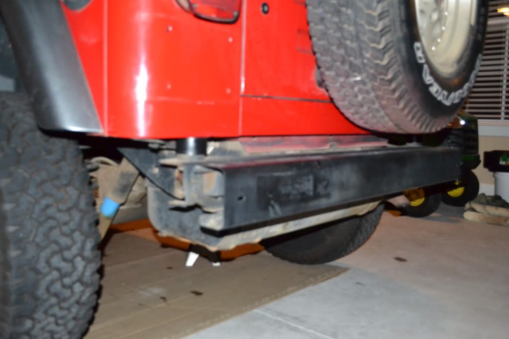

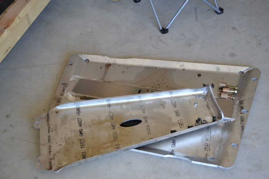

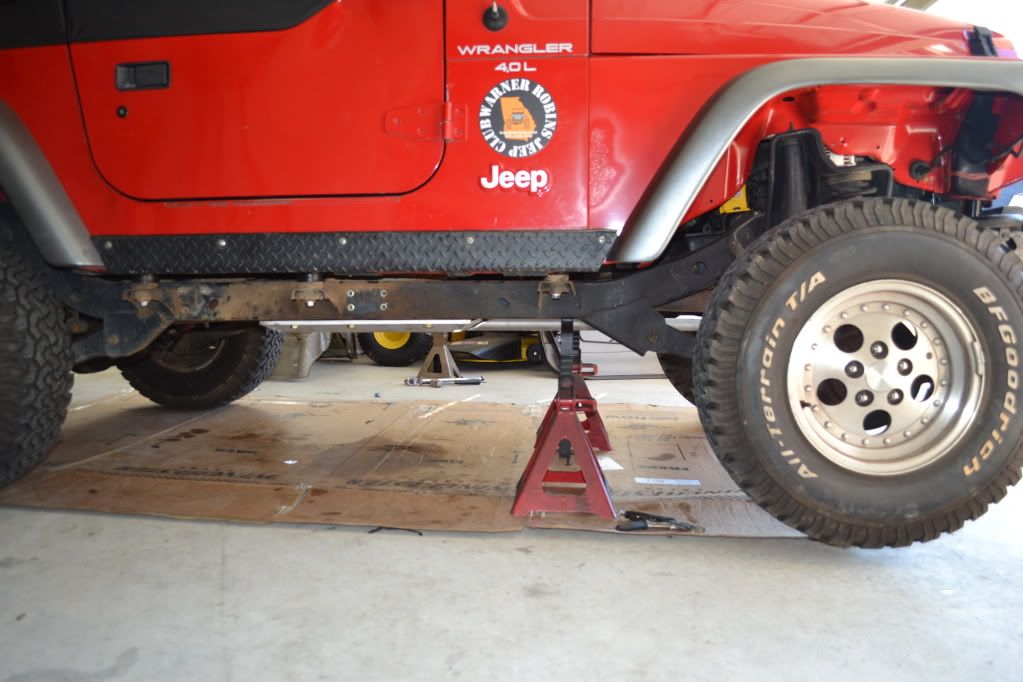

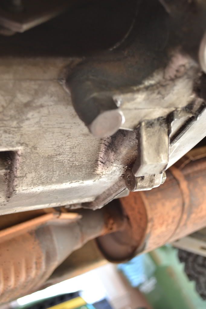

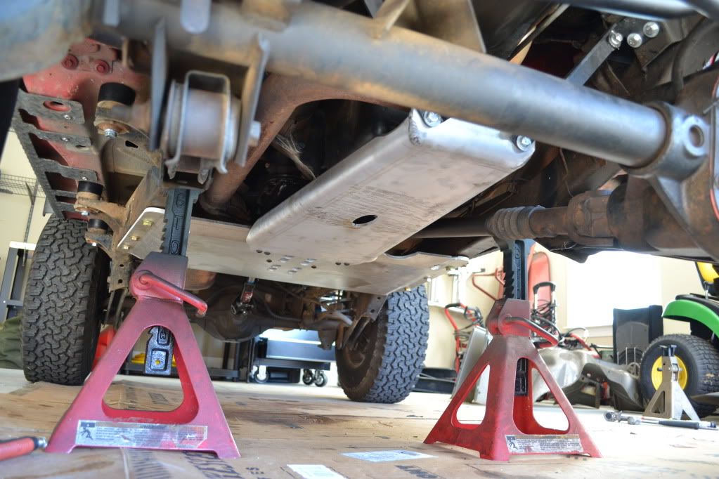

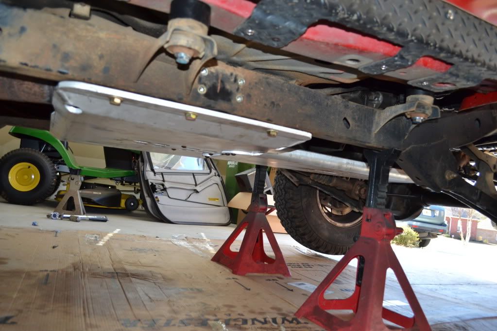

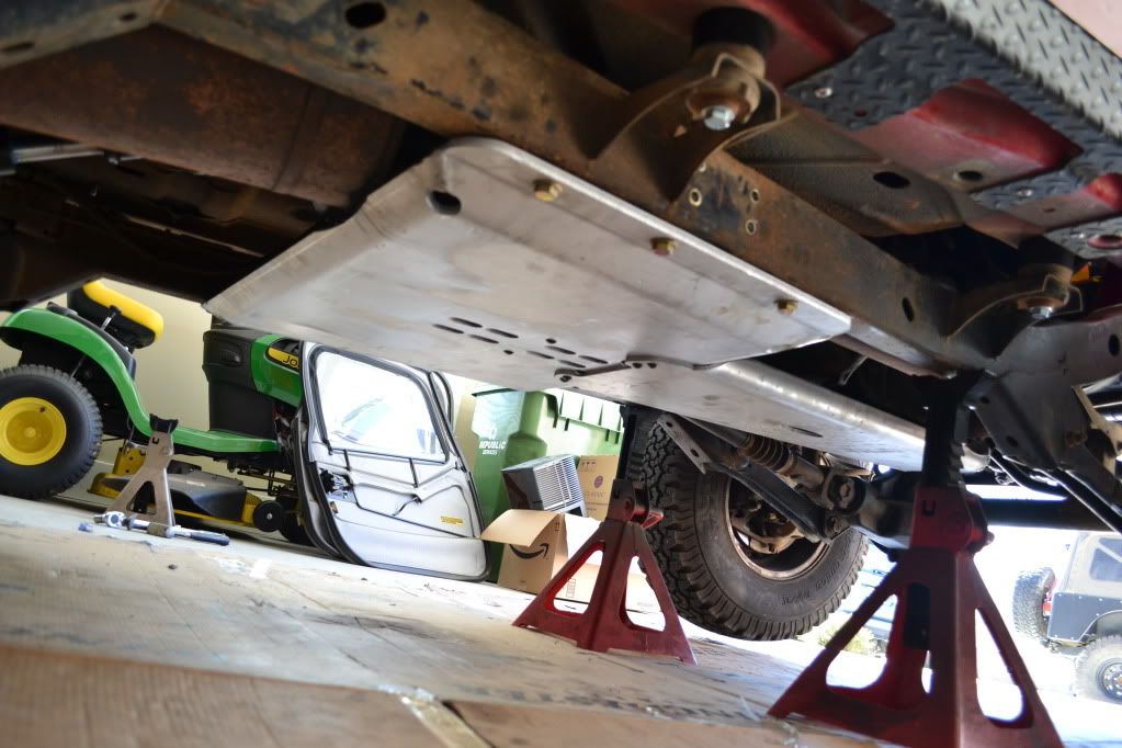

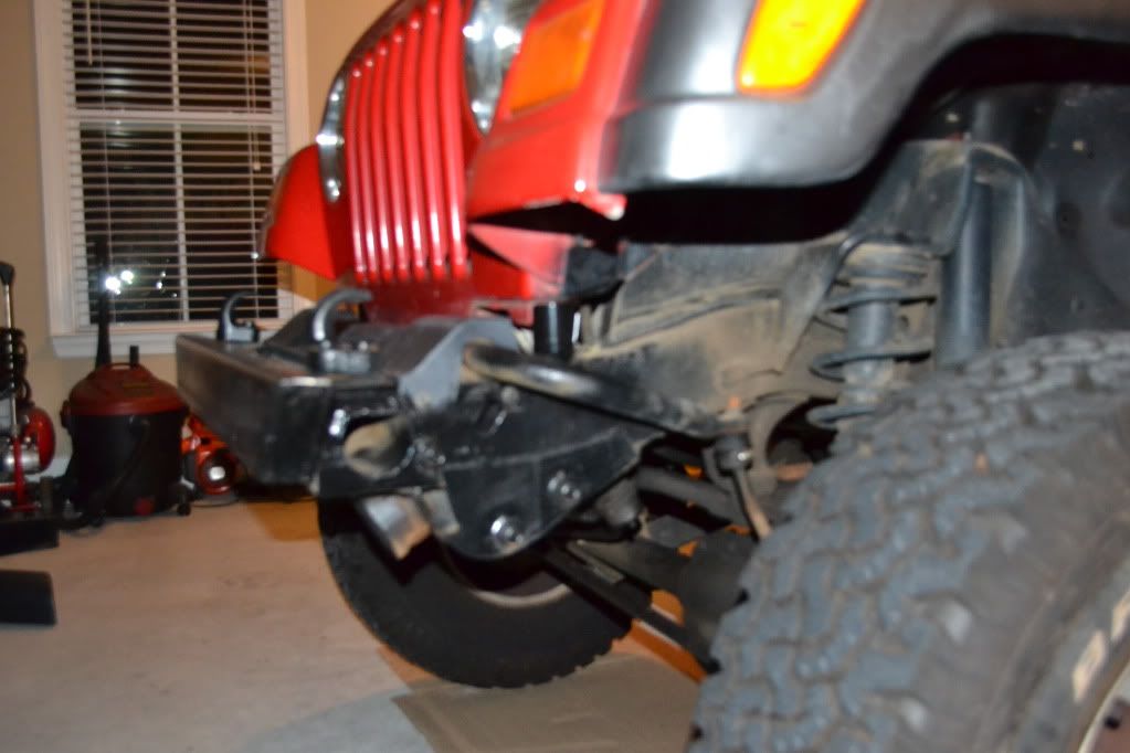

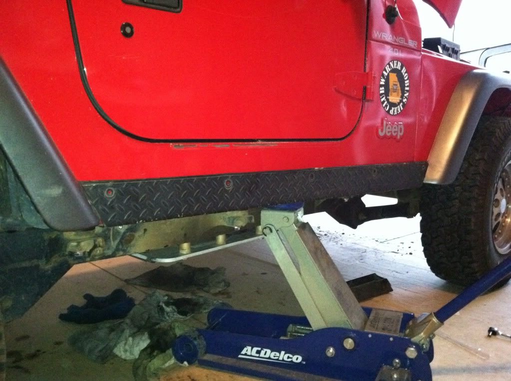

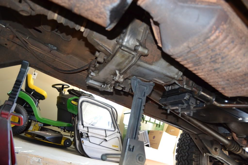

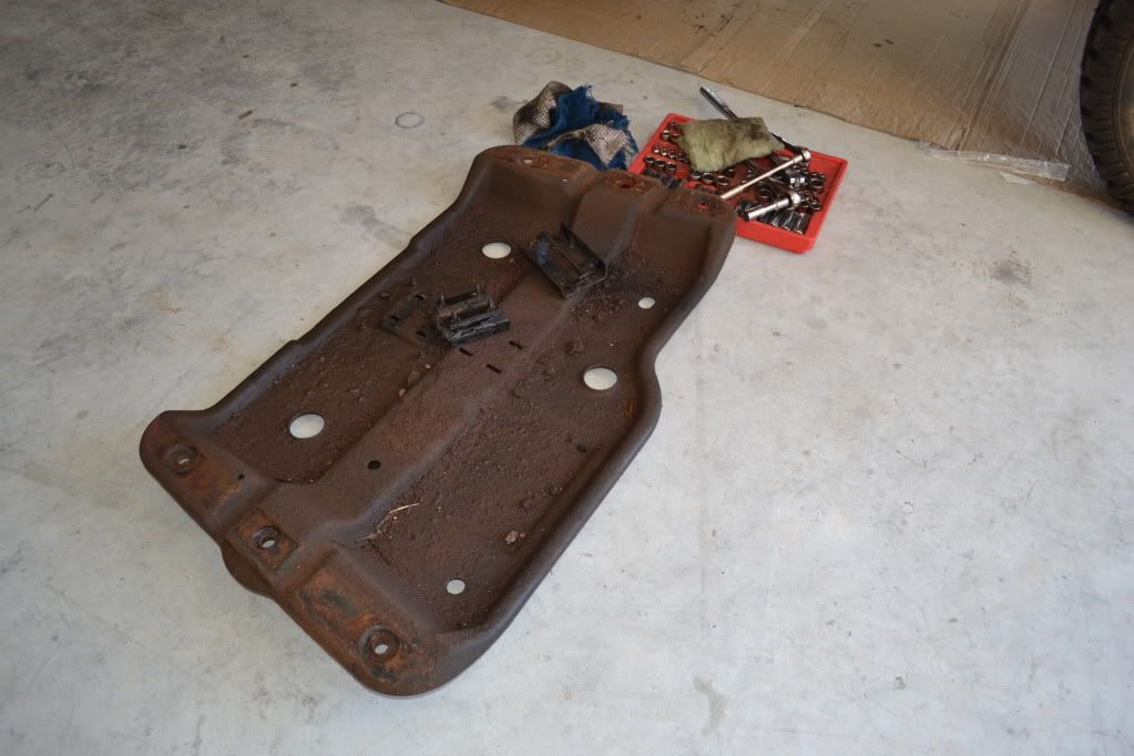

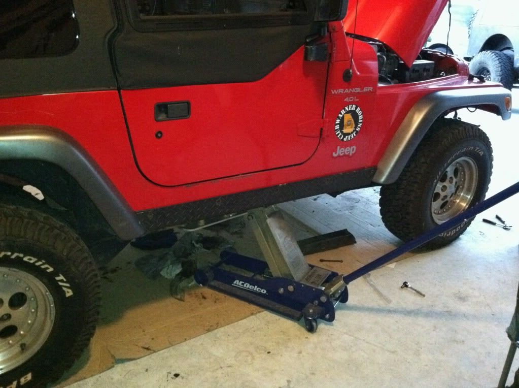

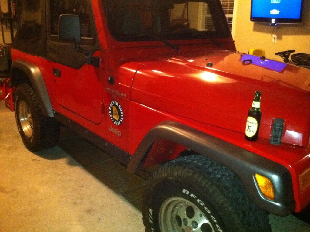

We got a bunch done today. Pics dont really do much but we installed a JKS 1.25" BL and started to install the belly and engine skids. Once we got the stock skid off, the transmission mount fell to pieces so that put a stop to that until tomorrow. Anyway, new tranny mount will be in tomorrow and we should have the belly and engine skids on soon... Pics:

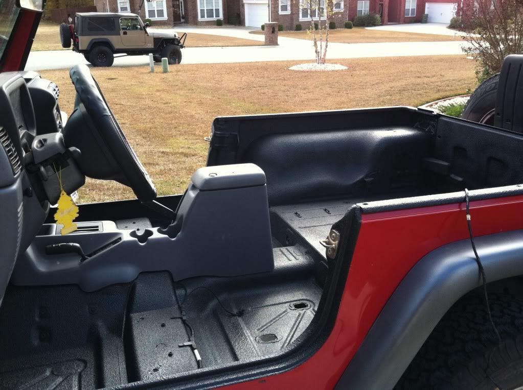

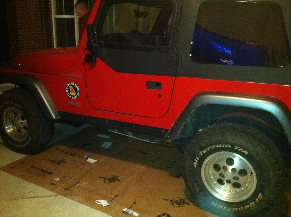

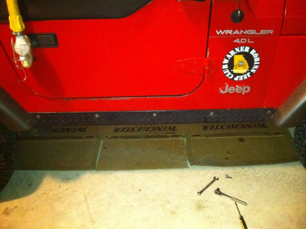

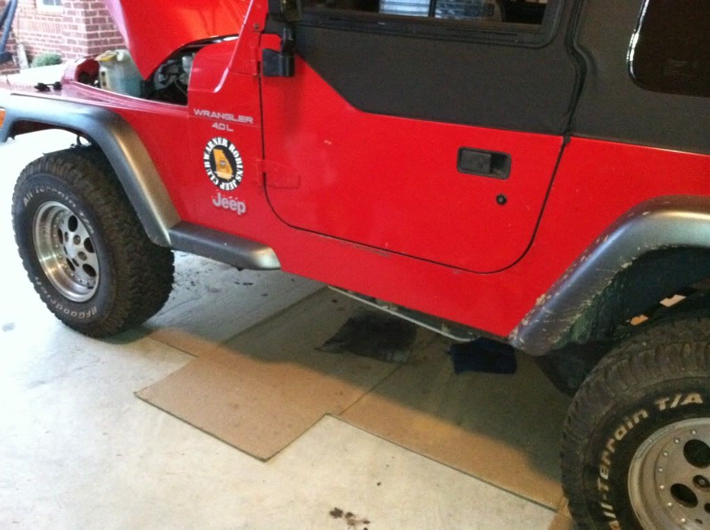

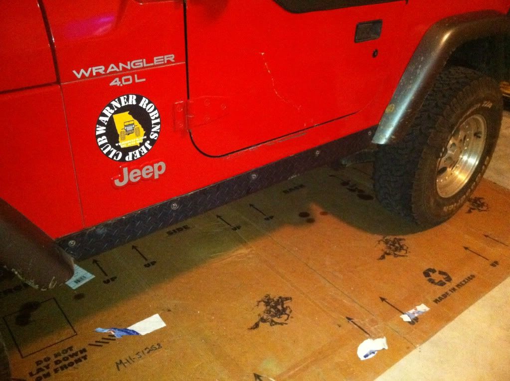

I replaced the leaky radiator hose this morning. Also added 2 bottom bolts to hold the radiator in place... apparently the PO didnt think they were necessary . So far so good, no leaks and holds temp just fine. I also chopped up my stock LJ Rubi rockers and we're retro fitting them to Kims Jeep. The cool think about the LJs and TJs is the only difference is the extra 11". Everything else mounts exactly the same. So short work with a grinder and my rockers will fit like a glove!
Dont have enough nutserts or time to finish today... Maybe tomorrow...

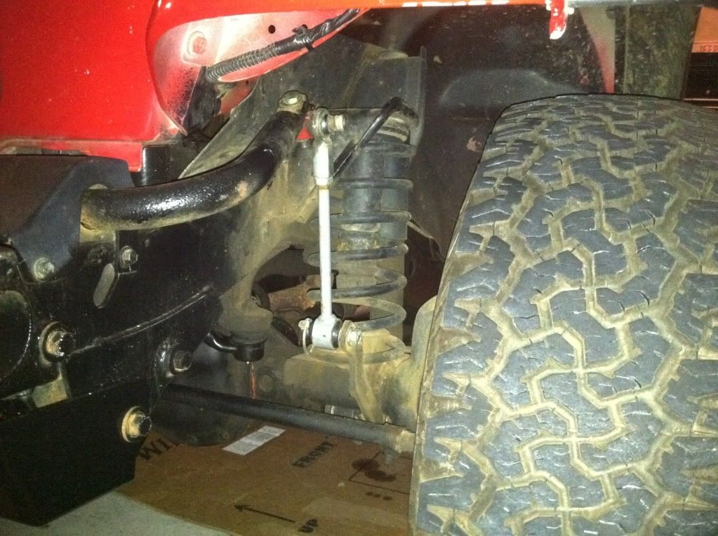

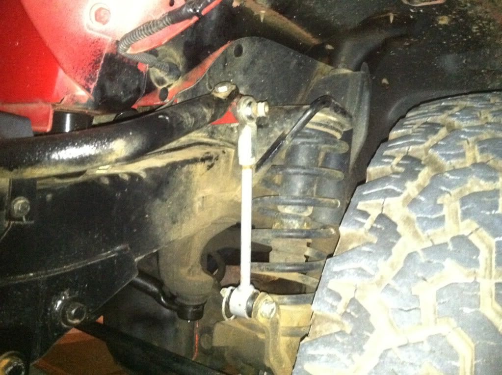

We got the rockers finished and installed my old swaybar disconnects I had on my Jeep before I got the Anti rock. We really like the way the rockers turned out. Fought with the nutserts on the passenger side but the driver side went on like butta!

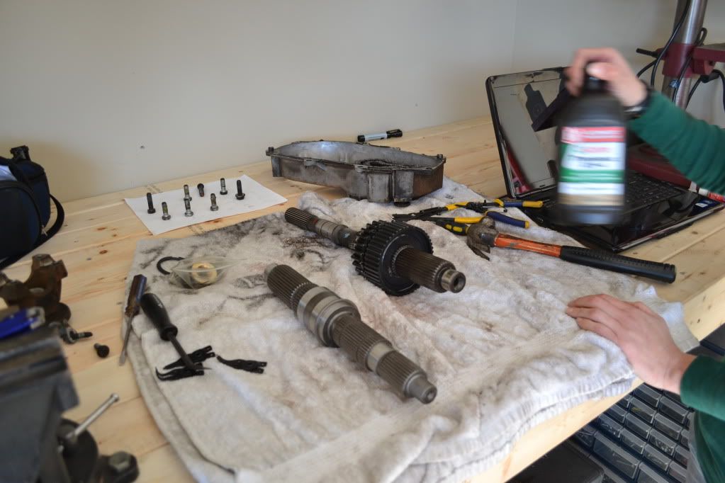

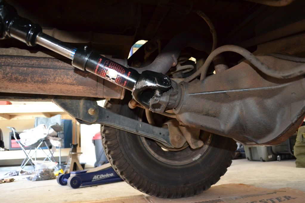

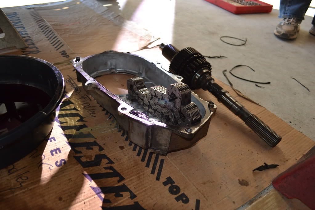

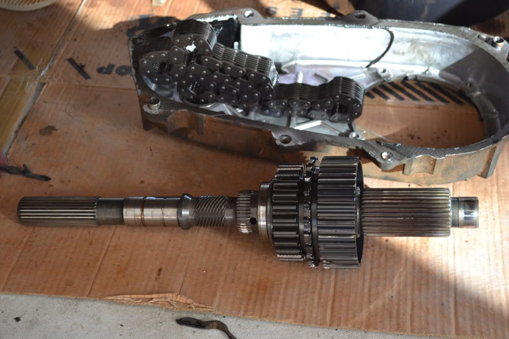

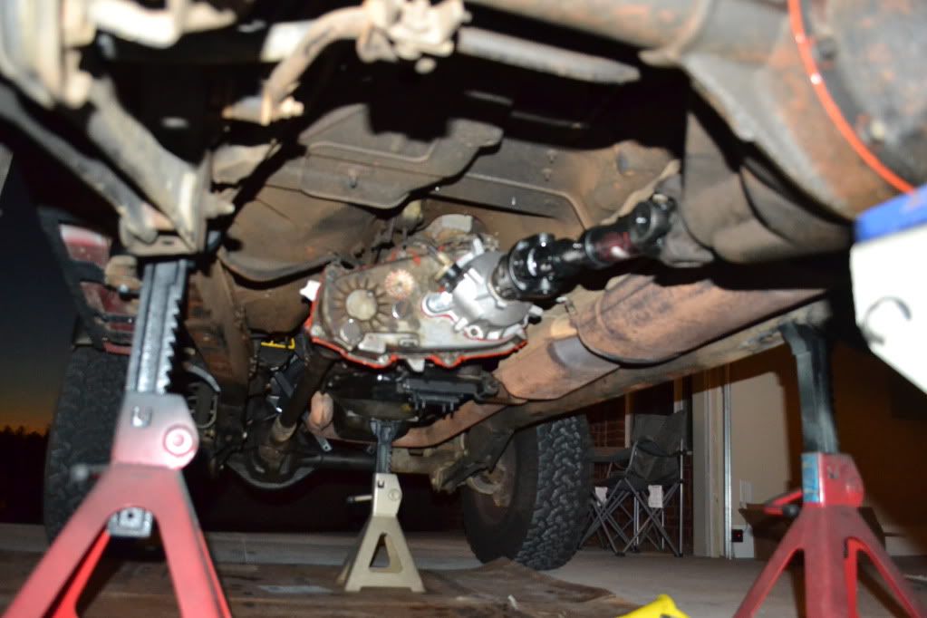

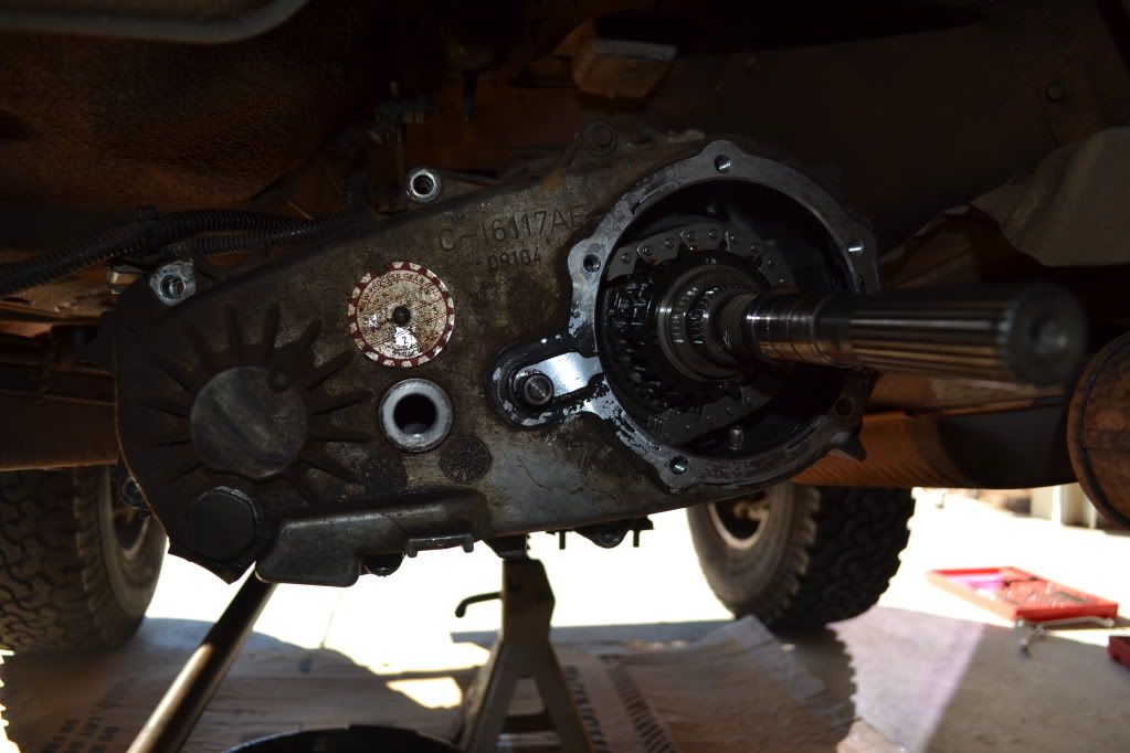

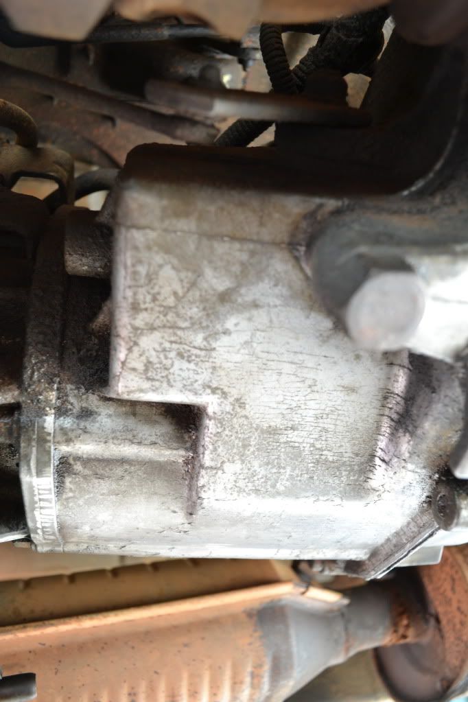

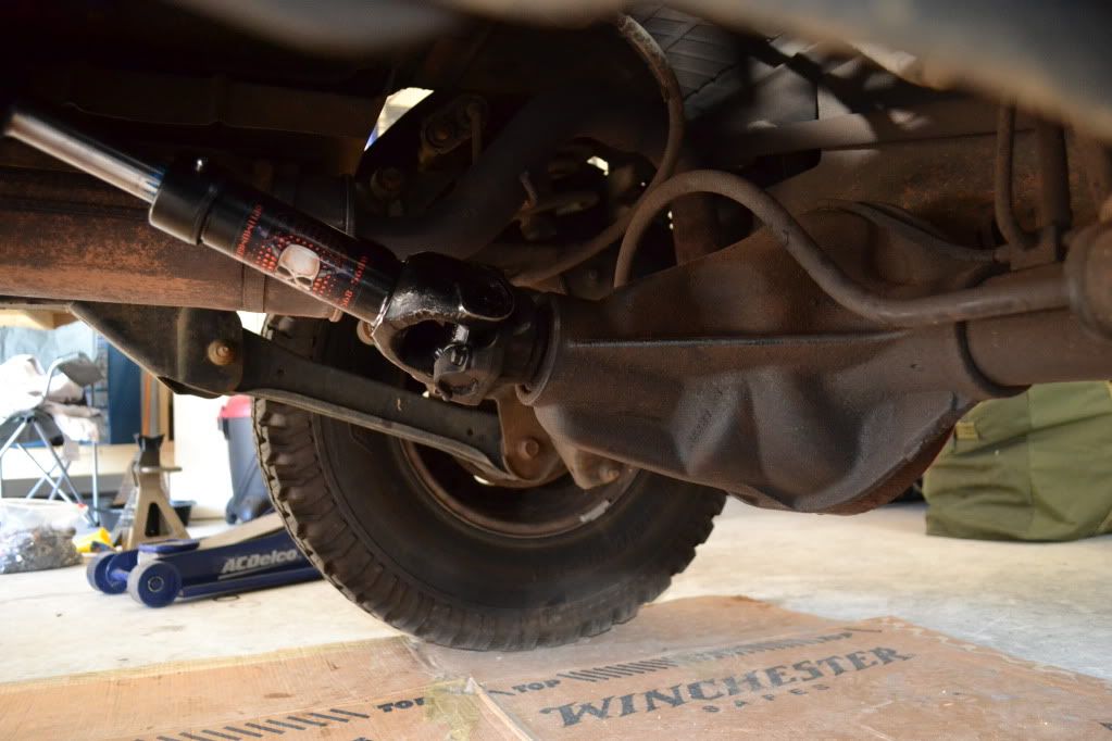

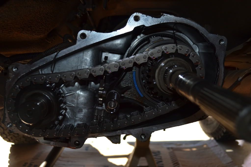

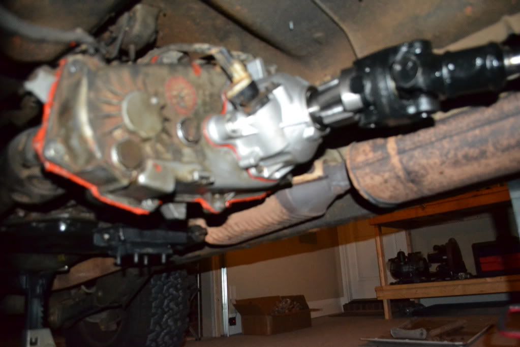

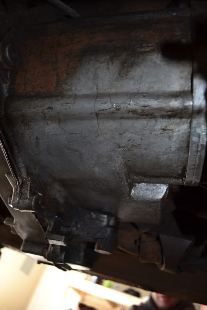

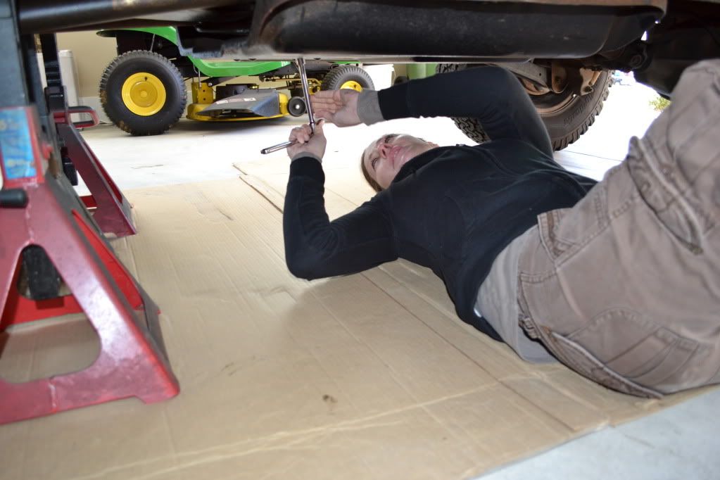

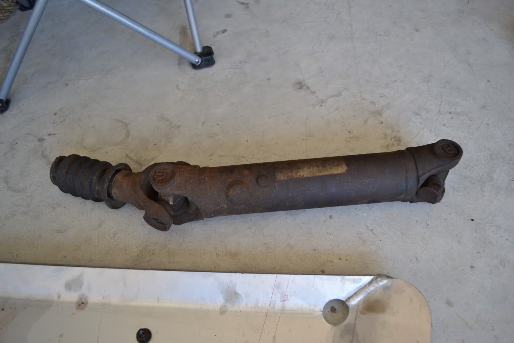

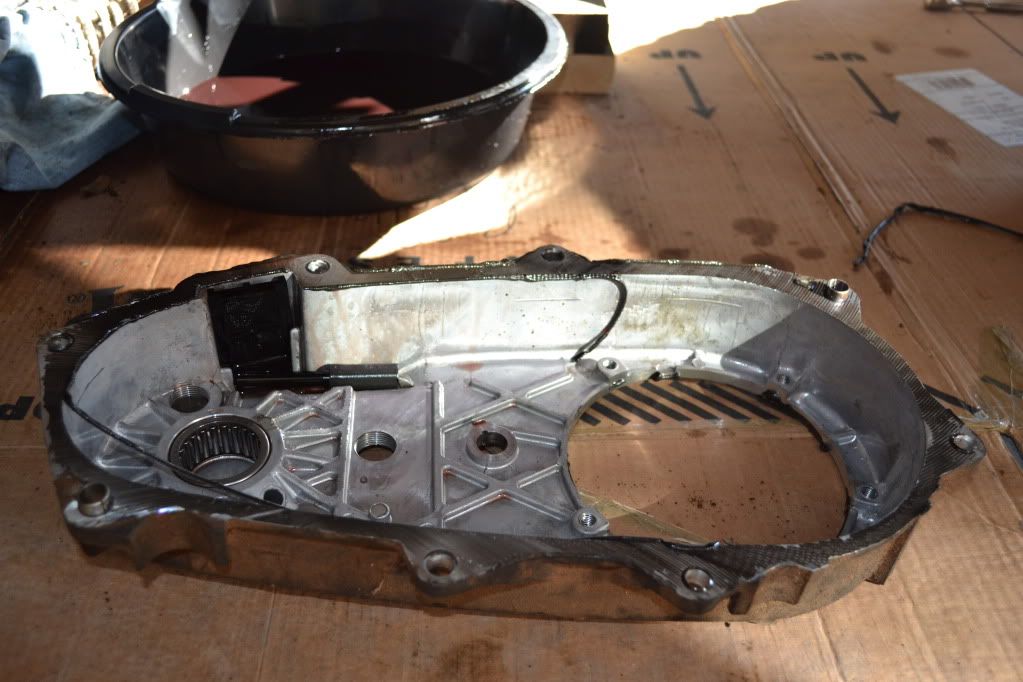

We spent all day today doing the slip yoke eliminator. Not bad just extremely time consuming. Everything went good except for when I resealed the TCase halves, got most the bolts in and realized we forgot to put the oil pump pickup in before hand. I was cussin up a storm . MAN THAT PISSED ME OFF!!!! :grin: Got it all back together, installed the drive shafts and called it quits for the night.
Fropleyqk is offline
post #10 of 50 Old 04-24-2012, 09:42 AM Thread Starter
Fropleyqk
Fropleyqk's Avatar
Join Date: Jun 2003
Location: Okinawa

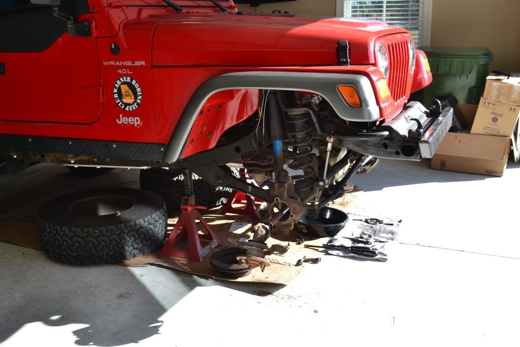

Posts: 4,491

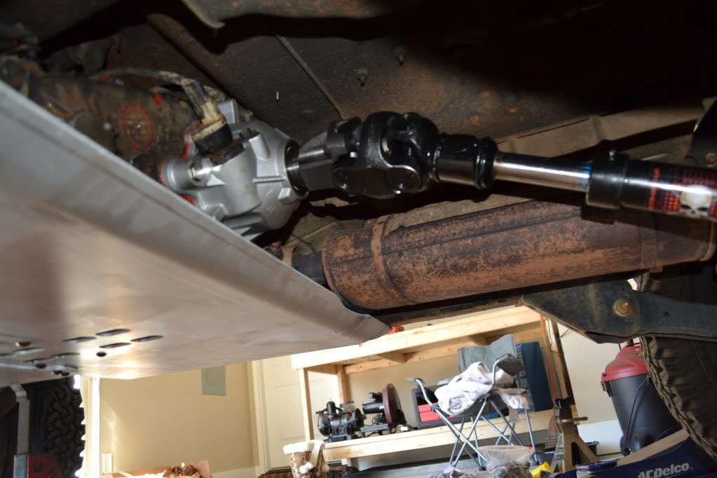

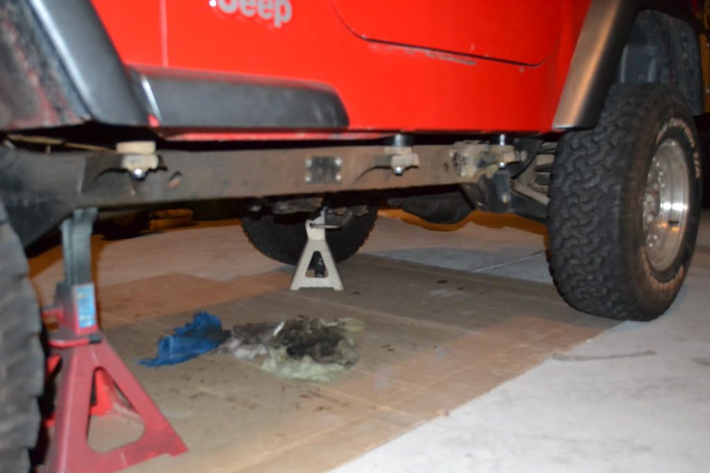

We got a bunch more done today. Finished up the SYE install and got the skids mounted back up. Its amazing how much belly clearance she has even at stock height. There are always a few weird things you run into when doing a tummy tuck and we have one: the muffler is rubbing on the passenger side upper control arm now. Not sure if its going to effect anything. We're just going to leave it and see what happens. Also, the bad news, I was hoping to get away without needing new upper rear control arms but it aint gunna fly like it is. The tummy tuck is the equivalent of a 3" lift when it comes to driveline angles. The rear pinion angle is pretty bad. We took her for a test ride and got serious vibes at 30mph. Going to need some adjustable CAs to rotate the pinion up before the next ride. Pics:

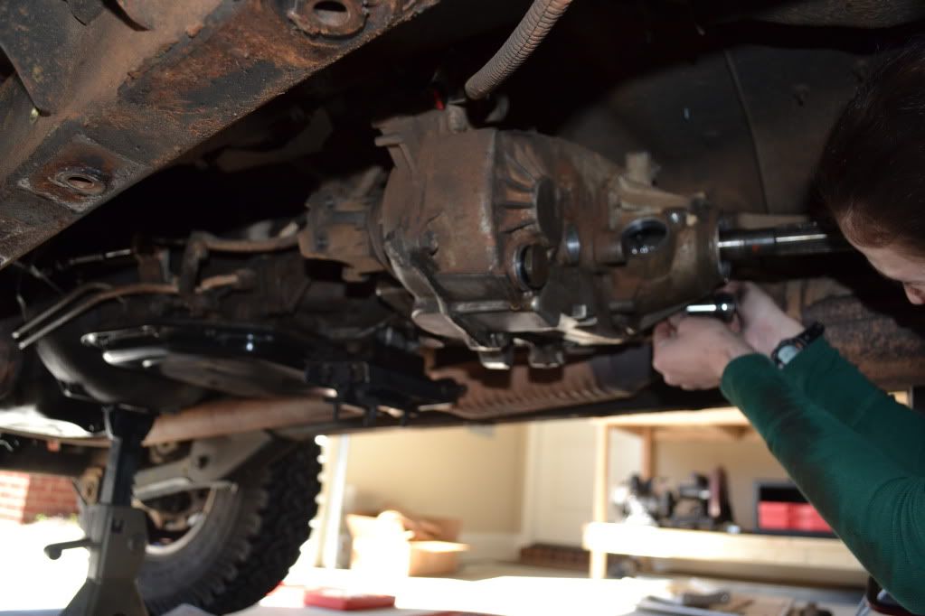

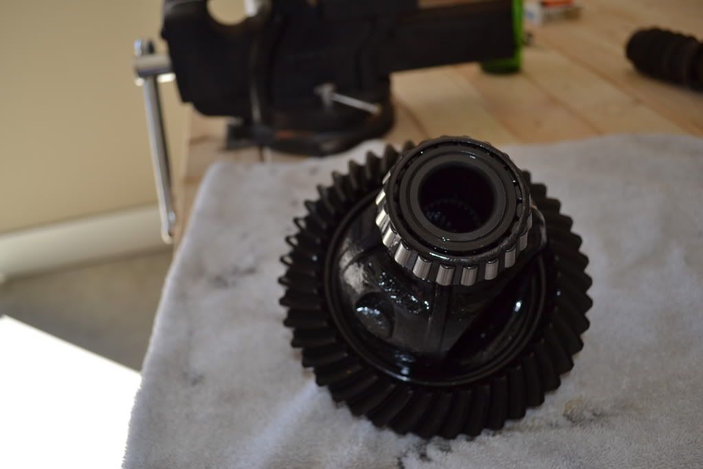

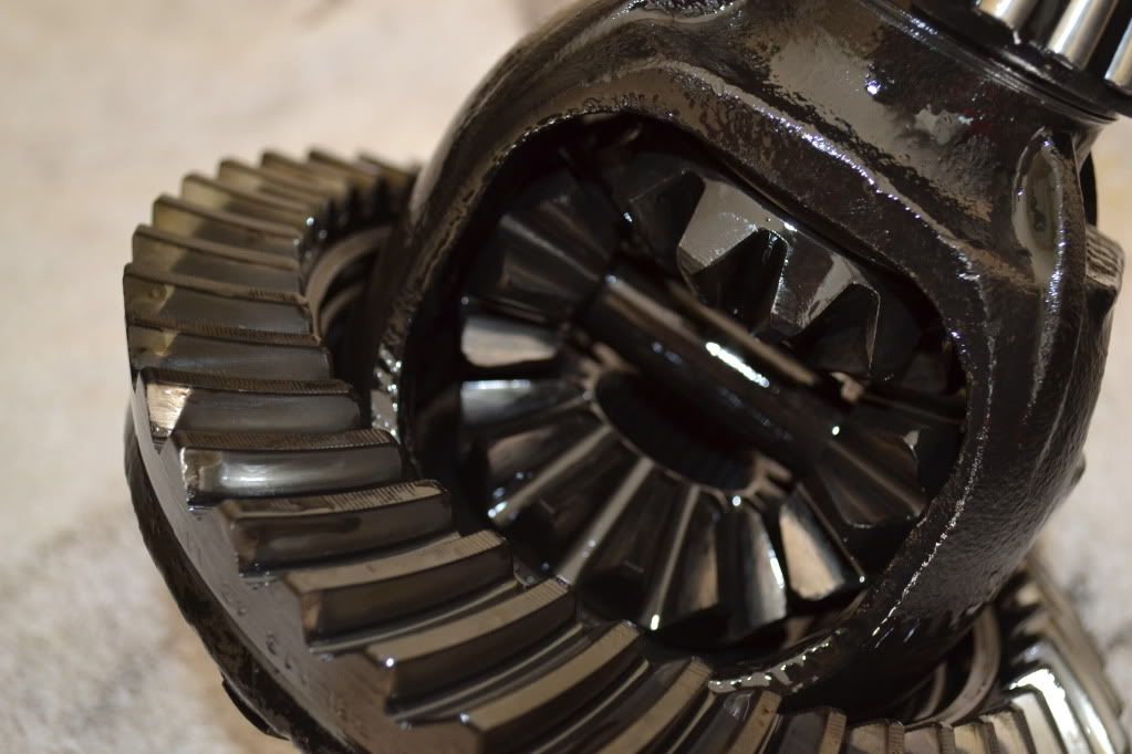

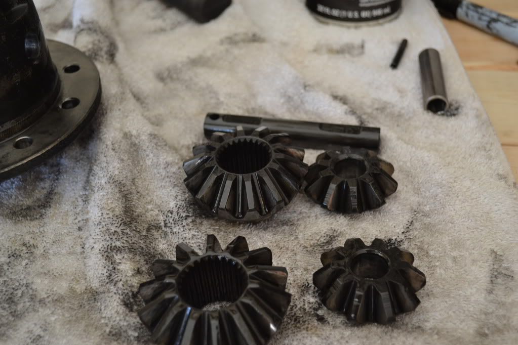

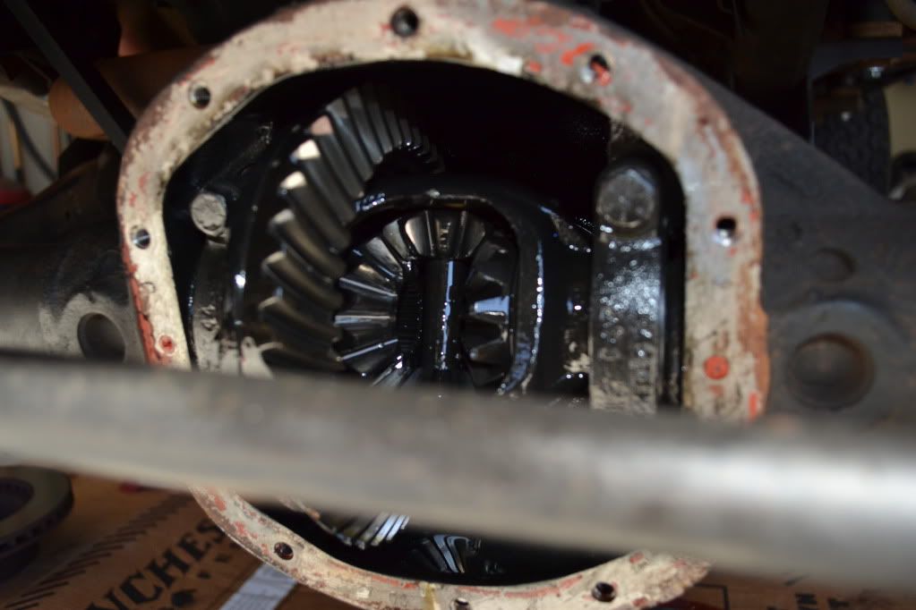

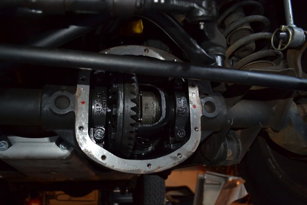

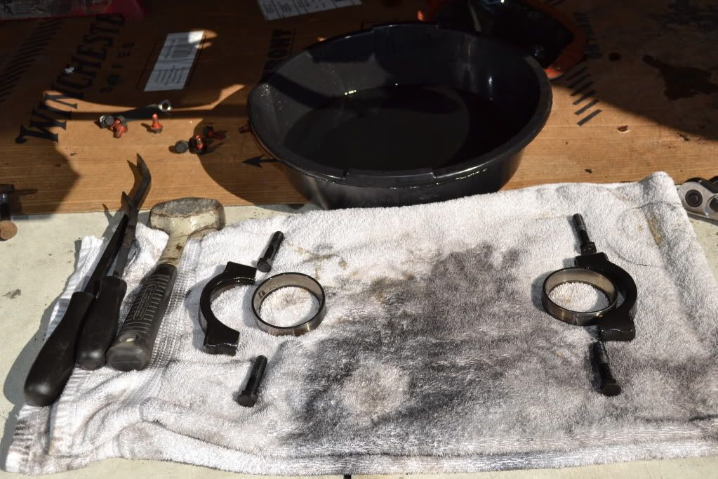

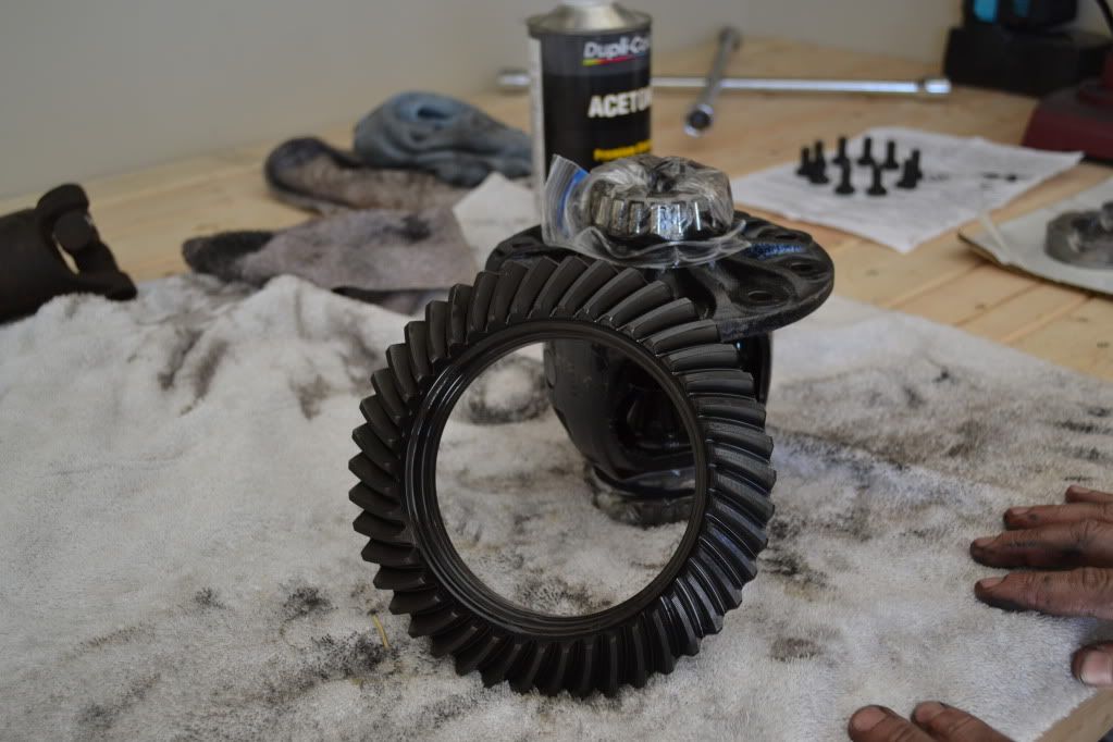

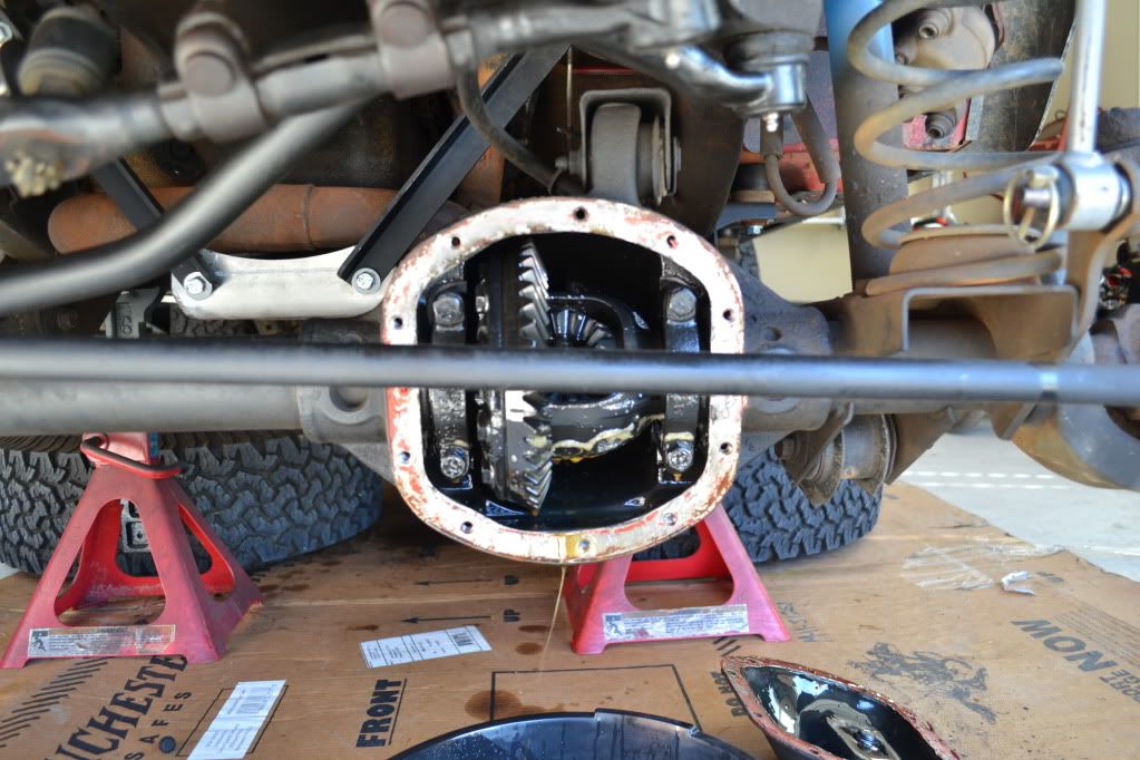

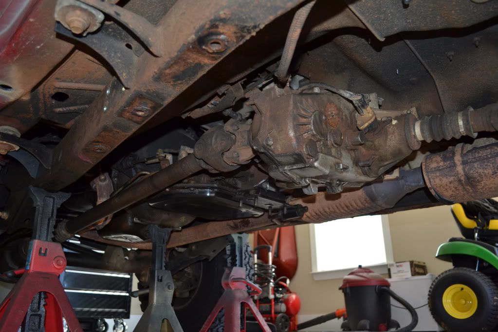

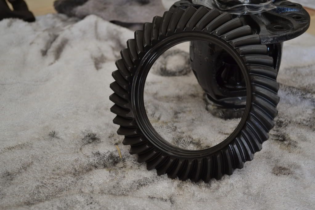

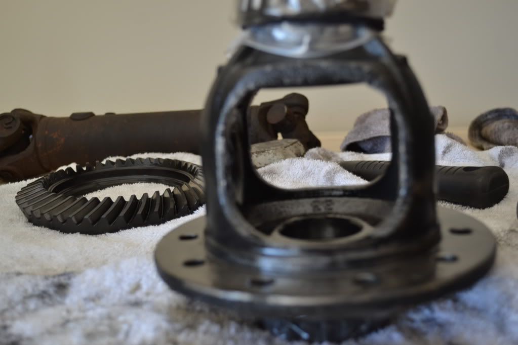

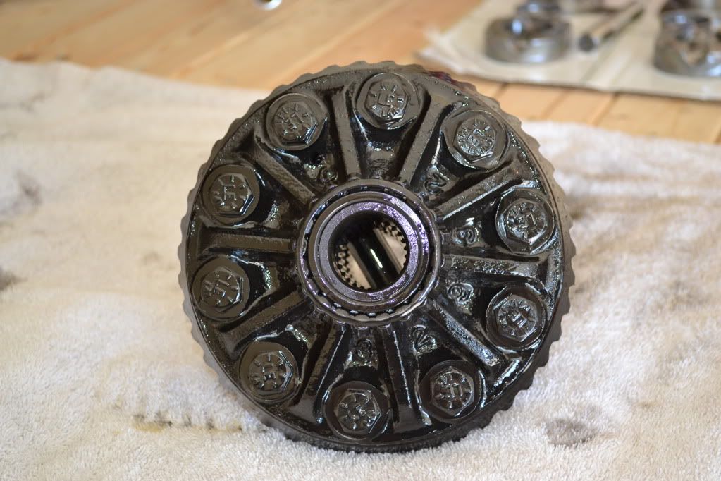

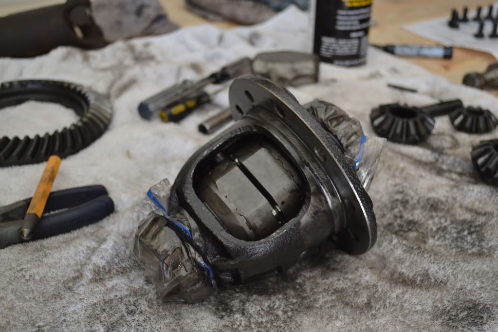

Also started on the locker install. It went really easy. Followed instructions on 2 different sites:
http://www.4x4xplor.com/aussielocker.html
Its an Aussie locker install but all the steps are the same until you get to the locker itself. When it came time for that, we just used the Spartan locker site:
http://www.ringpinion.com/Content/Ho...structions.pdf
It was actually really easy. We got to the point where the locker is installed in the carrier and called it quits for today. Got too much other stuff to do. We'll have the Jeep back together in about 45 minutes tomorrow. Kims going to go test the locker on some little crap right here in the neighborhood since we cant really go anywhere with the rear pinion be all jacked. Pics:
post #12 of 50 Old 04-24-2012, 09:45 AM Thread Starter
Fropleyqk
Fropleyqk's Avatar
Join Date: Jun 2003
Location: Okinawa
Posts: 4,491
Finished the locker install today. Very easy. I didnt take any pics really. Locker installed:

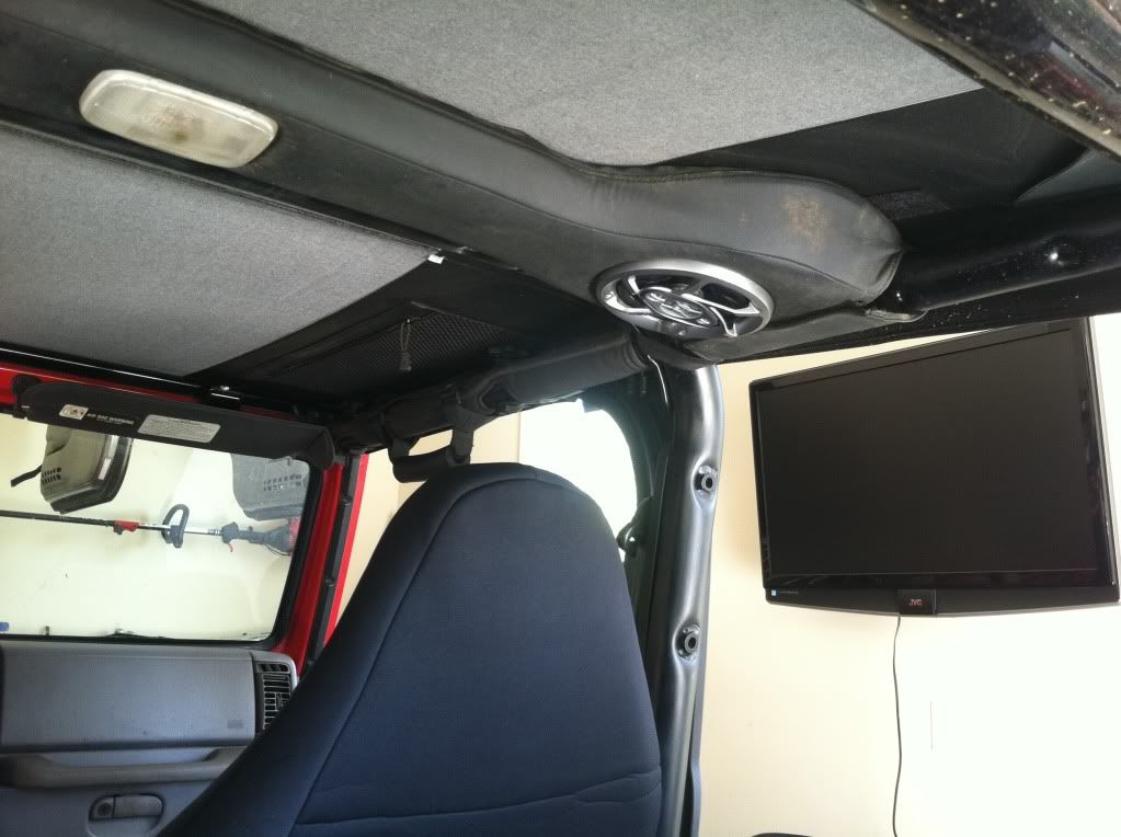

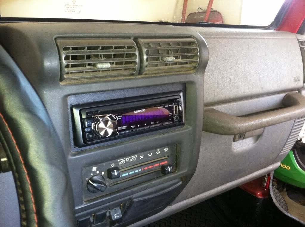

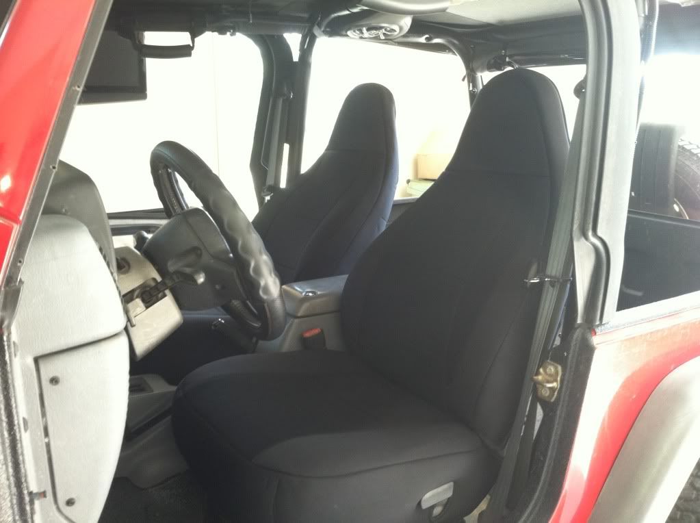

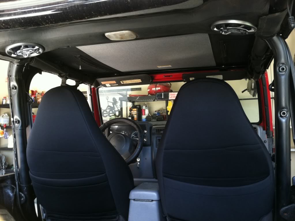

Finally got a working stereo going. Not sure what the PO did for his full time job but car audio was not it. Added a new deck and speakers. Didnt trust the stock wiring ran all new speaker wire as well. Stuffed everything with polyfill and, holy crap, its sounds damn good for the $$$ invested.
I also went ahead and gave Kim one of her B-Day presents early... neoprene seat covers! She's been wanting to cover those eye sores for quite a while:
