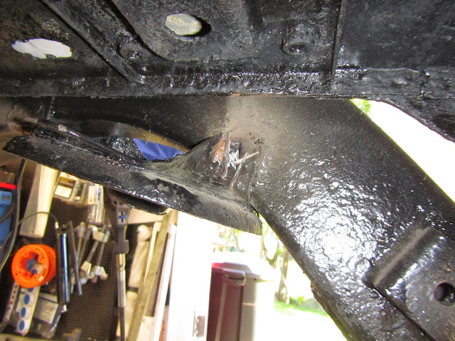

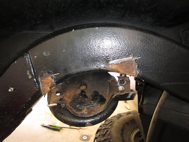

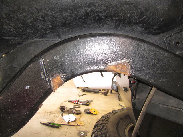

Originally Posted by IceKnight View Post
Next came time to remove the brackets on the axle that where way off from where they should have been. My brother was over so he helped me get those removed.
It took much longer then I expected to get everything cut off and cleaned up. But it got done.
I just tossed the upper part of the truss on to see how it lined up and it fit perfectly. The keyed truss system they have is really nice, definitely allows for a easy set up.
After playing with that for a bit and checking out what was going to be trimmed and adjusted on the housing itself, I turned my attention to the next big thing...the Rokmen rear spring re-locators.
This is how the spring looked before.
The curve in the spring does nothing good for anyone, so on to cutting.
First up is the tub, I raised it up just with a 2x4 to get extra working room on the inside frame rail. That extra little bit made all the difference
Its a tight fit cutting on the inside of the frame but a Dremel did work alright.
Only about half way through here.
After that I moved on to the outside of the frame and used a cut off wheel and a chisel to remove the rest.
Cleaned up the frame rail and it was ready for installation.
Welded up the new spring perches.
