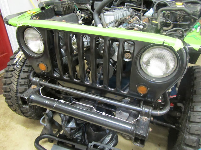

So to catch up with the lighting here are my front indicator lights all installed along with the markers.
I also got my brake/turns done out back as well and added some single very hidden led's for reverse lights. I got some power into the harness and everything works fantastically ...say for needing a proper led indicator relay.

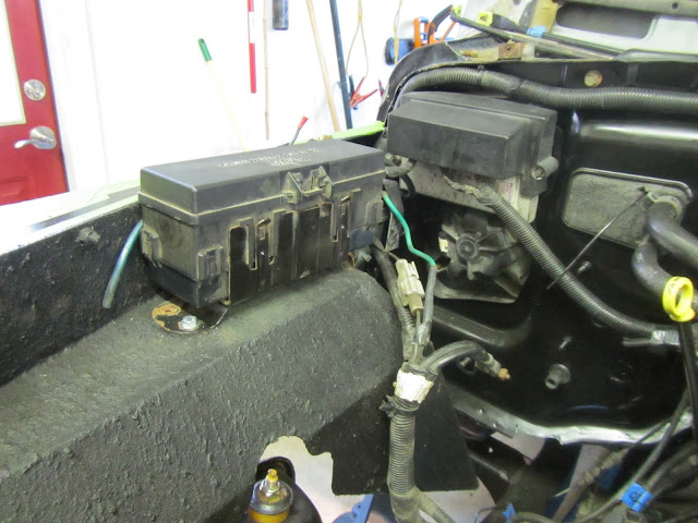

With a small amount of "bracket adjusting" using only the most specialized of tools (cutoff wheel and a hammer) I was able to get the fuse box and fuel system components to fit.

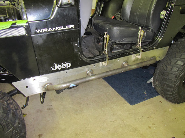

So sort of awesome news. My amazing wife once again slipped a fast one by me and ordered up my rocker guards last week and they showed up yesterday I must say I think she wants this thing done as much as I do.
As per normal awesome welds from Rokmen. These things are beefy landing at a nice hefty 42lbs each. bye bye any hope of mpg's
Because of the Rokmen fenders and the extra wheel well space they afford me, I do have some trimming to do to make them fit perfectly.

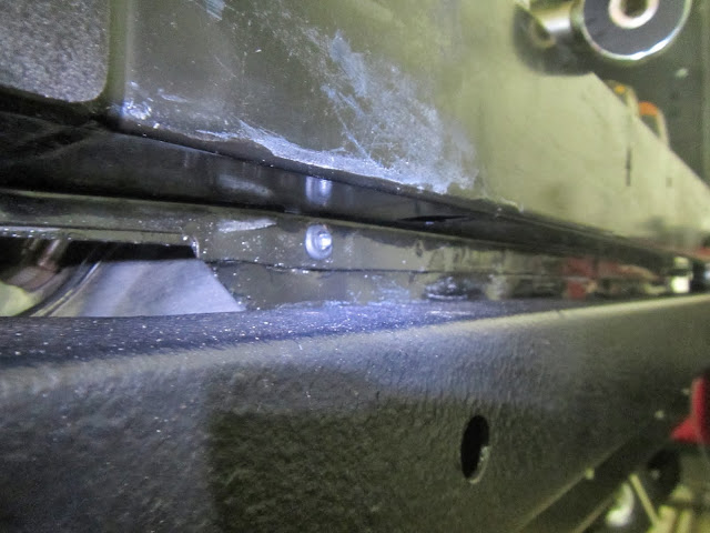

So conveniently enough the same day she ordered my rocker guards was the same day I ordered my steering box skid from Rokmen. Which I was going to install last night but that's just not going to work apparently. I need to figure out which side to cut/grind down to make this thing fit.
My front recovery point on the drivers side is juuust in the way a little. I'm thinking grinding the skid (which unfortunately came powered coated) because I think grinding any beef off a recovery point seems not so intelligent. What do you guys think?

Depends on how thick the point is....

Do you have more pics of relocating the evap stuff?
Here are a few pics I took tonight.
I ended up taking everything apart, cutting off this part of the mounting bracket and drilling a few holes to mount it with some hardware and put it back together on the fender. Things are close but everything thing fits and it's sturdy enough.

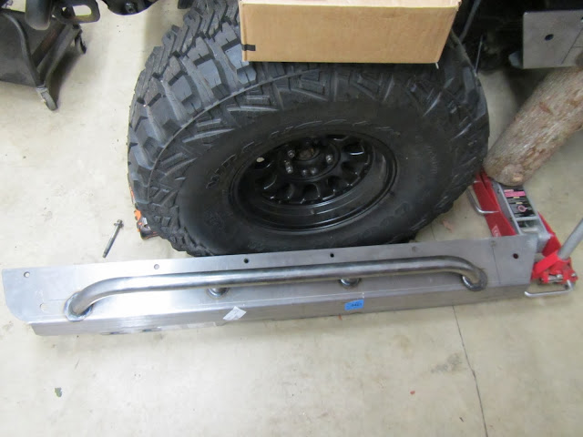

I also got my rear bumper in. Needs a little more clearance for perfect fitment before getting painted which Ill be taking care of later on this week.
I also measured the front bumper where the tow hook is and its just over 1/2 inch, so Ill be doing a small amount of grinding on that for proper fitment of the steering skid.

I spent the day in the garage and got my rear bumper fitted, along with my rocker guards and the steering box guard (what a pain this was because of my bumper). Now I have to remove it all and get it painted.
