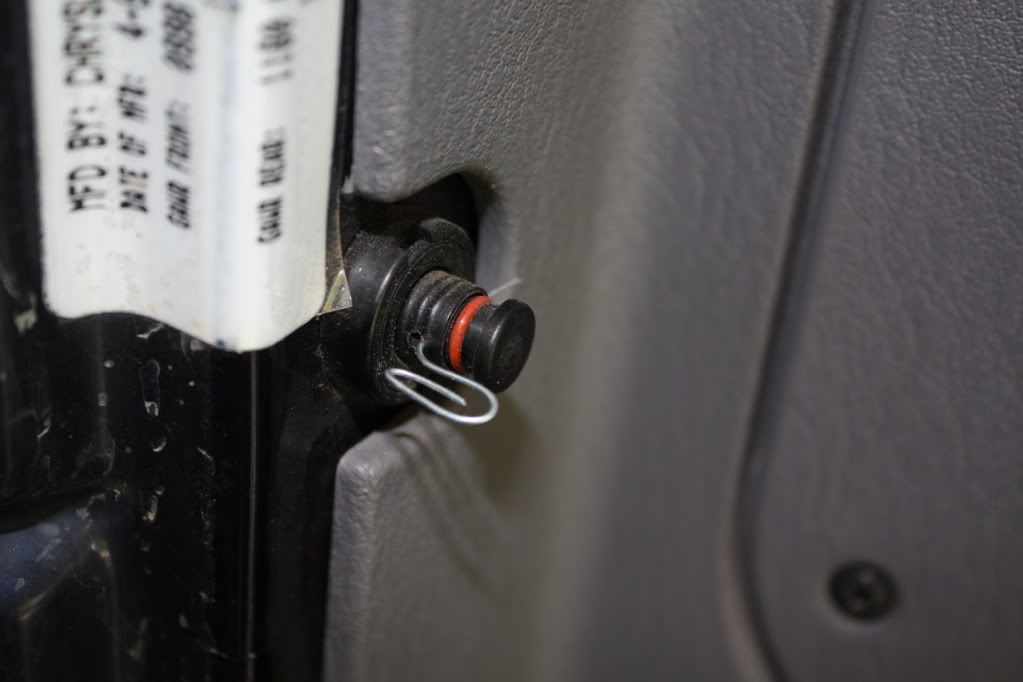

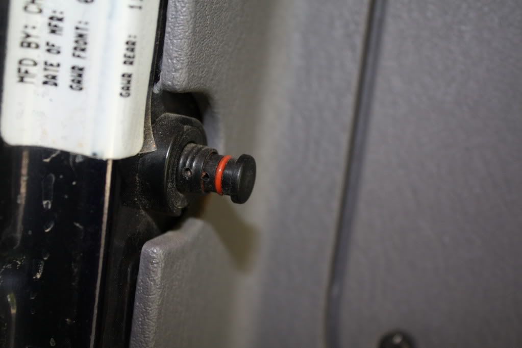

first, i did this for the dome light/courtesy lights when the doors are off, since summer is coming, and i got tired of pulling that fuse.
drilled a hole through the button...

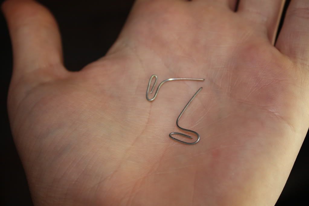

so i could fit these through. i just took some steel wire and bent it into this shape

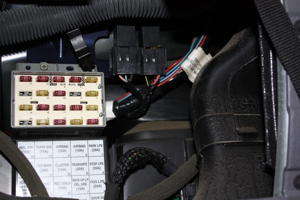

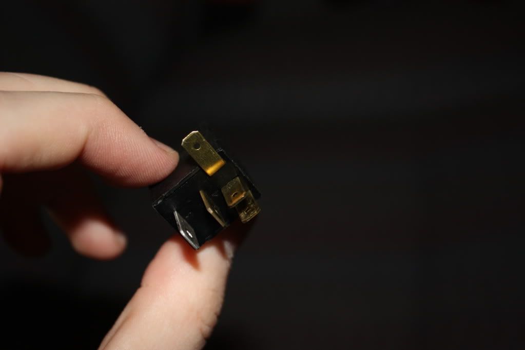

also, bent this piece on the fog light relay so i could run fog lights and hi beams at the same time
here you can see where it is located on 97-2002 TJ's. its that little black box to the upper right of the fuse block, its got two relays sticking out of it, the one to remove is the one on the right

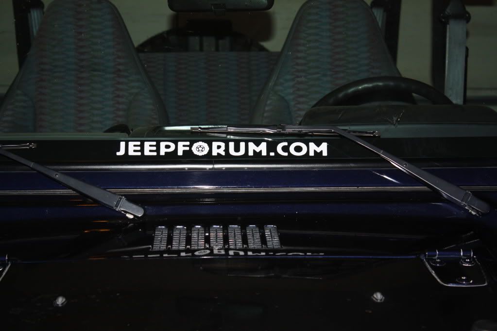

got my JF sticker a few days ago
also, i just graduated highschool, and my mom got me a winch for my graduation gift. i'll get pics when it comes

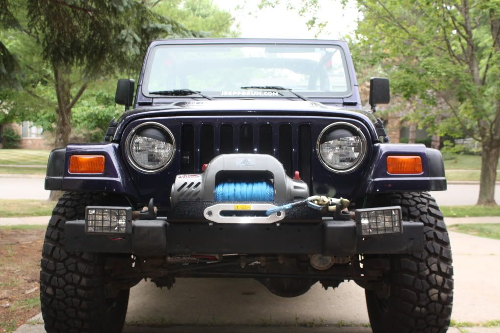

alright so it started raining today, so i wont get a chance to wash the jeep real well. but before it started raining, i managed to get a pic of the winch all hooked up
also, in case you didnt notice, i also made it angry

i like that winch, looks good, how much did the winch run you w/ the synthetic line?

thanks! i got it in during a sale. the winch, synth line, snatch black, hook, gloves, wired and wireless remotes all ran me $550 shipped. the sale ended over a month ago, but here's the thread FWIW
