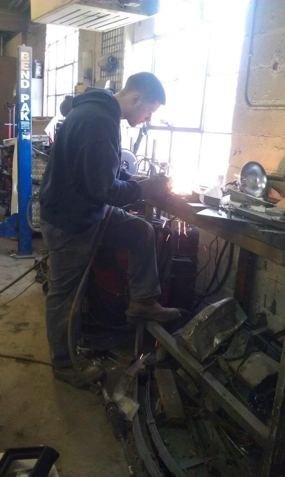

UPDATE: Almost finished, but two silly mistakes held us up. Yesterday we had trouble drilling out the spring plates and I had to wait until today for a machine shop to be able to do it.
Keith at AW Fab in Woburn (who I can't recommend highly enough, btw. Great guys, great work, and as XJ guys, know Jeeps well) opened up the spring plate holes in 10 minutes with a plasma cutter what would have taken me a whole evening to do with a drill.
And today I couldn't start until 4, and at 6:30 when we couldn't get the brake lines to bleed fully, I realized I had the calipers on the wrong sides.
