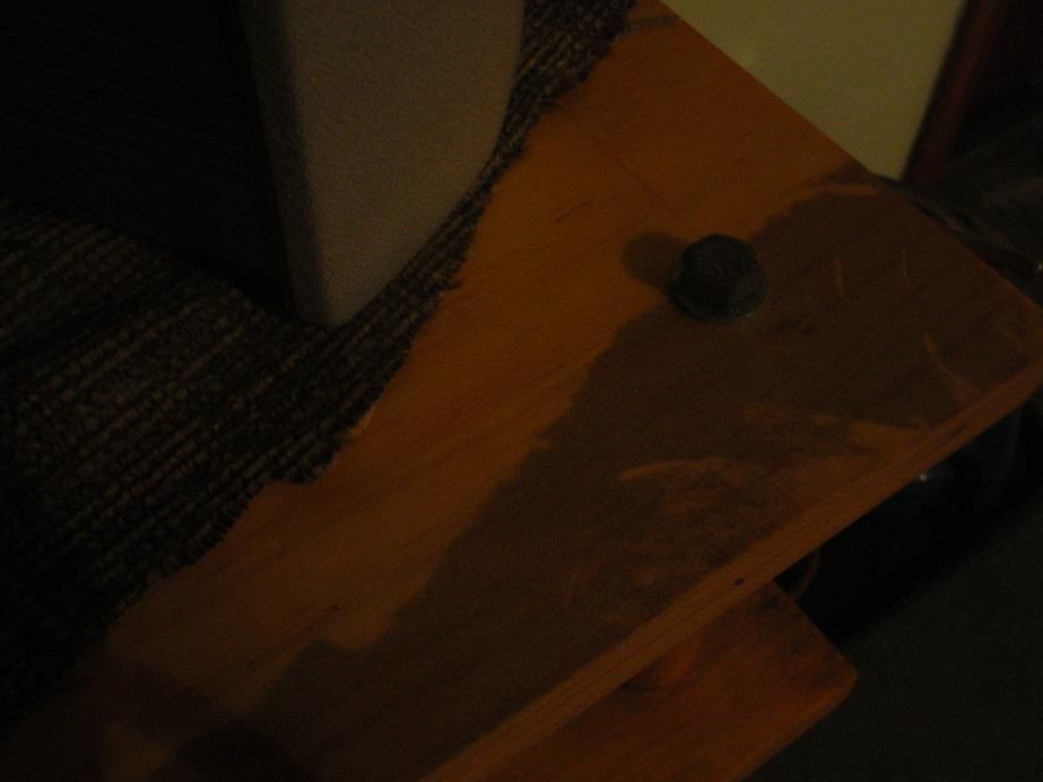

I should probably make a technical update before this thread gets tossed into GD, ha ha.
I have been doing a bit of work on the 8.8, but I've started a freelance design project that I'm trying to give attention to first, so here's the progress report:
Opened the 8.8 up and confirmed gearing and Aussie locker
(Don't open a diff in the house, btw. All 3 floors smelled like gear oil for a week. It was dreadful.)
Wirewheeled and flapdisc'd it clean. I don't have any pictures of the finished product unfortunately, but here's what every surface in my basement now looks like:
....so you get the idea.

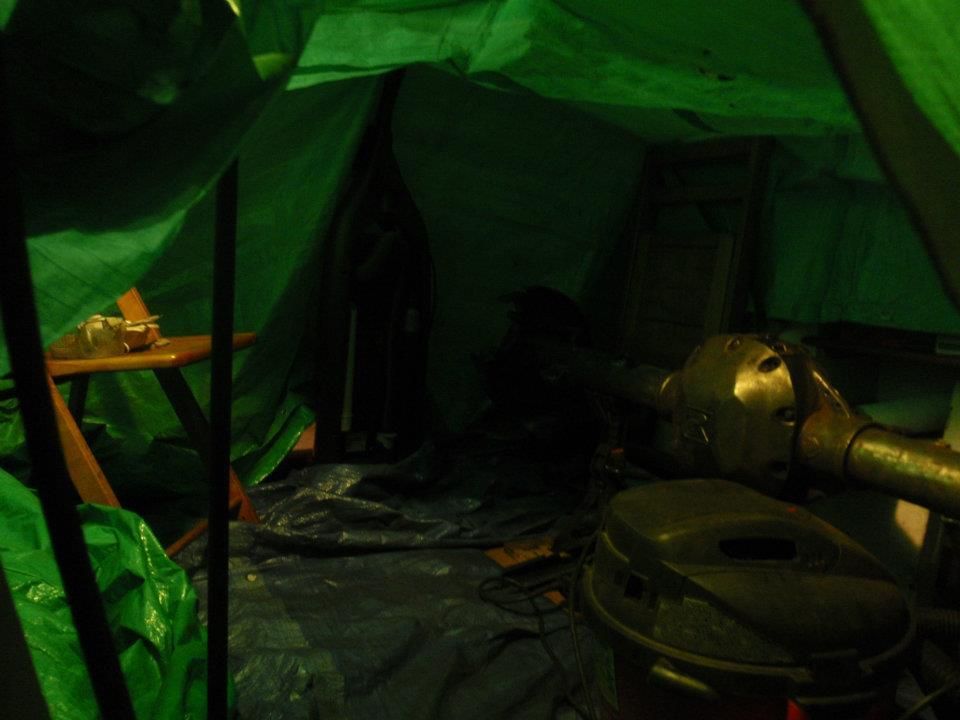

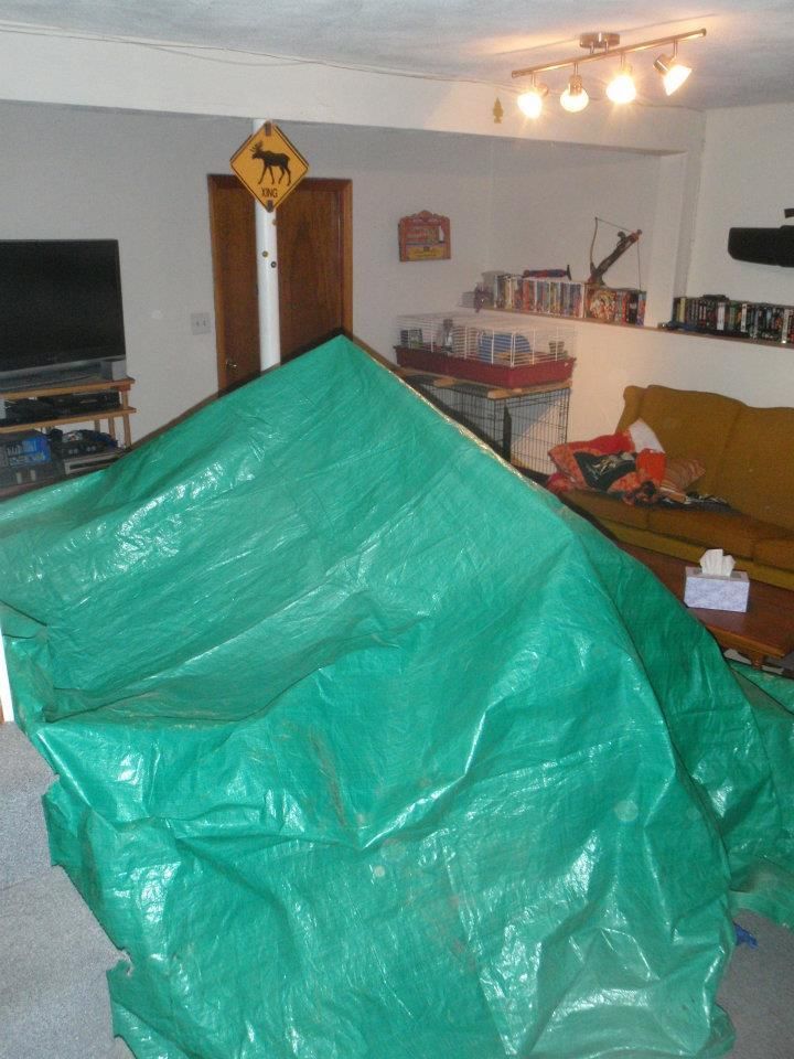

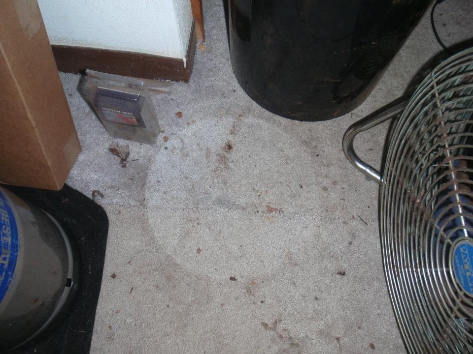

This trash can was a room away and next to the fan that was supposed to be blowing dust out the door and it still looked like this when I moved it.
Yeah.....the wife was not happy about that one.
My attempt at a solution was to use a giant-*** tarp to create a tented working area.
And it worked adequately, but I'm still not going to attempt wirewheeling an axle inside again. For the D30, I will just wait until nice days and bring the axle outside, neighbors/HOA be damned.
Once I had it cleaned, I Rustoleum Rust-Reformer'ed the perches and shock mounts and other areas I couldn't get the wheel to and any cast areas.
Then I coated everything in self-etching primer
Including the calipers (I bought new calipers, rotors, and pads for it), which I'm planning on doing, along with diff covers, in a yellow to match the "Jeep" logo on the tub.
And that's where I stand. Hopefully this weekend I'll get a chance to do the black engine enamel on the axle, which will let me take off the diff cover to do it and the calipers soon.

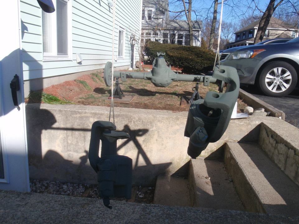

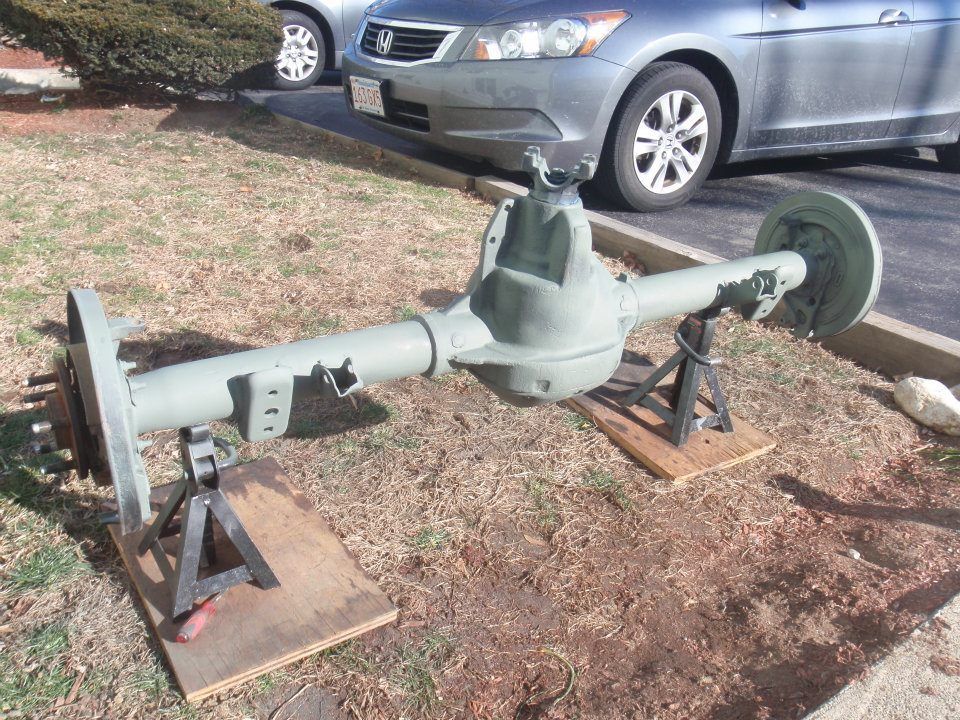

Status update on the axles:

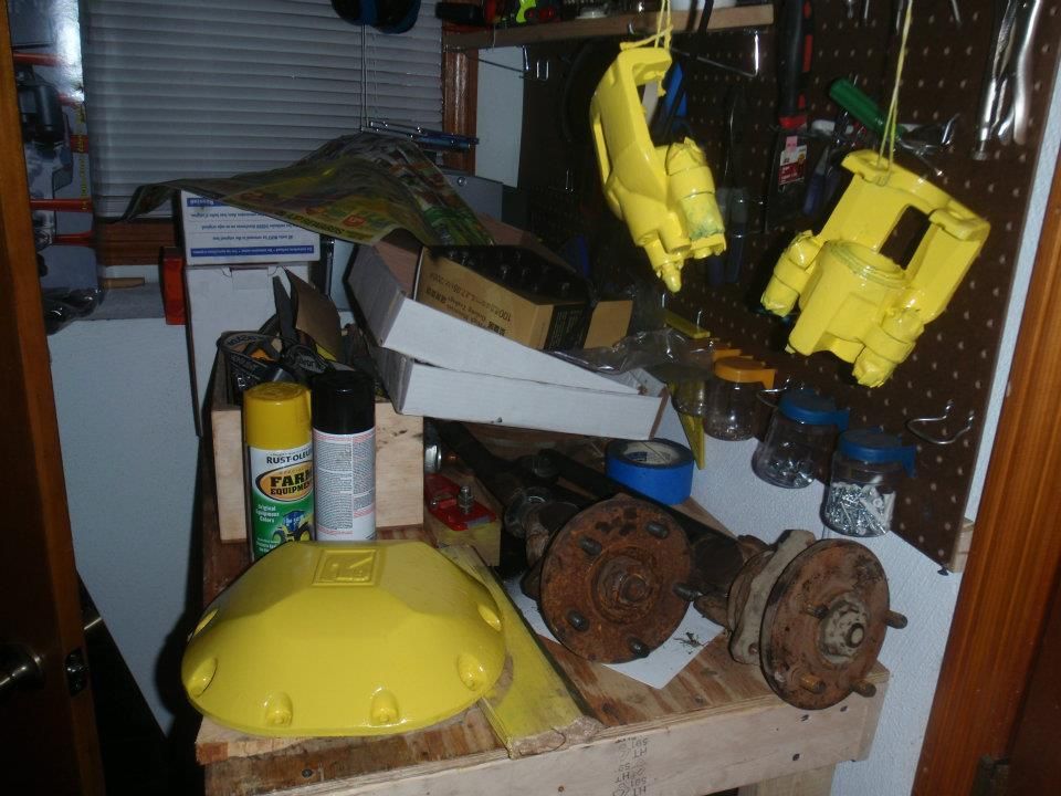

Coated it with Rustoleum Engine Enamel, with the exception of the diff cover and the calipers, which I will eventually do in Rustoleum "Farm Equipment" Enamel (which is just a fancy way of saying the colors match John Deere equipment)
Also got a great deal on a pretty much new D30 Aussie locker from a guy here on JeepForum, which is awesome because they're prettymuch out of stock *everywhere* if I tried to find one new.
Should be coming in the next week or so.
All that's left on the 8.8 is to paint the diff cover and calipers, get my back ordered u-bolts, order shims (I actually need to point the pinion *down* more, as the original rig was on 37s) and get 1300 series pinion yoke u-bolts for the driveshaft, and modify the e-brake to work once it's in.

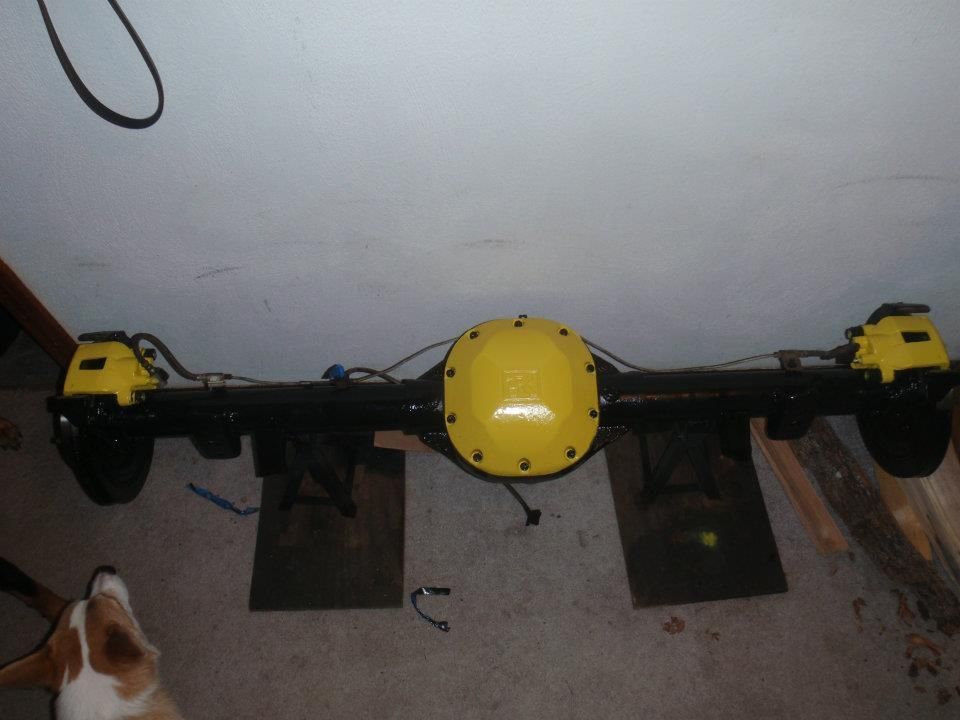

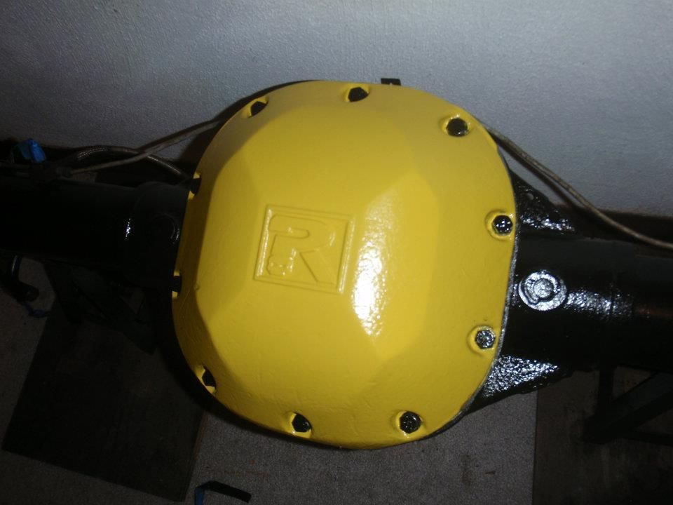

Had a pretty productive/positive night last night!

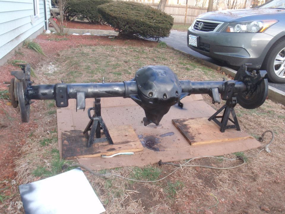

Finished-ish the final coat of paint on the 8.8 components
(It *really* didn't want to stick to the primer for some reason. It just dripped right off on the first 3 coats, leaving large areas with green patches. Very weird. A bunch of coats later, it's good enough for me not to care anymore, ha ha.

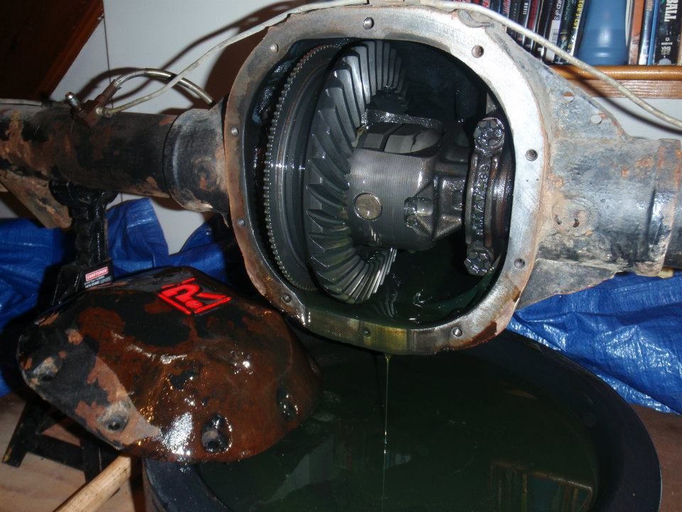

Then I decided to do some some of the inital prep-work on the 30.

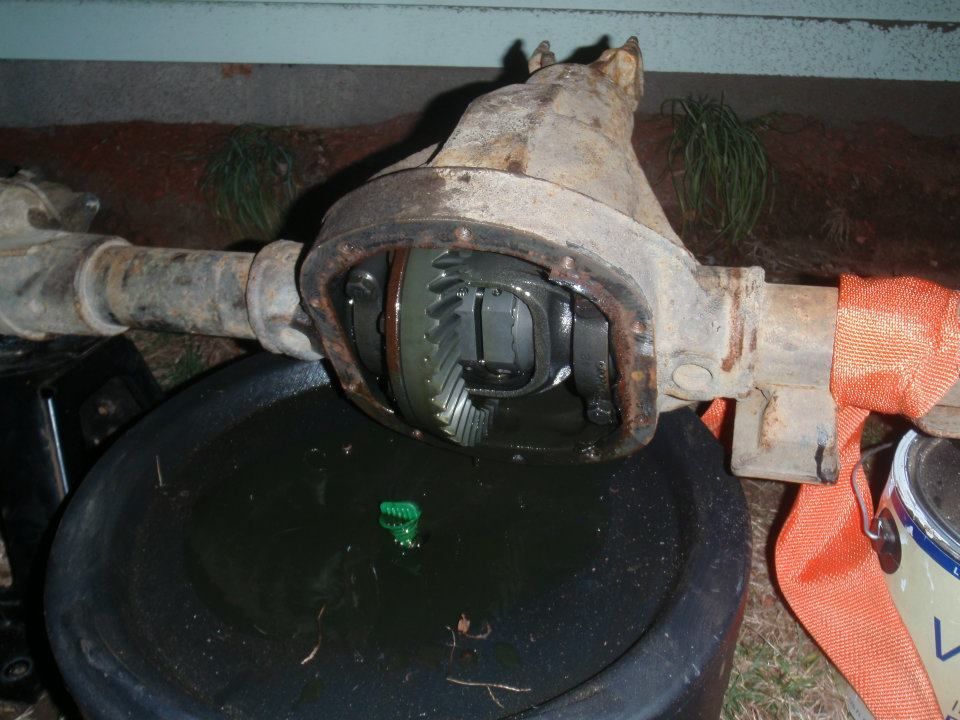

I opened up the diff to drain the fluid and verify gear ration, and....SURPRISE!
It appears I didn't need to buy that Aussie after all! The guy who sold it to me said it has a "posi-locker", which I assumed meant he didn't know what a posi-loc was. (He also said a knuckle might need replacing because gear oil had leaked, so I took everything with a grain of salt)
I know a couple of guys who may be looking for one, and Aussies are sold out everywhere, so it's alright. I'm sure I can find a buyer.
I did notice however, that there was one tooth chipped on the ring gear. That should be fine, right?

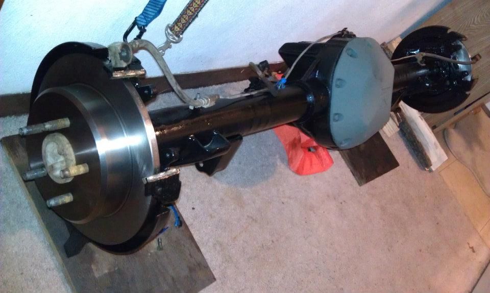

In other news, I mocked up the axle last night with the painted components:
I'm pretty with happy how it's going to look for the 2 seconds before it's dirty forever, ha ha.
