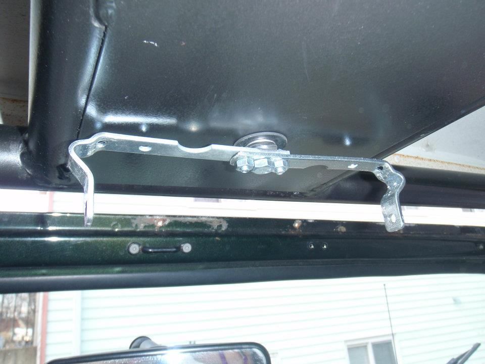

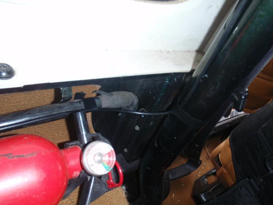

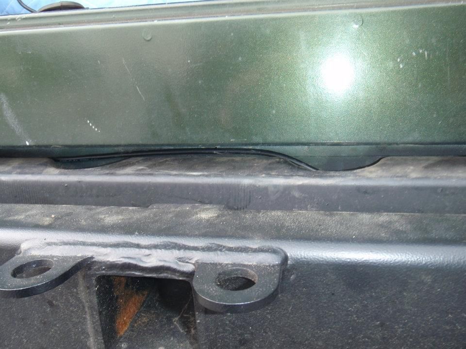

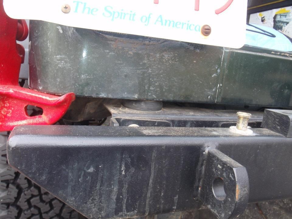

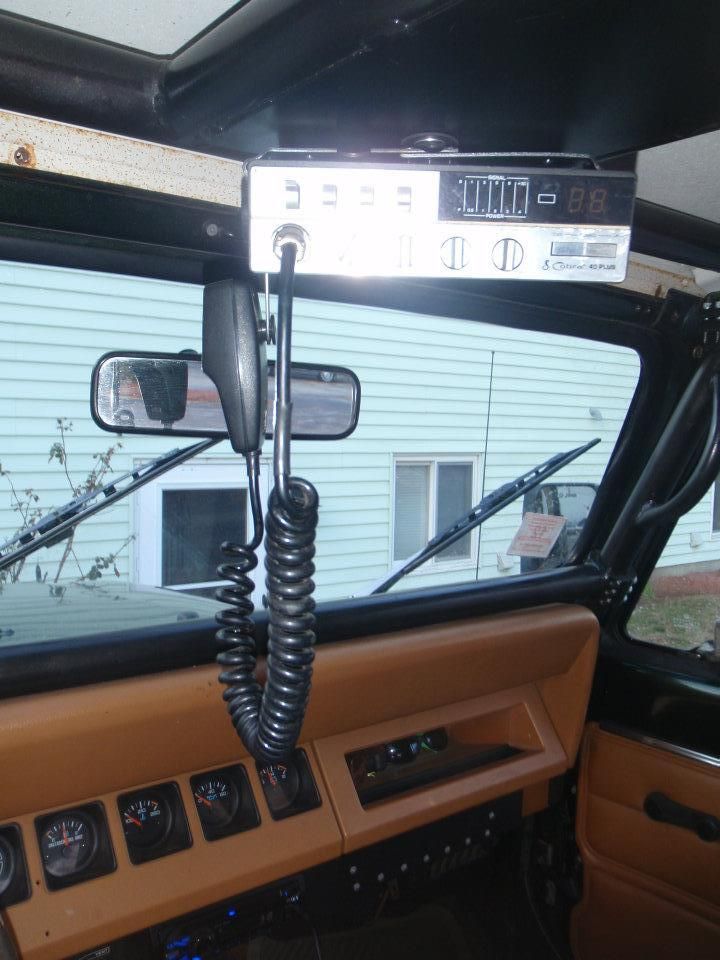

I installed my new CB and antenna last week.
Now all tuned up thanks to a little help from DJFlyy!
I was pretty happy with the cord routing I did. I ran it behind the body mount, and across the space behind the crossmember
In order to get the connecter in the space between the crossmember and tub, I had to jack the body up slightly to open it up.

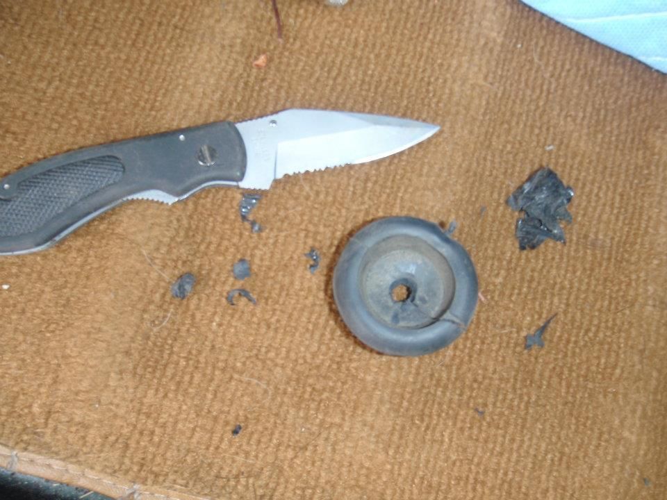

Then I ran it up through the rear quarter panel and through the grommet that the current electrical connections go through (I had to slit the gromett and carve out the opening to make room for it)
I then ran it along the existing electrical lines, up the rollbar, and across the t-bar on the sport-cage to where I wanted to mount the CB.

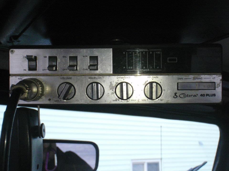

My father-in-law gave me his old CB radio from the early 80s that he used to use on road trips with the family, so it fits right in with the YJ!
I made the bracket for it out of the leftover pieces from the winch (we mounted it over the solenoid instead of the cable and had the brackets left over). I hand-bent the brackets to a functional shape so that the holes would line up to put two bolts through, then I drilled another hole to put a bolt/rubber grommet/washer/rubber washers though the hole I drilled through the t-channel. Perfect length! No coiling needed for the 18' cord!
And the final setup!
(The power is just a 12v plug. I may or may not hardwire it in at some point.)

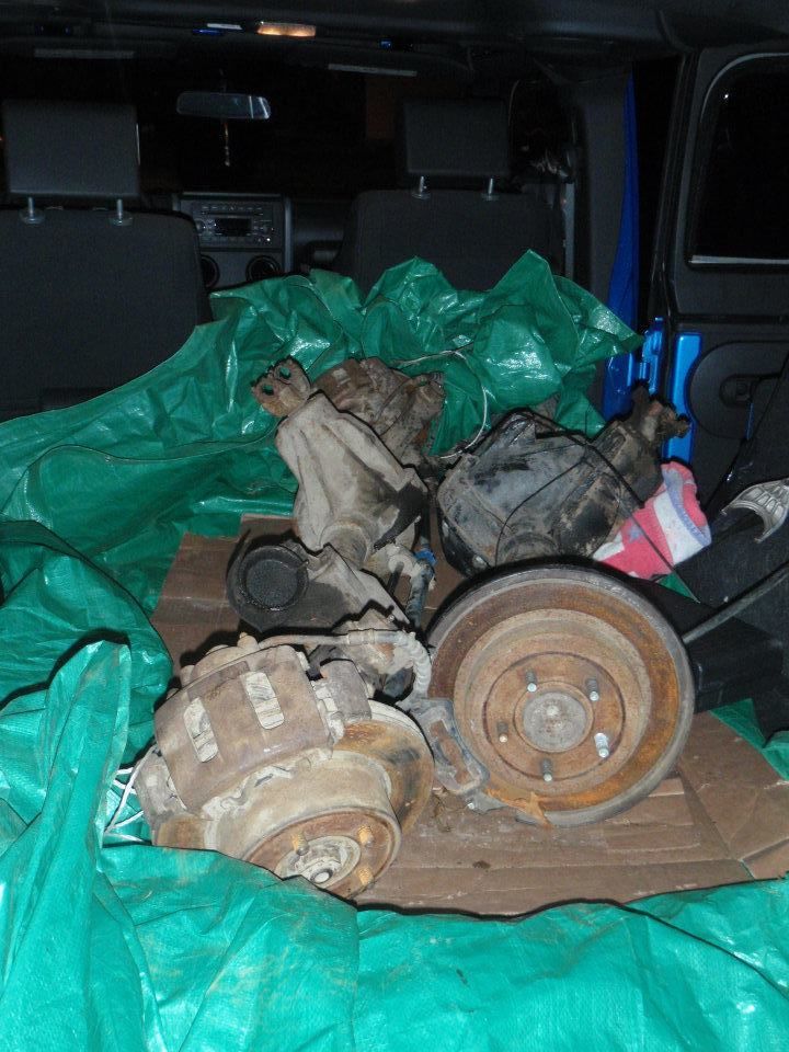

In other news, goodgoshdarn I love having a 4-door!
And now all set up in the house (my poor wife, ha ha), ready to start working on...
