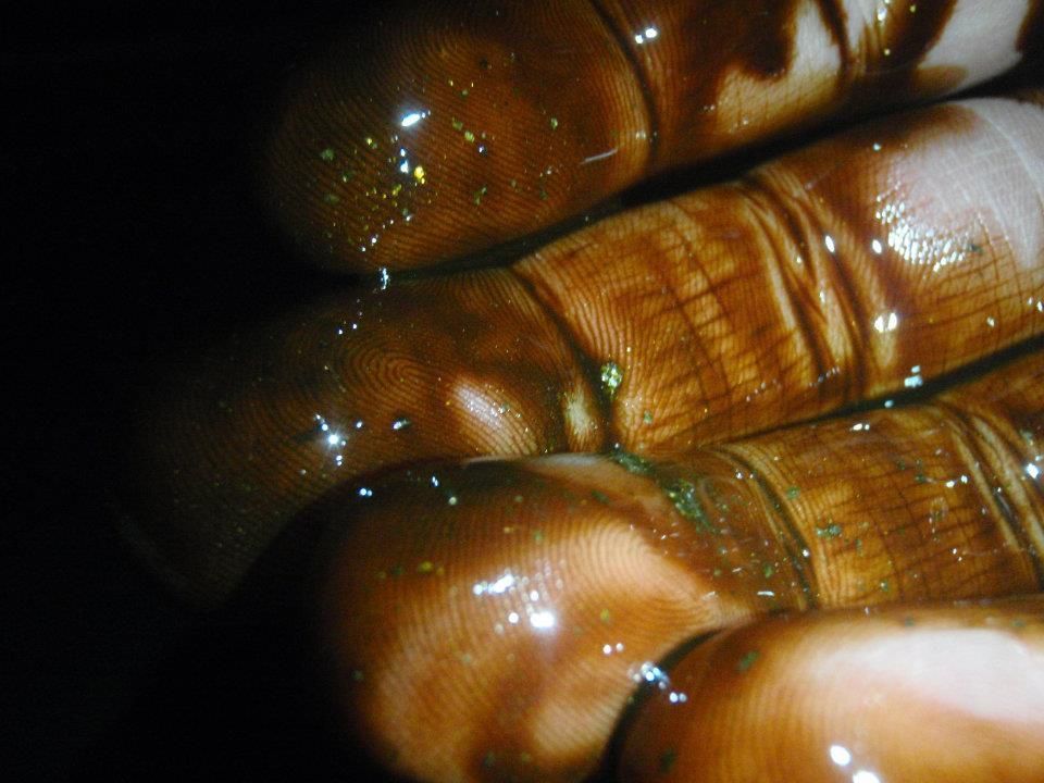

Changed my tranny fluid (less than 20k since my flush, about a year and a half)
That's never good.....

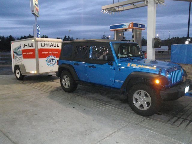

I feel like I'm always posting a couple events behind what's going on, but here goes:
Towing stuff back from NY was awesome and super easy:
Constantly amazed at the amount of room in that thing:

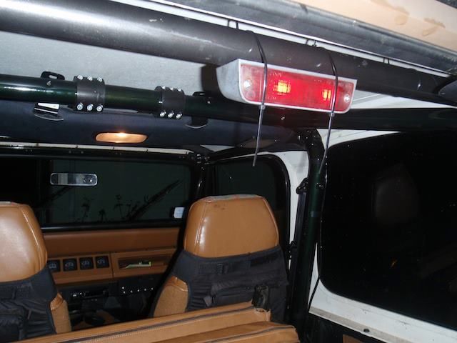

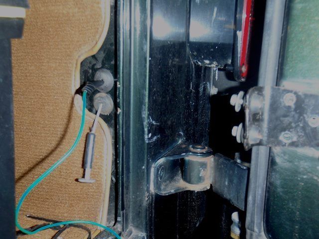

Next: Relocated my third brake light to it's final/permanent location on the sport cage. I removed the bracket with the tailgate contacts that hit the contacts in the tub:
Then I spliced in new wires and ran it up to top:
This is how it looks now (except that I trimmed the zip-ties obviously):
Very functional!

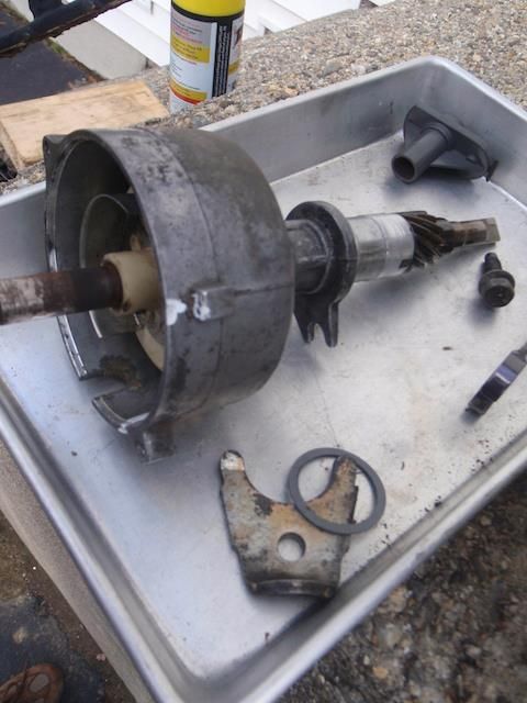

When I reset my timing a while ago, I didn't have a new gasket for the distributor and thought "oh, it'll be fine". Well, it's been seeping enough to start dripping on the driveway and smelling like burnt oil every time I drive. Got sick of it and finally RTVed a new gasket in. Quick and easy, can't believe it took me this long to get around to it.

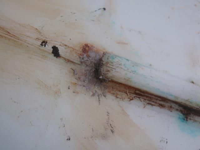

Next I tried to patch up my windsheld washer fluid resevior, as I can only fill it up like a third before it starts leaking everywhere. I tried JB weld and superglue, but it's still leaking. Suggestions?

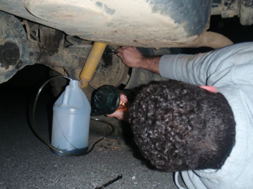

And helped a member of our club bleed his brakes after a leak on the run this weekend. The bolt of the front passenger caliper has loosened, leaked, and let air into the lines rendering them almost useless. We did all 4 wheels, although only the FP had air. The fluid was little funky colored, though, so it was worth doing anyhow.
