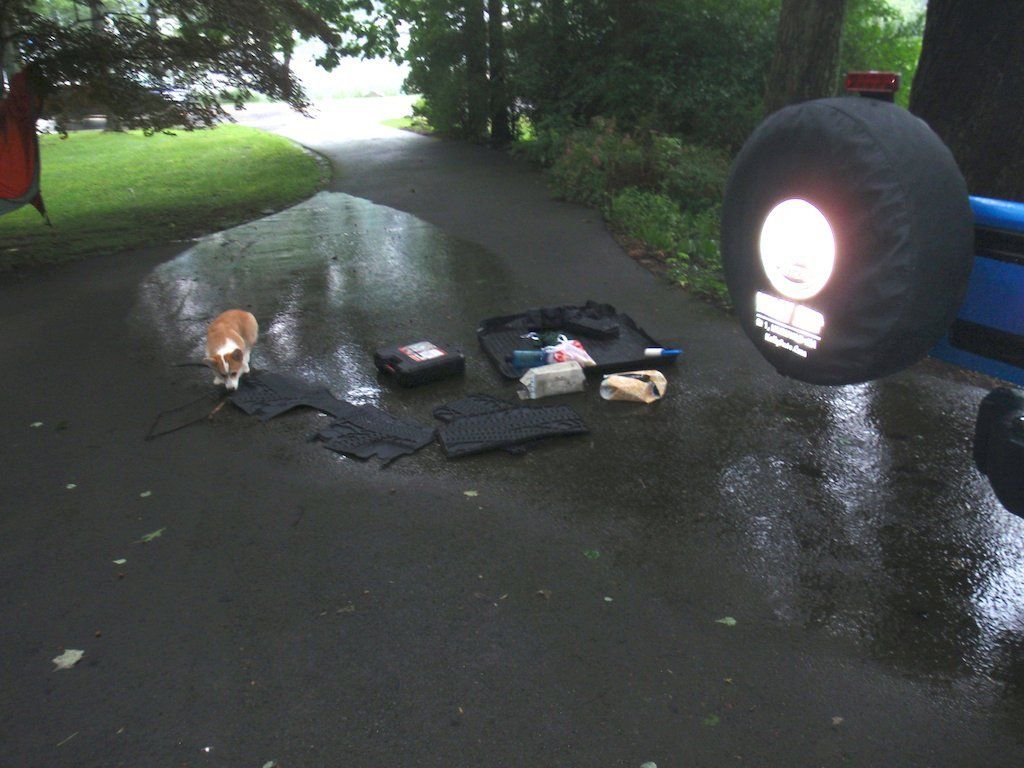

I also did some floorpan/carpet maintenance this weekend. I wish I had taken pictures, but I took out all the carpets, then took an angle grinder and flap disk to the surface rust that had started to form. Then I cleaned and degreased it and put 3 coats of automotive rattlecan primer and a top-coat of "Charleston Green" rattle-can rustolium paint. It actually matches pretty closely, I'm impressed.
While that was drying, I stuck the 3 carpet sections in our fancy new industrial front-loading Mercedes-Benz-of-washing-machines (I don't feel like a dick bragging....because no one really cares how nice your washing machine is, ha ha) and stuck them on heavy-duty, pre-wash, steam-clean, extra-rinse, everything-short-of-a-gestapo-interrogation cycle.
Man, what a difference! There was literally a half inch of sand and dirt covering the bottom of the shop sink it drains into. They look like brand new carpets.
So now that I had dry floorboards and clean carpets, I sprayed all the under-carpet areas with a light coating of WD-40 and threw the rugs back in. Hopefully this should keep everything as rust-free as possible until I get around to doing a Monstaliner job in a few years.

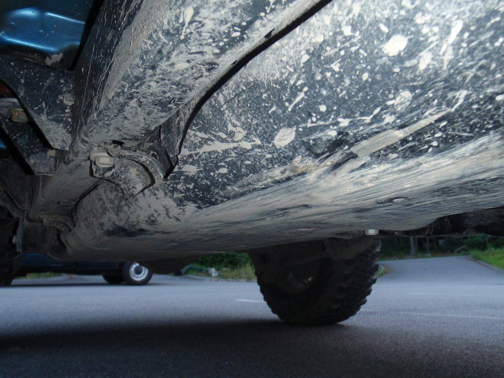

Also, just an update on the Islander:

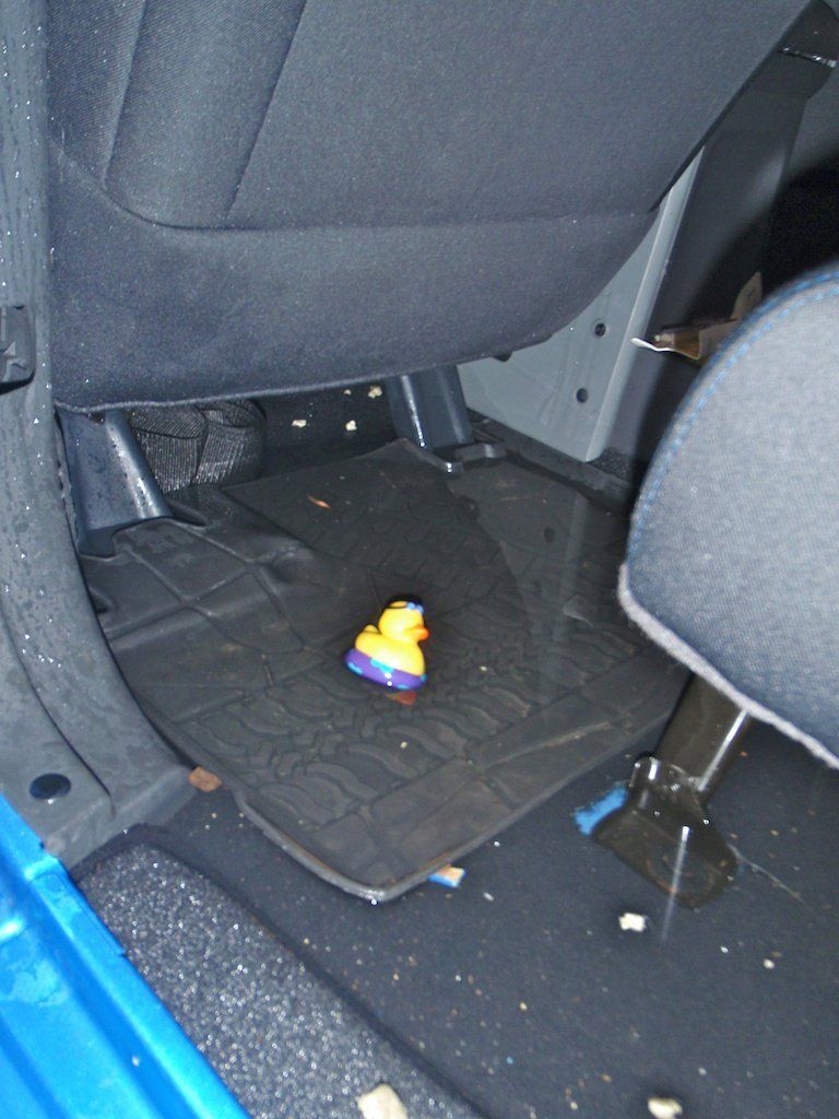

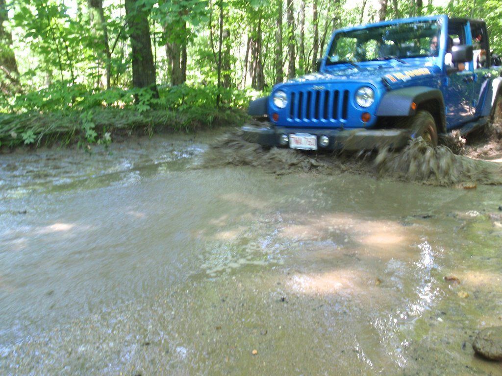

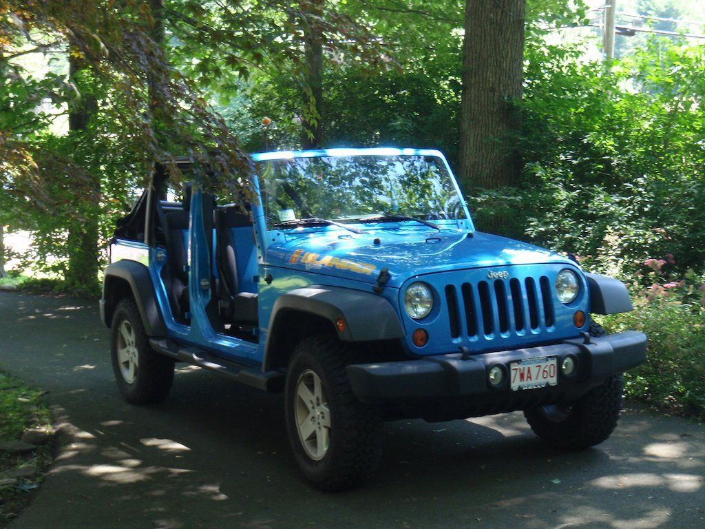

Been using it a *ton* this summer, with lots of loading camping gear and dogs and running no doors and 6 and 7 hour trips.
The wife even took it wheeling for the first time! A decently legit trail too, with very little flinching. I was so proud of her. Barely even winced when she put her first big dent in the skid plate!
(The picture doesn't do the dent justice)
Even accidentally filled it up with 2 inches of rainwater in one of the biggest scariest storms I've ever camped in. Should have put the top back on, ha ha. 15 minutes, though, and all the carpets were pulled and all 9 drainplugs were out. The JK continues to impress me.
And continues looking purdy....

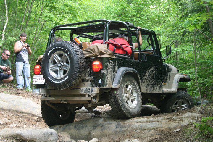

And just as an add-on to the discussions previously had about flex and stuffing and how my tires did, someone just sent me a picture from a previous run:
Pizza Cutter Flex ftw.
Can't do that with fat tires.

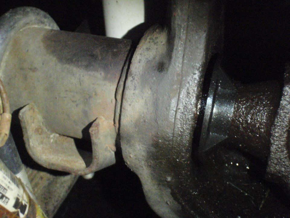

So did a tire rotation last night and general inspection to try and find a "clink"ing I've been hearing whenever the suspension moves. Didn't find the clink, but I did find this.....
Looks like it's time to replace the axle seal. If what I've been reading is true, it involves removing the carrier, which makes me nervous. I might see if I can recruit some of you NSJ guys to drink beer, watch, and make sure I'm doing it right when the time comes, ha ha.
I mean, I've noticed spots on the driveway, but it's a pretty slow leak and my diff fluid level hasn't dropped at all, so it's not *urgent*, I guess.
I never replaced the gasket when I reinstalled my distributor, so that's weeping as well, so add another thing to the list.

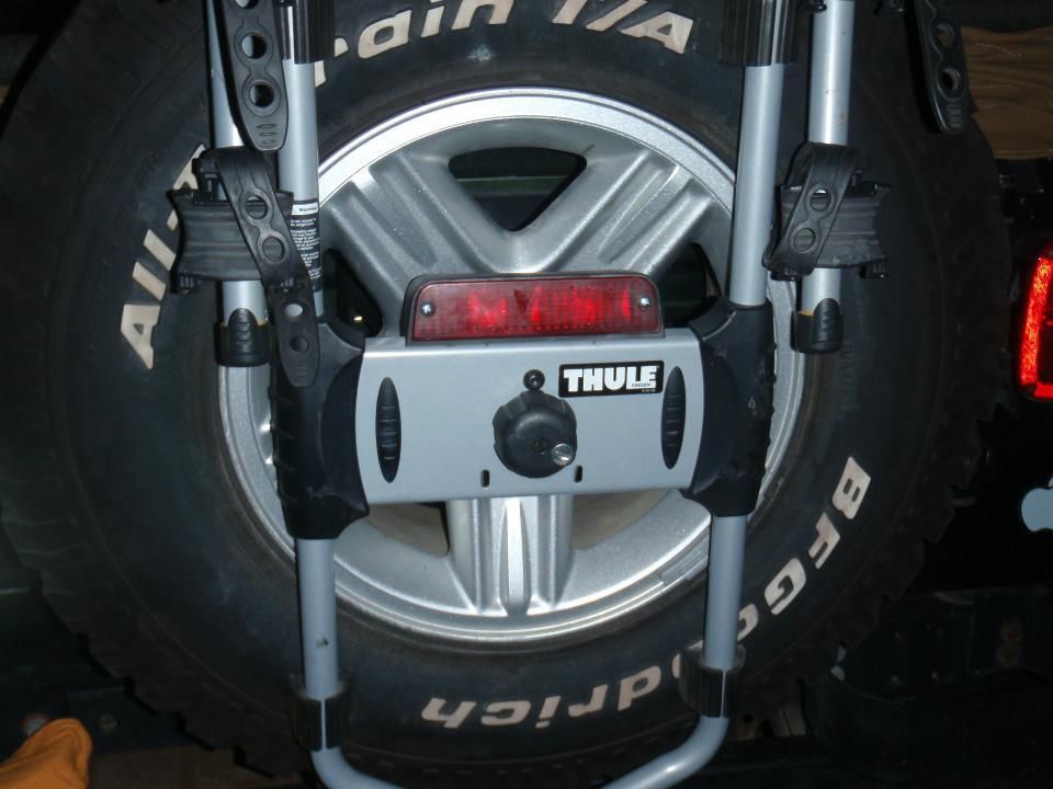

On a more positive note, I got sick and tired of my third brake light flopping around and clanking (see previous flex photo for reference), so I dissassembled it and relocated just the top light section to my bike carrier on the spare. Looks pretty good I think!
I secured it by using the existing bolts to clamp down on some IKEA bracket or something I had laying around that clamps it to the lip of the carrier. Effective and lets it be easily removed for changing the spare, carrier, etc.
And a video I took to verify I hooked everything back together correctly. Almost like it's supposed to be there, ha ha
