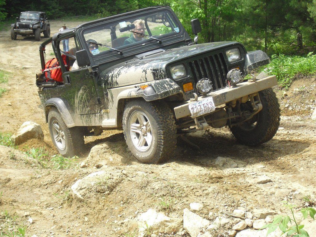

Just in case you guys were worried that it's a street queen, I figured I'd share a couple shots from the ExploringNH anniversary run from a couple weekends ago!
I gatta say, the ATs did *much* better in mud than I was anticipating. I could stop right in the middle of a mud slick, start it in second and just roll out with no issues, consistently. I should have aired down more (I was at 25, I should have gone to 15) so I kept bouncing off ledges, etc., but the skinny tire thing worked *awesome*. No issues with flex or stuffing, so the new setup is working really well.
I'm going wheeling with ENH again this weekend, albeit a pretty mild run, but it's bringing to light that I'm *very* bad with staying light on the gas when I wheel. I'm definitely going to have to upgrade to an 8.8 if I want to add a locker. So it looks like I'm saving up to try and do an 8.8, locker, and regear all at once!

In the picture in the previous post, I'm bouncing pretty hard, so you can see how the tire tucks into the wheel well, even before getting some angle from flex.

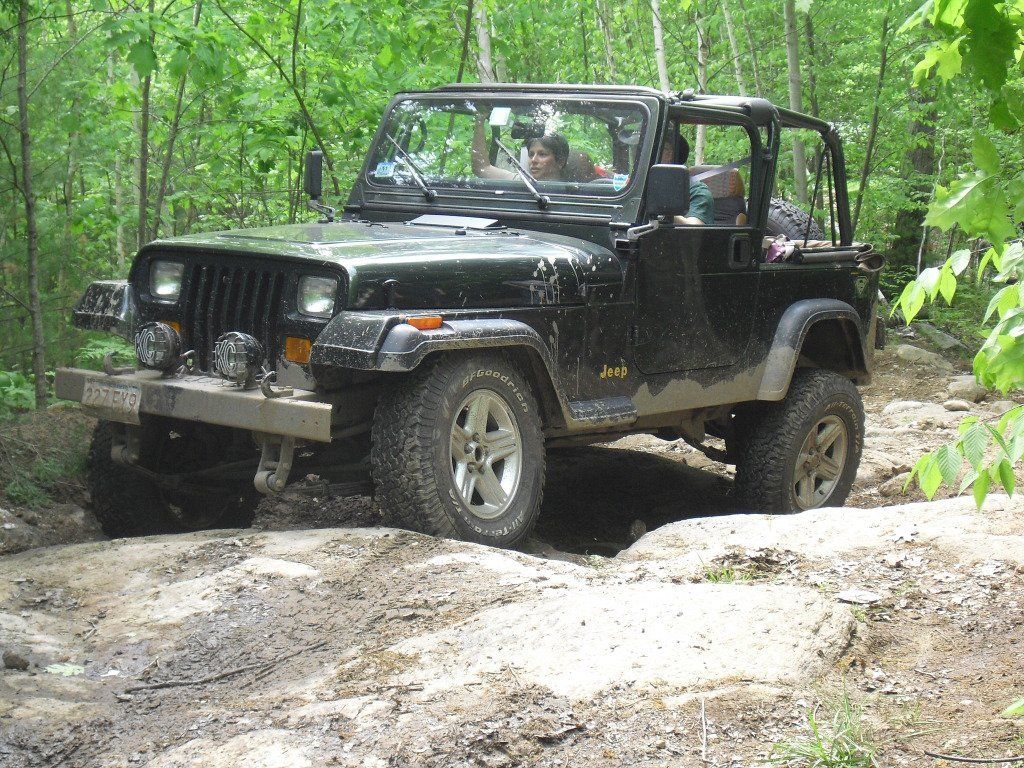

The picture below shows the front flexing room pretty decently. It's not even close to being an issue, so you can picture that in the rear.

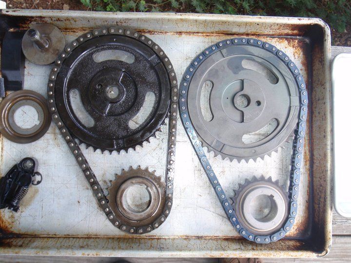

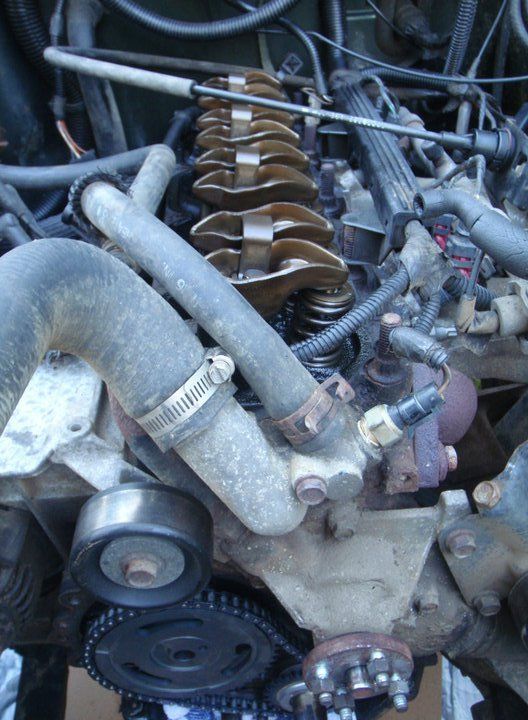

In a more general updates, I think I may have finally tracked down the rough idle issue I've been having forever. I went to replace my timing chain today, assuming it was loose and that was the problem. Turns out it was still really taught, but I found this instead....
Ummmmmm....looks like I'm going to have to learn how to reset valve timing.....
I'm completely intimidated by anything engine related, but looks like I'm going to have to learn....
How my engine compartment currently looks:
I'm been taking a lot of pictures because I'm hoping to do a timing chain write-up this week, with possibly a side write-up on how to reset valve timing. Keep an eye out for it!
