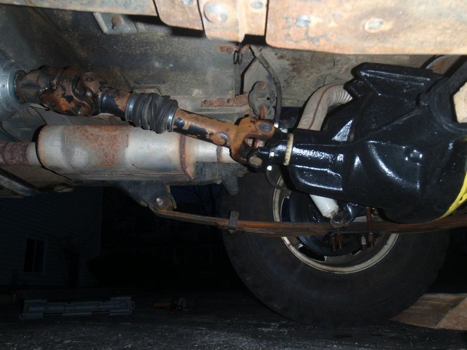

8* of shim
Got about 5mph more before vibes, but still only up to 50-55.
As you can see, bigger shims ain't ganna do sh*t but make it worse at this point.
