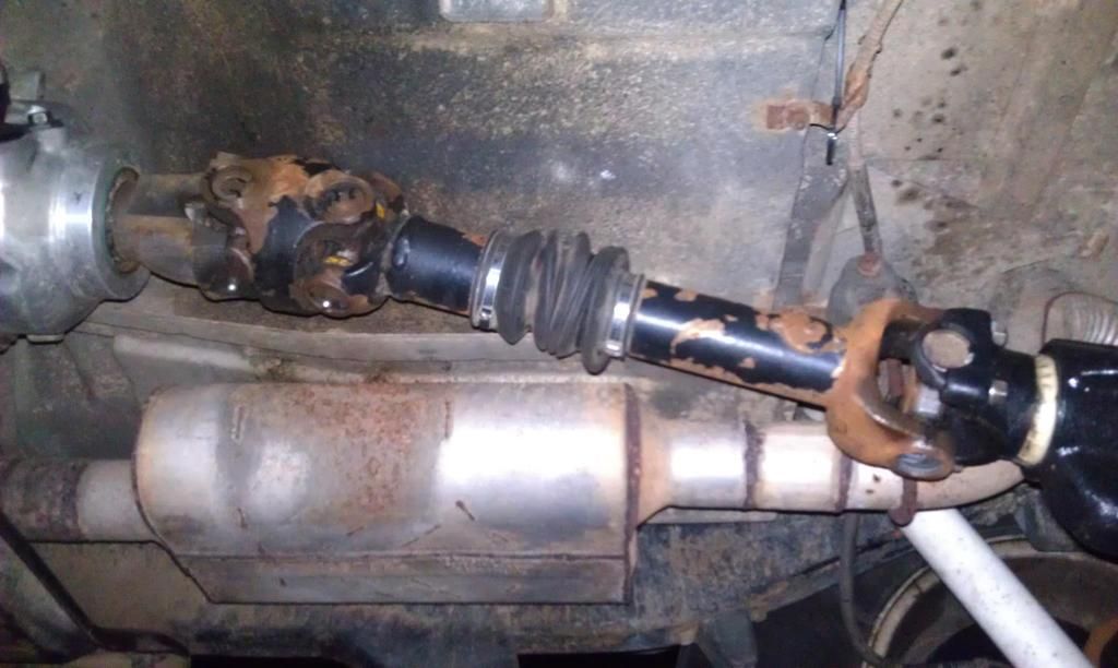

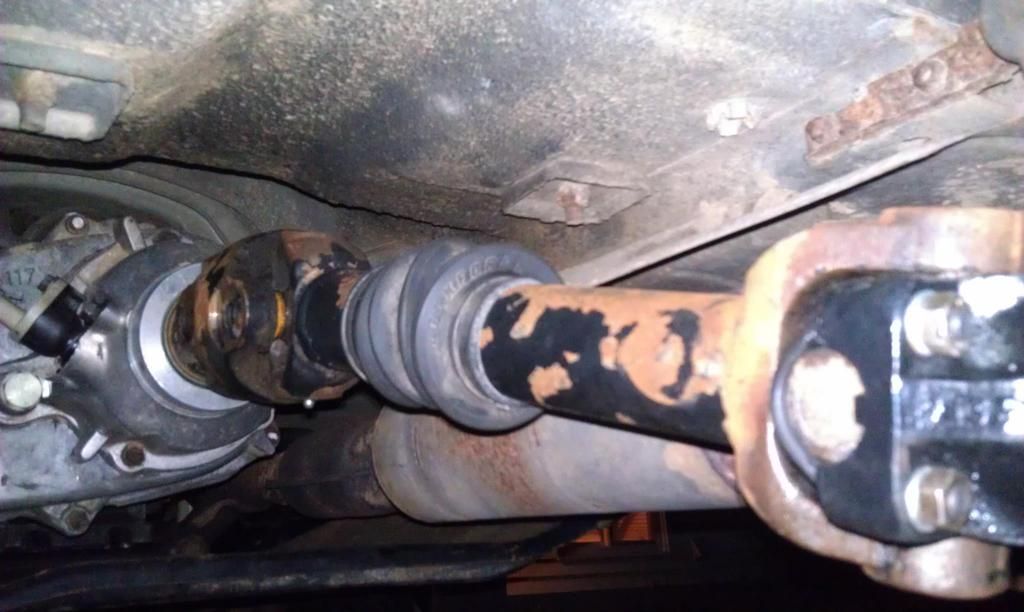

The final items (regarding the axle, at least) is to correct my pinion angle.
This is what it was originally at (didn't realize how much axle droop there was when installing, so we put in 2* shims)
Removed the shims last night and got the pinion angle down to this:
It's still a few degrees too high, and I get vibrations on major acceleration and above 50mph or so, so I'm going to order 4* shims. I'm going on vacation next week, so it'll be here by the time I get back hopefully.

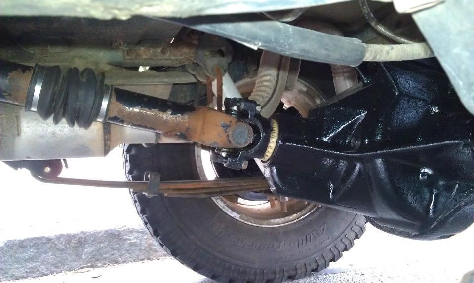

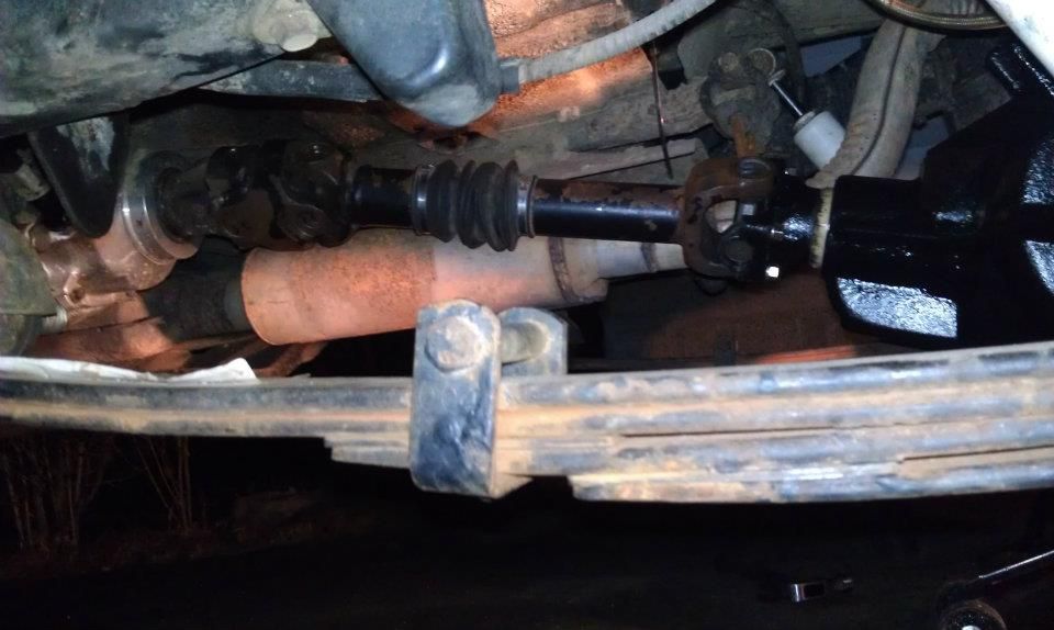

I put in my 4* shims last night (had to drill out the center pin holes to 1/2") and I thought my pinion angle was great, and it even looked a little low. Tightened it all back up and now have no vibes on acceleration, but I start getting major vibes at around 45mph.
I'm going to have to get back in there tonight with an angle finder and check to see if my eyes are seeing it accurately.

The pinion side looks fine to me, but how does the transfer case output side look?
Here's the pic from Tom Wood's site just for reference.

The axle side looks to be a zero degree difference between the shaft and pinion. You want a few degrees difference to make sure the needles are moved in all the caps as you drive. Otherwise they wear much much faster, and can cause vibes. I'd set it a few, maybe 3-5, degrees shallow of the transfer case, which should net you ~1-3 degrees negative while you're driving. 'Nah Mean?

I took a video of the driveline angles because my camera often looks different than how it looks to the naked eye.
If you pause at like 9 seconds it gives you a full (albeit not terribly crisp) view of the driveline angles.
I'm still not getting how an equal driveshaft/pinion angle could cause vibrations. Could someone give me a quick explanation?

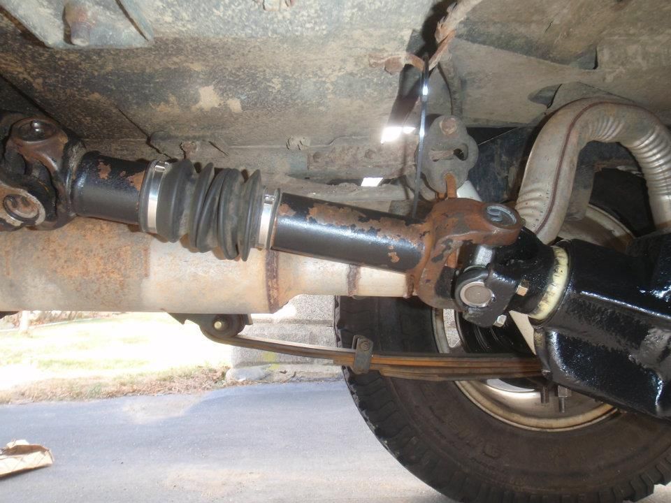

Ok, now I'm just starting to get frustrated.
To review:
D35 original - perfect as fast as I could go.
Short-sigted -2* shim - didn't actually drive it because it was obviously wrong
No degree of shim - drove highway and got vibes, but I can't remember when they started
4* shims - vibes starting at around 45 mph
And finally, the 6* shims - still have vibes starting at around 50 mph. A little better, but ultimately still not highway worthy. Very frustrating.

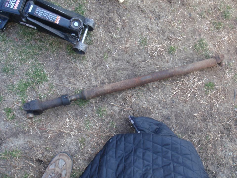

So I called up the driveshaft shop this morning and asked if I could drop by on my lunch break and have them take a look and the guy basically told me that no shop is going to look at it without pulling out the shaft first and checking that. That wouldn't have been that annoying were it not for the fact that I just pulled out my front driveshaft last night.

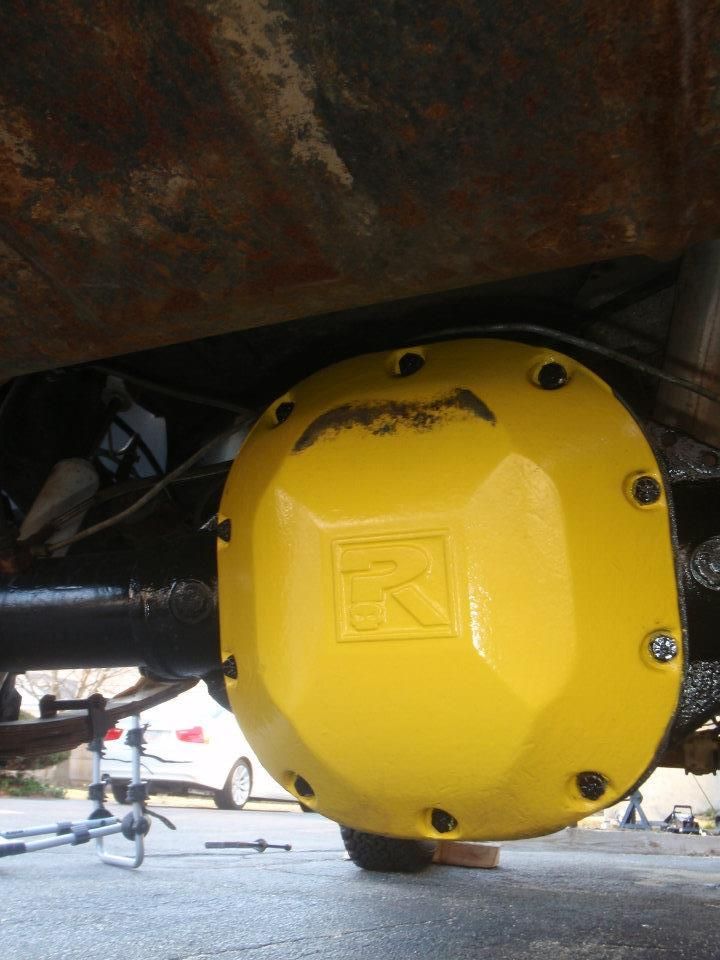

Also, for those who asked if my diff cover rubbed my tank, here is your answer:

So, yeah, I'm really frustrated with the vibration situation and I'm tempted to just reinstall the front driveshaft, remove the rear, swap into 4WD, and let someone else deal with it.
It definitely looks like I need to have my DS cut down at the very least (compare the first image with the last), so I should be removing it anyhow.
Thoughts? I'm really getting frustrated.
