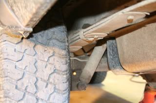

Front B4
Back before
boo saggy springs!

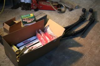

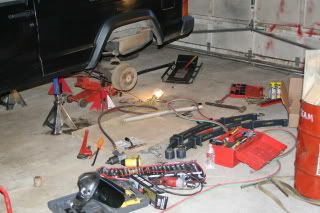

Here's the leaf springs (FLAT)
Here are the replacement parts
And taking apart the rear end (haha)
Oh, and GREAT news! I ONLY broke 3 out of 4 upper rear shock bolts!
Hooray! (NOT!)
It was alright though, my dad has a couple tap sets and we drilled them out and tapped them and put in some bigger bolts.
I also broke 2 socket extensions, one the tip snapped off and the other wrapped around itself because me and my dad had to use a 3 foot pipe to get the leaf spring bolts to budge...and that was with a torch too! He decided to use his craftsman one so we could stop breaking them.
The back took 6 hours total and I netted 2.75" of lift over stock...4" over what I started with.
Because it took so long to do the back I had to wait a week until the next weekend to finish the front, so I hot rodded it for a week I got a few comments. (sorry no pic, I should've snapped one but didn't think of it)
The front took 3 hours, no coil compressors, just 4 pry bars and some clamps, it worked. It was NOT pretty though.

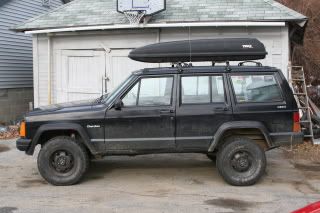

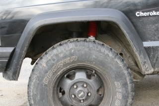

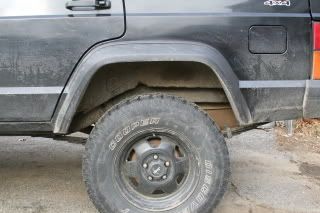

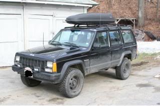

Anyways, the result
Back
Front
The whole thing!
The set up rides like a cherokee dream! The leaf springs are like stock, and I kept the stock springs out front and the shocks stiffened the ride a bit, but for the better. All in all I was extremely impressed!

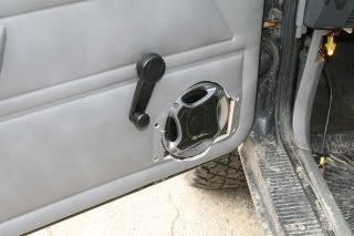

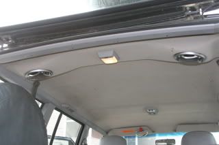

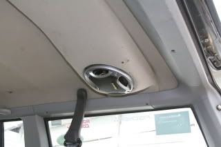

Alright I was gonna add my stereo stuff a couple days ago but I forgot so here it is.
Headunit: Kenwood KDC-MP232 (CD, radio) 40Wx4
Speakers: 4 5.25" Pioneer Premier 3-ways (200W max, 35W)

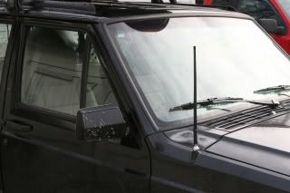

I also have a shorty rubber antenna from VIP for $8
I LOVE the way it sounds, one of my rear stock speakers was falling apart so I had the buzz noise when I turned it up even a little. The new 3-ways sound great, the mids and highs are very clean and crisp, with decent lows but I have a sub/amp enclosure that needs fixing (wires) and that will fix that!
Volume wise, they go as loud as stock before they 'bottom out' so to speak.
Here are some pics
I had to trim the door cover to fit the new speaker covers, its not real pretty but hey, it's my jeep and no one in my high school would complain too much because they know it's better than their beater. (80% of students at my school drive beaters, 'good on gas', bah humbug)
and the antenna

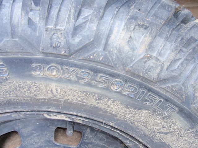

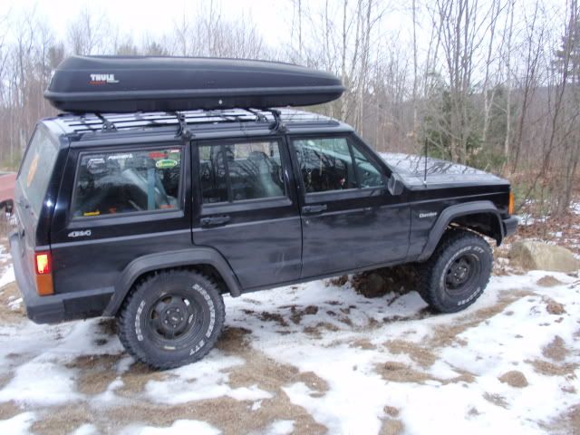

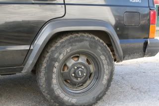

Here are the pics of my brand new STT's! I went on a mild trail to test them, which is getting worse every time it rains because it is washing out I almost high centered my front diff on a spot that used to be flat.
These pics are from my cousins backyard
flexing, with front and rear swaybars. The rear flexes like it's not attached, but the front is restricted, spring showers bring disconnects (not flowers)
side shot (ignore the neighbors un-used trailer)
And a good shot of the tire tread
The tires work great, it is snowing here right now (6" expected) and when I came home from work I was testing the tires in about an inch of snow, I went in 2wd the whole way and had amazing traction, and braking is a little more before they lock up but that isn't going to get much better no matter what.
Off-road they owned, I walked over everything, though the trail wasn't that tough, it's a four wheeler trail with small rocks and 1-2" of snow and some mostly frozen mud puddles.
ON-road they don't make any more noticeable noise, but I think my flowmaster covers most noises anyways They handle great, and the siping is pretty good. The tire shop installed them at 40psi and I think thats about what they should be run at, I will keep an eye on the pressure and how the tires looks to be touching the ground.
Right now I would give them a 10/10 but that's because I don't know the tread life of these tires. This thread will stay quiet until after christmas anyways, that's when I get a couple small presents to add on!
