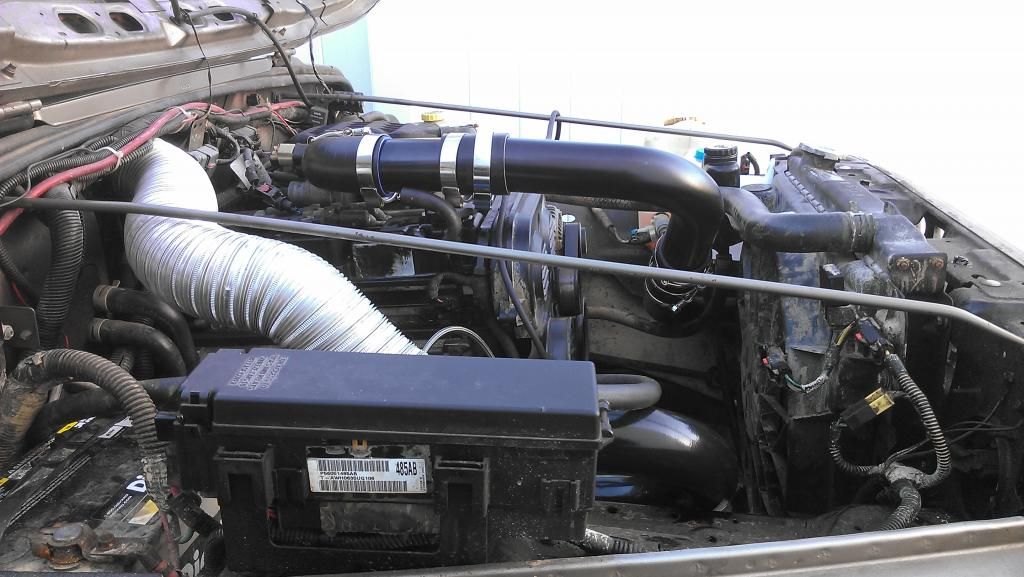

got the adapter on, turbo on for test fit. found out i have to clearance the inner fender just a bit and shorted the exhaust u-bend. i also got a universal coolant bottle for the charge pipe clearance

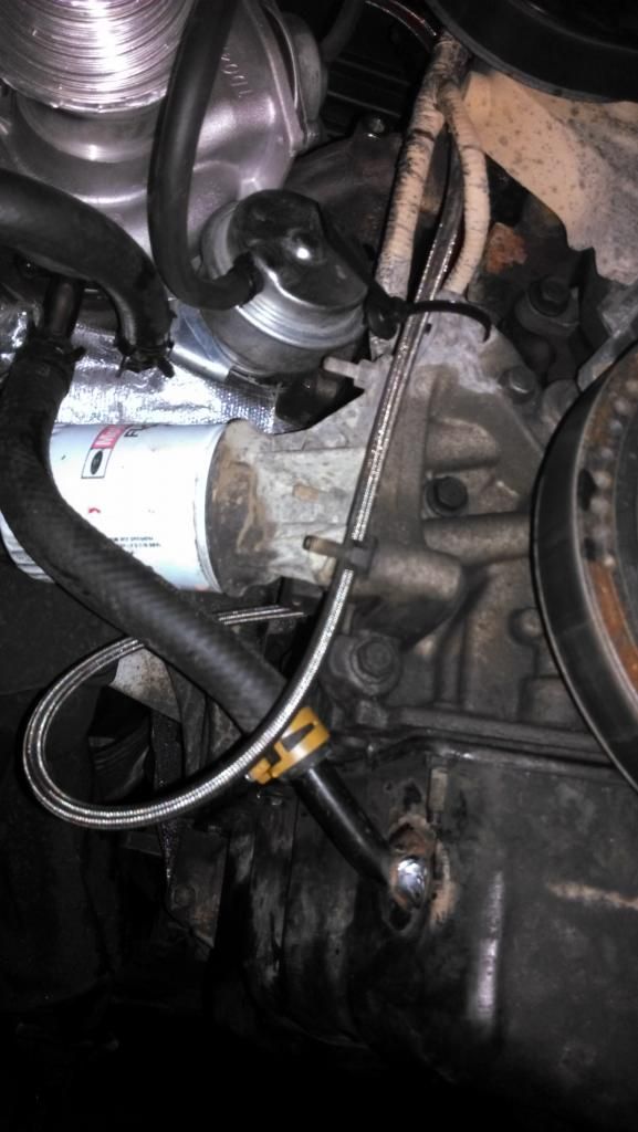

Got more work done today before more snow comes. Clearanced the fender to turbo, only had too because I have mml and tt. Oil fitting are in, cut and welded up the shortened u-bend. I'm going to try to hook up the exhaust at the factory flange but well see how that goes..

got a lot done today, im hoping to start it up tomorrow. i just need to drill and weld the oil return in the oil pan, run the charge pipes, fill coolant and oil.

all the coolant and oil lines are conected got the drain tube welded it today, i did a quick test fire to check for leaks. i also started to mock up the charge pipes im still wating for one reducer 90* for the hot side charge pipe.

its all together, except a ****ty an fitting that's leaking, and the rest of the exhaust

looking good! I think I got the same air filter assembly. Are you getting cool air from inside the cab? Nevermind I answered my own question I see your mini snorkel in the other pics.

Took it for a test drive today, its awesome! I could cruise at 35mph in 5th gear with so much power. I'm going to have too make a heat shield for the battery, that manifold puts out heat. The exhaust is a bit loud its currently dumping behind the skid plate, sounds like a diesel I like it.
