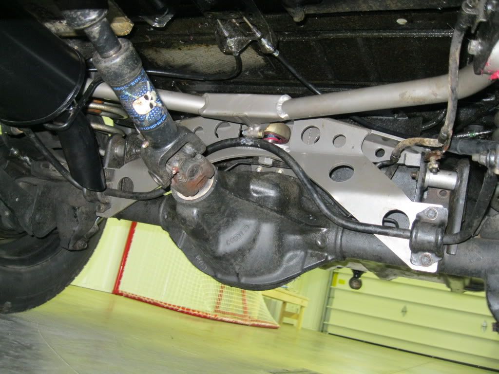

installed full traction rear 3-link, i had to make a shorter muffler with a turn down to clear the upper y link
installed a currie TJS adj track bar

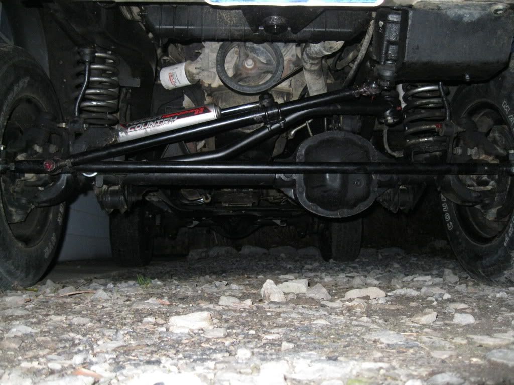

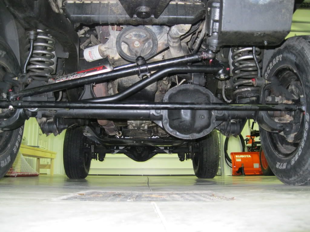

ever since i installed the TJS track bar i have been having bump steer and torque steer. i thought of rotating the tre so its at a lower angle, and at the same height as the lower track bar mount

i had time to work on the jeep today, i changed the angle and height of the upper tre. It fixed my bumpsteer just like i thought, but i still feel like i have rear steer when i give it more gas then usual, im thinking i might need a stronger sway bar for the rear with the 3link

Is nice to see more 2.4l 4 bangers on the forum, I own two of them critters. One is Solar Yellow and the other is the same color as yours. All there is to say the lil 4 bangers rule lol. My Yellow one has the Fulltraction trilink, it doesn't give rear steer but does give somewhat different driving feel than a true 4 link. Still rides better than the stock trackbar setup when lifted. I made the stock exhaust work on it.
