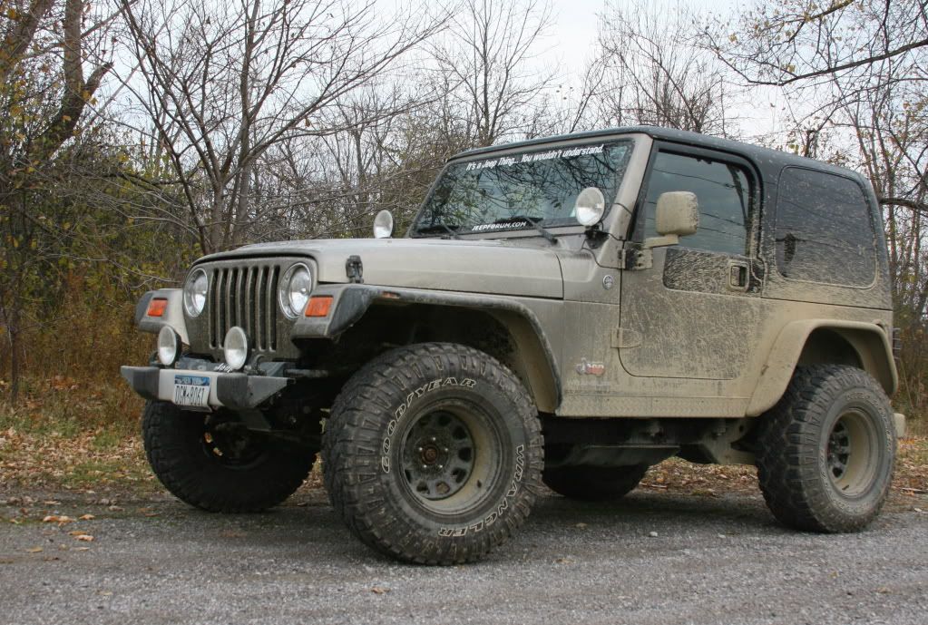

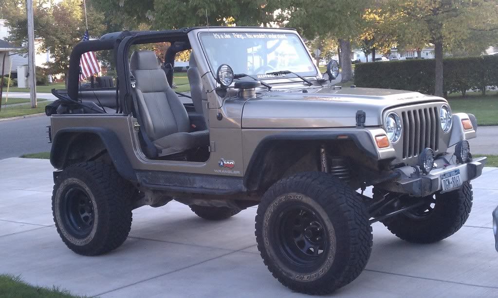

some shots before winter hit us up here
then winter came
jeep vs snow drift across road=jeep won

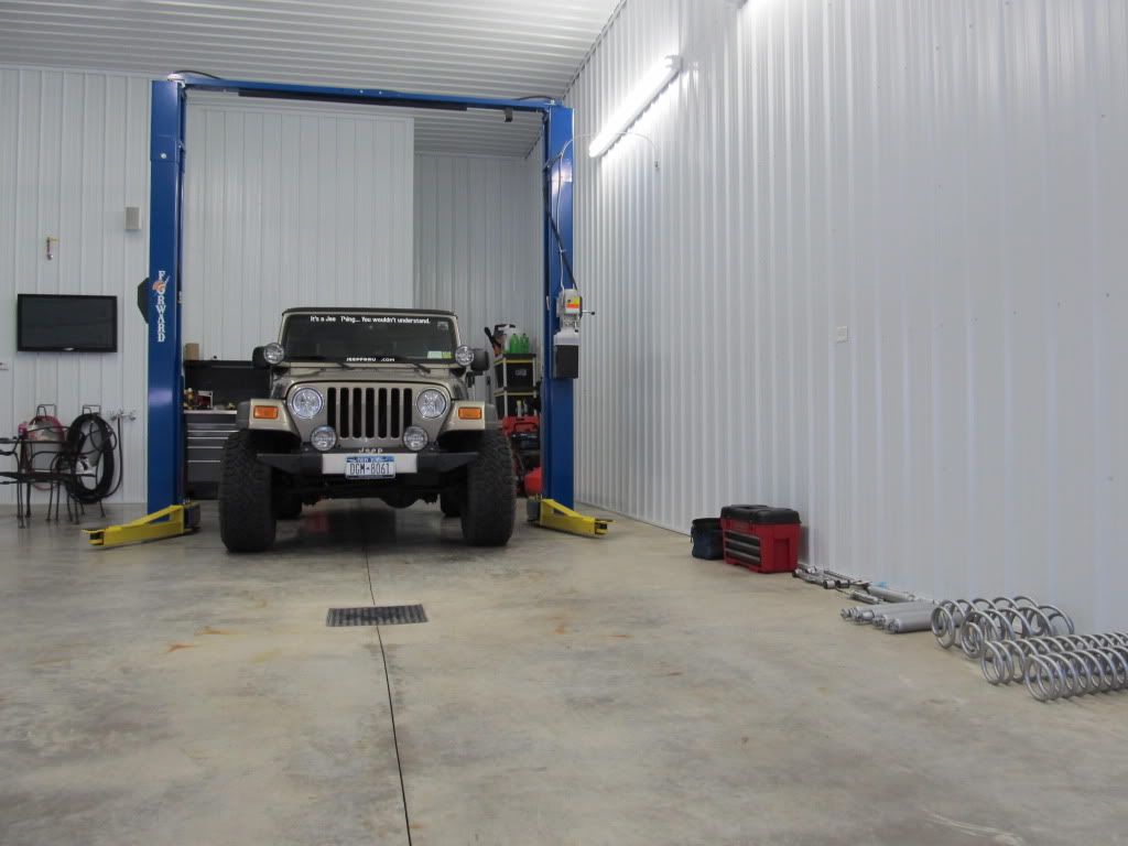

when i was puting my lift in
after

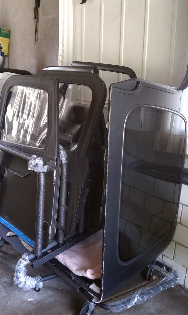

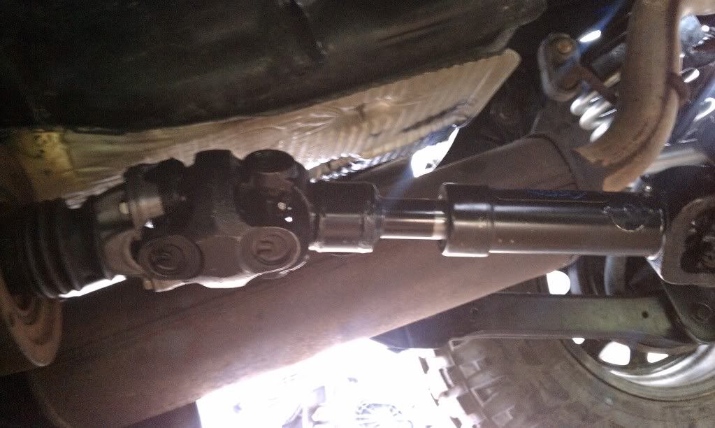

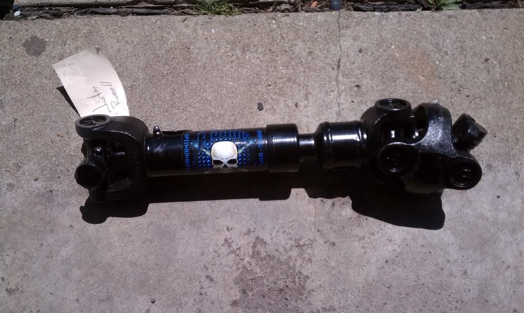

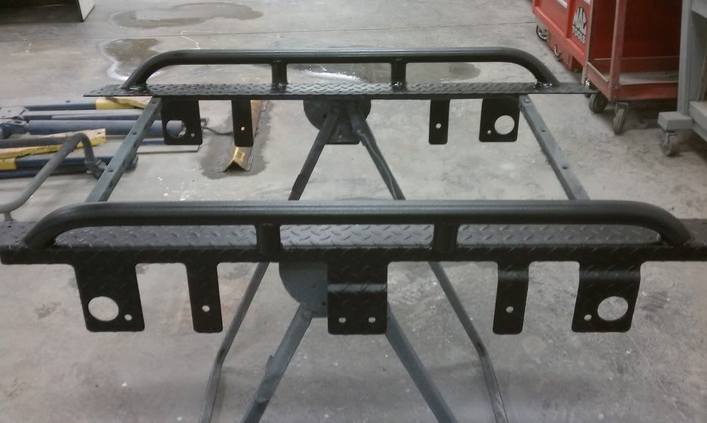

had to wait some time for my driveshaft and yoke to come so i used my extra time to build my hardtop rack and take off the top since it was getting warmer out
i chose to do a hack n tap, fits my budget and its strong enough for what i do

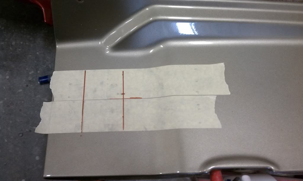

i got a good deal on a harley davidson mirror to keep me legal

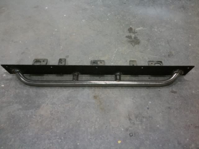

i fabed up some rubicon rock guards with sliders from a to z fab, makes a nice step too

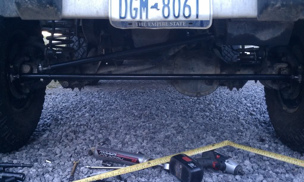

durring jeep jamboree i found out the factory steering wasent good enough for what i do so i opted for an upgrade when i got home

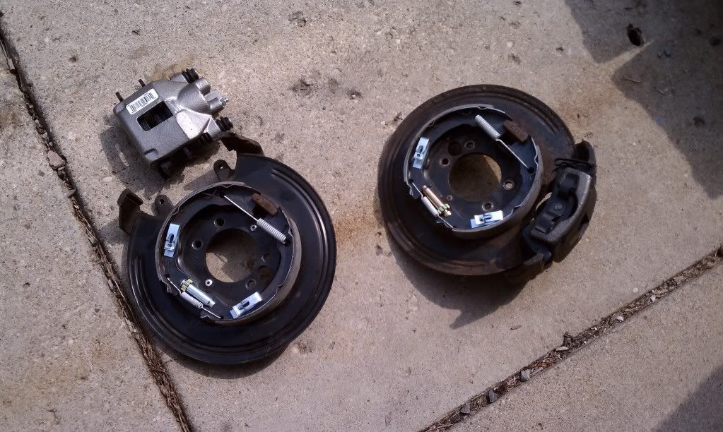

geting ready to swap to disk brakes in the rear

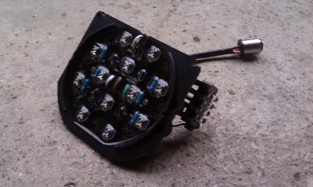

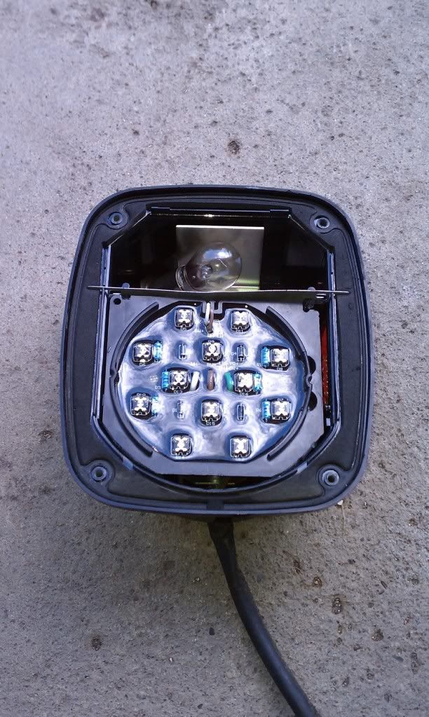

i bought led trailer lights and swapped the internals into the factory housing

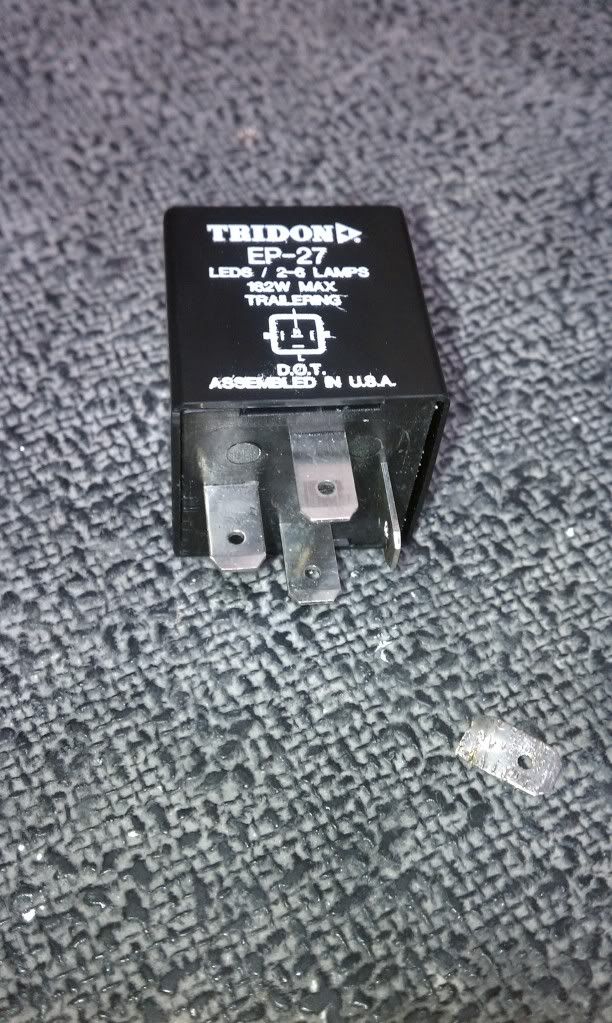

swaped the flasher relay to this ep-27 led, but removed the center pin or it will cause a short to ground and burn up

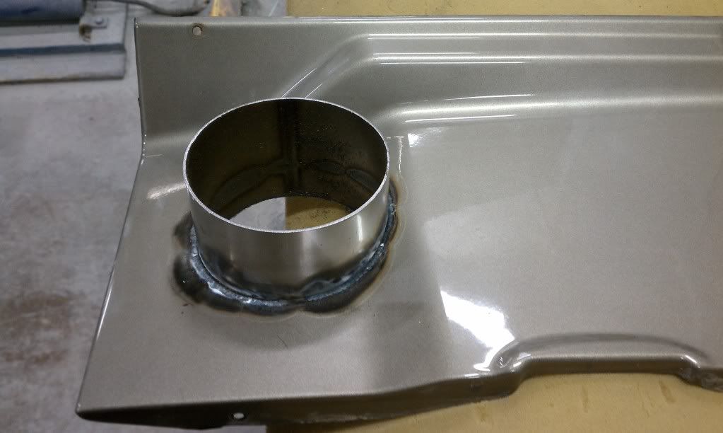

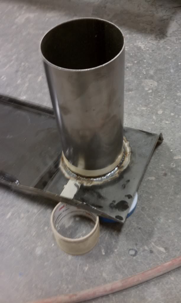

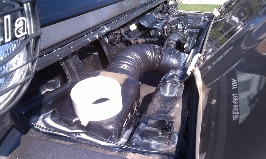

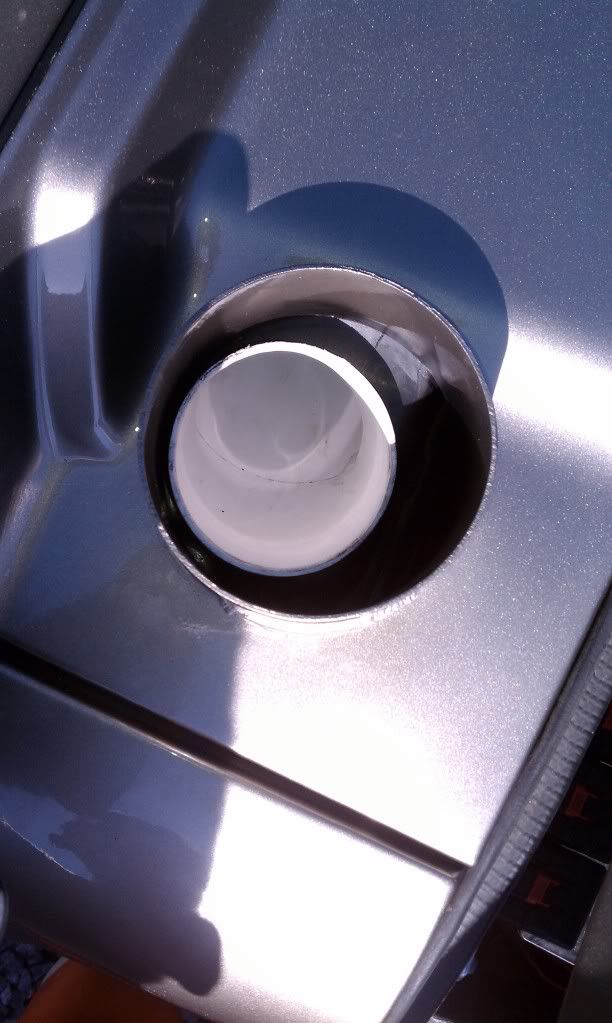

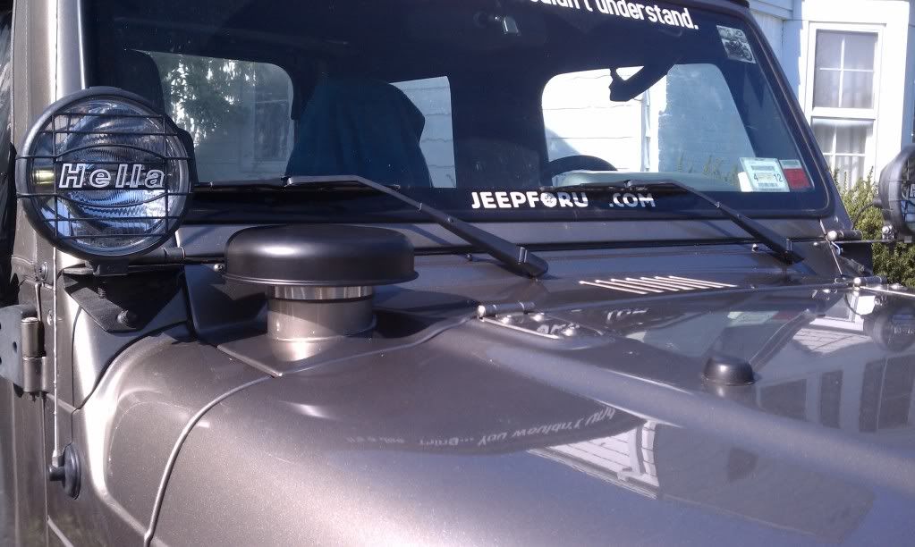

my HMMWV air intake, start to finish

post #30 of 178 Old 10-23-2011, 07:51 PM
teamgreen666
Location: canada
Posts: 521
i like the snorkel very clean.
