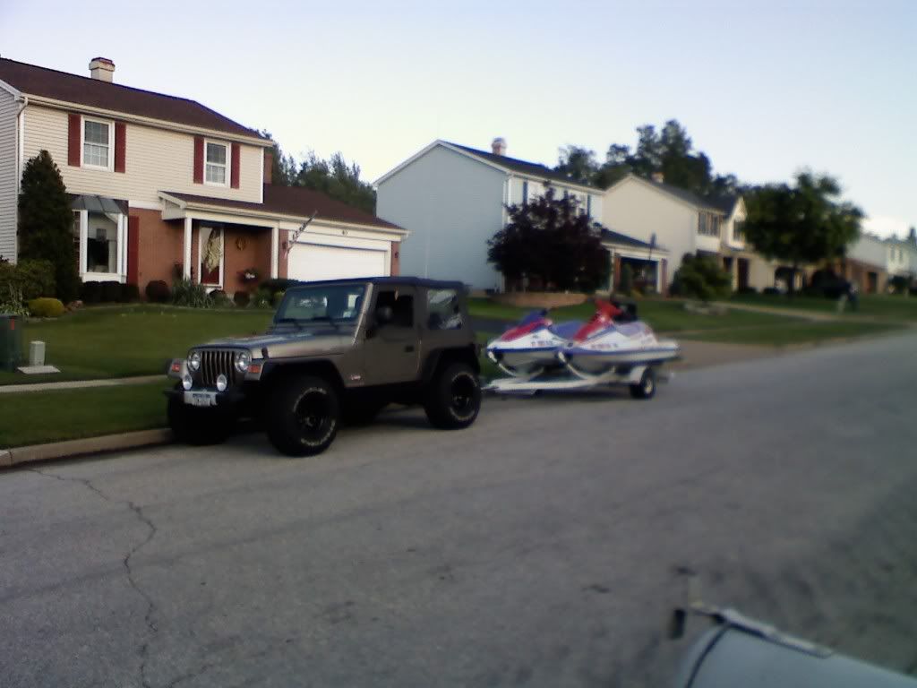

First off my name is justin I have allways wanted a wrangler since i was a lil kid
This is my jeep wrangler purchased in Oct 2009, the first one i have ever owned. Its a 2005 TJ SE with a 2.4L 6 speed, yeah i know its not the power house, but it came from vigrina beach area and its got no rust on it and i got a great deal for it. Around here all the used jeeps are rotted out from all the road salt.
Winter was coming and i dont care for the cold, so i found a used hard top in the area for cheep
Got some used 33x12.5x15 tires mounted on steeles for cheep, tires are shot but i wanted the wheels insted of buying new ones. No steering rub, but i got the flairs a coulple time on big bumps some times, oh well for now.

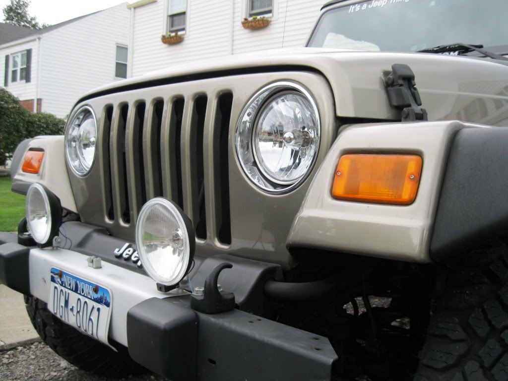

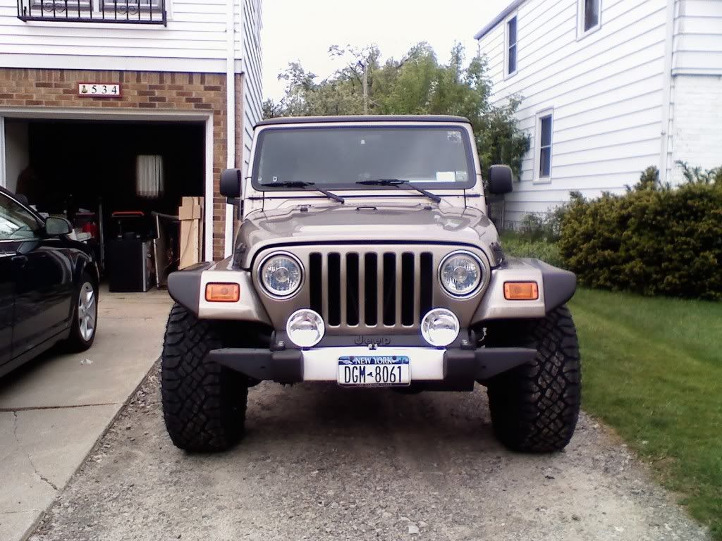

Also installed driving lamps

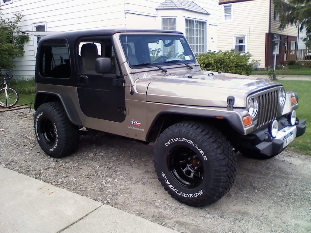

Found some hard doors for the winter, i love not dealing with the soft half door windows with it this cold here. I also cut the bumper ends on and angle.

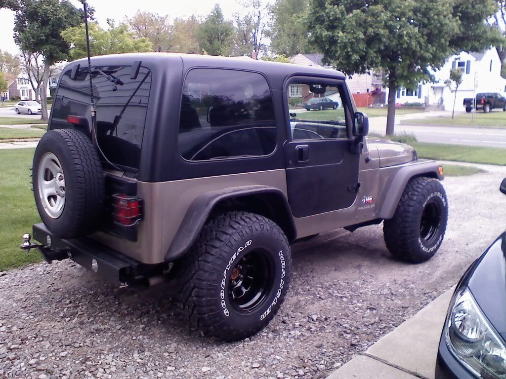

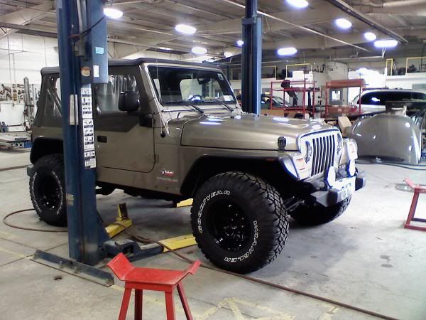

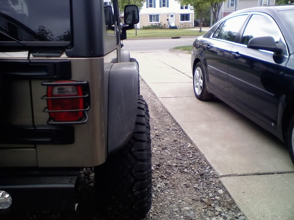

Got my new rubber in 33x12.5x15 Goodyear Wrangler Duratech

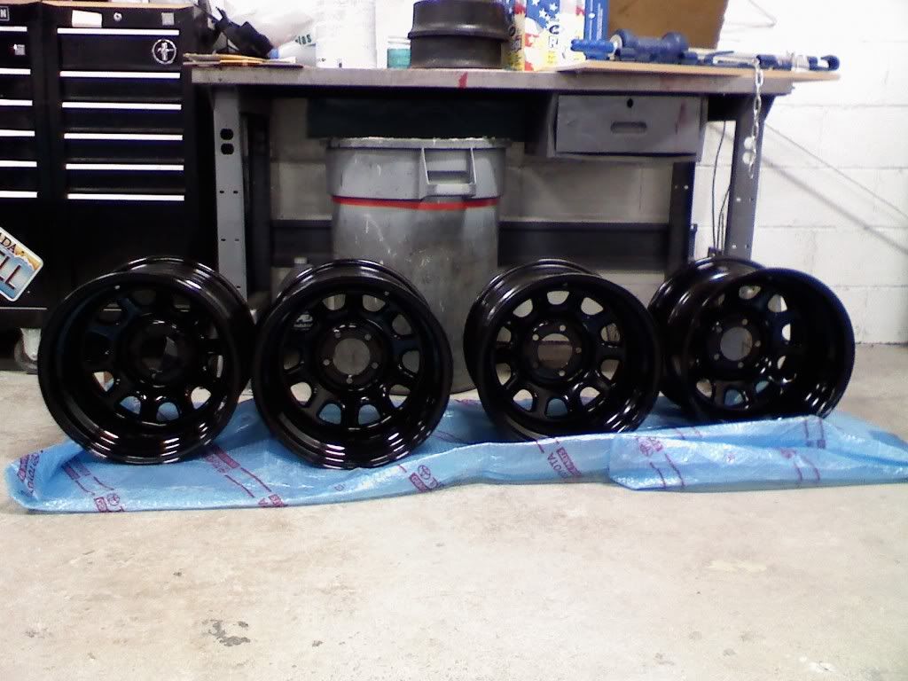

I had a local blasting company sand blast my wheels, then i painted them, they look great and for alot less than new ones

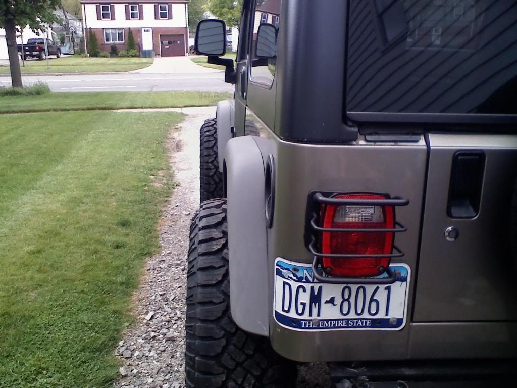

Got some 6" wide flairs curtisy of 2 JF members
I got 1'' spacers off ebay just to keep the tires from any rub for now untill i get my lift in

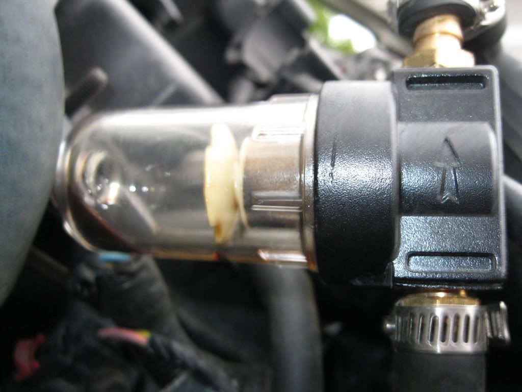

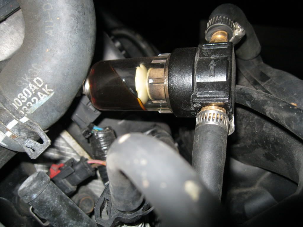

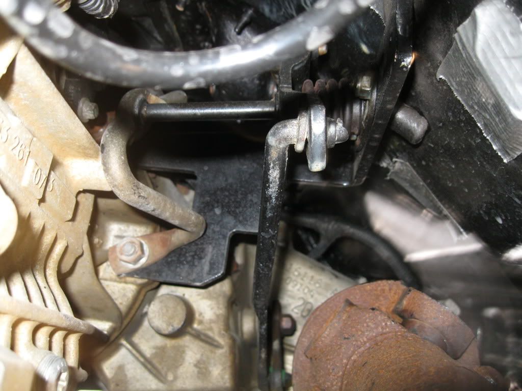

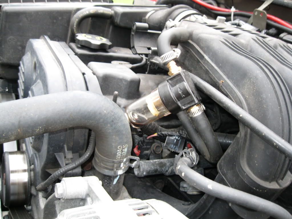

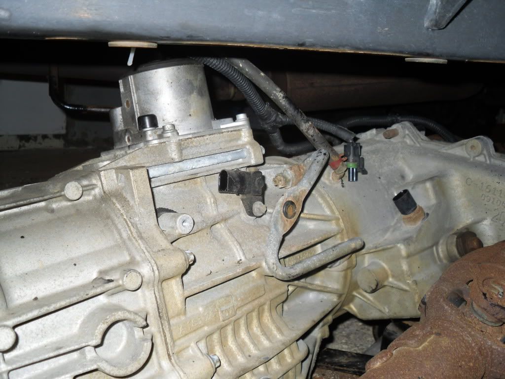

I was having trouble getting in 1st and reverse gears the warrenty wouldent cover the throwout bearing so i replaced everything clutch related since i had the tranny out. I also replaced the hydrolics since it came as a whole assembly and i got it cheep from the dealer too. At the same time i did this i was noticing a misfire so i changed the plugs but i noticed alot of oil in the intake manifold so i threw a cheep air oil seperator in the pvc line for now bc its cheep and it works lol. I also put in an Advance Adapters 4x4 shifter bracket its so much smother, all i had to do is put a lil bend in the upper linkage since i dont have a body lift.
Thats oil from one days driving

Thanks dude, when i put them 33's on they hit the factory flairs. i go new wider flairs on and their higher than factory and i got a 1'' spacers on the springs untill i put the lift on. I have no rub when turning, the wheel are backspaced at 3.75 i belive, i have no wheel spacers too.

3 days of driving to work and a trip to the lake towing the skis, this separator really works, no more misfires from oil getting into the motor

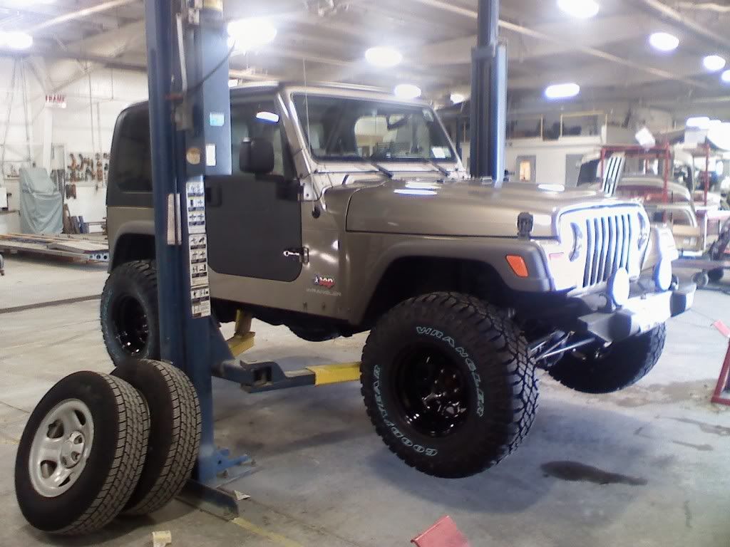

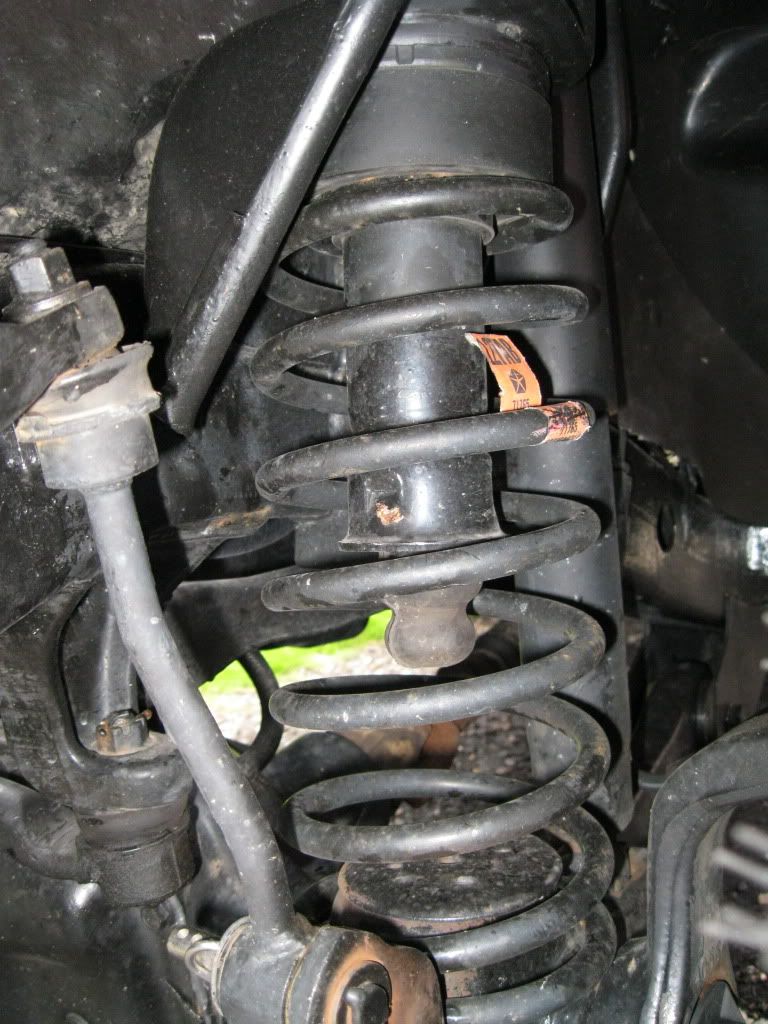

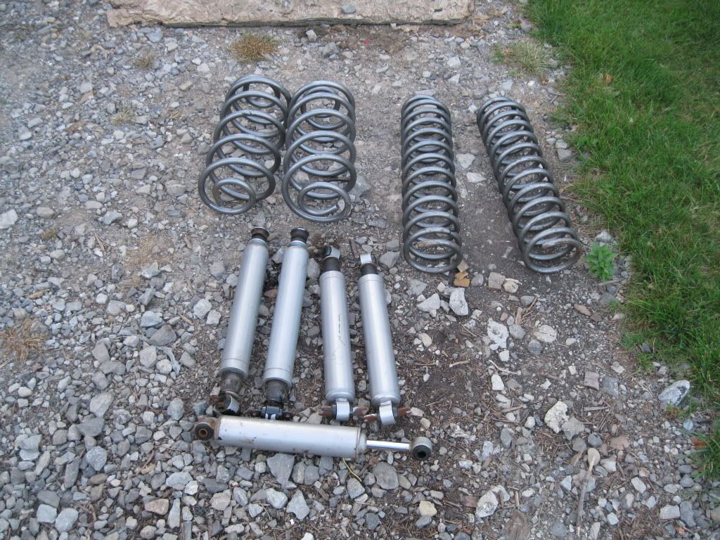

Picked up a lift kit finally, got it off a friend that had it on his tj for the summer he went back to stock for some reason. 2.5" RC with 2.2 shocks

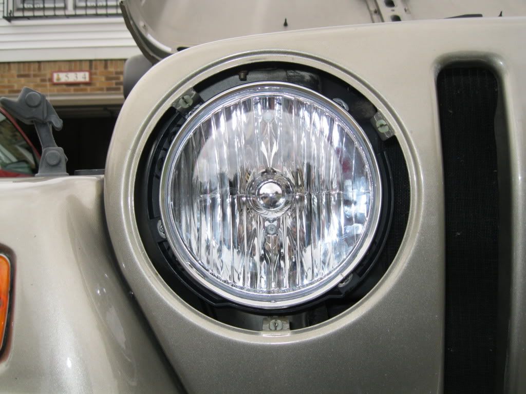

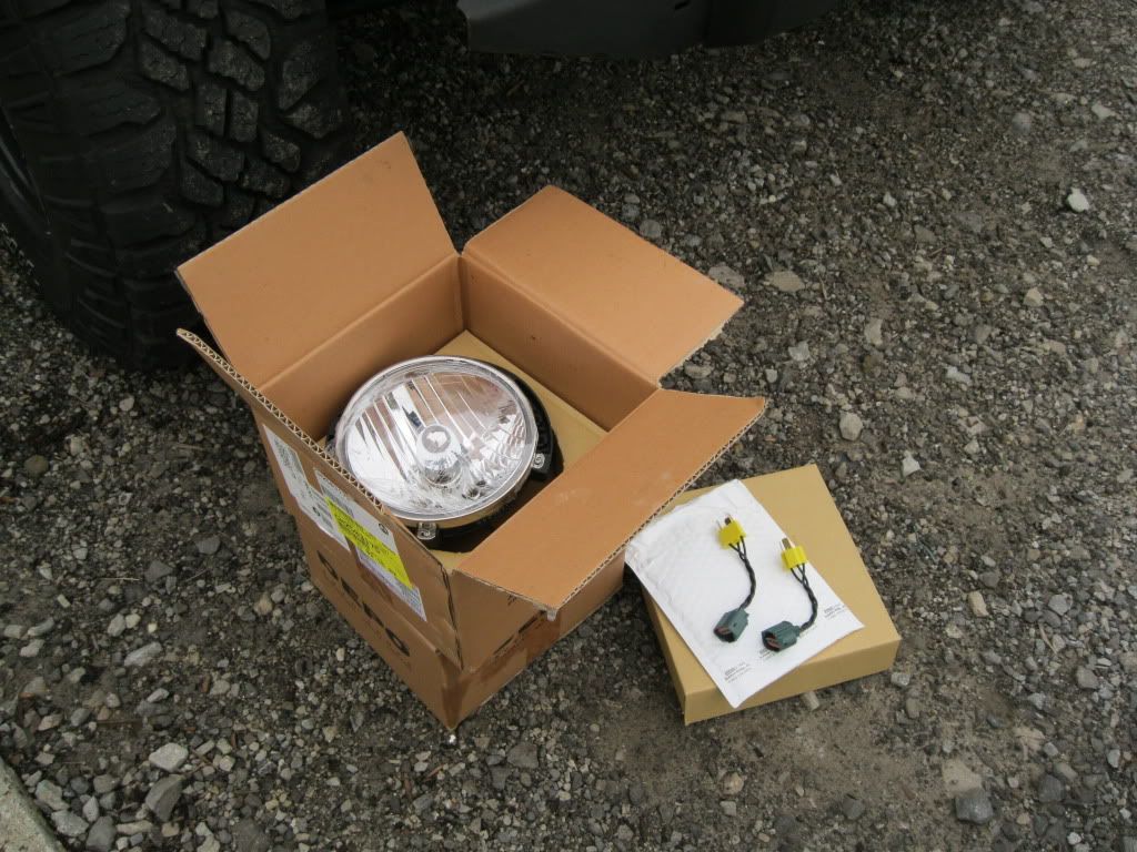

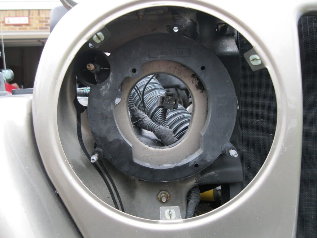

Just installed new JK headlights
