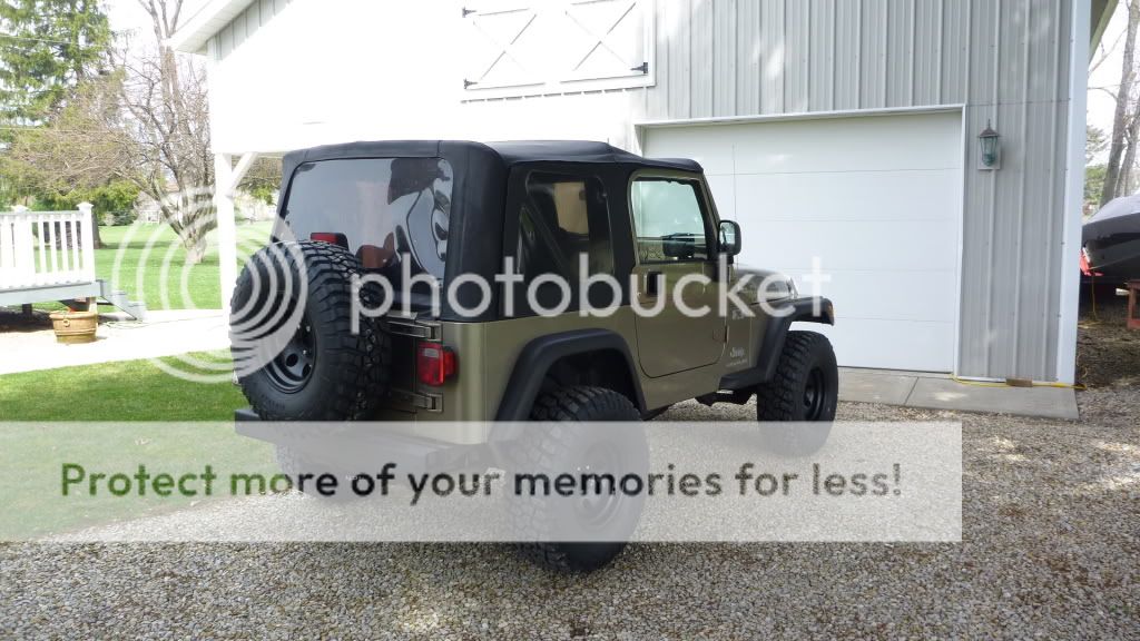

Heres what we are starting with! 2004 X with around 88k. 6 cyl, 5 speed:

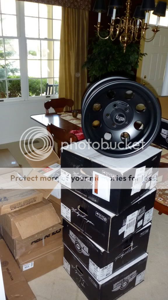

Heres what I had waiting for me at home when I came back from finals! :

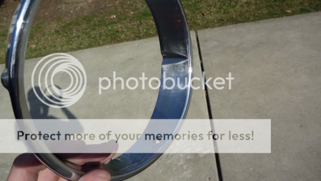

First up were the headlight bezels. I used 000 and 00 steel wool to scratch the surface, but that didnt seem to scuff it up nearly enough (made it shinier if anything else), so I used 400 grit sandpaper to get a dull finish to apply the primer. After I sanded it down, I took a cotton ball and some rubbing alcohol and wiped everything down. I used duplicolor primer and some rusoleum wheel paint. It was a flat black paint that said it could be used to paint wheels or plastic stuff, so I figured it would work well enough for my bezels (which it did).
After sanding:

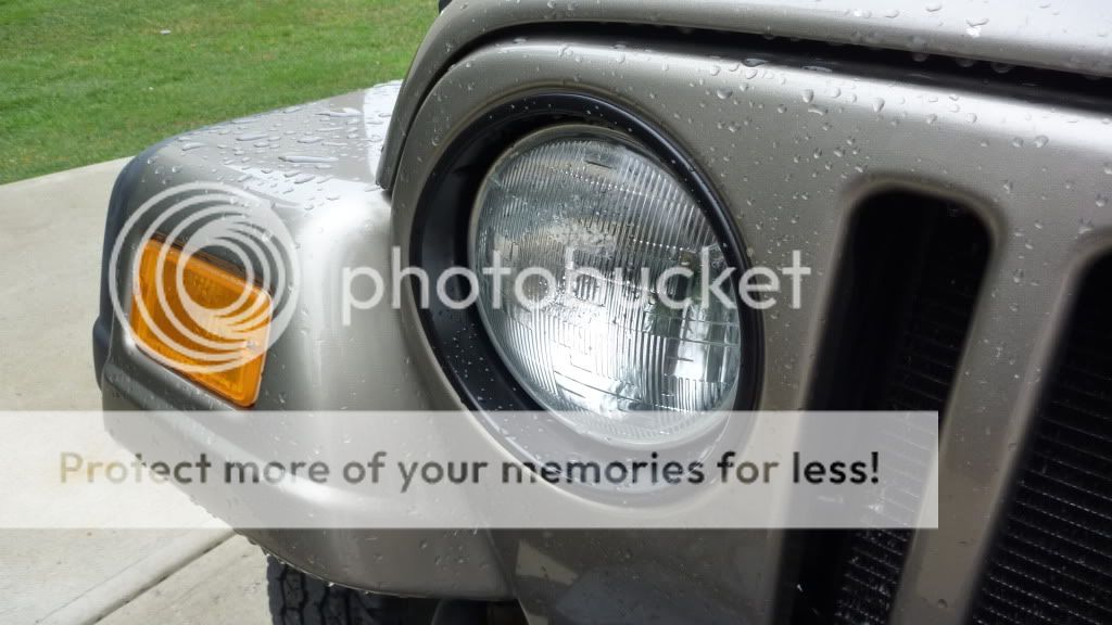

Forgot to take a picture after they were painted but before I put them in, so here they are about a day after I put them back in. Black bezels are the only way to go on the khaki jeep IMO:

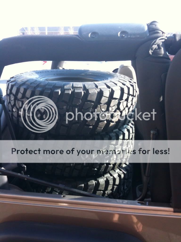

Here are the wheels and tires mounted up ready to be put on the jeep! Cant wait to see it up a few inches higher!

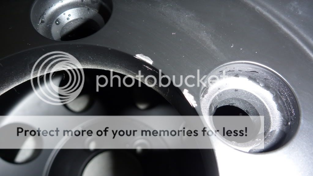

I need some opinions on this one. The guys at costco CLEARLY dinged up my BRAND new wheels. Do ya'll think this ding is enough to get worked up about? Its an aluminum wheel so luckily I dont have to worry about it rusting, but it still kind of pisses me off:

I would bring it up because that's a bit of bull **** if you ask me...I work at an auto shop and extra care should be taken with brand new aftermarket wheels, especially painted aluminum wheels!

Thats what I was thinking, but what do i do, go in and say "gimme $100 because you guys dicked up my brand new wheel"? It was clearly their fault because when I took the wheels to them 4/5 of them were still taped in their boxes.

I would say that you want them to replace the wheel and remount the tire on a new wheel! talk to the manager, and not the little peon *****es! Just keep complaining until they give you something...it almost always works! and when that doesn't work call the Costco main customer support line and ***** to the highest person you can get on the phone and they'll give you something for sure!

Just my opinion...But looks like a pretty small scratch. You do have every right to be upset, but if they scratch that easy they will probably get scratched up on the trail anyhow. Just my two cents...take it or leave it. Jeep looks sharp by the way!

Thats what I was thinking... I'm going to touch it up with some black paint or something. I was just upset because I am a college student who is paying for all of this, and when I give someone a BRAND new, $115 wheel, and they give it back with a fresh ding in it, it kind of grinds my gears, you know??

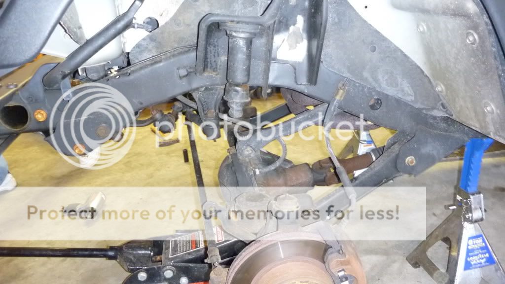

Front shock and spring removed:
New ones installed:
