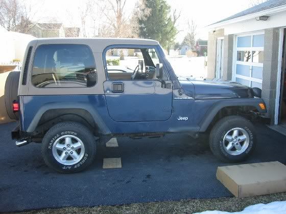

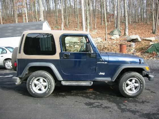

The day I brought it home:

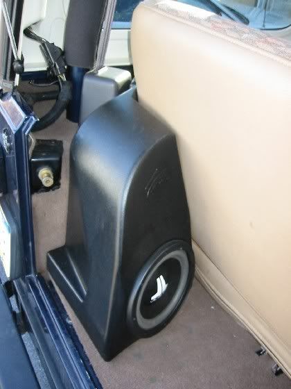

First Mod(gotta have tunes):

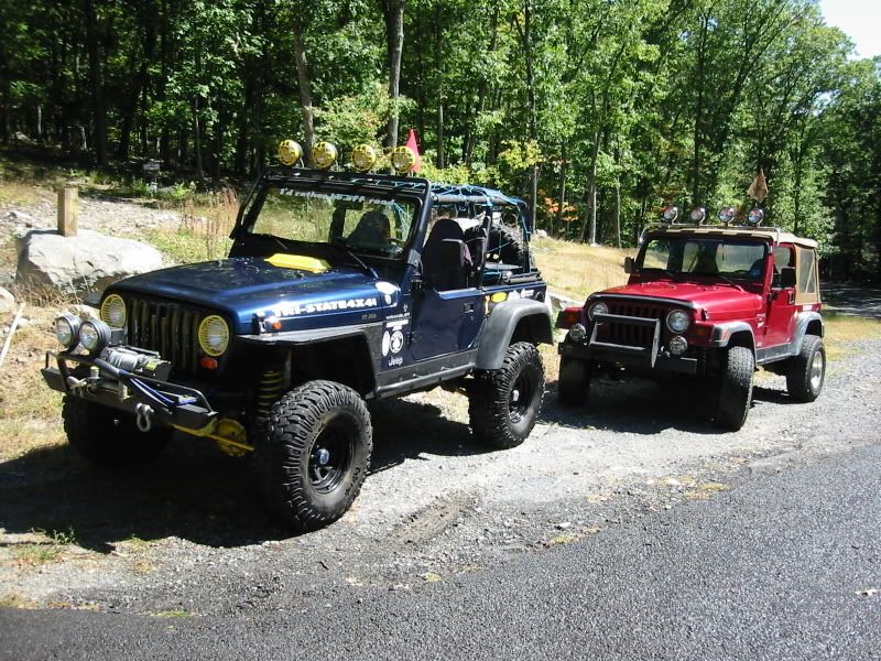

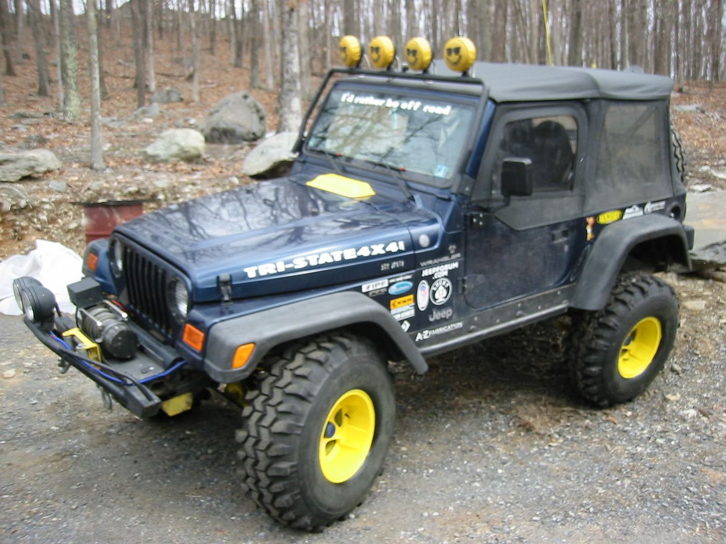

Added Lightbar and MT Tires:

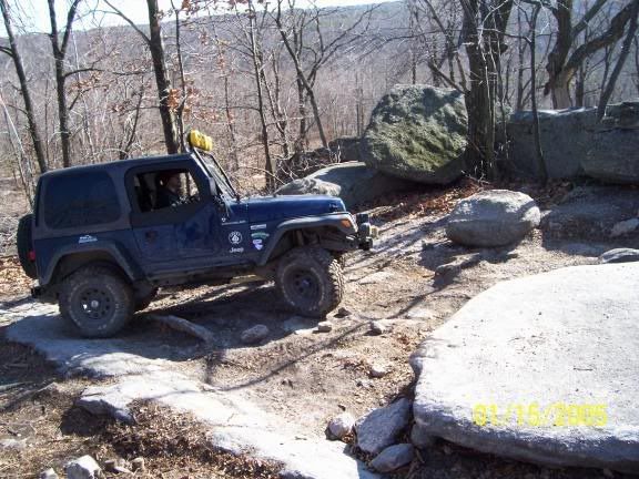

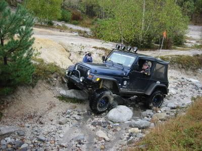

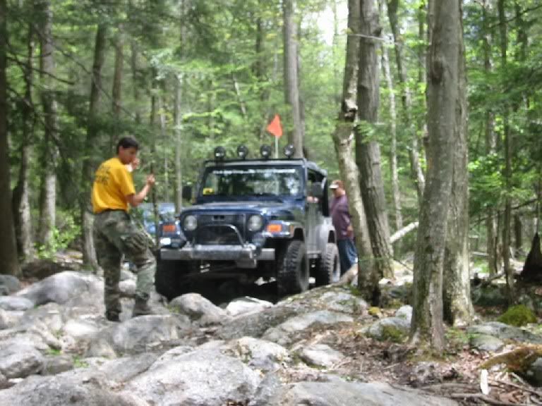

Wheeling:

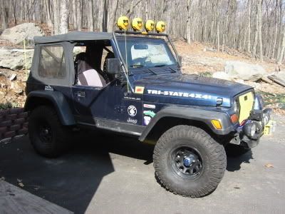

Added Trxus Tires:

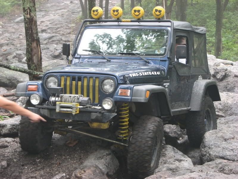

RE 3.5" Superflex, and some yellow paint:
36" TSL's:
Back to 33's and flat fenders:

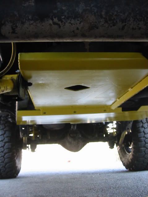

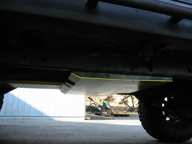

33 engineering Tummy tuck:

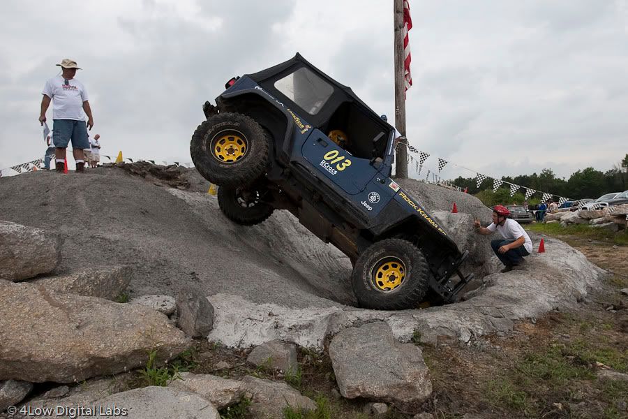

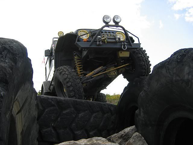

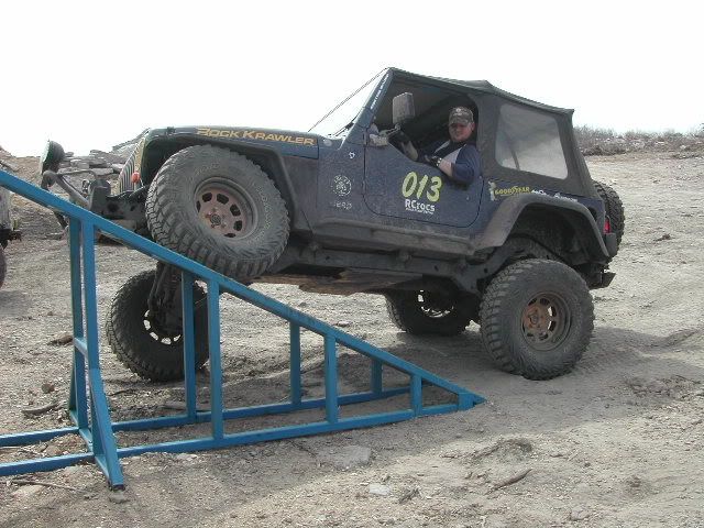

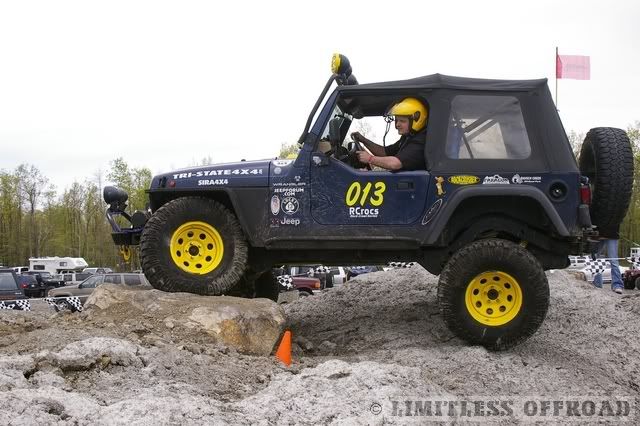

Started competing in RCRocs:

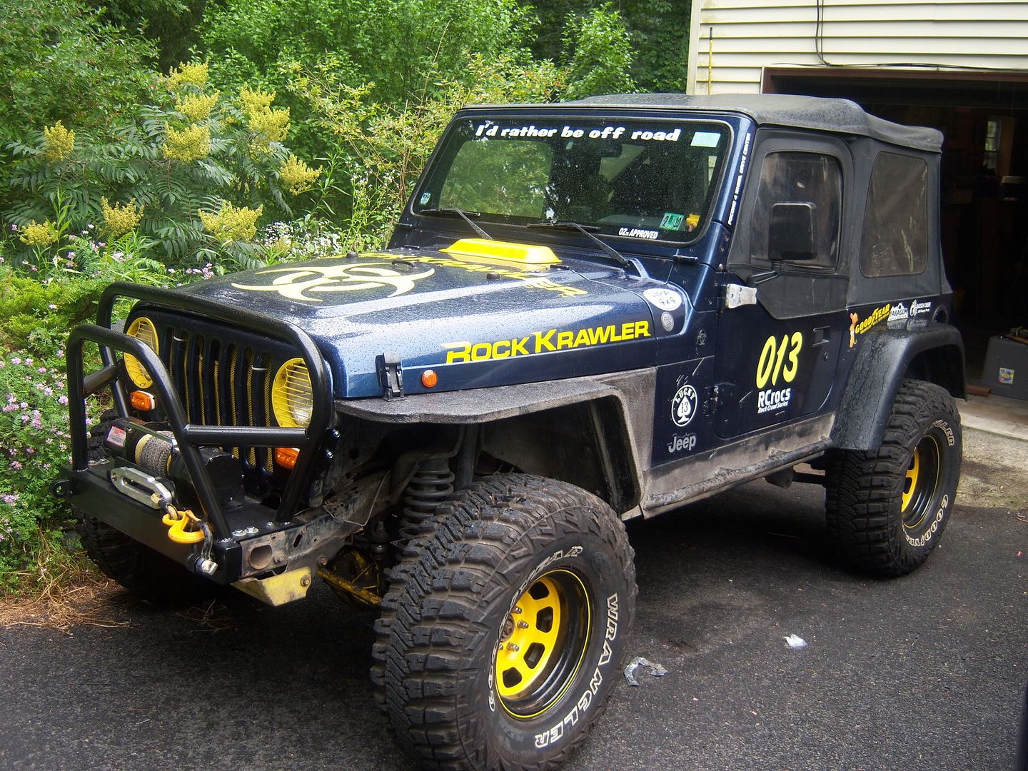

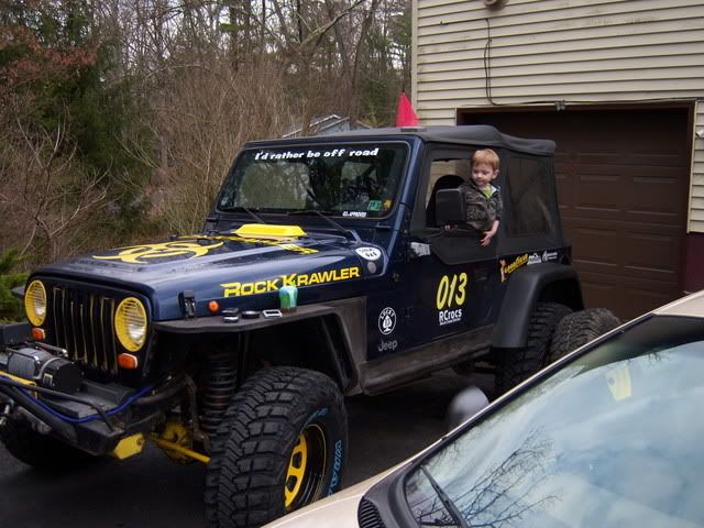

Sponsored by Rock Krawler(Custom 3" lift):

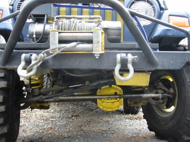

New Front Bumper:
Second year competing:

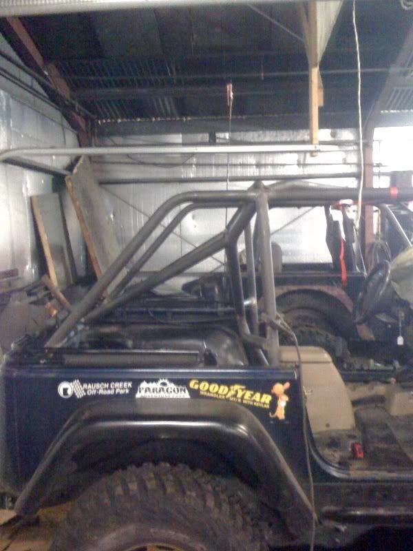

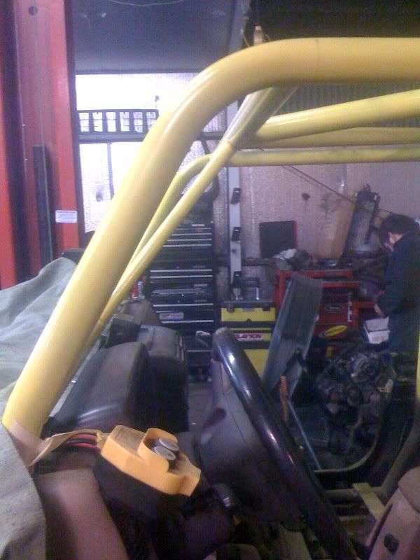

Started the cage build:
More to come soon when the cage is all done!

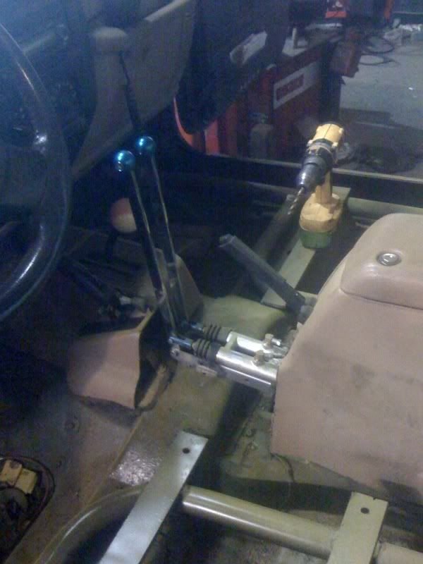

couple teaser update pics, almost done now!

I have never seen that tummy tuck that you have. Looks like it gives you more clearence then some of the other brands. Also the blue and yellow looks great.

The 33 engineering tummy tuck is not made any more as far as I know, It is custom attached to my skid row oil pan skid and i also raised the oil skid about 1.5"

My front D30 has 4.56 gears(now wish it was 4.88) an Aussie Locker, and Yukon chromoly shafts.
The rear is a swapped in D44 with just the 4.56 gears. At one point i had an aussie in that as well, but again the class I compete in only allows 1 locker, and since I cant shut the Aussie off, I had to remove it. Eventully it will be replaced with something!
