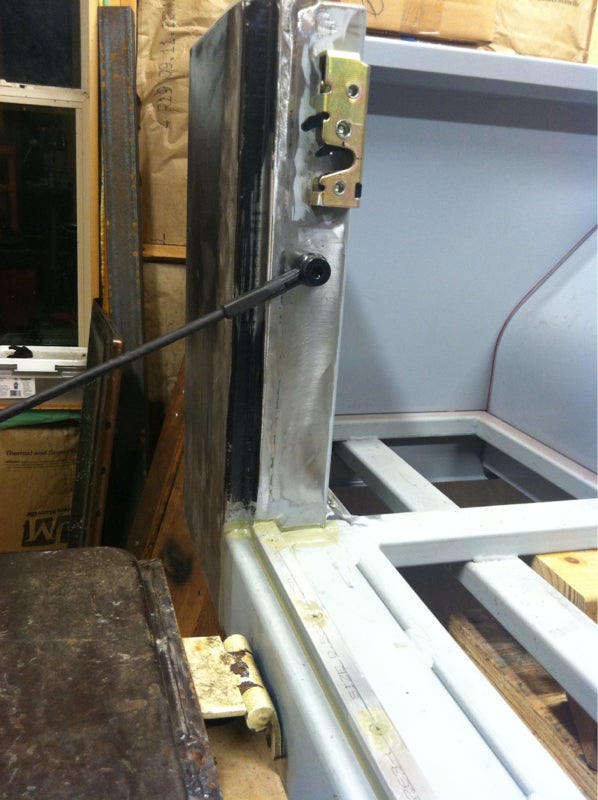

post #114 of 331 Old 09-27-2013, 06:10 PM Thread Starter
jpin86
Location: dallas
Posts: 583
Here is a shot of the lower sill installed. This is what the lower tailgate will seal against.
The corners are really stiff. I can push down on the tailgate and lift the front of the bed up without the rear corners flexing at all.
