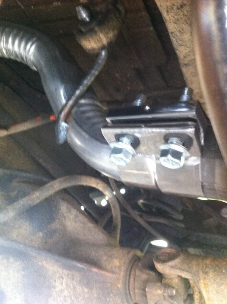

Well I finally had a chance last week to install the new muffler. Overall I'm very happy with the sound of it. Sounds wicked, I guess it's supposed to sound even better after the break in period. Had a harder time getting the muffler on the pipe from the catalytic converter section as they were the same size. So I found a youtube video that shows how you can make a pipe smaller using a basic u-clamp. This worked quite well actually and allowed me use the Walker Stainless steel band clamps I picked up to join the pipes together.
Here is also the old muffler and tailpipe, it was at its end.
Never used these band clamps and I was quite impressed with how well they tighten and seal. I torqued them down to spec and will have to reverify after a couple hundred miles.

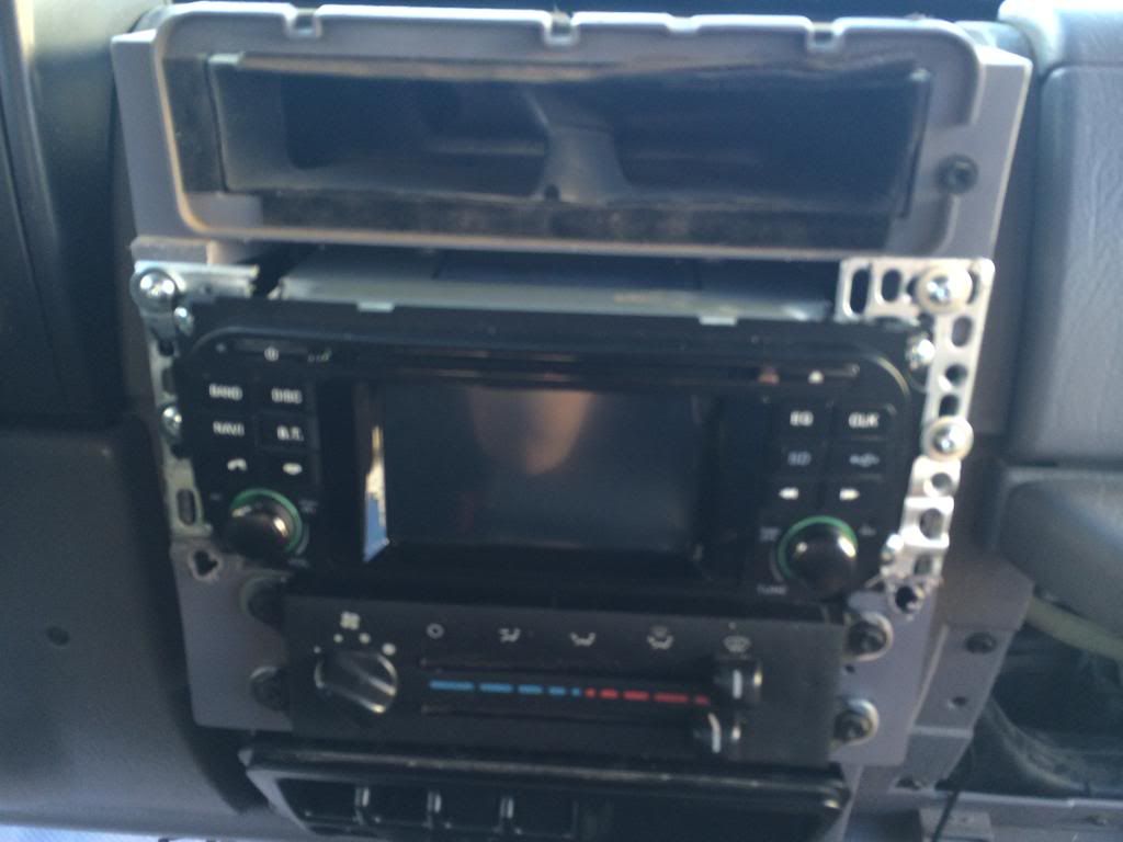

Spend a few days installing my new NAV radio in the Jeep along with ripping out the wiring for m driving lights & fog lights etc.. just a mess under there. Couldn't look at it any longer. Going to re-organize the stuff down there and hopefully come up with some sort of wiring plan.
This is the radio I installed. Unit looks great and works sweet too, quite fast and smooth between going of menus etc. Had to kind of fabricate my own mount as it doesn't quite fit with the pre 02 TJ's but it's in there and not going anywheres.
The little tabs needed to be chopped off on the dash, along with some minor trimming on the bottom to get the new switch tray to fit nicely.
The newer style radios use 4 mounting points, while the older TJ's (square) only use 2 (top right, bottom left) also the holes don't even line up if one wanted to use just the 2 diagonal holes. So I had to fabricate these mounts. Some brackets I came across and I simply straightened them out as they formed an L-shape, then I tacked on nuts&washers to the rear of them in order to fasten the radio to those. While the bracket is held onto the dash using screws.
Here is the unit mounted up with the brackets.
Finished product turned out pretty good. Only thing is with the way one sits in a TJ your somewhat high so the FOV for the stereo sort of cuts off about 1/8" from the upper part of the screen so you can't see the top bar if it has something written on it like the GPS application. Hopefully I'll just have to till the radio up a bit and tighten the upper screws more to give it that pull in from the top but push out from the bottom to get the slight angle. This is also hardly noticeable.
