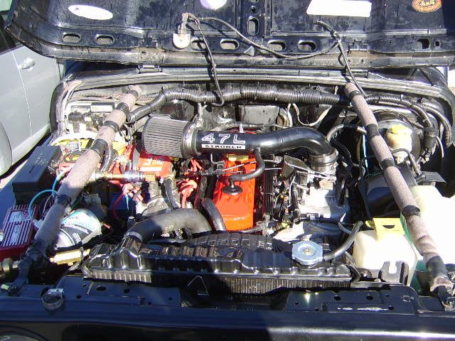

I have finally decided to do a build thread. I bought my Jeep new in February 1997 when I first started the job I am still at. For the first twelve years the Jeep was my daily driver and weekend warrior. In 2009 I bought a vintage Porsche to split daily driver duty and diversify my weekend driving hobbies.
My favorite thing about Jeeps is that they all start out essentially the same, but all come out different in the end. This is how mine turned out…

Motor
• 4.7 I6 Stroker
• 336 horse power 435 foot-pounds of torque @ 3400 RPM
• 4.0L block bored over .030
• 258 crank and rods
• 10.5:1 pistons
• Balanced
• Double roller timing chain
• High volume oil pump
• Comp cams cam
• Ported and polished head
• Back cut oversized valves
• Chevy v8 valve springs
• Late model air intake manifold
• Banks header
• Banks Stinger Cat Back with a custom tail pipe to route around the lift
• High flow cat
• K&N FIPK air intake
• 62mm throttle body and spacer
• MSD-6 ignition with custom quick disconnect
• MSD coil
• MSD 8mm plug wires
• Jet Stage II performance chip
• Centerforce dual friction clutch
• 4-core radiator
• Tomken dual battery tray
• Optima Red Top battery
• Optima Yellow Top battery
• Supplementary vacuum reservoir

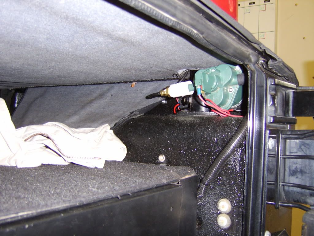

• On board air using Sanden compressor
• Kilby air tank mounted under the Jeep opposite the muffler

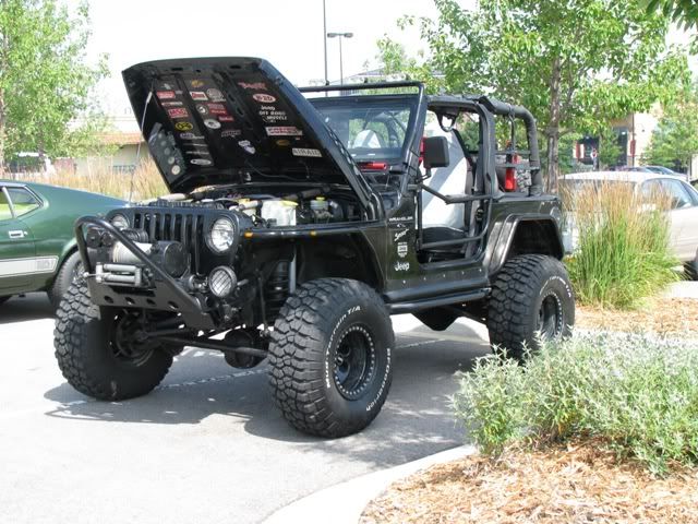

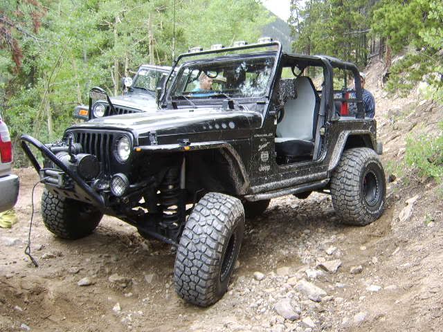

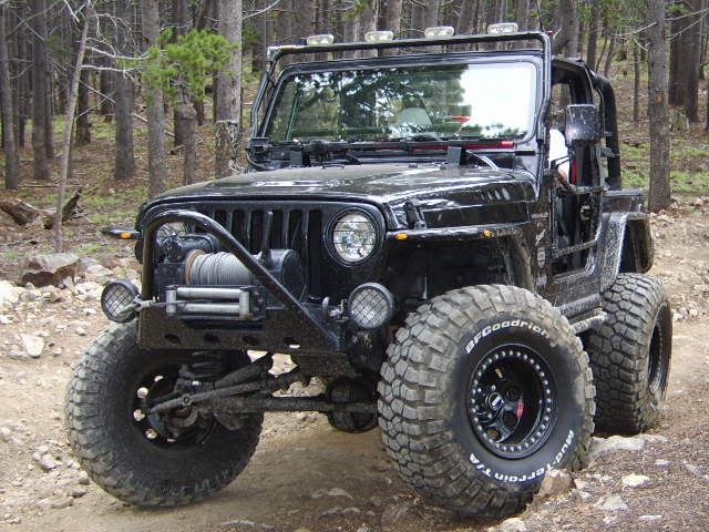

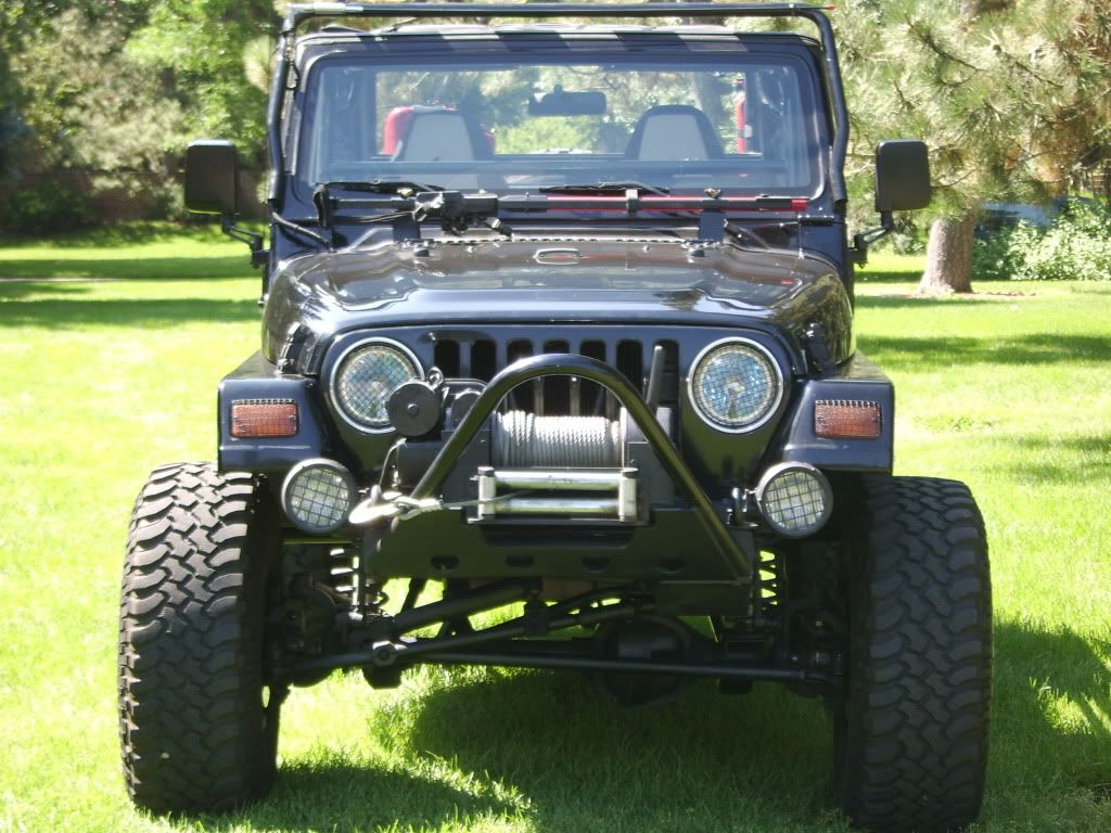

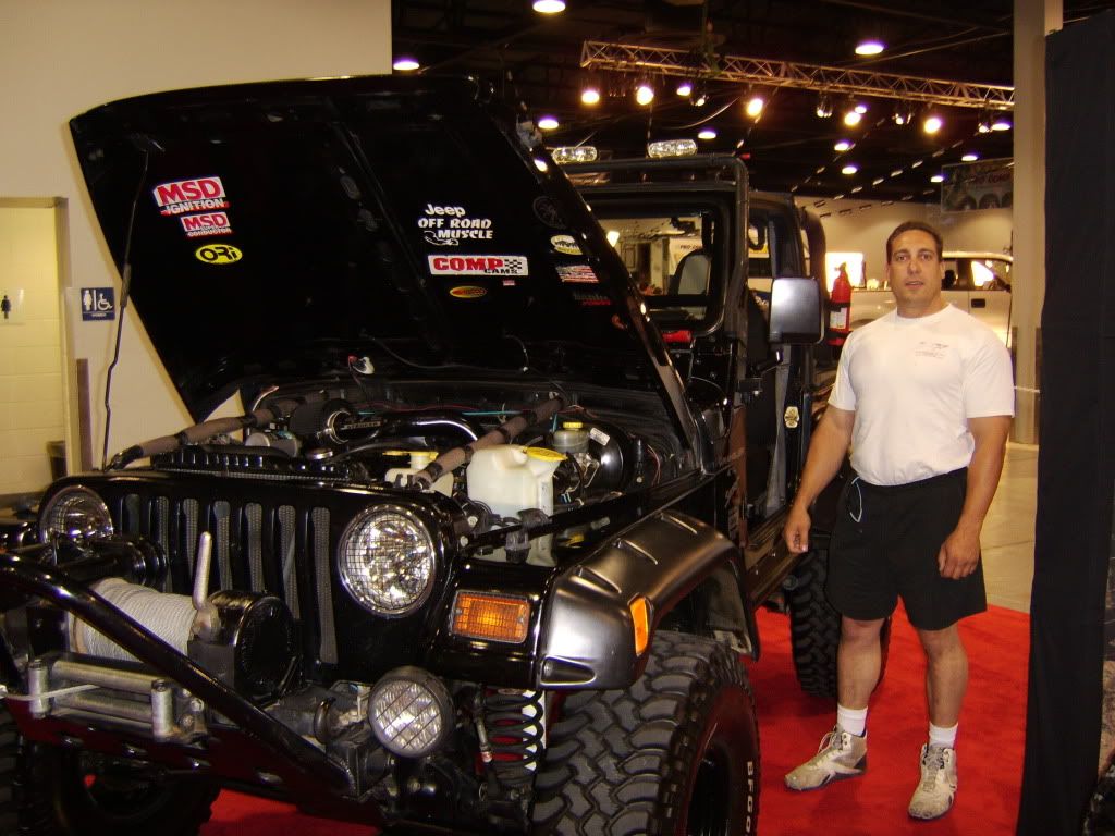

These pictures are from the fifteen years I have owned my Jeep. The Jeep has aged very well as the modifications were mostly improvements. I on the other hand aged through these pictures from 29 to 44 deteriorating daily.

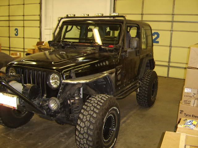

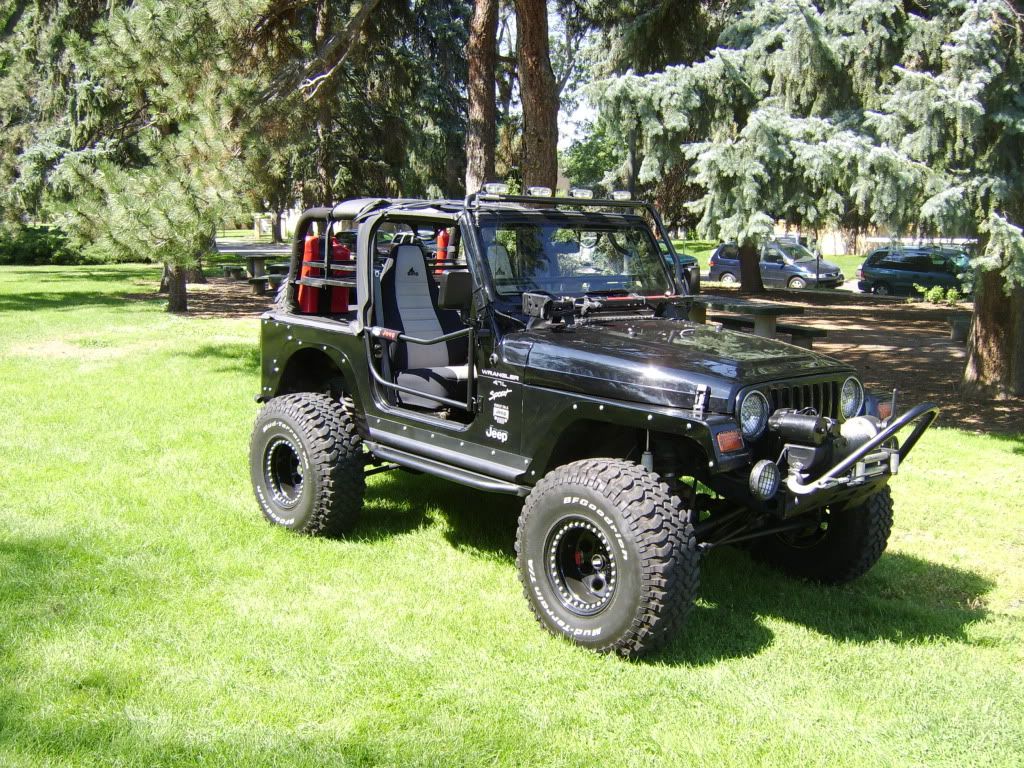

My Jeep as it sits now. The interior at least in winter is a warm quiet place as Jeeps go. The green LED dash lights are a great improvement.
My Jeep as it left the body shop after being rear ended in October 2011 with pictures from the wreck and subsequent repair.

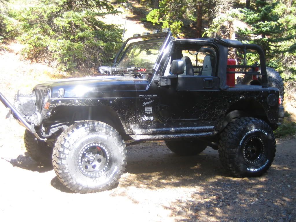

My Jeep last fall on a fall colors drive. One of the best parts of having a Jeep in Colorado is the scenery. I am privileged to live in a beautiful state where it can be as fun to do a light but scenic trail as it is to rock crawl some of the really great local trails. I am afraid I can’t do a Jeep build thread without posting pictures of the local scenery.

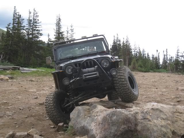

My Jeep is always a favorite at car washes and shows. In my many years I have come to the conclusion that while "chicks dig Jeeps", wives hate them.
[IMG]http://i299.photobucket.com/albums/mm301/Stogie25/Jeep/Build%20Thread/xIMG_6172.jpg[/IMG]
Last summer I took my friend up to wheel his brand new Rubicon Unlimited. As it was his first time offroad, I picked a light but scenic trail to break him in.

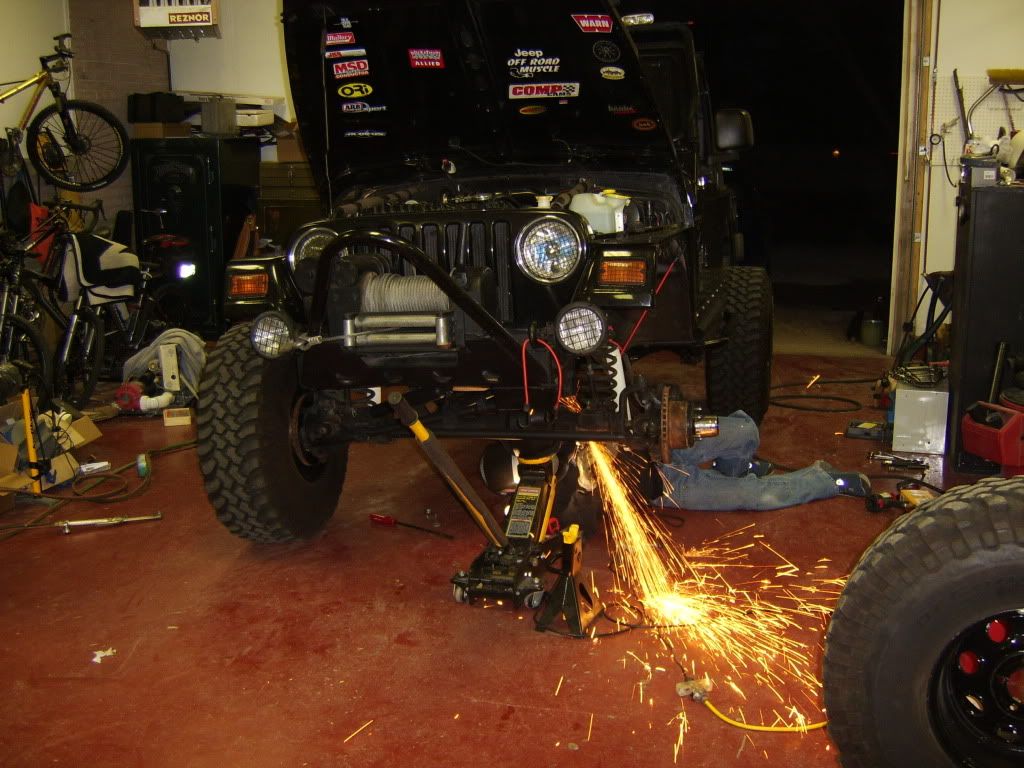

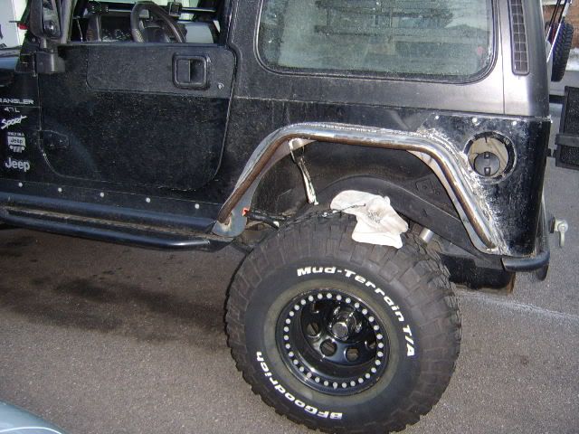

In January of 2009 my neighbor and I assembled and installed Sniperfab tube fenders. We also built the rear tubes out of Poison Spyder tube flares , Poison Spyder trail corners and a little creativity. Cutting perfectly good fenders was an unnatural act.

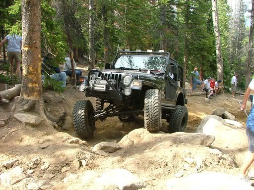

A couple of years ago my neighbor and I were going up for a little light wheeling and some fishing when we found a guy in trouble. Jeepers code dictated that we had to help him. We never got to wheel or fish that day.

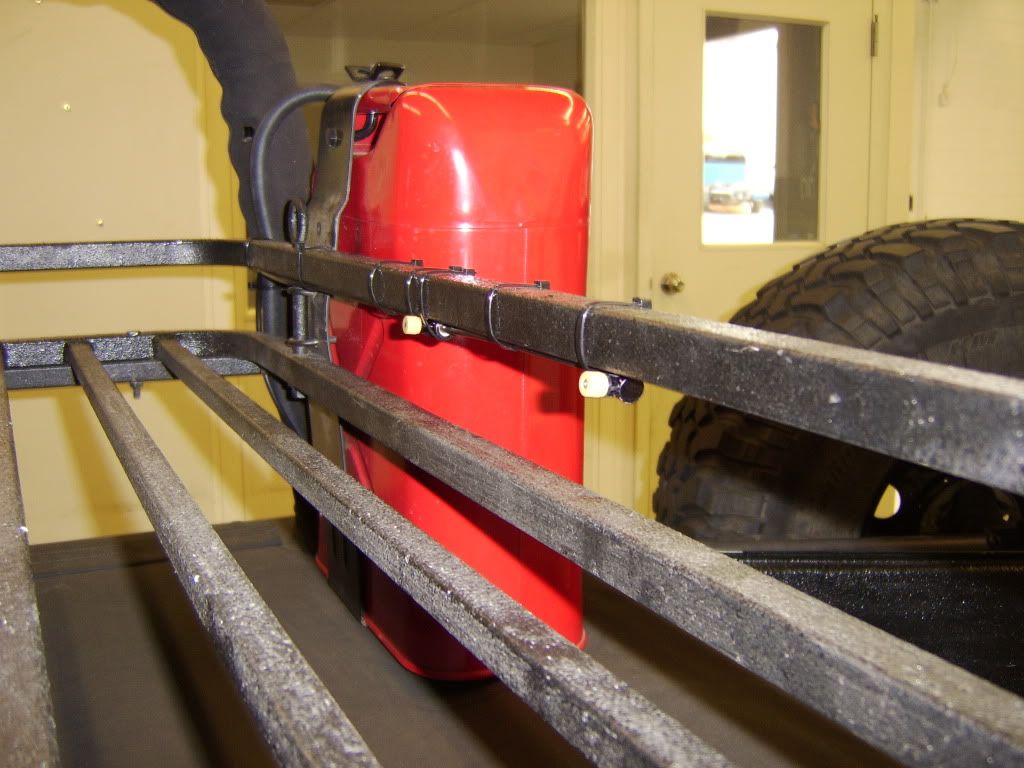

In 2007 I decided to make a misting system for summer. I put it together with a RV water pump using my gas can as a water source. The gas can promptly rusted . The one I use now is lined. I did all the design and testing during that long cold winter.

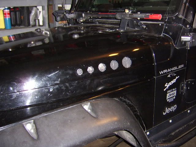

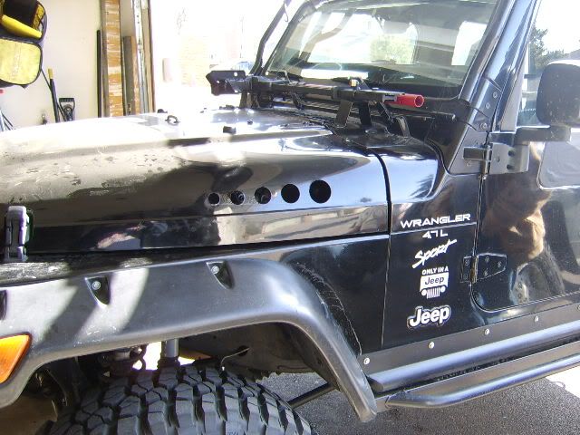

In 2006 I decided to vent my hood. Measure seven or eight times. Cut once.

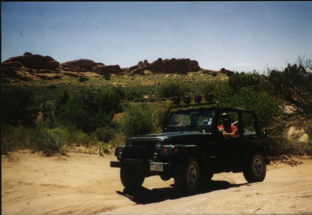

New Jeep including a trip to Moab in 1997.

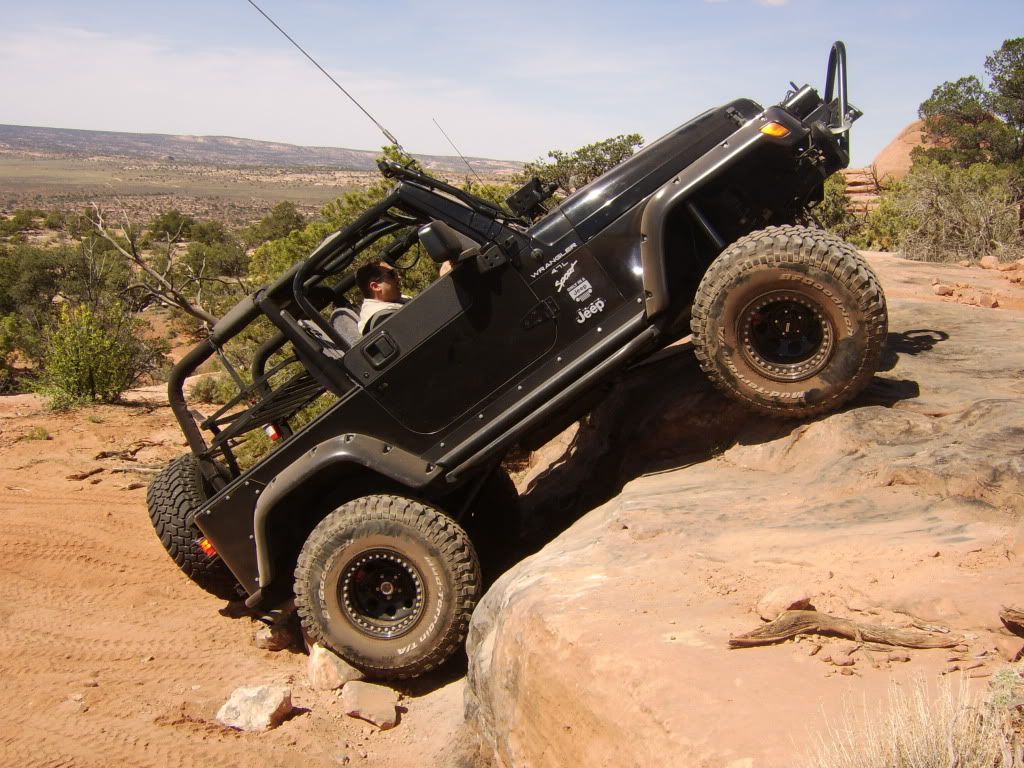

Moab is not too bad of a drive from Denver. I made it to EJS 2005, 2006, 2007. One of the trips we had the good luck to wheel with a couple of the Jeep engineers, Walker Evans, and Brad Kilby.

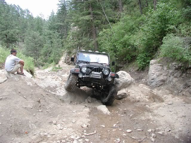

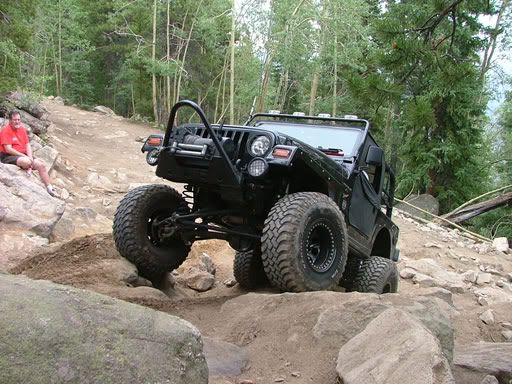

Random wheeling pictures.
Random wrenching pictures.

Vented hood. I use a Scangauge II to monitor my intake temperature. The temps are 20-30 degrees F lower on average then without the hood vents.
