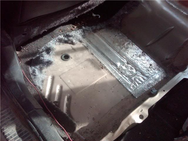

Well Ordering coils soon, and then OME HD leaves in a couple weeks. Meanwhile fixing up the "little things" with the jeep.
Drivers side floor pans look pretty good
BUT
I will be riveting sheetmetal down this weekend and bedlining the interior. Will post pics after I finish. I'm leaving the carpets out and I have some nice cover all floormats to go down.

It's going to be quite the project. ALOT of cutting the biggest PITA will be the seat mount how it doesnt sit flush with the floor and that is quite rusted. I'm going to run sheet metal underneath that and then clean that up as much as possible and if I have to cut rust out of it and strengthen it. Can't wait to get it done although its pretty funny driving around with one seat.

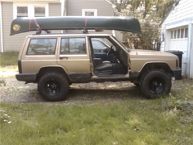

Pic of how its been looking lately

Well my co-worker and I fixed the floors in my jeep today. Big thanks to him I couldn't have done half as good a job without him. Pics of it all cut out and primered. I used Rustoleum Primer for Heavy Rust.
And all sealed up and riveted down.
It was kind of a ***** with that beam for the seat mounts. we had to slide a piece underneath it. I'm going to use some foam in a can to seal up under that really good. If you look at that you can see the plug that's probably for power seats which I don't have so it would be real easy to hook them up.
From here I gotta bedline the floors and tackle the other side. There is only a quarter sized hole in the other side thank god. I'm glad I don't have to do this ever again haha.
