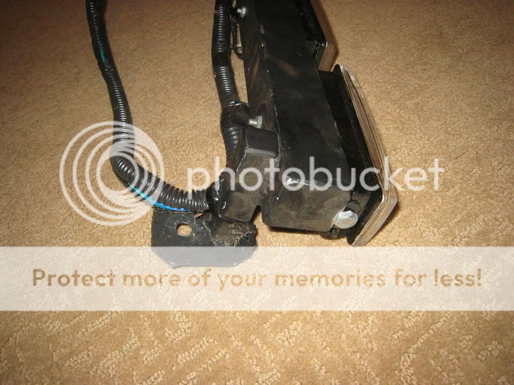

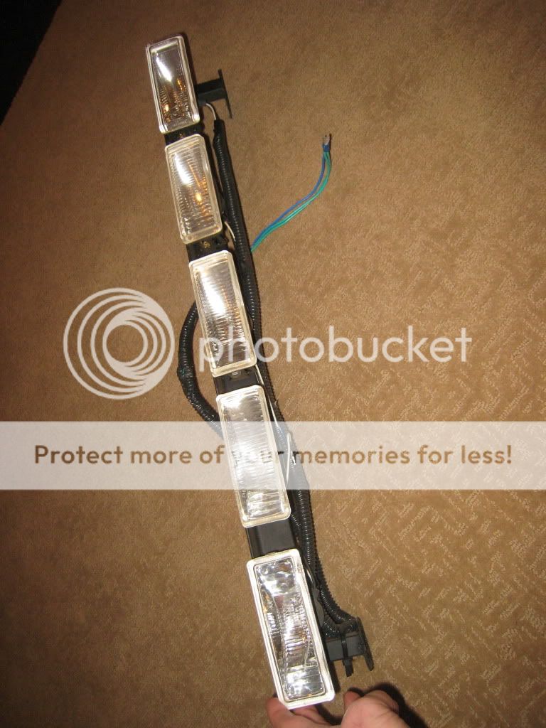

I used five 55w generic brand fog lights. I thought i could get away with it but it was a no go they, were about 3/4 of a inch from the hood. I hope yours will work out better. Ill try and dig up a picture of the one I built. The rubber hood bumpers are easy to get out. Just squeeze the bottom side with pliers and pull. One more thing, they tend to act like a wind screen and flex the hood and shake the lights from bumper position.
Here is what mine light bar looked like. I had just bought a welder and wanted to try my hands at fabricating.
Obviously its been sitting around for awhile.
