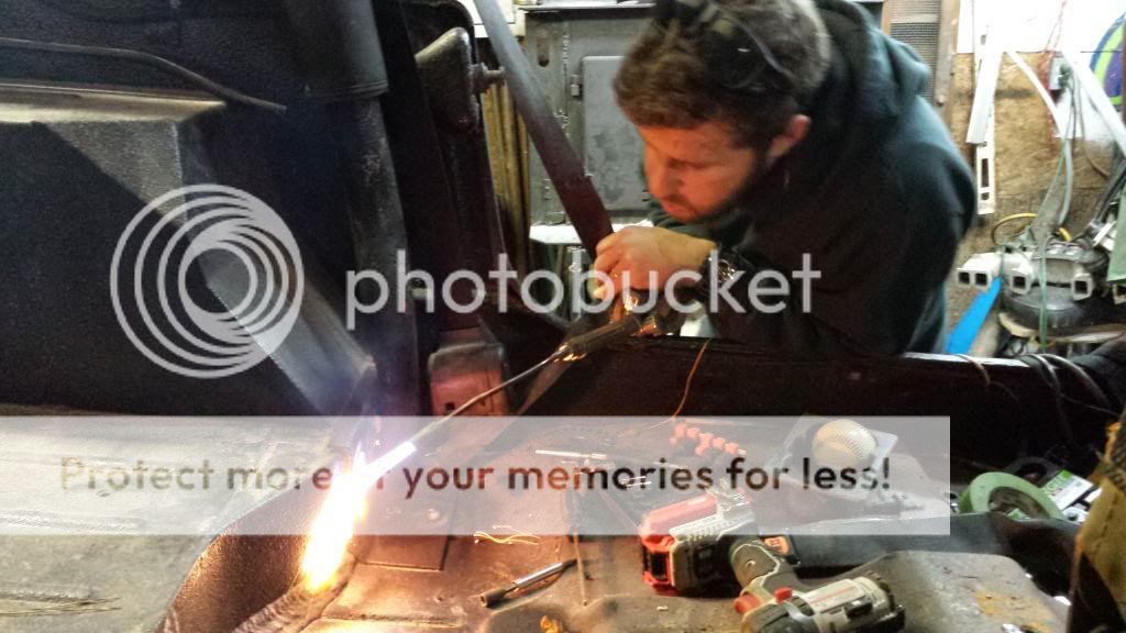

We had to take the torch and heat the bolts of the roll cage, rust sucks and i'm finding out Jeeps have tons.

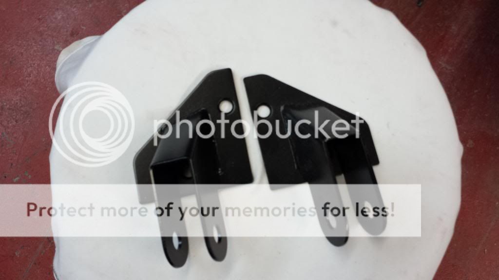

these are the shiftier that I'm going to be using, I'll cut the tail shiftier a 1:1/2.

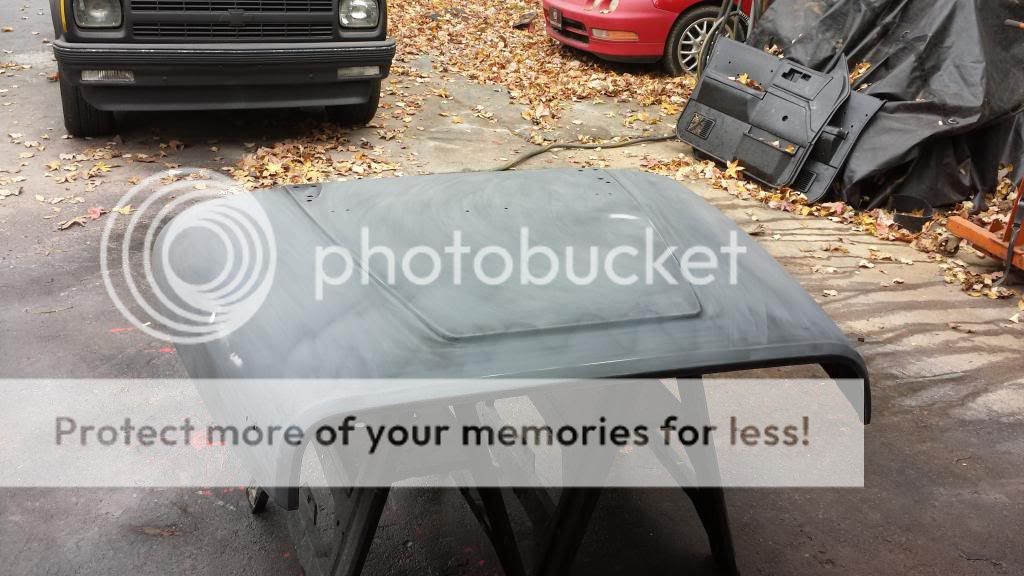

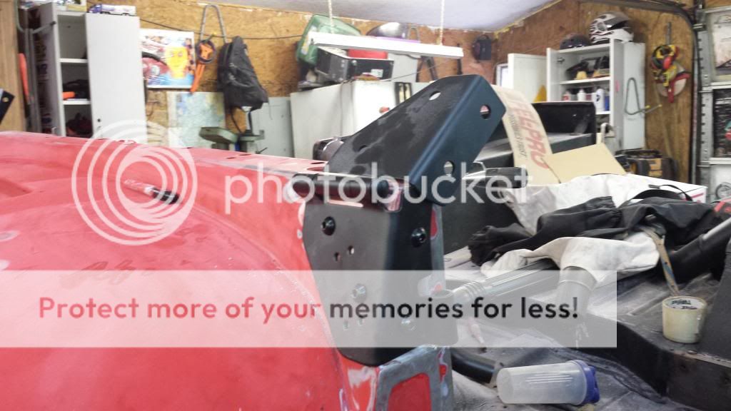

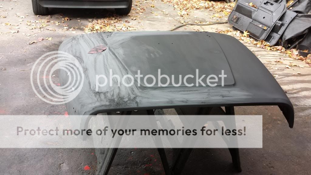

I cut the word Jeep out of the each side of the Jeep, because the rock sliders I'm building are out of 5 inch angle.
[IMG][/IMG]
It Looks like a lot of fill , but it's a a skim coat, it all cuts down to very little filler is left after all the work is done.

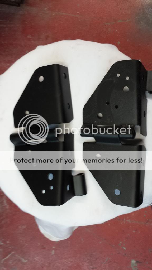

I bought new Smitty hardware, it's not as heavy as oem, but it will work.

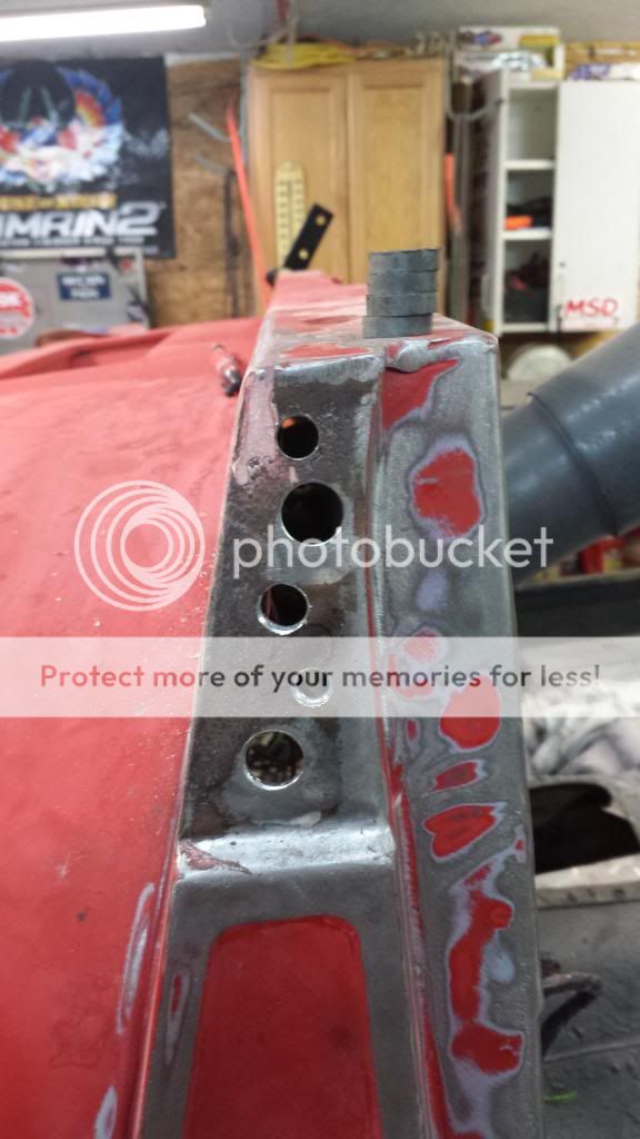

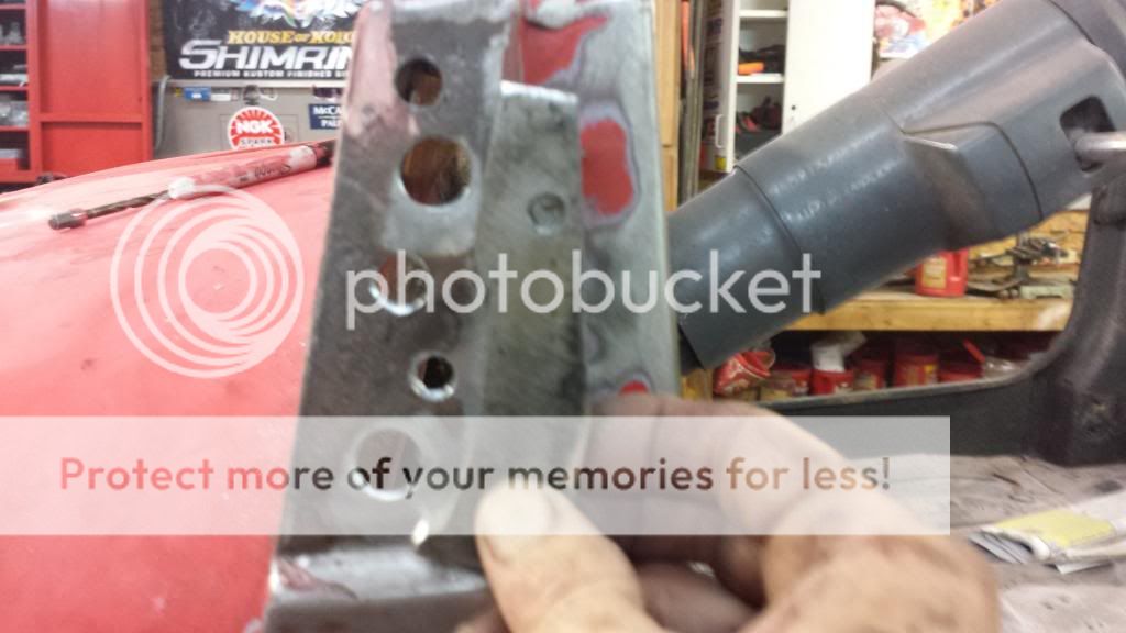

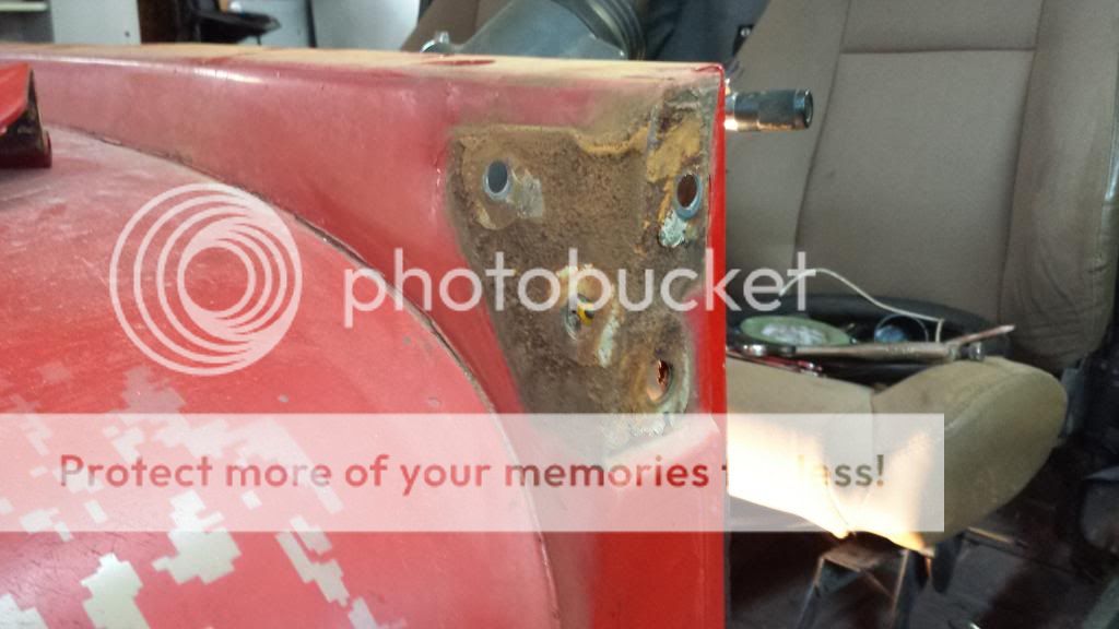

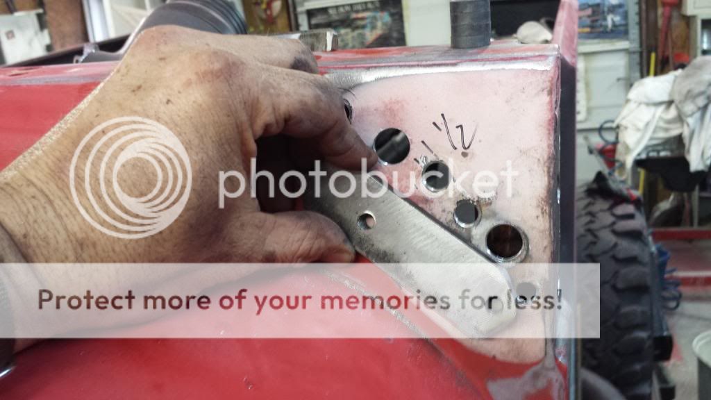

About 70% of the bolts broke off in the retainer, so I board out all the holes and made my own retainers a welded them.

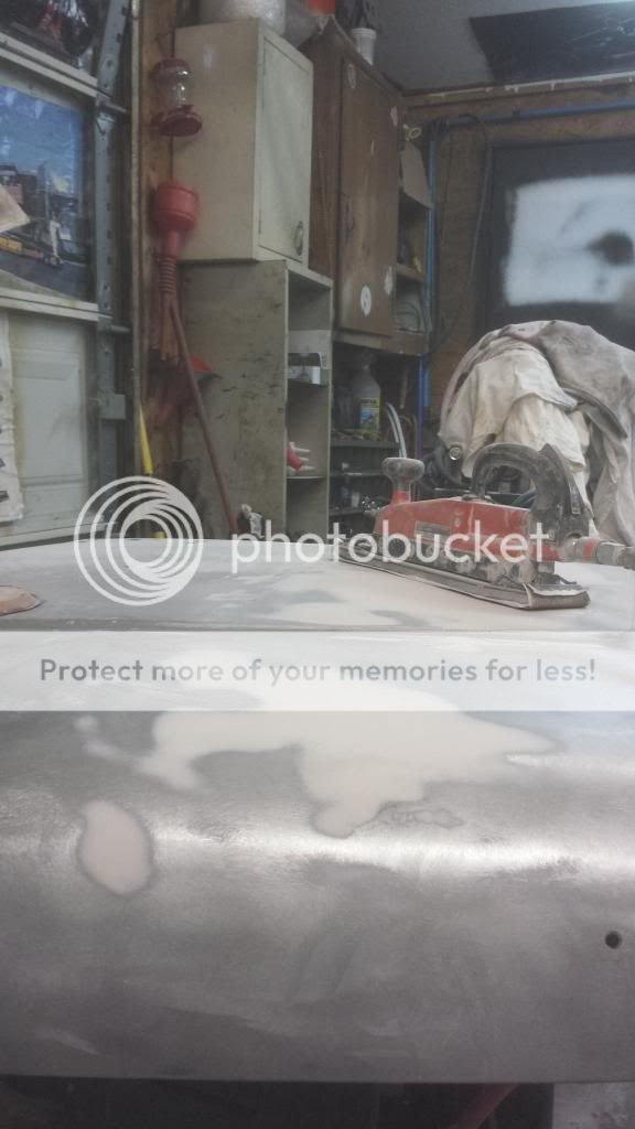

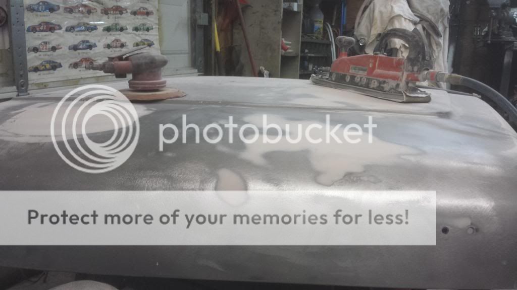

I put in primer and started sanding and blocking, this is always a fun job NOT.

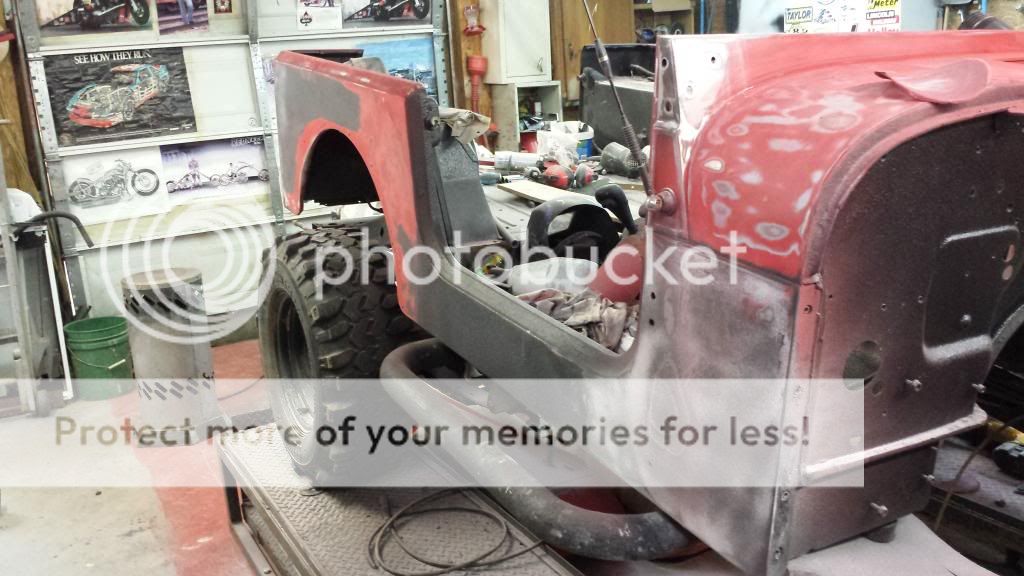

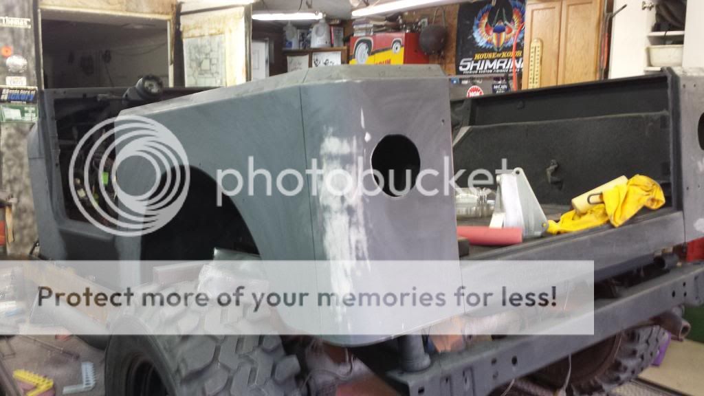

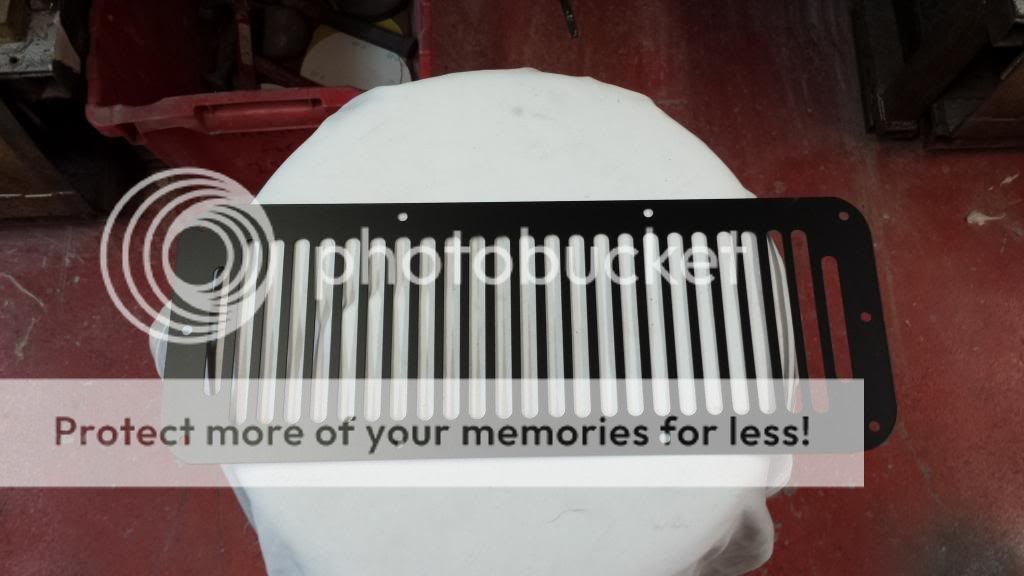

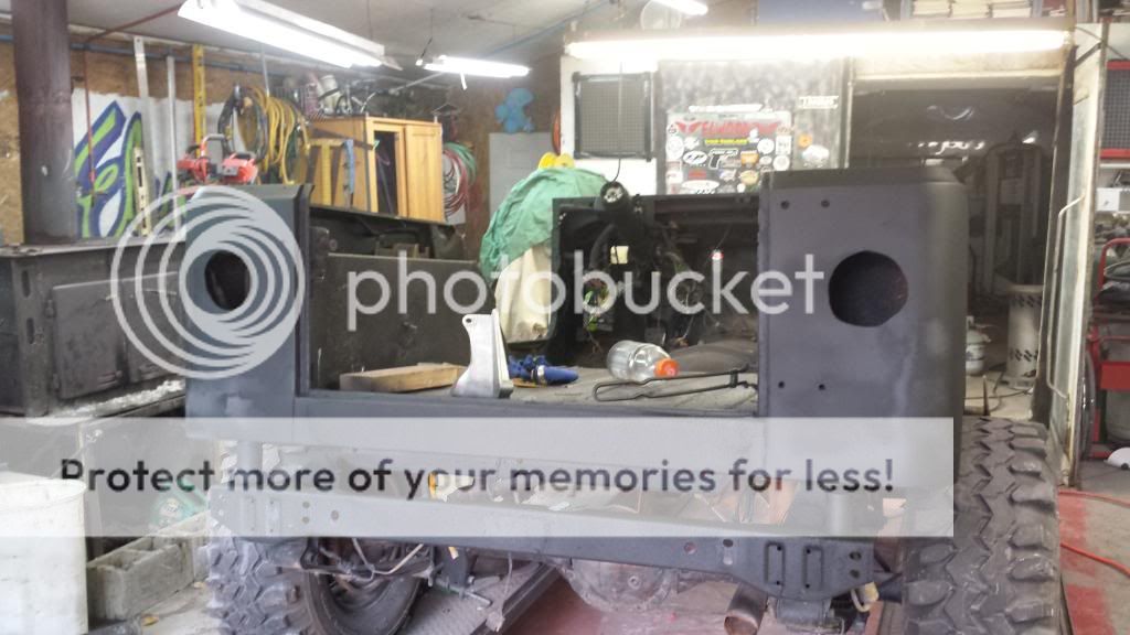

My Next step are the fenders, I'm using the stock fenders to make the old style Jeep fenders, the front are 7 inches, I've made them with vents in the wheels wells that go into the engine bay, buy also will drain out the bottom. I'm spraying them with Herculiner and painting over them with military desert sand color.
