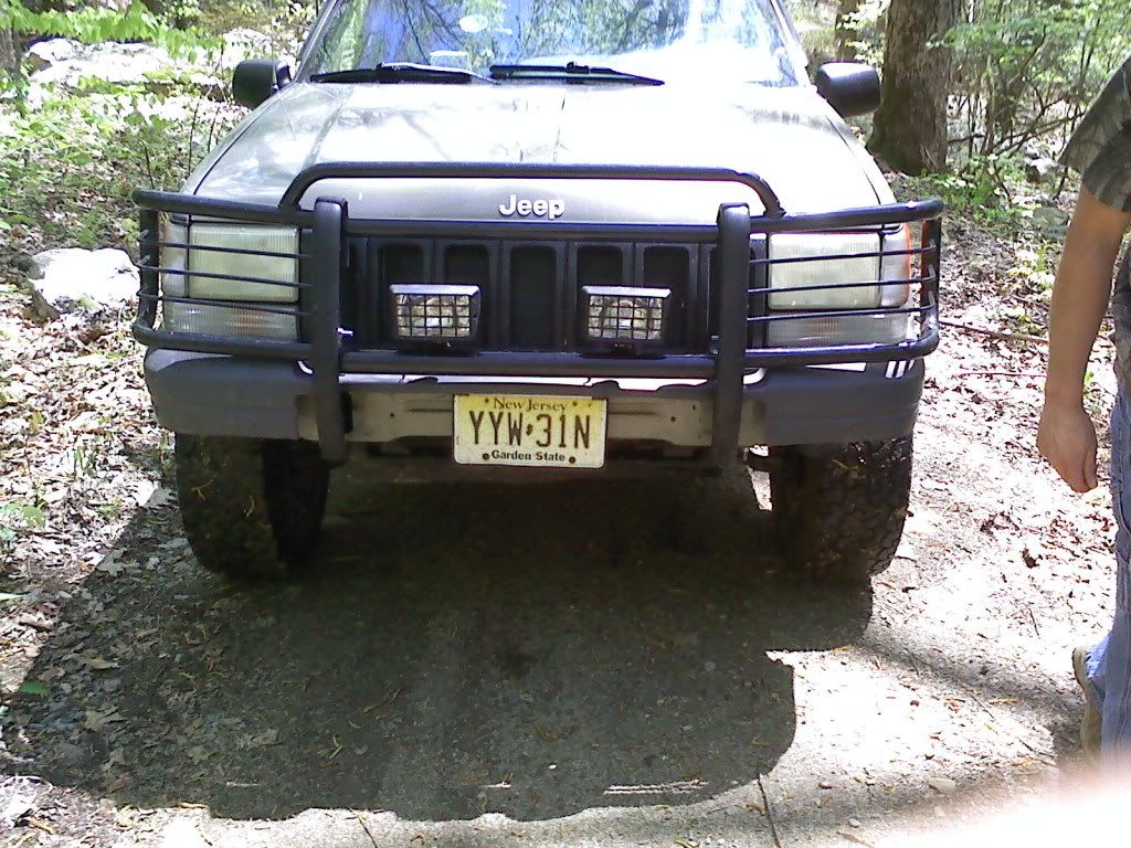

Oh yeah almost forgot i also fixed the brush guard from pushing the bumper down...

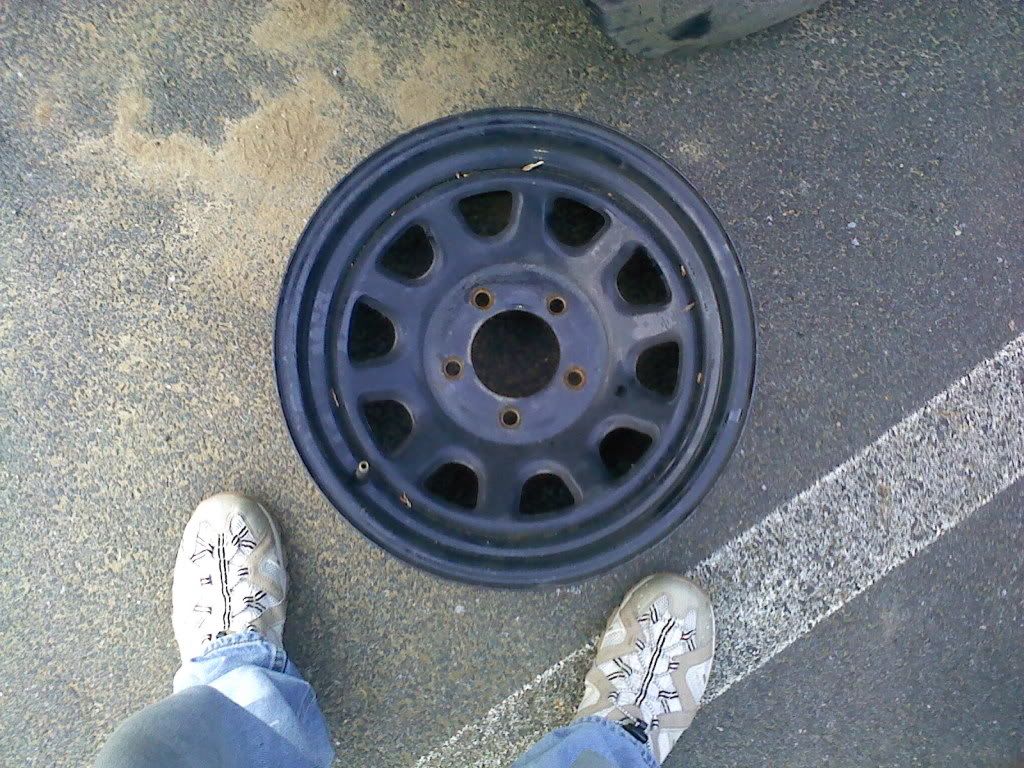

Then as we came to a little clearing there was sitting on the trail a pretty good looking d window rim...lol... so now i got me a spare for this set im running now

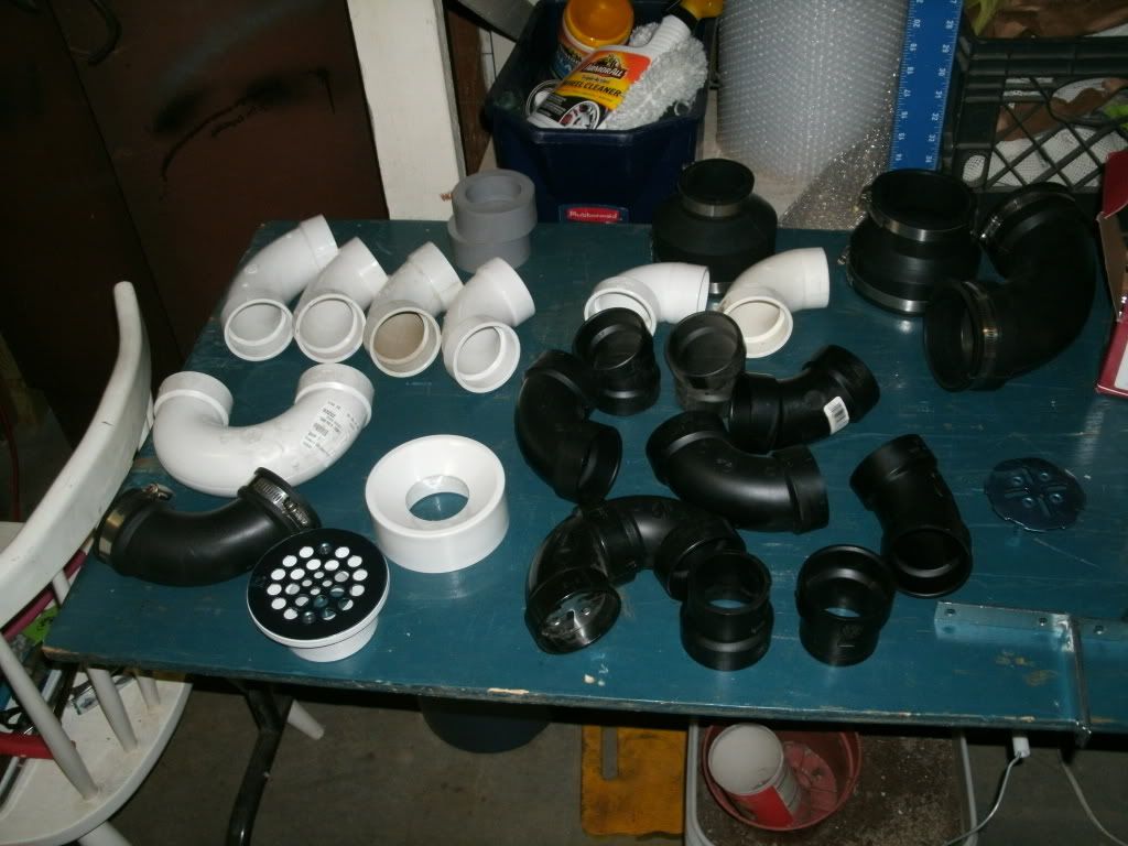

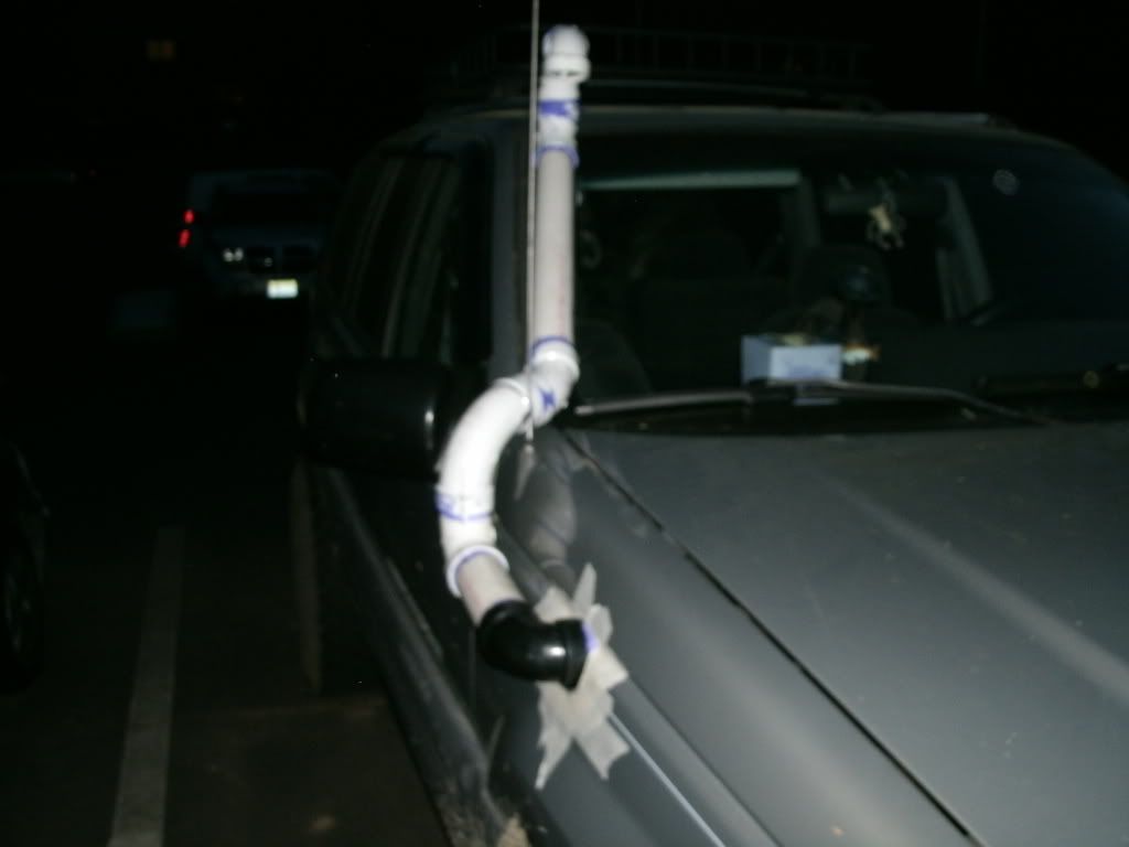

Ok so as promised i started working on the snorkel. I had been researching about homemade ones since i bought the jeep and could not find anyone who home built on the passenger side. So i decided not to follow the pack and make one that i wanted. I started with the standard 2 inch PVC pipe and went to town.
paulyboy is offline
post #82 of 675 Old 05-10-2011, 08:25 PM Thread Starter
paulyboy
Location: Randolph
Posts: 1,035
decided abs sucks and went with all PVC schedule 40 except one fitting that i didn't have.

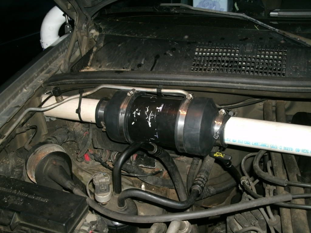

I had to come up with a filter box idea that not only would fit in the space but would hold a filter as well. Found a performance air filter that goes into 4 inch air intake piping so i used two reducers and made the box out of 4 inch PVC.

Don't worry zip ties are temporary and the whole thing is going to get painted.

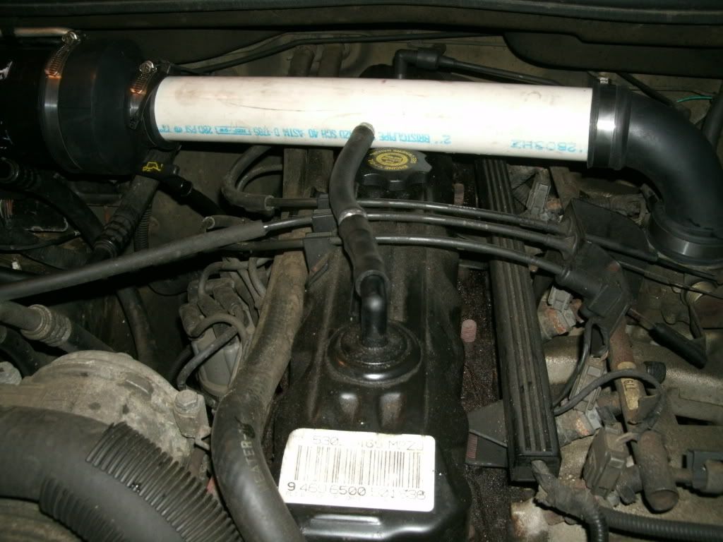

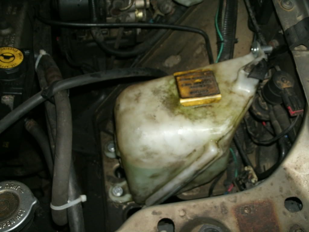

Then i realized the coolant overflow was in my way. But i didn't stress it because i figured that it would fit where the stock air box was and boy was i right fit like a glove.

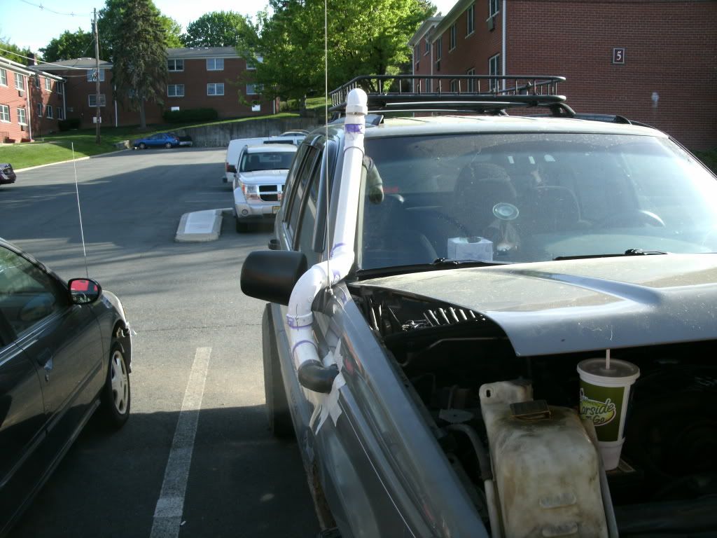

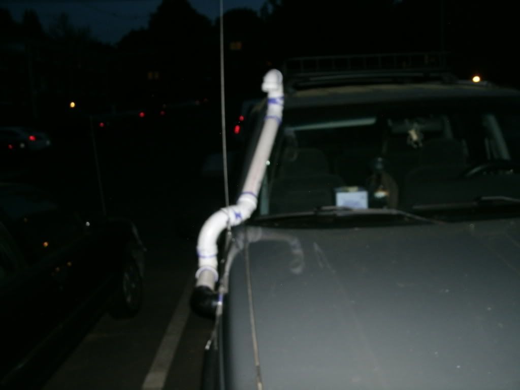

overall im happy with the little project and i just wanted to be different and not have the dam thing in my vision on the drivers side. I also wasn't a fan of running the pipe all the way from end to end on the outside of the fender as well.

oh and some trim for the whole in the fender i cut to make it look clean and tight.

didn't have a shot of the throttle body and the vacuum line that was relocated.

and the oil blow back line ..need to delete this so i dont get anymore nasty crap on my throttle body

So hopefully now my filter wont get wet every time i go thorough a dam puddle. Next pics will be of it painted and mounted correctly.
