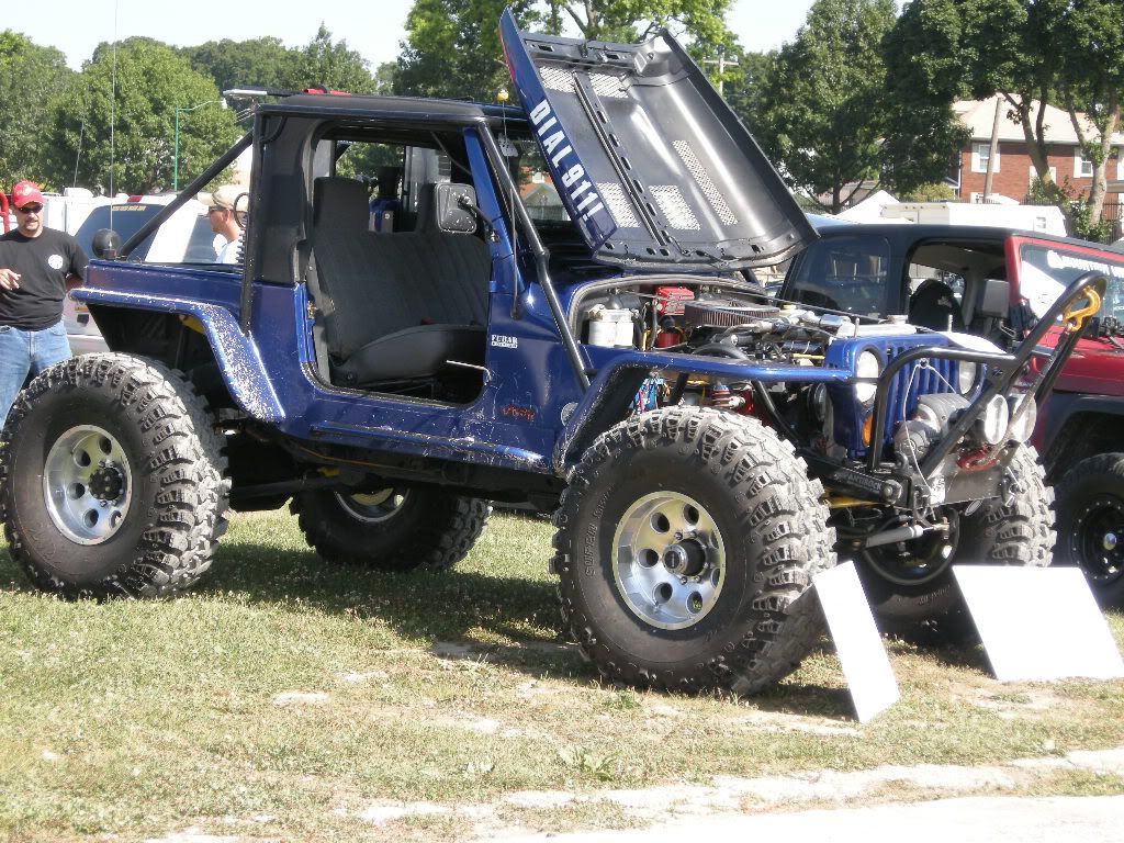

We recently finished revamping my TJ. We are still working some of the small bugs out, but so far everything is performing off the scale.
Here's the run down:
1966 corvette engine turned into a 355
Pete Jackson Noisy gear drive
Roller rockers
Magnum pushrods
Holley Projection intake
TBI setup from an '89 Suburban
Centerforce Dual Friction Clutch
SM420
Klune with 2.72:1
Dana 300 with 4:1
Pinion brake
Front axle: 1979 Power wagon kingpin D60 with 5.13s, hydro assist, custom truss, custom coilover mounts, 1985 Chevy 3/4 ton hubs and rotors to convert from DRW width, custom 3-link with trackbar, high steer
Rear axle: 1992 F250 Sterling 10.25 with a Detroit and 5.13s, custom truss, custom 4-link, custom cantilevered coilover system
17x10s with Stauns and 42x14x17 Iroks
Custom Exo
Custom flat fenders
Custom rear fenders
Custom flat dash
Custom Winch bumper
Custom bellyup
Custom fuel cell
Benchseat from an '89 Toyota truck
There's more but you get the idea...

Thanks a lot everyone! Yes, the rear suspension is adjustable 3 different ways per side. I can adjust the link that attaches the cantilever arm to the rear axle, I can adjust the coilovers and I can adjust the nitrogen pressure in the coilovers. Trust me, it flexes really well!
Keep in mind, the way you see my jeep in Diablo's vid, that's my DD configuration. I drove a little over 2 hours one way to the PA Jeeps Show, wheeled the rocks a lot over the weekend and then drove it over 2 hours home.
