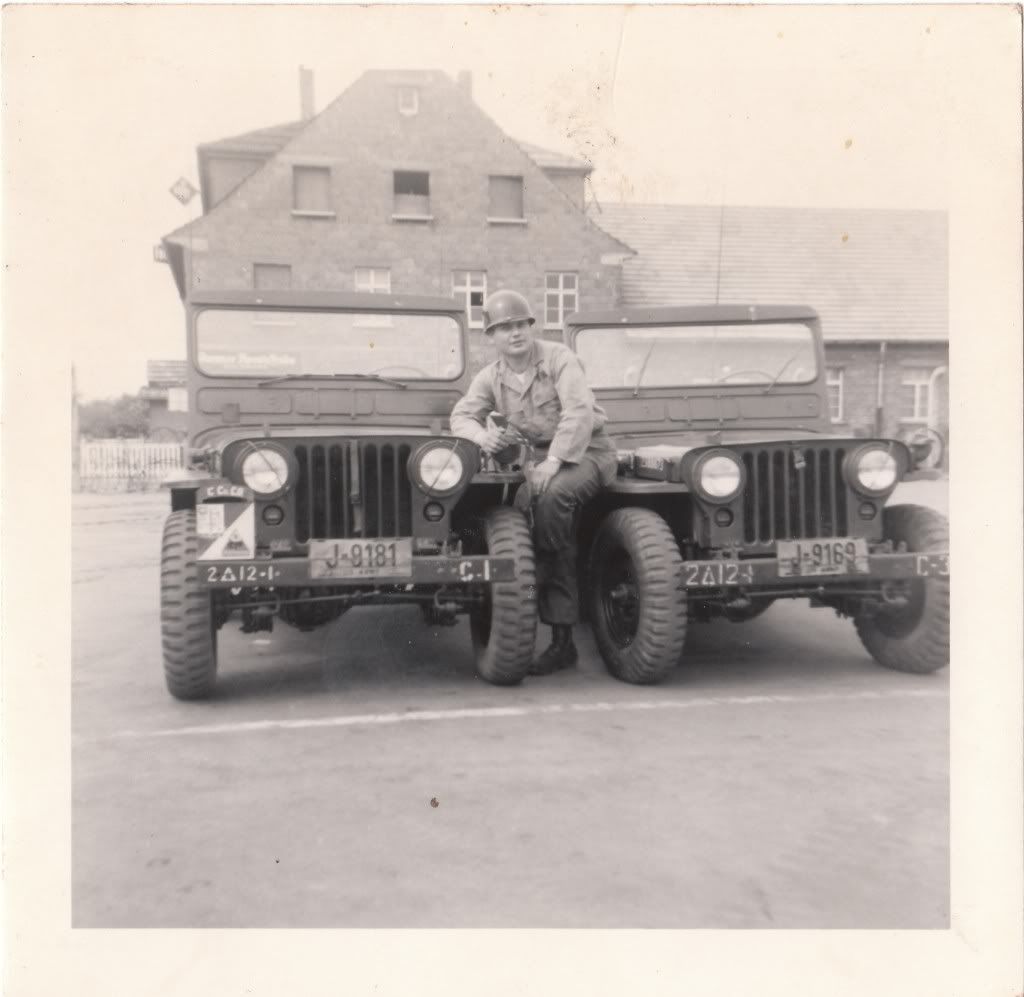

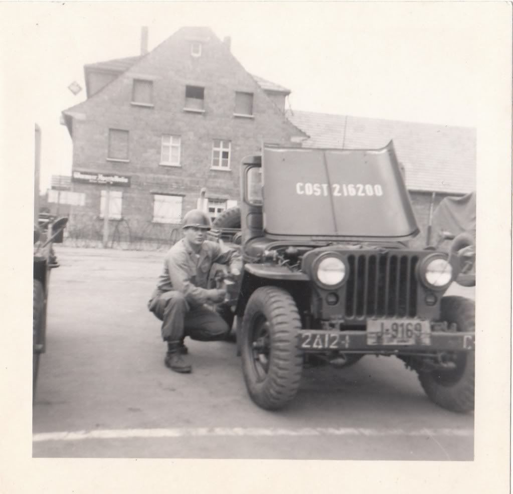

This is what I am going for. A rolling tribute to my wife's grandfather. He was in the Korean war and drove this Jeep. I know he had the M38 and mine is a 2A, the average human won't know the difference.
'74 Cherokee 401

The photo is a WWII jeep, not a M38. Either way, I think it is a great tribute!!
Take care,
Thanks but....he is sitting on the same Jeep in this photo.
M38.
