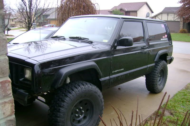

ya good choice staying with the flareless look. Flares are only really worth it if u dont have any problems in the stock location. Most mods to flares start to look awkward. nice work!
Thanks man. And thats the exact word I was looking for, it looked awkward with the flares

yeah alot better with the flares off. great build! it really makes me want to find a two door. my dad had one for quite some time and i loved it. it was the champaign color but i like the black better.

Originally Posted by black2door
Heres a pic when I had them on.
Those are your stock flares?
I was thinking it would look like this:
Originally Posted by alwaysready
Sold the 98 TJ Sahara. Buying another Jeep soon!
98tjsahara is offline
post #40 of 456 Old 01-18-2008, 07:49 AM Thread Starter
black2door
black2door's Avatar
1994 XJ Cherokee
Location: Springfield, MO
Posts: 1,897
Yeah, but I had to mount them up higher to clear my trimmed fenders. So it doesnt extend all the way down.
