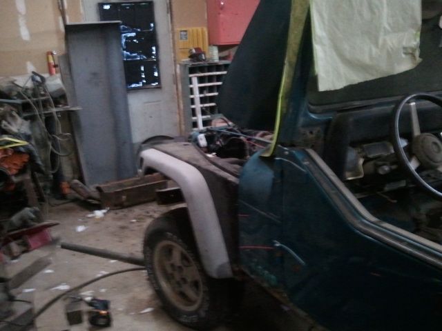

Since then I really haven't had any time to get into the garage to work on the old girl. Until today! A short day due to having accrued to many hours at work this week led to an afternoon of cutting up Jeep bodies! This is just mocked together for now as I found a few small rust areas on the donor piece that I want to fix before I weld them together and I need to get the CJ Tail gate installed! The only pic for now since I left the digicam in the shop!

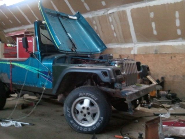

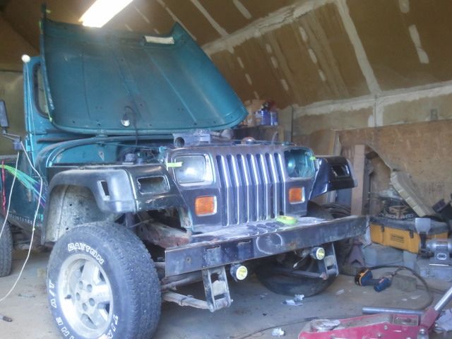

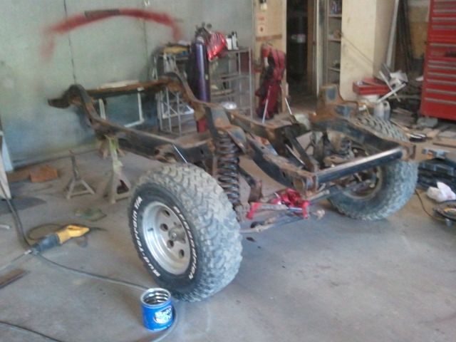

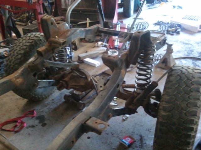

Today however I began to work on the frame and I ordered the tube for the fenders! I picked up a High Pinion Dana 30 that I am going to use up front for now as well as a 8.8 rear that I will eventually get installed. I also got a set of 3" TJ lift springs.
For those of you who may be reading this and are knowledgeable about building control arms i have a question! I was planning to use 2" DOM .250 wall and 1.5" weld in bungs. Now I have run into some confusion.
I was watching Search and Restore the other day and Ian used 2" .120 wall and sleeved it with 1.75" .120 wall. Is there any benefit to doing this over simply using 2" .250 wall.
Anyway here are a couple of pics that show where I ended up today. Those are the 31" tires that came on my YJ, I plan to run 35's.

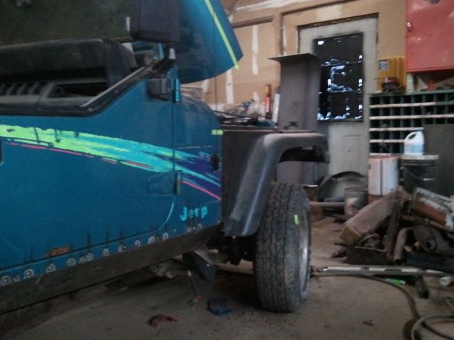

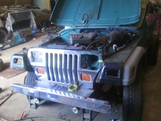

While I am waiting on some parts to come in to work on getting the frame together I decided to start on my highline front fenders.
I ended up getting a good deal on a pair of tj fenders that had the typical rust issues. I only wanted them for the inner fenders and the part that connects to the tub so I snagged them. Got these mocked up on the jeep to get my measurements for cutting the hood.
Much to my surprise these fenders would be easily adapted for use on a YJ with a 2.5" highline! I will be cutting most of them away once I get all the mounting points figured out and the hood cut down.
Here are some pictures...
Just run the 2" .25" wall lowers it'll be more than enough. I run 2" .25wall lowers and 1.75" .120wall upper without issue on my 3 linked yj.
