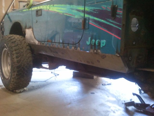

Ok well made some progress tonight, spent about 5 hours in the garage. I did a lot of work but it doesn't look like it! I had to cut out my boatside and start over. Pain in the butt but at least now things line up a lot better! Lesson learned is dont buy a rotted out jeep...LOL! Nothing lined up right due to the amount of body distortion from everything being rusted off.
here are the few pics I took

my boatside after I cut it out with the plasma cutter
Mostly together, still have some welding and lots of grinding to do. doesnt look nearly as pretty as the first time around where the welds go!
side view! Like I said it doesn't look very much different but it was really a fair amount of work!

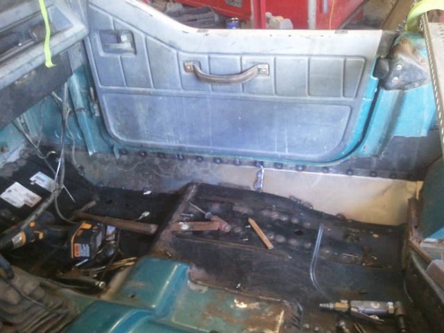

Got the drivers side nearly finished up as far as rebuilding the tub and boatsides are concerned. Began cutting out the pass side floor boards, fortunately the floor supports are in much better condition and are salvageable on this side! the middle and rearward of the three center body bolts broke coming out so I need to go and pick up some new nuts to weld in before I can start welding the floors back in.
Here are a few pics.

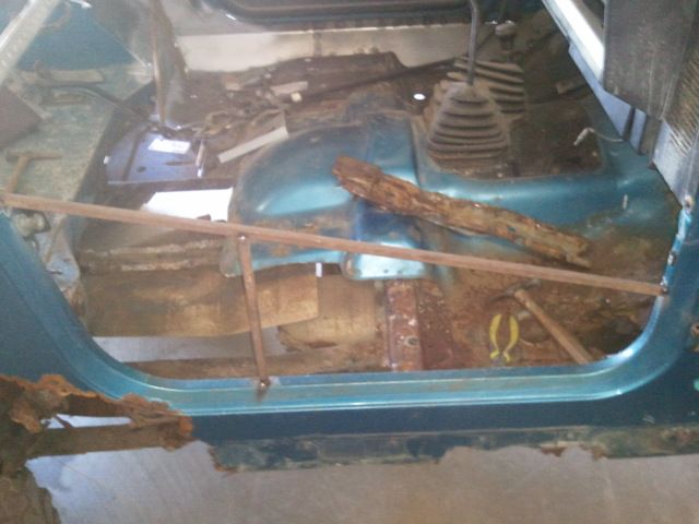

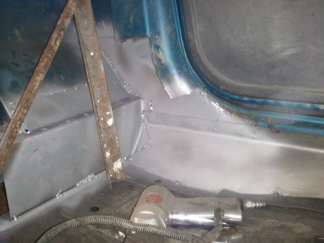

Inside view of drivers side just in front of wheel well. Parts are just tacked into place in these shots. The angle iron and square tubing are supports I tacked in place in an attempt to keep the tub shape.

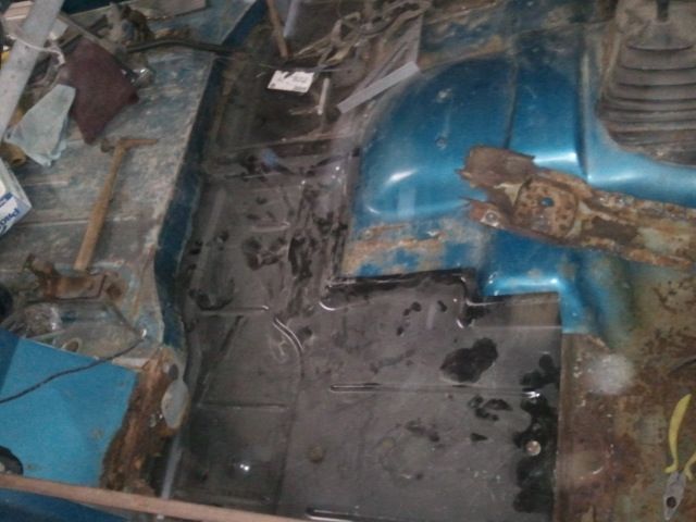

Rear pass side floor pan cut out.
Another view of pass side rear floor removed

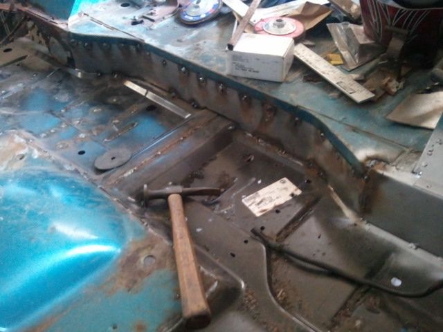

Another view of the drivers side repair. Sprayed a quick layer of weld through primer over this area as I prepare to finish the welding and rebuild the support channel that the YJ seat belt attached to.
Test fitting the new floor board

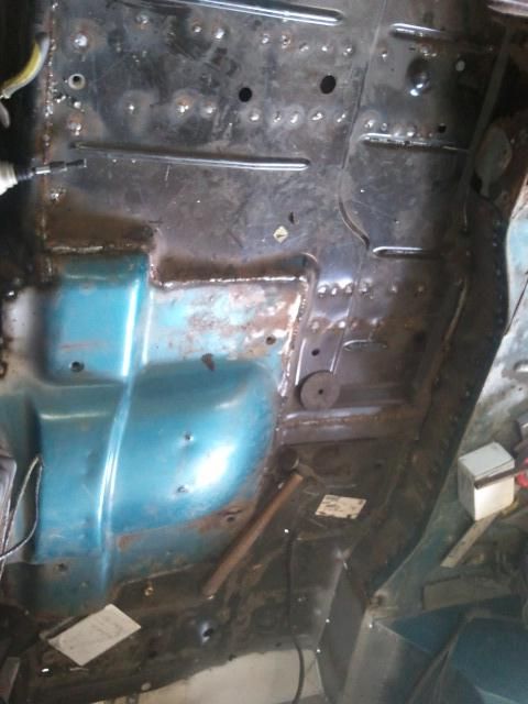

Pass side front floor pan welded in place
Repaired floor support, almost ready to weld rear floor pan in place

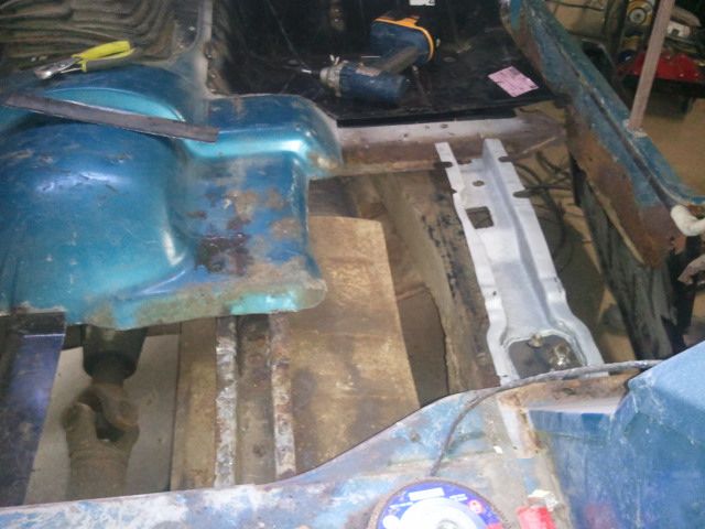

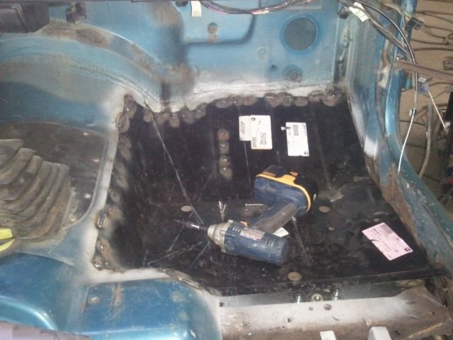

Got the pass rear floor welded in place finally, also added a patch for the riser to the rear floor area.
another view of the riser patch

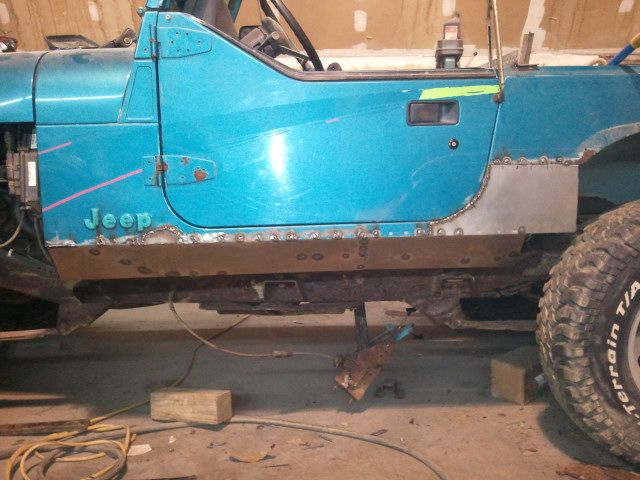

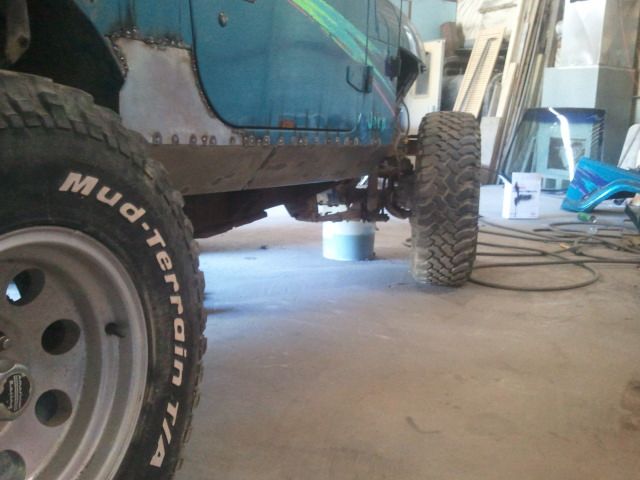

pass side boat side done...mostly!
inside view
another outside view

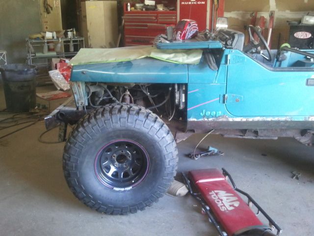

rolled one of the 35's from the JK up next to it!
