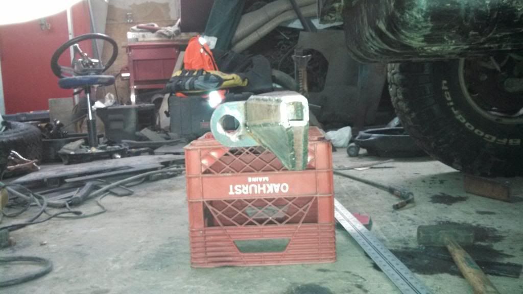

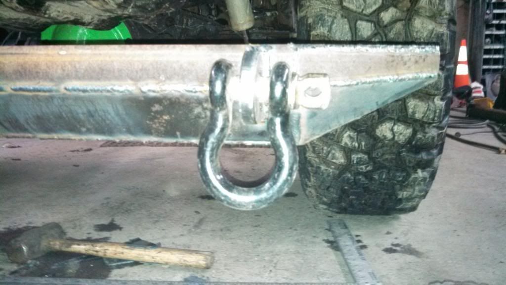

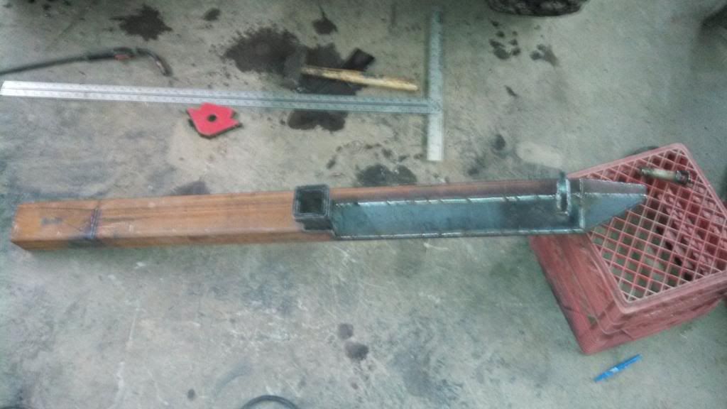

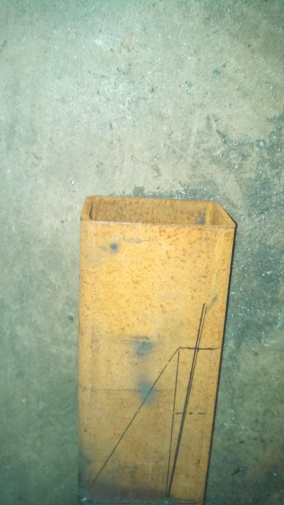

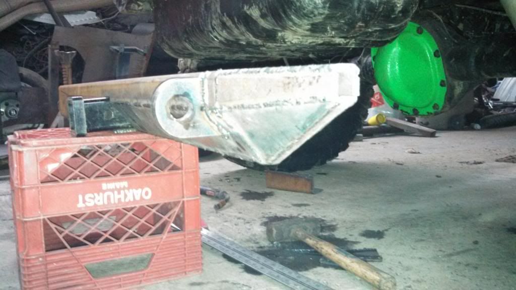

After the locker install I started building my rear bumper.
I started with a piece of 3"x4" rectangle tubing. Will have a 2" receiver and 2 d ring tabs.
I only finished about half tonight. I think it will look and work great when done!
