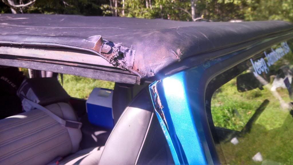

Took her out for the first offroading with the locker. A buddy of mine lost his fuel pump out in the woods, he lives a couple hours away. Another buddy and I loaded up our jeeps to go rescue him. Used my jeep to pull him out, driving in I was thinking no way was I gonna get my jeep back out with his in tow. Surprisingly it went super smooth!

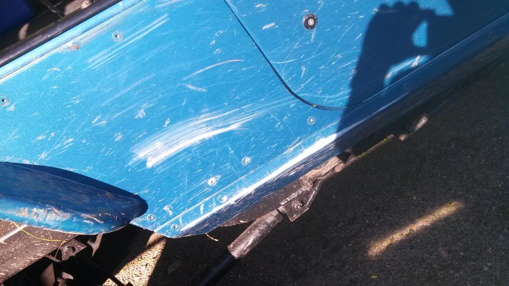

Things went so smooth we decided to do some wheeling afterwards. My friend who we rescued owns a lot of land on the rocky downeast coast of maine. His rig is an 05 TJ with front and rear dana 44's with arbs. His trails are very tight and technical, difficult without a front locker. My long wheelbase made some of the tight areas nearly impossible. Ended up with some damage. The worst of it is that I ripped out the zipper for my right side window on my top. Here are some pics of some of my damage...

Thank you for the kind words, I built this baby to beat on! Non functional damage adds character!
Paint damage is minor and expected, I'm upset with myself for not putting the top down. The tear is an easy fix, not sure on the zipper yet. I will get a picture!

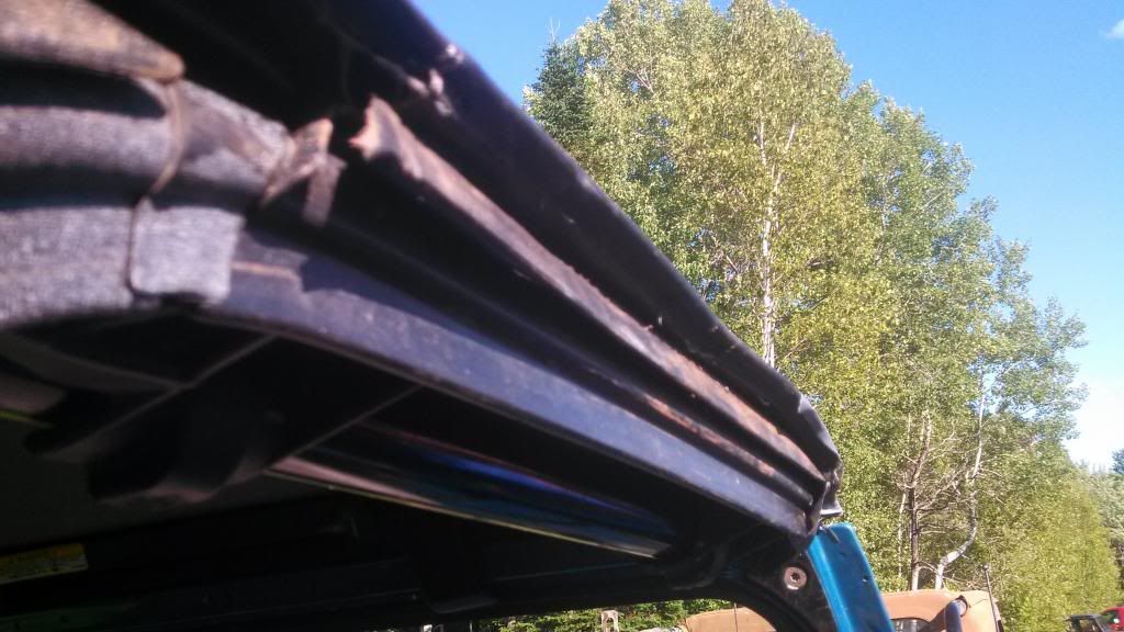

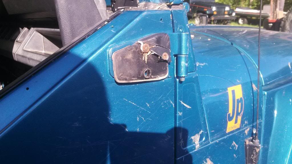

Here is the zipper

Called nearly every upholstery and canvas shop in town today. Finally found a guy who was willing to help me out. He is going to replace the zipper, repair the hole and perform some other minor stitching repairs for under 100 dollars. Only downside is the new zipper wil be white, I would have preferred black but really don't care that much!

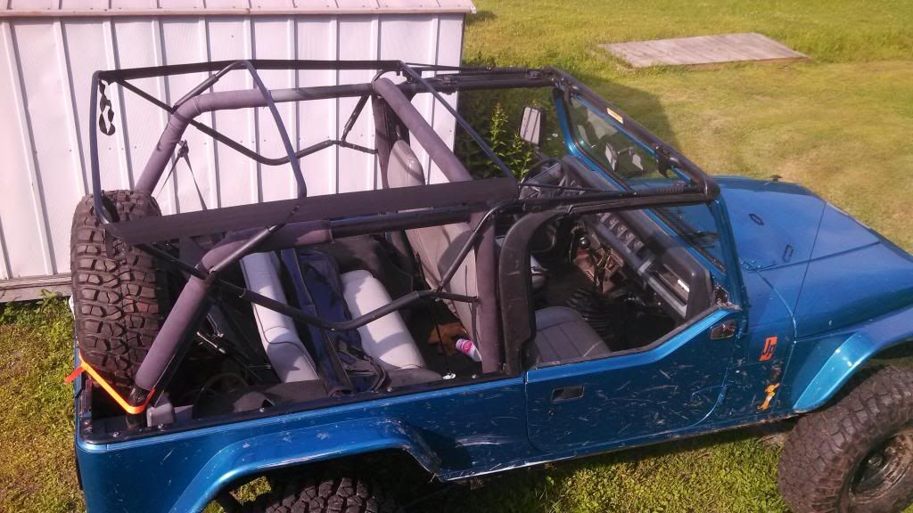

Here is the jeep without the canvas,

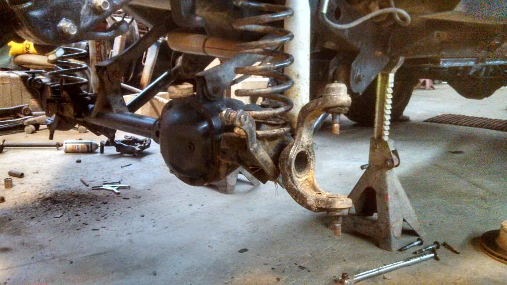

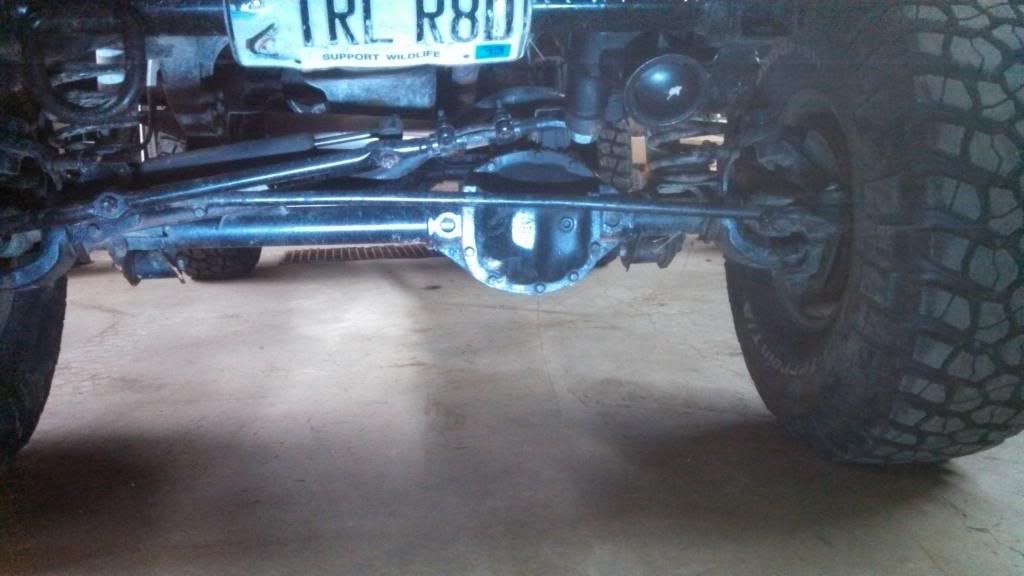

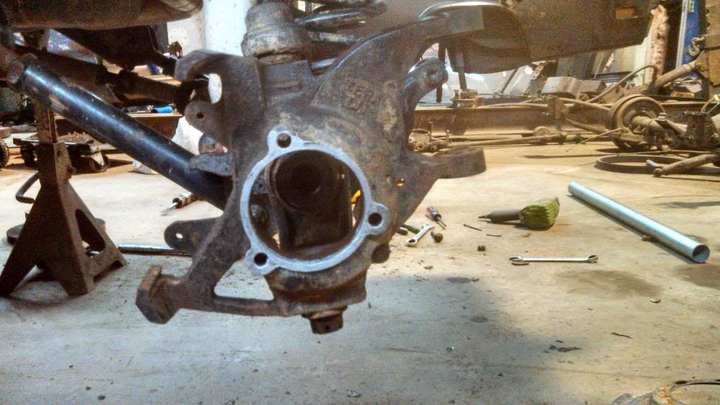

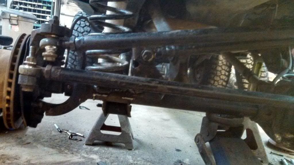

Got most of my steering upgrades done. Still have to build a frame side track bar bracket.

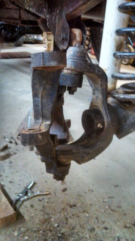

This is the stock beat up steering I started with.
Axle stripped and ready for reassembly
High steer knuckle and axle tube seal installed.

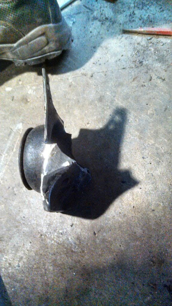

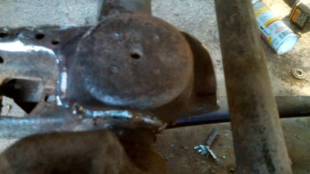

Somehow I failed to notice that the pass side lower coil bucket was rusted out. Kinda frustrating, but turns out that I needed to modify it anyway in order to have full steering ability. The crossover steering link was hitting the bucket and would not allow for a full right turn.
Here is a pic of the rusted mount cut off.
The modified coil bucket that I cut off a spare axle.
Welded in place about 1" back, the steering link now clears
Track bar relocation bracket welded in place. Steering mocked up, need some shorter bolts!

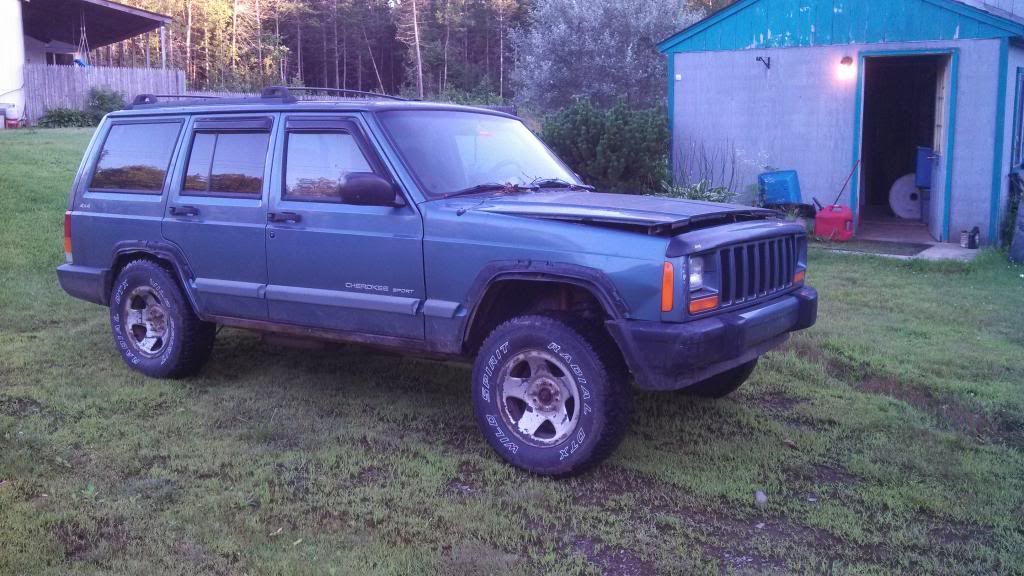

My ax15 lost a bearing or had some sort of internal failure. I looked for a reasonable replacement locally to no avail. I ended up buying a beat up 99 XJ and plan to put the aw4 into my rig!
